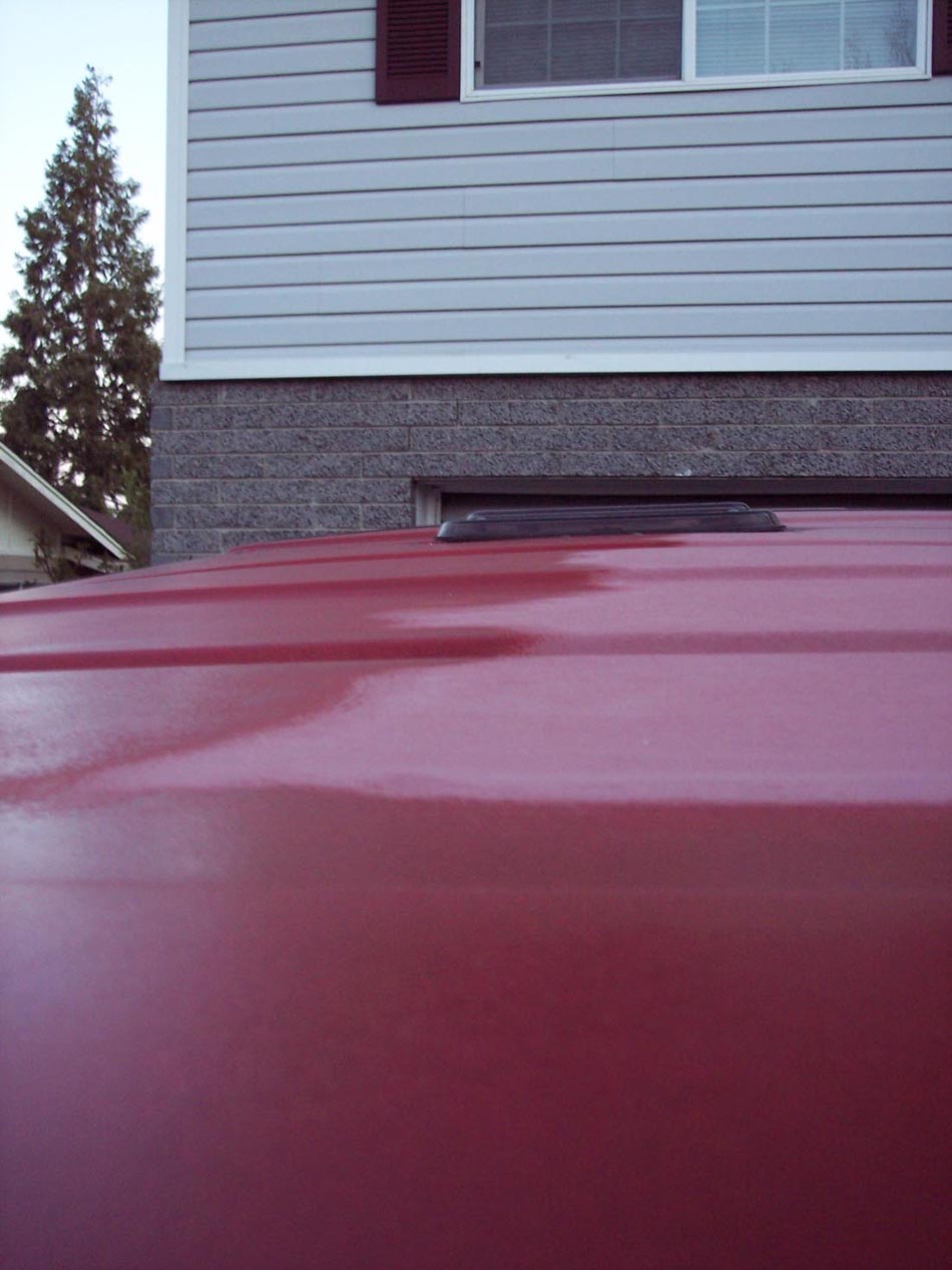

FRICKIN AMAZING PRODUCT!!!!!!!!!!!!!!!!!!!!!!!!!!!
god i love this forum, read about someone using penetrol on their fiberglass top to enhance the paint color, and does it ever. the best $12 i spent this month for sure. i applied right over top the stickers too, hope that does not ruin them. highly recommended. any paint shop will have it, first place i called was general paint here in calgary and they had 8 cans in stock $12 each.CHEAP. THOUGHT I WOULD PASS THIS ON TO ALL THE NEWBIES LIKE ME.

I got amazing results as well thanks to this forum.
picked up a can and went to work.
Even freinds that could care less about somthing like this took notice....
I had the exact same results as the other pics of the maroon van
