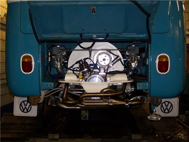

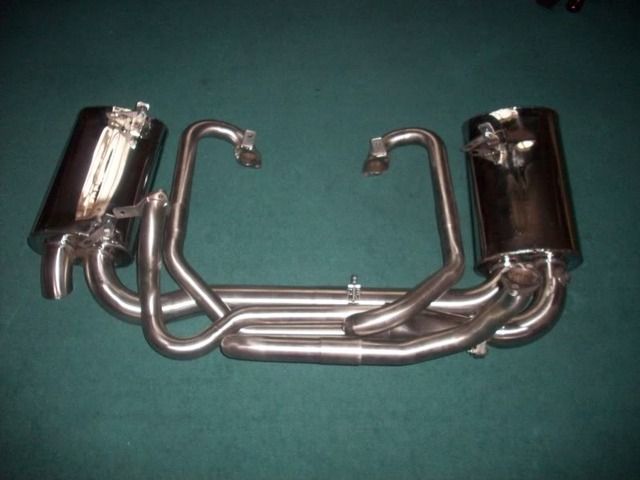

I know there are various threads out there for the different performance exhaust systems available and what problem each of them have. I have sifted my way through most of those and am still confused and undecided as to what system I would get.
I have a 2110cc mild motor and want a good exhaust system like a 4 into 1 header. The sidewinder/python style of exhaust seems to be the best ground clearance , but most people have a complaint about the sound level of the Mondo exhaust. I found a picture of a sidewinder style exhaust that has two mufflers on it (posted it in the wrong thread, trying not to be a hijacker). This system seems like it would be quiet and still have all the advantages of a header system with good ground clearance.
So, does anyone know who makes this system? or, if you know of one that is quiet, powerful, and works on lowered Busses?
Thanks, Gordo.

Sorry I can't help with a source, but adjusting the valves on that must be an absolute nightmare Shocked

PostPosted: Tue Feb 24, 2015 7:26 pm    Post subject: Reply with quote
Yup it would be, but if I was to go to all the trouble to take it off to adjust the valves, I think I would run a stinger on it for a week , just to get my loudness fix and be happy to spend as much time as needed to put it back on.

PostPosted: Tue Feb 24, 2015 9:26 pm    Post subject: Reply with quote
I doubt if that would fit in a bus. The apron and the side frame rails would interfere. Looks like maybe it is intended for a Bug.
I bet A-1 either makes that or could make you one that fits in a Bus. Lotta plumbing, but it looks pretty trick.

PostPosted: Tue Feb 24, 2015 9:50 pm    Post subject: Reply with quote
I don't know about that, the top of the J-tubes are about 5" below the engine tin seal which puts them at least 1" below the frame. And the one muffler sits in the same orientation as the other.
The only difference I would like to see for a bus is the tail pipe turned out to the side more.Like this.

PostPosted: Tue Feb 24, 2015 10:14 pm    Post subject: Reply with quote
I would worry about head temps going up with a setup like that.

PostPosted: Tue Feb 24, 2015 10:17 pm    Post subject: Reply with quote
I think two of those mufflers would not help. You will still have that "drone". Any system that has a muffler under the body will be louder than one that has the muffler at the rear. Having the tail pipe exit from under the body does help. I cut my tail pipe off and flipped it 180 to point up, and added some pipe to get it to exit outside of the body. It made a big difference, but still has a "drone" to it.

PostPosted: Tue Feb 24, 2015 10:25 pm    Post subject: Reply with quote
Gordo.
That shot looks like there is more side clearance. But the nest at the rear of the engine looks pretty busy. There isn't a lot of room with the rear tin and the diagonal brace on the apron, but maybe.

PostPosted: Wed Feb 25, 2015 3:51 pm    Post subject: Reply with quote
That was a custom made exhaust made by a guy in the UK.
I think he only made a few to fund his hobby, so not sure if he's still making them.
Cheers, Daniel.

PostPosted: Wed Feb 25, 2015 7:26 pm    Post subject: Reply with quote
Cheers, Daniel.
Very nice. Is that your bus? did you buy the system from the UK guy? If so how does it sound?

PostPosted: Wed Feb 25, 2015 8:20 pm    Post subject: Reply with quote
Gordo.
Hey, not my bus, just a pic he sent me when I asked about one. Was going to be too much for shipping for me. If it had a few more connections to break it down it could be shipped a bit easier, and could help when doing valve adjustments.
Could still make one using the A1 header as a starting point.
