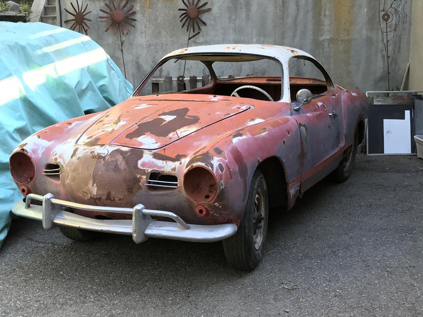

Hi all. I picked up 58' that I'm looking forward to getting back on the road. It came with a few boxes of parts. Most of which really show their age. I know lowlights have some year specific parts and others can interchange with later cars. My intent with this car is to get it back on the road and even though it would be great to have all 58' Ghia parts on it that is not my priority. So bare with me as I try to figure this out. First Gauges. Besides date stamp on back and shift markings on the speedo, are there differences up to 66'? The car came with no gauges. Second, headlights. It came with 2 sets of headlights. I was told they were from the 58' and a 59'. Anyone have an exploded drawing of how they go together and should they have lenses or just the sealed beam? I'll stop there and get these sorted out first before adding more questions. Thanks in advance for any help.

Thanks for the info. So it looks like the US spec headlights do not have a lens. Just the sealed beam. That's one part I won't have to hunt down. I figured as much about the spedo and clock. I have a 57' spedo from a beetle. I'll clean it up and see if it works. Unfortunately the mounting tabs are missing. Next front turn signals. My car came with these bulb holders. They have one connector. Should they have two? a running light and a turn signal? Attached photo

Yes I have the links. Thanks. I guess I'll find out it drives when I drive it. Ha! The car needs the usual rocker/lower fender repairs but it's not as ratty as it looks in the photo. You asked where I'm located. I'm in Utah.
