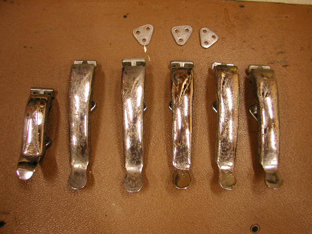

hiya,
can anyone please post a picture of the correct type of pop out window latches for a 1961 samba.
many thanks
Eric&Barb

If it's a 2 pop-out Bus, these are on the 2 rear popout windows
If it's a 6 popout Bus then these 5 "big spoons" and one "medium spoon" for the front cargo door

PostPosted: Sun Oct 26, 2014 2:13 pm    Post subject: Reply with quote
in the picture , 6 spoons and 3 spacers. which windows get spacers? I am putting pop-outs in a 13 window SO42 that came with no windows at all. it looks like they had jalousie windows in previously with all the screw holes that are there. both left and right rear window opening has the threaded latch bracket on the inside of the panel. how many spacers do I need to buy?
