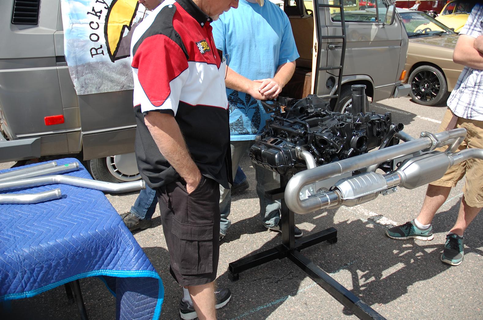

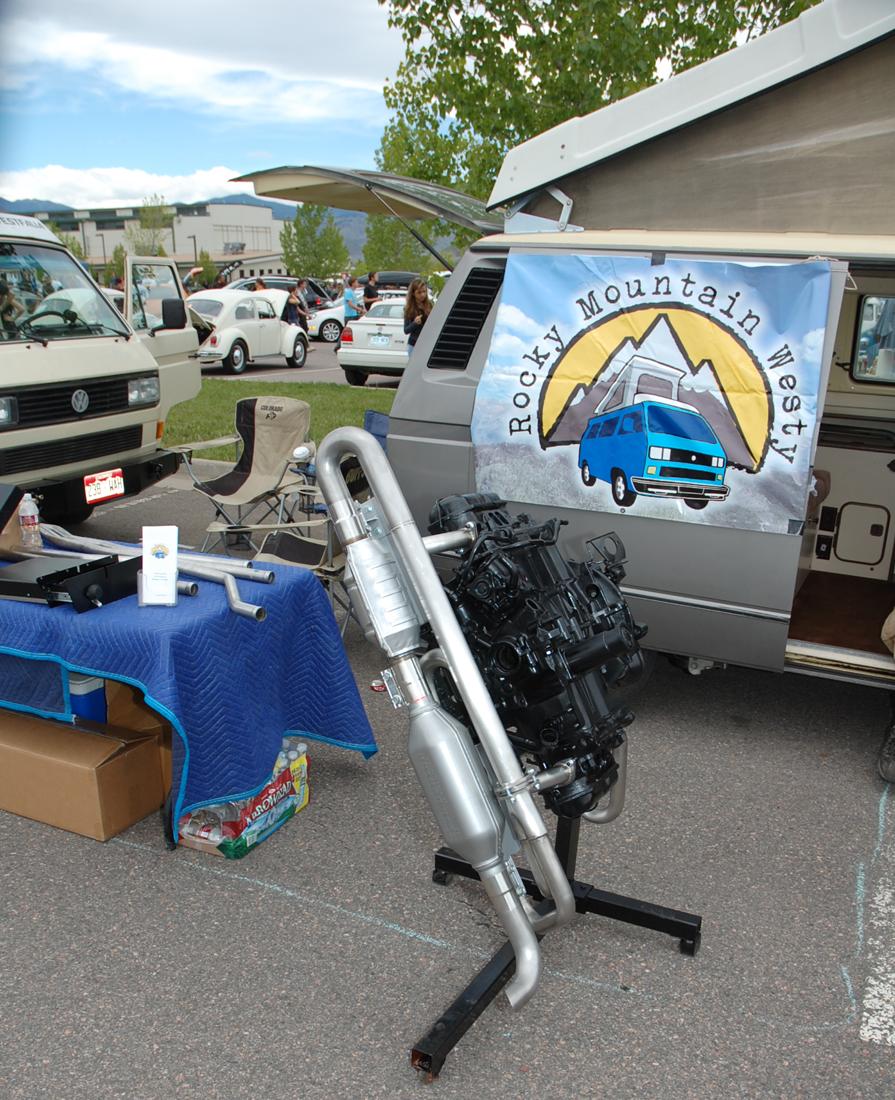

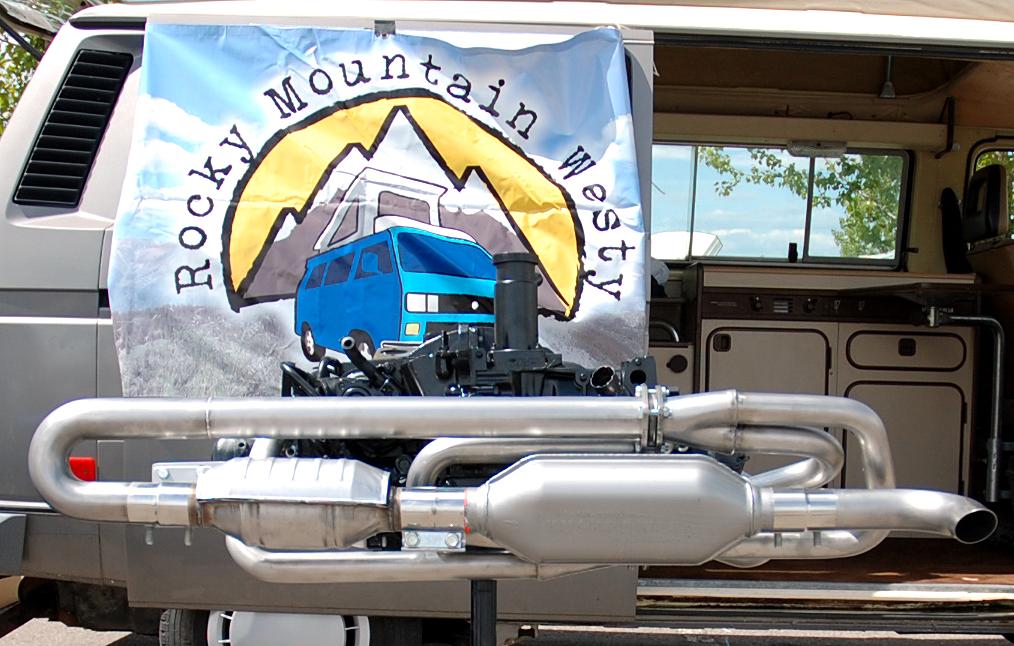

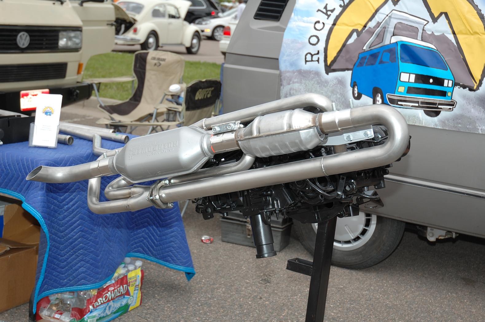

I looked over the exhaust and talked to Mike Labate about this impressive rig. He said they're figuring a 15% performance increase at highway RPM's!
I drooled, but took a little pride in having been the one at the 2009 VW's on the Green to urge Greg to build Chris's design, having whined... er, talked to Chris about building and selling the thing:
As of our conversation in very late May, Greg was talking about $2K and a day installed for the full package.
I'm sure we're all very grateful to Mike and his company for offering such a wonderful and worthwhile product to our community:
I'm saving my pennies. +15% would be just about right for Winston and his faithful 1.9L.

Two improvements I notice from the system I was sent are appreciated.
Slip joint between the CAT and muffler.
Precut tailpipe.
Bravo.
