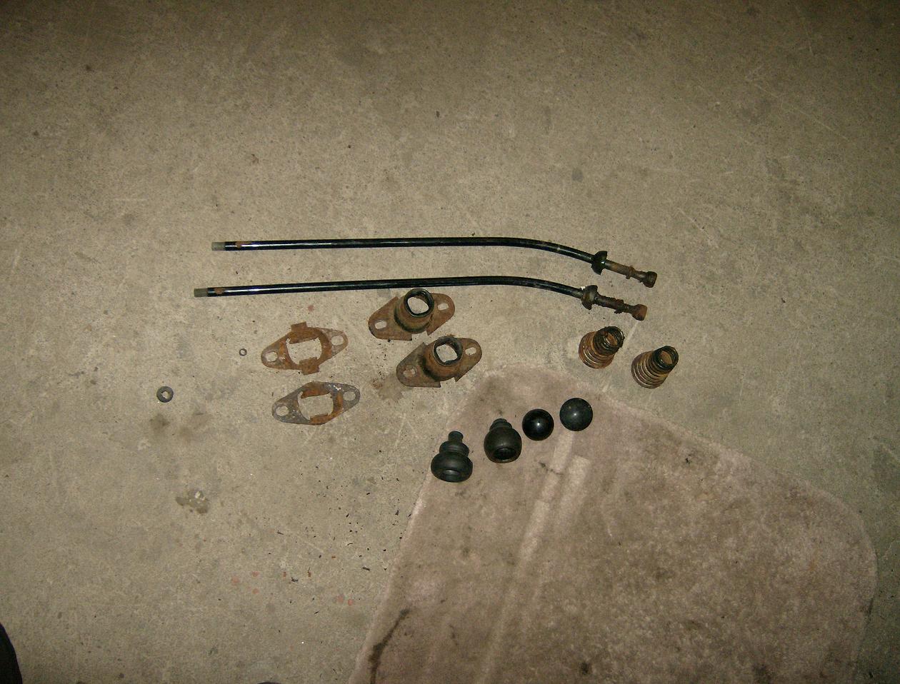

Since we're asking, mine squeeks like hell underneath the boot and can be hard to go into gea but the pattern is tight. Am I just lacking grease? What kind of grease do you recommend? The picture (top of post) looks like there is no grease in there.

You can use just about any grease in there. Whatever I have around is what I use. I fill the cup and then ram the ball down into it with the pin facing forward.
