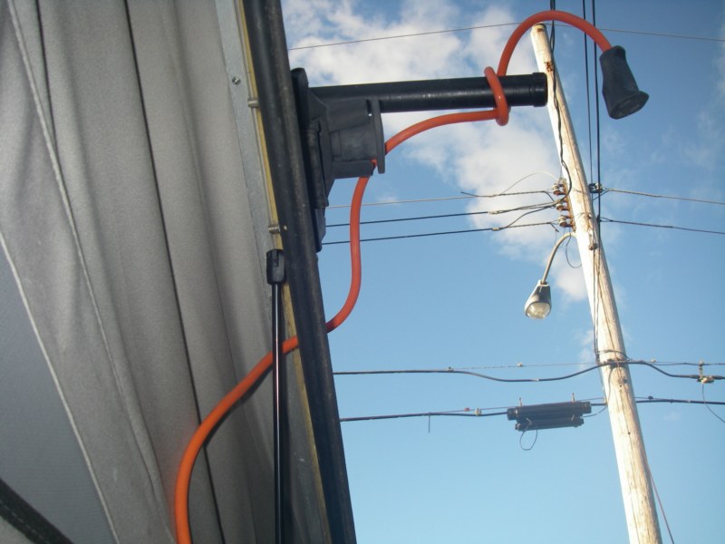

I've gotten a few requests for pics of how I set up my panel over the last few months, and I've finally taken some pics, and an old youtube vid.
Here is a pic of the front mount, it is a spherical ball mount and the bullet shaped steel sticking through it is bolted to the solar panel, the back can lift up or I can tilt it side to side or leave it flat Wink , in all of those positions it is still locked to the van, or I can take it off the van entirely as it is on a 40' 10 gauge cord.
And here is a thule locking knob, there is one on each back corner of the panel, 6X1 threaded rod is attached to the panel on the back edge. The piece of wire is up there from when I was carrying some long cargo, its not part of anything for the panel.

PostPosted: Sun May 03, 2009 8:41 pm    Post subject: Reply with quote
1621 wrote:
Brilliant! Love the simplicity!
The first couple ideas I had were pretty "involved" LOL they probably would have weighed 20 pounds without the panel.
1621 wrote:
What are you using for the prop to hold it up?
A piece of 1" X 1/8" steel with a 6X1 bolt welded to it.
1621 wrote:
How much cord length are you limited to when tilting?
I actually have 40' of 10 gauge cord under the panel that is permanently hooked up so on hot days I can park the van in the shade and put the panel in the sun.
To be totally honest I don't move the panel around much largely because I have way more panel then I need so maximizing the output by having it face right at the sun is not all that important.
With this setup I would not leave the panel tilted in either direction if the wind was blowing as the panel is only supported on 3 corners, and when the back end is up the only thing holding the rods on the front of the panel into the spherical ball mounts in gravity, although instead of smooth rod I could use threaded rod and some wing nuts, but they wouldn't be to easy to get at at the front of the panel on the roof.
As it is now I just stand on the rear bumper and can tilt the panel either way or remove it from the roof pretty easily...

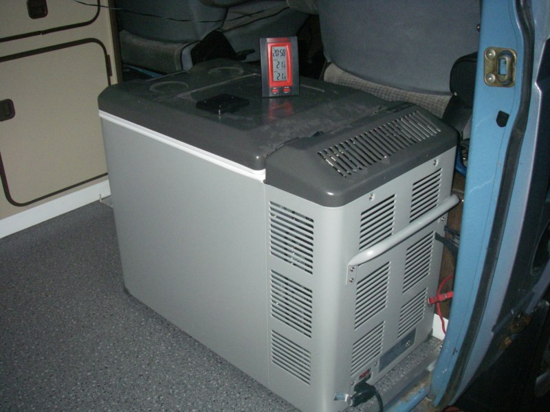

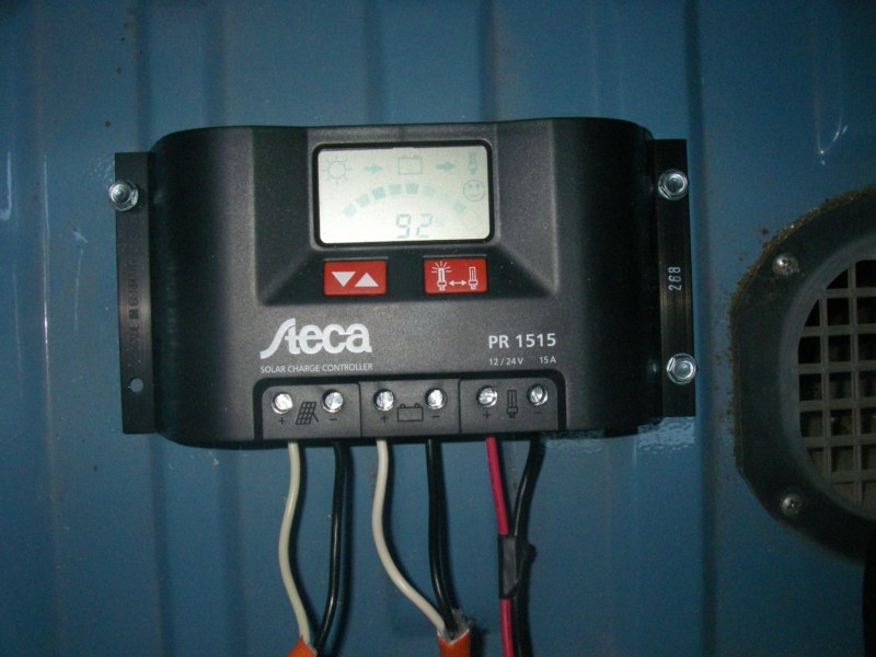

Hey folks after months of reading posts, researching solar system, calculating solar requirements, scouring for panels, batteries and other bits and pieces I have finally put together and installed my system.
I would like to thank everyone for answering my questions and providing advice.
Why was I looking to install a Solar panel set up? Basically I wanted to run my Engel fridge totally off grid for up to 4-5 days. My propane fridge was not running well and my propane tank was due to be replaced. I figured the Engel and solar panel was the way to go. The only issue was that in Atlantic Canada we do not get as much solar radiation so the calculations were indicating that I needed a bigger panel.
Here is my basic set up:
- 1 x 135W Kyocera KD135 SX UPU Solar Panel
- 2 x Odyssey PC1500 Deep Cycle Battery (Only One is installed right now)
- Steca PR1515 Solar Charge Controller
- Lots of wire

Next wire it to the Solar Charge Controller

And Plug In the fridge. I will be installing a couple of more 12V sockets, one right on the passenger post by the fridge. The temp of the fridge is 'C not 'F. It is cooling down as I write this
All for now. I will let you all know how I make out this weekend.
