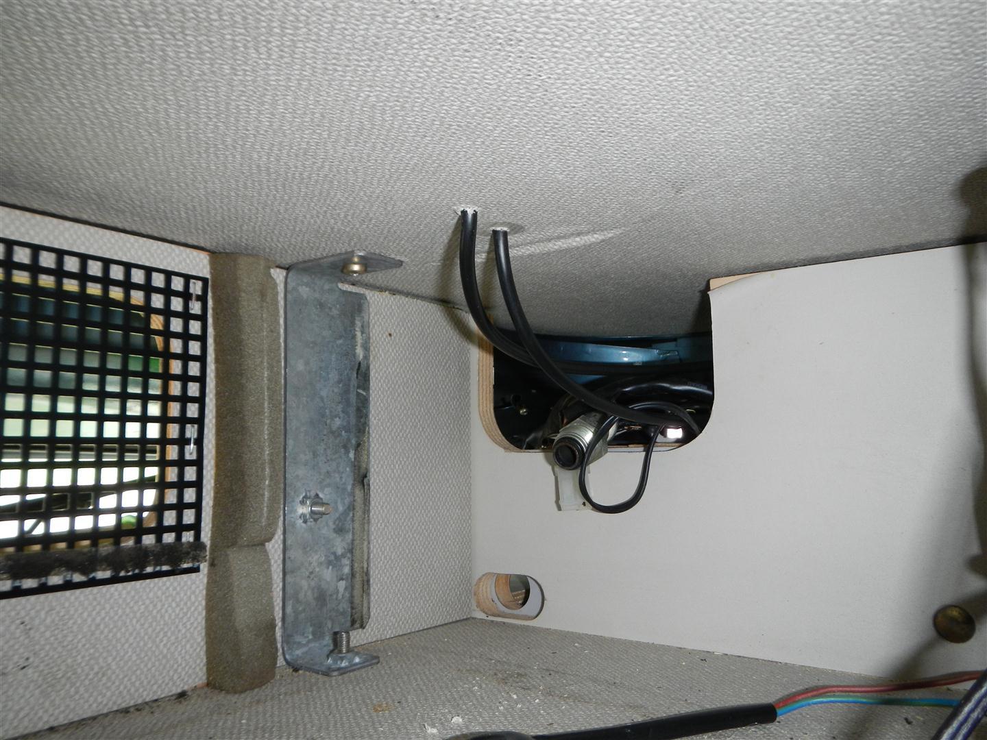

Hello Samba.

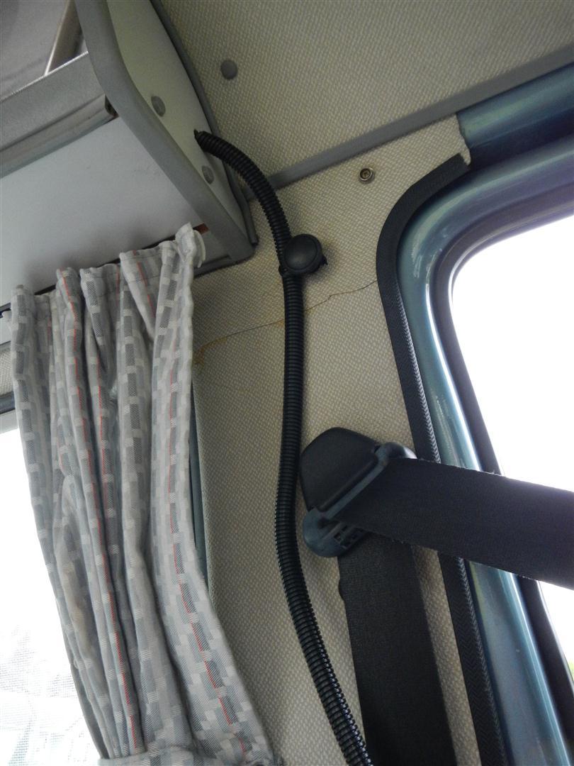

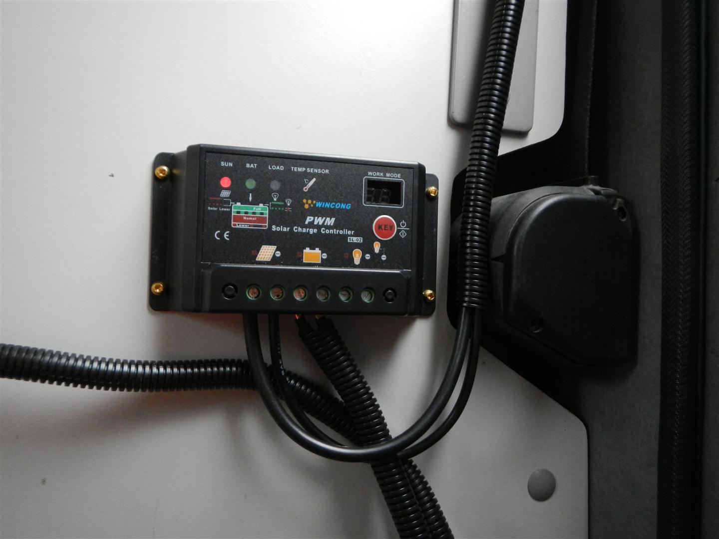

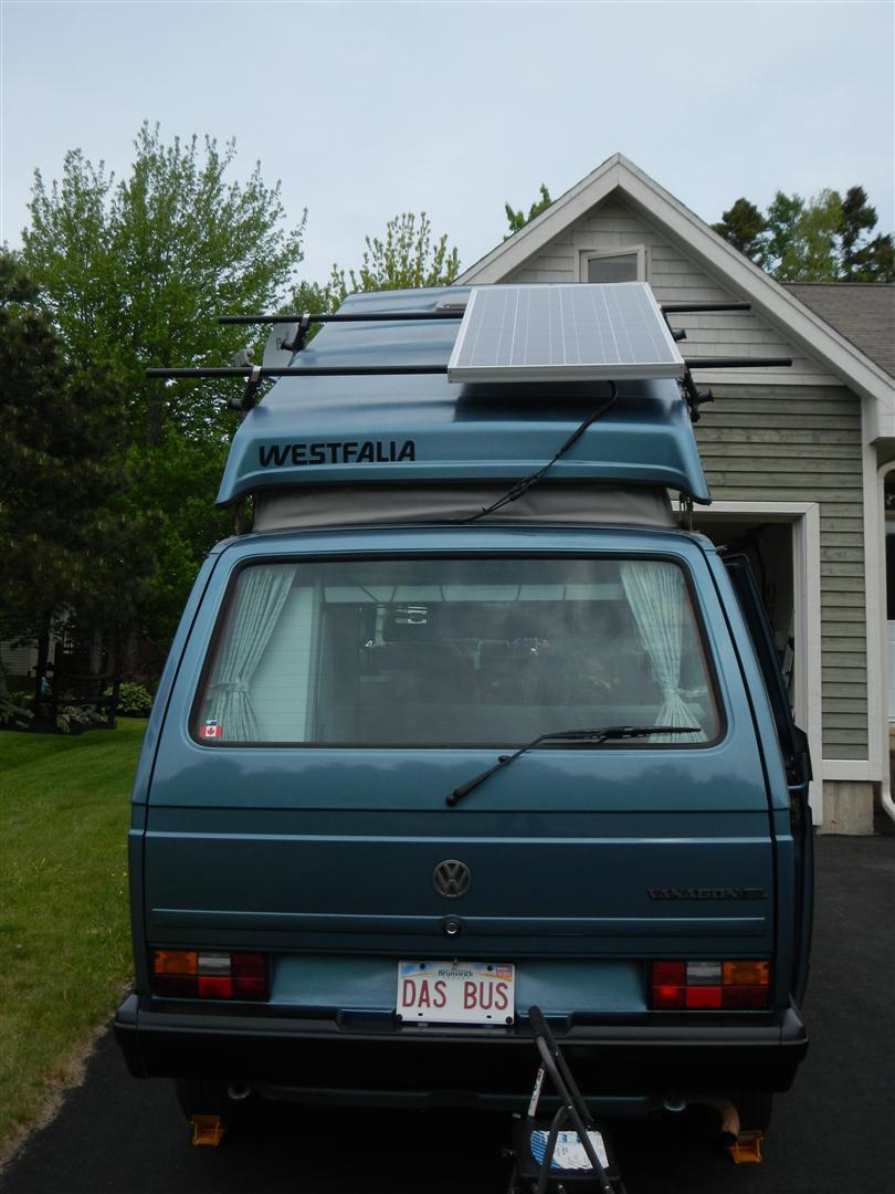

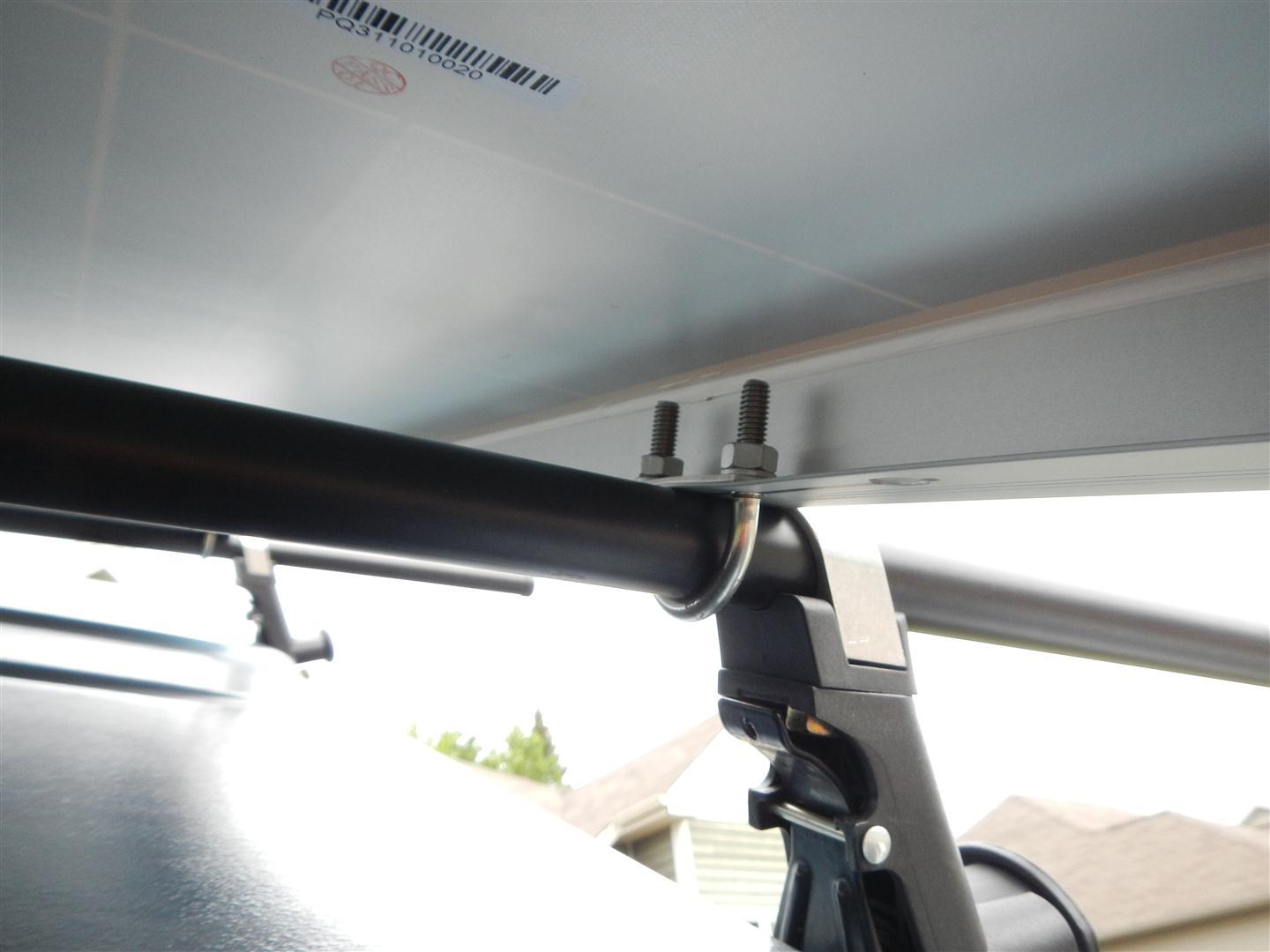

I came across a good deal on a solar panel so I decided to jump in. I did not want a complicated set up so I kept the whole thing very basic and totaly removable.
I already had an auxiliary battery (GW kit) and Yakima roof bars so I built from there.
The panel is 140W and came from a bankcrupt local solar business. I got the panel, the controler, all weather connectors and a bunch of 10 gage wires for 330$.

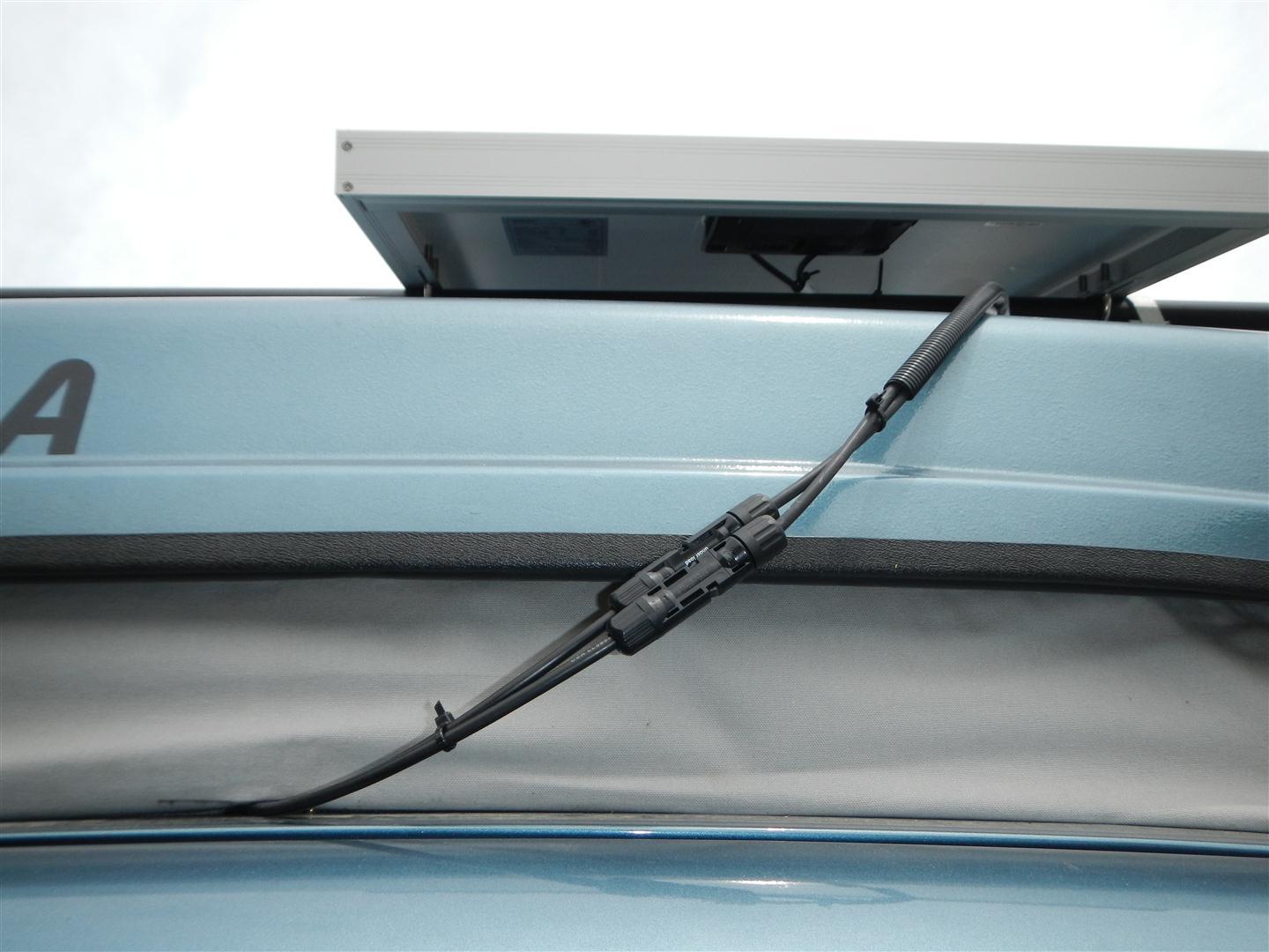

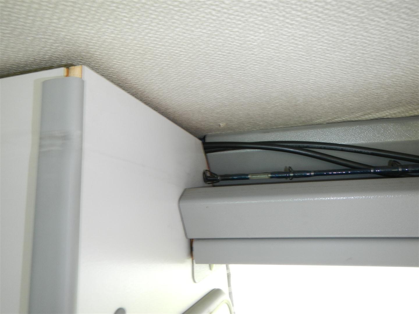

I did not want to drill holes in the roof or in the body so I inserted the wires under the tent at the back, ran the wires down where the AC use to live, in the gutter above the stove and down the pillar behind the driver seat to the aux battery. I installed one 12V socket to plug accessories, only the radio and this soket are wired to the aux battery for now.
I tested it in full sun all day yesterday while at the beach. I was running a basic electric cooler and managed to recharge my battery from 11.6 Volt to full charge and run the fridge at the same time. At sun peak (12h-14h), I had 7 amps at the controller and 13 Volts on the battery while running the fridge and the radio.

Nice setup. I have a similar configuration on my roof rack. I went through the fresh air vent on the left side of the van, drilling through the interior sheet metal well inside the vent, so as to prevent water coming inside.
Might I recommend you put the solar panel on the left (driver) side of your van. When you park on the street, you will find that the trees along the sides of the street will shade the panel less often. In addition, you will be able to access whatever else you put on the racks--surfboards in my case--from the sidewalk, without having to walk into the street, where there may or may not be busy traffic.
