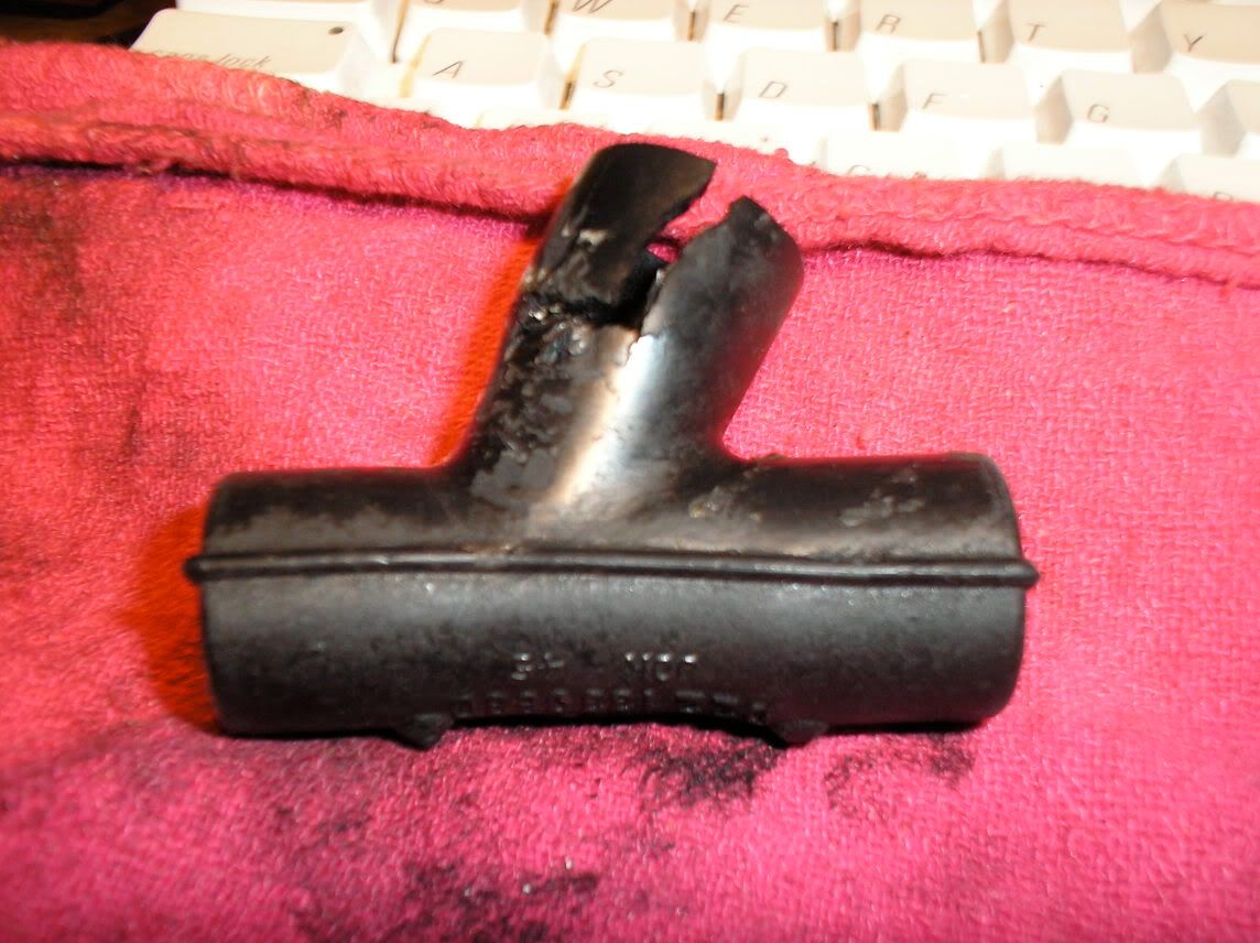

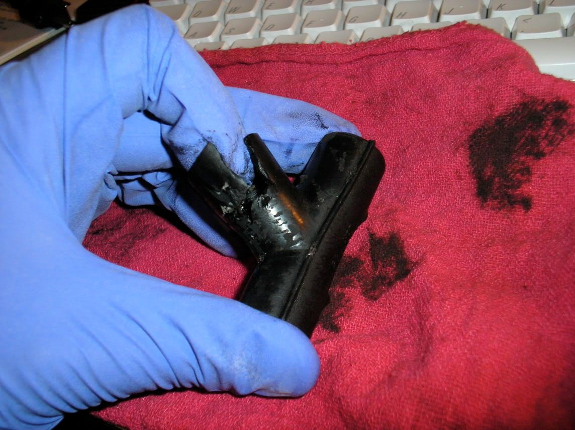

my 78 bay cranks then dies, fuel presure and pump are in great condition, afm resistance checks out, double relay checks out, i found this looking for a possible vacumm leak. it is the elbow at the brake booster line to the decel valve. could this be my probelm.

Brake booster elbows strike again: Isn't it the #1 air leak ?
Sure that is your problem. When my Westy stalls at every stop ( no idling ), I know the right elbow has poped out again. Back on, everything is back all right.

PostPosted: Mon Aug 07, 2006 4:00 pm    Post subject: Reply with quote
Ha ha... when my motor races and the brakes go to manual, I know my LEFT elbow has popped out. I've got that fixed now.

PostPosted: Mon Aug 07, 2006 4:14 pm    Post subject: Reply with quote
where can i get another one. busdepot are backordered. is the an altenate solution, like an on they fly fix. any ideas

PostPosted: Mon Aug 07, 2006 5:50 pm    Post subject: Reply with quote
Birdibus wrote:
How come, my brakes don't go manual when my RIGHT elbow pops out ?
How did you fix it ? Did you find and cure the cause of the poping out ?

PostPosted: Mon Aug 07, 2006 7:44 pm    Post subject: Reply with quote
Strange that someone would say they are NLA. Where do you live?
Part number 022 133 083D
These VW dealers have it in stock [the number in front is quantity]:
