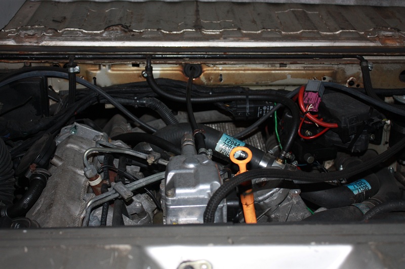

The engine bay. Notice the modified oil filter welded to face down, with a AHU oil filter set-up. The big black flexible air intake tube will be changed later to a set-up that goes towards the underneath, instead on top like now (and I believe a lot of noise comes from):
The pump and the belt tensioner (not shown) are the highest point. The tensioner is planned to be shortened, and the engine lid will be modified to accomodate the pump when we'll raise the motor that is just too low to the ground. Is there any way we can tilt this pump like a AHU?:

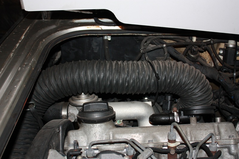

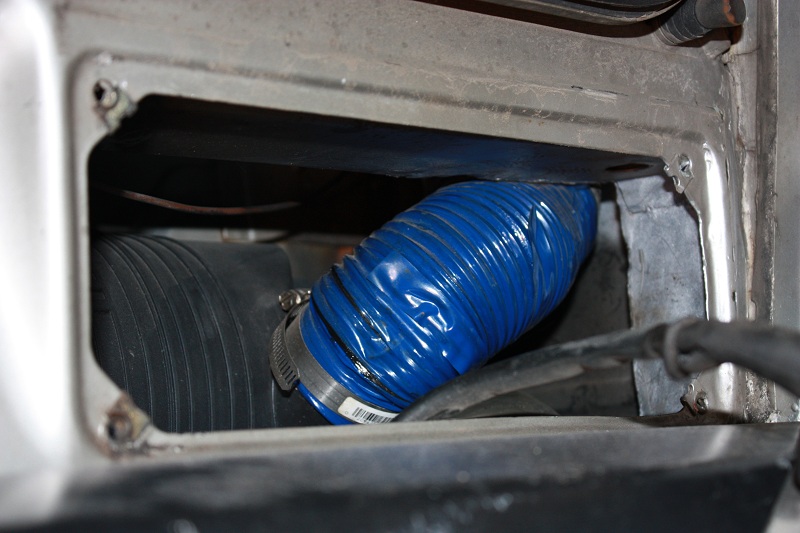

Here is my intercooler set-up. The air comes from the top air vents and comes out tru the bottom, and is sealed from the engine compartments heat. This intercooler is from an Eagle Talon. Corroplast mini mud flap to protect the intercooler, and to also create some sort of vaccum while driving. No electric fan at the moment but planned to be added (don't feel the need for it yet, according to my thermometer laser gun.
Donalson air filter # G065433. Note that a little metal wall was removed to accomodate the filter. The blue tube will be changed later to...

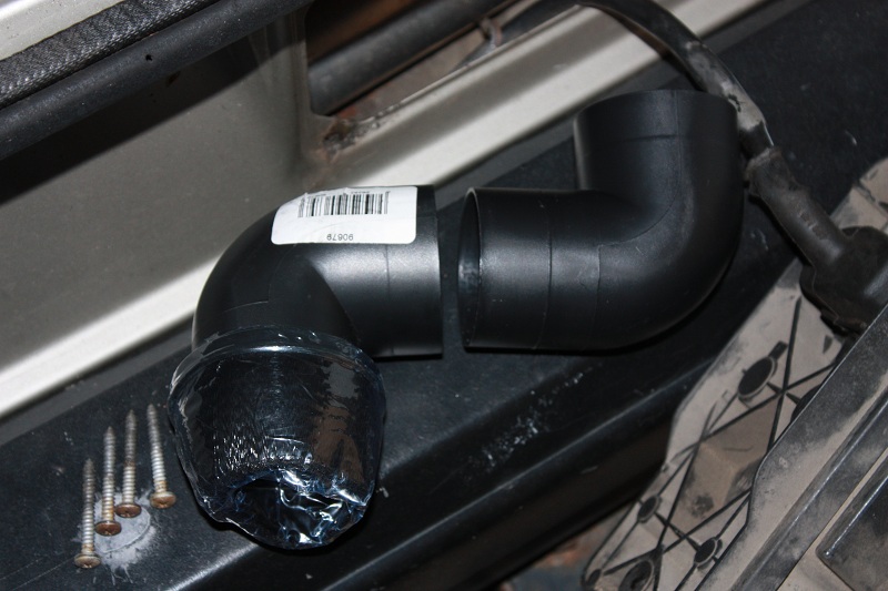

I just fell on these nice perfect 90 degree plastic tubes days later after fighting with the blue flexible tube. They where found at Canadian Tire store and they are for the shop vac!!! 10$ each! Perfect fit diameter to the donaldson.

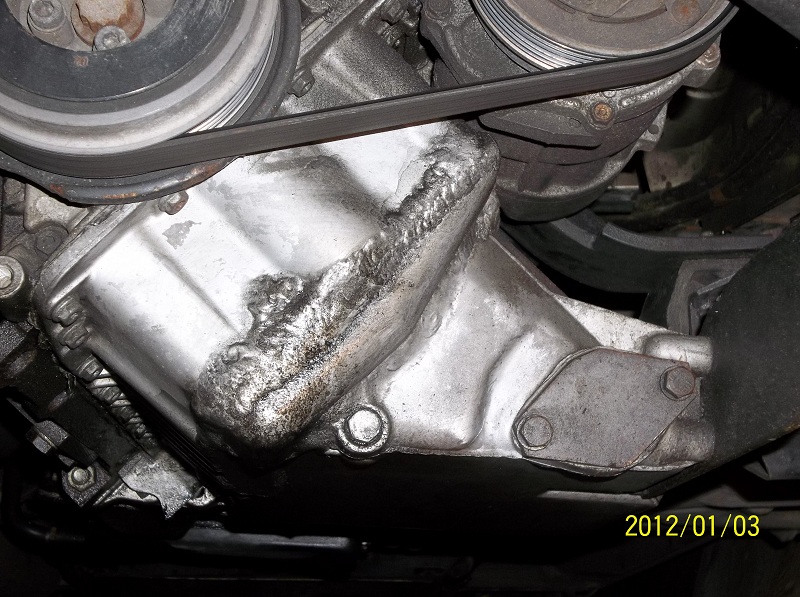

Hi Jabba, so here is my custom oil pan. As stated before, it is the base of the ALH TDI oil pan welded with the bottom part of the vanagon diesel oil pan. I could not figure out why there was always some oil stains on the welded pan. I figure it out later that, with time, the oil will go tru the aluminum welds and create this leak. It is very slow, but annoying. I might consider to paint the interior of the pan, as suggested somewhere here on thesamba. i don't know what kind of paint to use.

@pedrokrusher, Is your oil pan MIG welded? If that's the case I would suggest you to really clean that weld up and ask someone to reweld it with TIG.

Hi Svenakela, I don't know the difference about TIG and MIG aluminum welding, I guess I need to TIG weld it now... Keep on learning!
Try using some Glyptal

Hi pedrokrusher, For next time, welders need to spend extra time prepping alum., remove the natural occurring oxides on the surface with a stainless brush, use a alcohol based cleaner after. Your pan most likely leaked from the get-go...just took awhile to get to the outside.
For lack of proper NDE equip/methods...Diesel gas/petrol works well to reveal flaws. Fill up the pan, have a beer and hope you did it right the first time, or you go through the prep. again Rolling Eyes. And a nice little AC square wave inverter with a pedal helps.

Bosruten is right you need a very good preparation on the 2 pans before weld them together. Aluminium is like a sponge and when you warm it too much, the holes become bigger. If there is oil when you weld, you can create a boiling. Also, you can't Begin the weld wherever because the metal reacts by twisting itself.
I've done the preparation on my oil pan but let do a professional welder for the weld. He used argon and weld inside and outside the pan and there is no leak.
Pedro, i have seen the original bracket for the exhaust on your pan. I trust my welder but to support my exhaust i didn't use this bracket.
