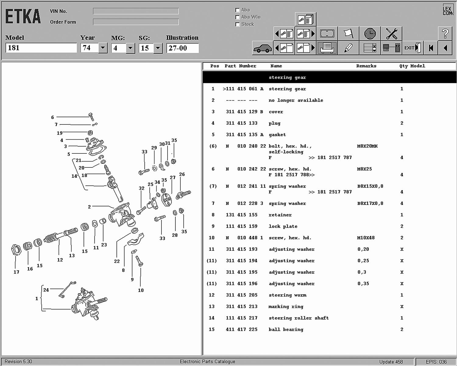

Sometimes, due to age, corrosion, etc., there is play between the steel parts of the flexible joint and the steering column shaft or the input shaft of the steering gearbox (25 & 26). Check those pinch bolts too.
If it was my car, I would replace the coupling disc (27) if it was more than a couple of years old. Use a stock disc (not urethane).

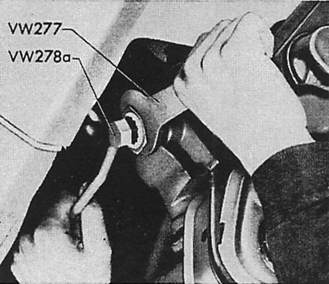

Since I don't own the special tool for the worm adjustment bolt (#16),
I have used a big metric nut, which sticks out far enough to get a wrench on it.
