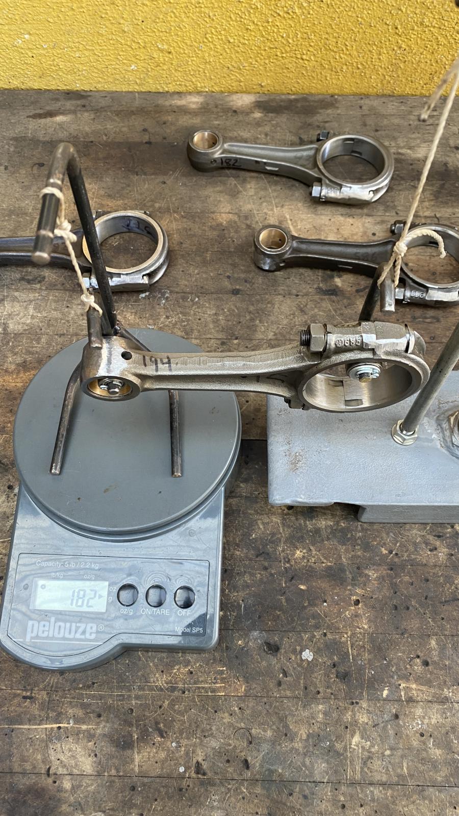

Hence the counterweighted crank with a balance job.

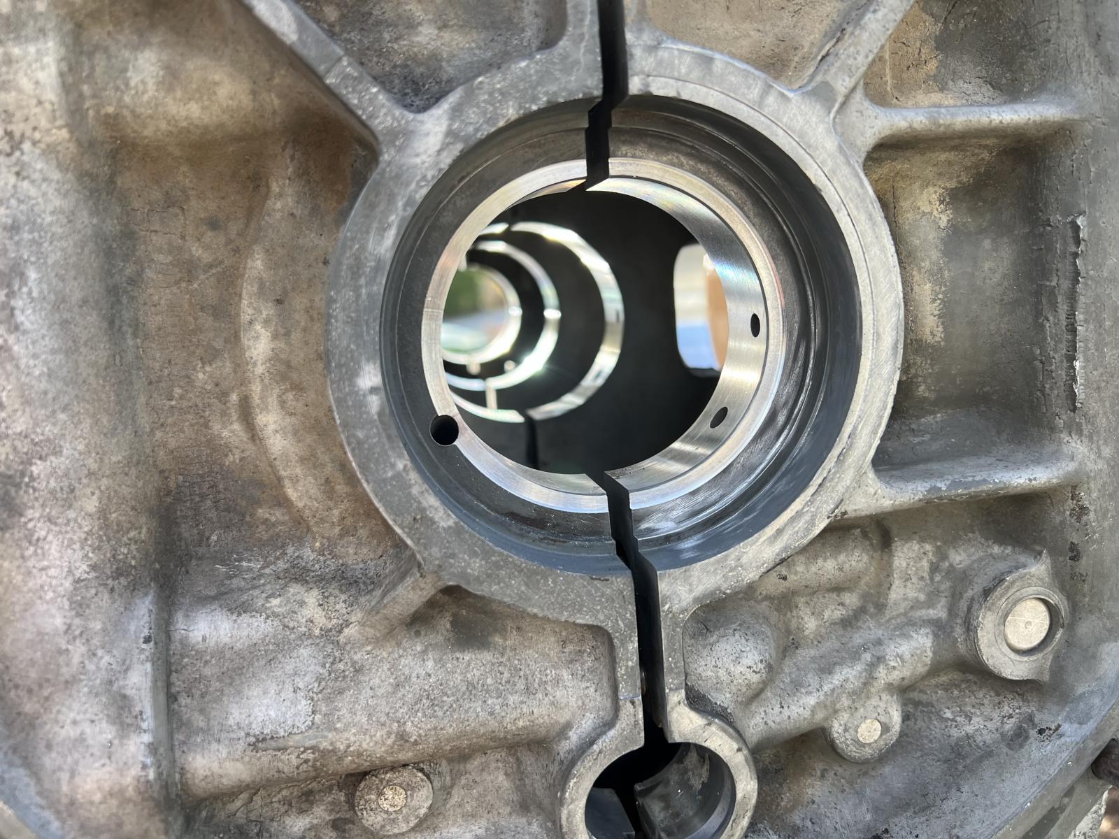

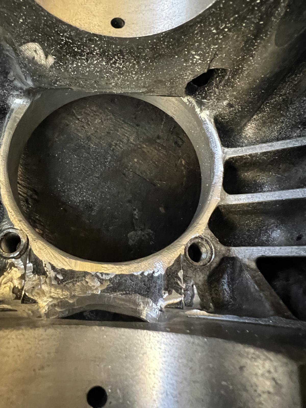

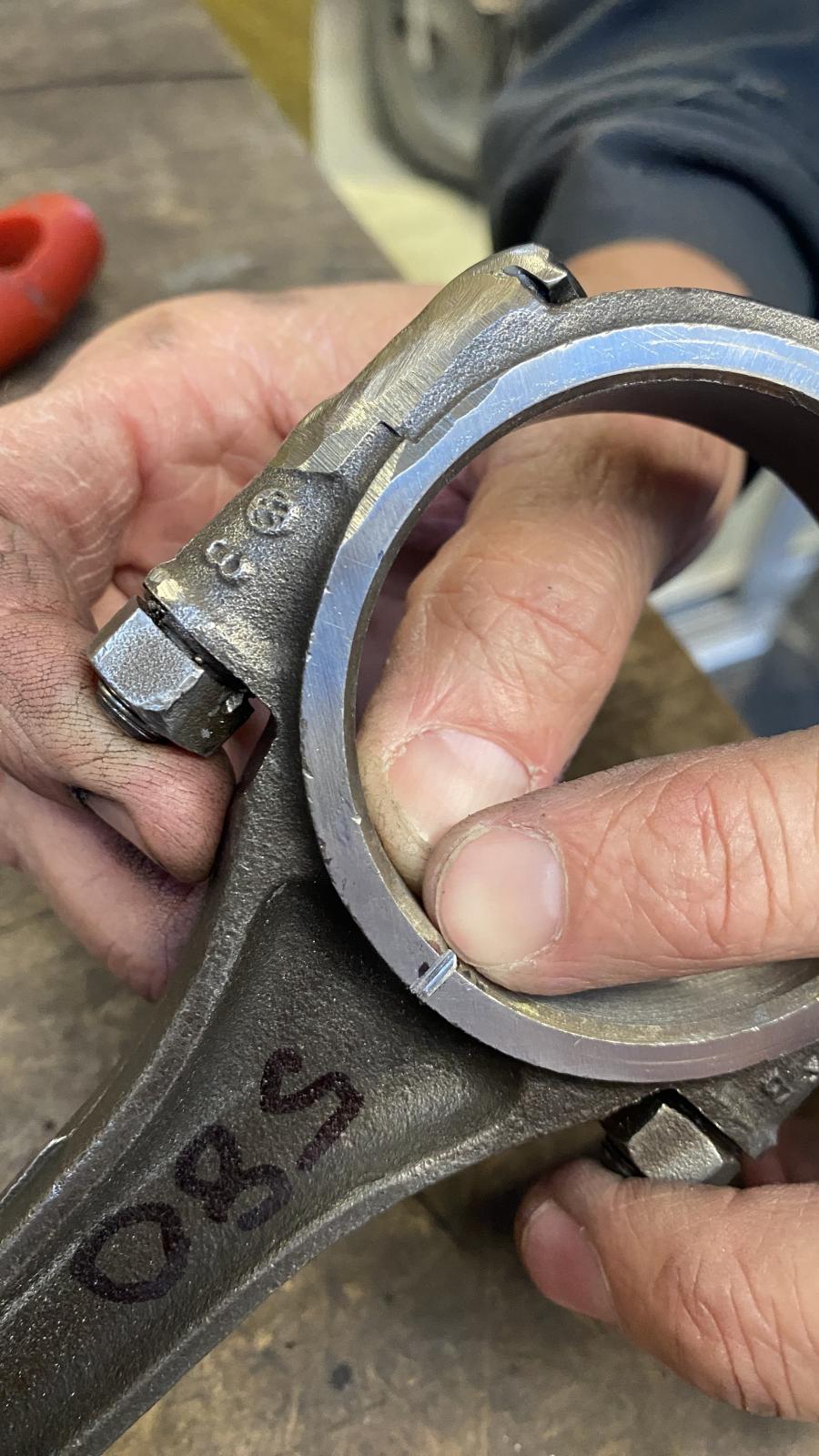

Once Jeff gets some pics up we can show profiled rods, case porting, head porting, full flow, Hoover HVX, etc.
Here we relieved/blended the bottom of the cylinder spigots a la David Vizard.
At the end of this vid:
https://www.youtube.com/watch?v=2qqoXy_kyZc
Eliminating the sharp edge along the bottom of the cylinder spigot cut into the case should allow air to flow more freely.
A nice motor. "Balanced and blueprinted" even if nearly stock.

I realize you think very highly of your VW engine machinist, but don't the cylinder openings have a REALLY rough finish?
I've had about 15 cases machined for larger cylinders by various shops such as the original RImco, Berg's, and a local shop in PA over the past 3 decades- and the ground surfaces are usually as shiny/smooth as seen in your first photo of the fresh line bore.

I’d buy a set of 5.4 CB Unitech rods vs rebuilding stock.

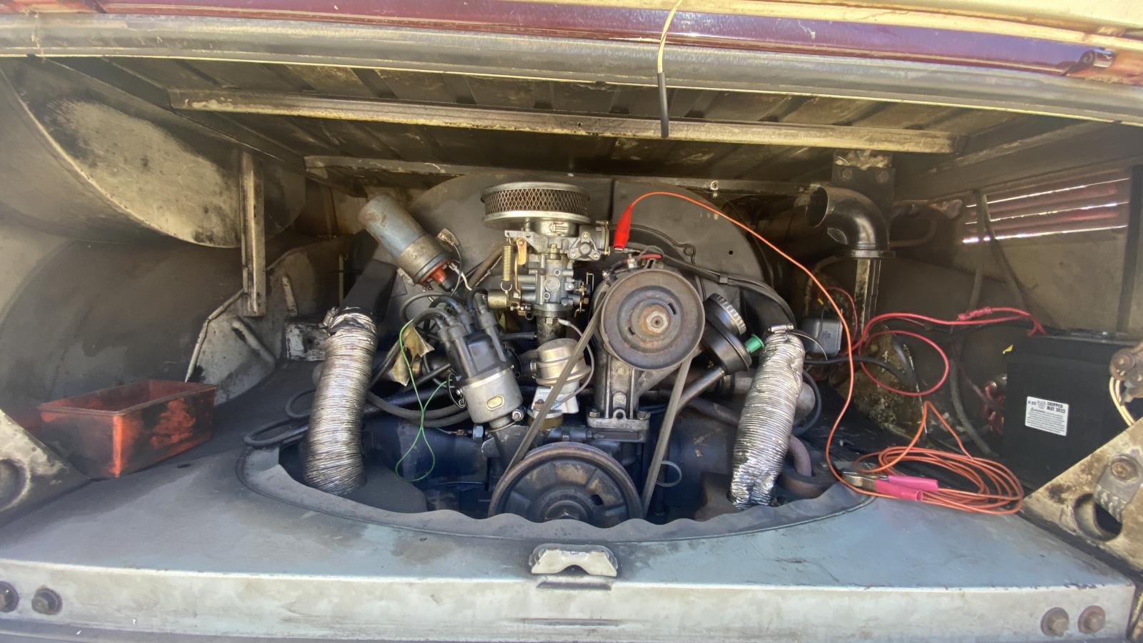

Here are a few photos.
Certainly open to anyone’s advice…
67' Squareback
66’ EZ Camper
Jeff’s Bus Stocker Plus

Regarding the rods…definitely nothing wrong with stock rods for your build. Just a preference of mine.
CB’s Unitech rods are forged-Chromoly and balanced for $90…just hard to beat
Heh! Someone noticed this.. Smile
Take a bit closer look at what’s going on here.
Cylinder ‘open up’ cut was done well and the finish is clean.
The ‘mouth’ of this cut has had a radius added.
Said another way, there had been a bell-mouth put on the bottom edge of the cylinder spigot.
Kind of like a velocity stack on a carb…
Pics were taken just roughed in with a burr.
We were going to polish it with a flap wheel,
But current thought with intake ports is that a rough finish flows better.
Didja watch that video i linked?
Vizard is a well-regarded builder.
Not a huge gain here I’m sure,
But these small mods do add up.
More power, better mileage, smoother running, and free!
What’s not to love?
I do get where you’re coming from.
There is a new set of those Unitechs right here in their box that i got for free and might never use.
Would have happily given them to Jeff for his build here and saved us a bunch of balance work.
Jeff’s motor has obviously seen an ‘engine house’ rebuild by a volume shop at some point.
Things like rods and pushrods are from different motors.
You can see subtle differences in color or casting marks, but especially in balance.
These weren’t all made at the same time and came from the same core motor.
So, even though they were balanced within a gram or two overall,
When we did the end-to-end balancing on my jig here we found more imbalance.
It did take a bit if fussing to get them nutted, especially with my hoakey balance rig.
Still,
In the end,
I’m going to offer that a set of properly-done 311b rods are better in one way:
Overall dimensional accuracy.
My man Jim has a couple of nice old Sunnen rod hones and has used them consistently for decades.
He knew we would be looking carefully and care deeply about the quality of his work.
Things we can check like pin fit are exacting like you can only get from a craftsman.
While the Unitechs are really nice and might be perfect as well.
If they weren’t, we wouldn’t know until it’s too late.
This way we have the man himself checking everything on a precision instrument.
I trust Jim’s work more than people in China on an assembly line cranking out rods for low wages.
