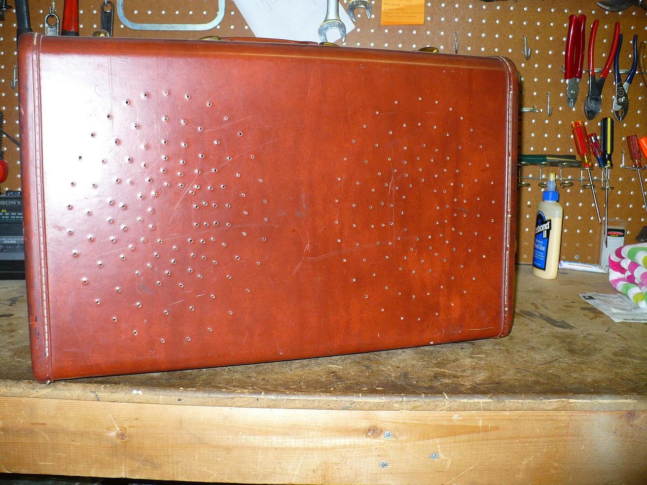

I built mine the same way as you did but instead of putting the fugly grills on the outside, I made an internal box on the inside (tight fit so it wont rattle at all) and used a protractor to mark circles of equal amounts on the outside of the case directly over the speakers and drilled numerous holes in the top with a very small drill bit. So the case looks like nothing was ever done to it, has way for the sound to escape, and since the case didnt have the large holes drilled into it it makes for more of a enclosure making the suitcase louder.
Im running a 150w (1 channel, will be rebuilding it soon with a multi-channel) amp to 2 4-way 6x9's controlled by my ipod. Mines so loud that I cant listen to it in the car over half way on the iPod. I have longboard ride nights around town here in the summer, and we just put the case outside the bug and crank it. can be heard a 1/4 mile away on a still night.
The suitcases are a lot of fun. With mine being completely hidden underneath the case, I have had numerous people fall in love with them. I have mine, and have built 4-5 for numerous porsche 356 owners around.
I will try and get a picture for you of the two I have at my house at the moment (mine and one in process of being built)

Well mines outside and didnt feel like going out there so I will take pictures of that one when I get back in a few days. Here is one that I finished yesterday for a 356 friend of mine. Samsonite Leather suitcase with the whole internal box setup. Im not finished, still have to go back over the holes with a icepick and press the leather back into the holes and polish up the case.
Lets see if these pictures work.....here we go.
The case with the drilled holes:
[img]https://www.thesamba.com/vw/gallery/pix/686922.jpg[/img]

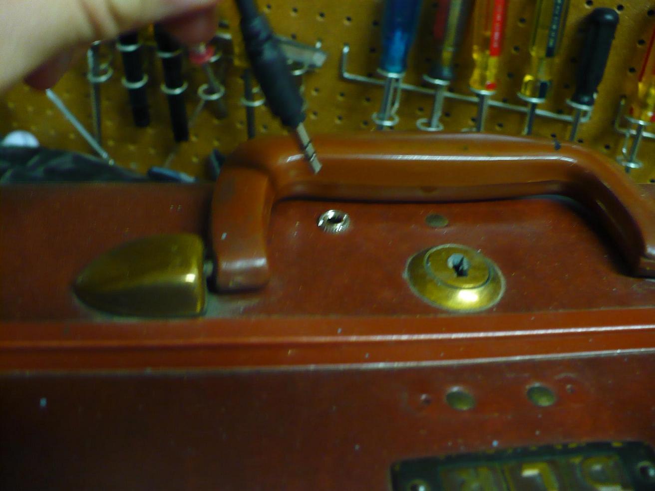

The flush mount input for an iPod cable or any other sort of media device:
[img]https://www.thesamba.com/vw/gallery/pix/686923.jpg[/img]

Pretty fun. And when you go somewhere, you just unplug the cables and most people, unless they really look would never be able to tell. Mine is personally covered with stickers and I didnt use circle designs, I just drilled them in a uniform distance so the entire top just looks like texture. [/img]
