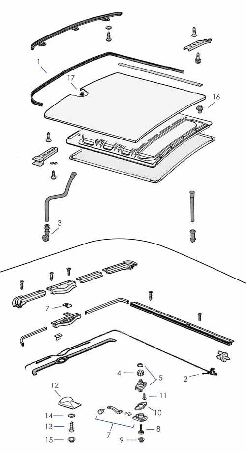

parts fiche:
http://vwbus2.dyndns.org/bulli/michaelk/vw_bus_d/fiche/t208700.html
http://vwbus2.dyndns.org/bulli/michaelk/vw_bus_d/fiche/t208800.html

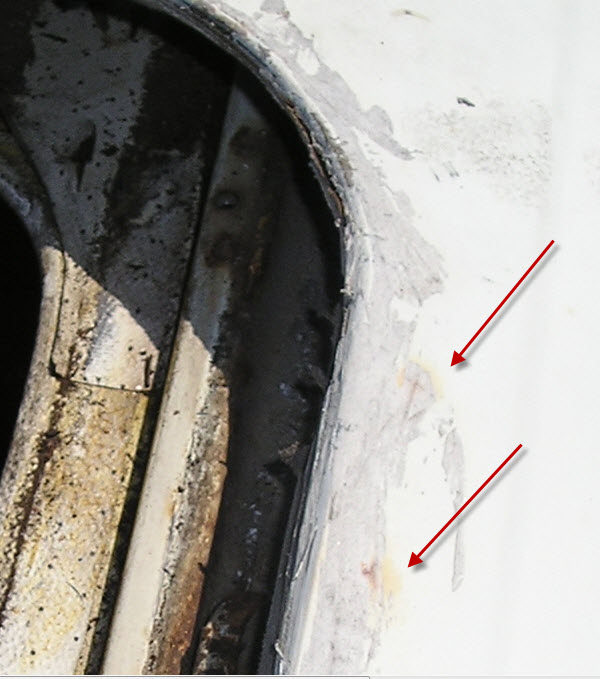

Rust on the top coming from inside:
What it looks like when media blasted:
What it going on:

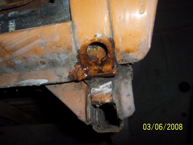

Drains:
Front drain with plastic "valve" removed:

Please keep your eyes open for me at shows etc and let me know if you see any of these. Rewards will be considered.
http://www.thesamba.com/vw/classifieds/detail.php?id=1414756
Plastic parts -
241-877-365 - plastic
241-877-375- plastic
241-877-361- plastic
313-877-366A - plastic

Thanks - it is covered pretty well in Bentley. The issue is finding the 4 pieces of plastic in good enough condition to use as a mold for replacements. I know there are other people who want these. I just wish someone would find a box full of these parts NOS as well as NOS cables and I could stock up. Right now with the NOS cables it works like new. Of course I still have the rust issue inside the top but what can one do. Not going to drill spot welds and remove three layers of top.
SGKent Premium Member
Joined: October 30, 2007
Posts: 42364
Location: at the beach
SGKent is offline
PostPosted: Thu Aug 01, 2013 9:07 am    Post subject: Reply with quote
Good news - Shawn at EIS has been able to repop 3 of the 4 pieces recently. I bought a set today and will report back how they work. I suspect that we have finally found a solution for the sunroof community.
http://www.eisparts.com/241877300.html
Thanks - Steve
