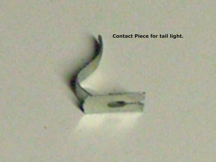

That was easy. I have a doner contact plate and harvested the spring contacts(2) and transfered them to mine. Just pry up the tabs and fish them out/install is the reverse. Then run a jumper to the brake hot and plug into the blank spot on the harness. I used a torch to heat a box cutter blade and cut the lenz plastic to accept the larger bulb. Total time 1 hour Very Happy

I made another set from my doner plate.Who wants them? Posted photos in my gallery.

Did you notice the left and right sides have different pathways? Why would they make 2 different circuit boards? Goofy. I'm on the fence about the ebay sale on the spares I made. I would think you would need the lenzes as well. When you cut the hole for the bulb use a red hot knife to avoid cracking thre plastic.
It was easy wasn't it Very Happy

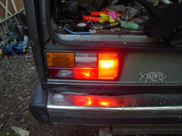

Bill's pictures of the mod:
Donor:
Mod:
End effect:
