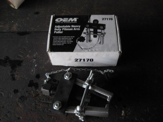

PostPosted: Tue Jul 08, 2014 8:16 am    Post subject: THE tool for pitman arm/drop arm removal Reply with quote
Available for rent at Auto Zone.

PostPosted: Wed Jul 09, 2014 8:43 am    Post subject: Reply with quote
asiab3 wrote:
Interesting, I didn't see that when I rented one last month. I did use this one, and it performed perfectly:
http://www.amazon.com/OEM-25262-Pitman-Arm-Puller/dp/B000CMHKR2
I bought one of those and bent it without budging the pitman arm. Returned it for credit and rented the other one and it did the job.

PostPosted: Wed Jul 09, 2014 8:48 am    Post subject: Reply with quote
Wow! Out of curiosity- what is the chain thing for on the one you got?

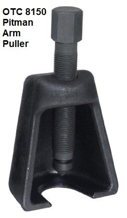

I have a tool just like the second one pictured. Bought it at NAPA.....made in Taiwan. It works percectly......but you MUST follow directions or yes....you will bend it.
This particular tool is not designed to separate taper and spline joints by generating force by turning the screw.....in fact all but the largest straight pullers are not designed to work by screw force.
As the directions note.....tighten the center screw very tight to induce load on the joint....and then strike the center screw sharply with a hammer (about a 3 lb sledge is about best combination of shock and not damaging the puller). Sometimes it takes a whack...and adding another half twist of the center screw....and one more whack......but this tool has never failed to separate any pitman arm it has been able to fit on.
You should pre-treat any very rusty joint....and maybe even heat lightly...300-400F is fine.
This puller works with force and shock....not force alone. I realize that cheap versions of this tool may not come with directions but the one from NAPA and Lisle tools do come with these specific instructions.....all fixed arm pitman arm pullers generally work this way
Not to be confusex with an adjsutable arm puller for removing straight shaft fit and straight spline fit parts like a steering wheel in keyed shaft gear etc. Those simply use screw force. Ray
raygreenwood
Joined: November 24, 2008
Posts: 23136
Location: Oklahoma City
raygreenwood is offline
PostPosted: Wed Jul 09, 2014 9:06 am    Post subject: Reply with quote
Oh...by the way...how do you tell a puller that works by shock as compared to one that works by screw force?
You will notice that the one in the picture has no rotating foot or cup at the end of the screw. It has a sharp point in the center to hold it in tight contact so it wont slip. Thats a dead giveaway that its not designed to be operated by screw force.....but by shock force.
The shock force tool is really designed to seperate morse tapers and other friction fit tapered machine joints.
A tapered, splined pitman joint should be no problem for a tool like this.....if its properly used. Ray

The chain attaches to a cap that will fit over the threaded end of the taper on the steering box. The cap is black and difficult to see in the photo.

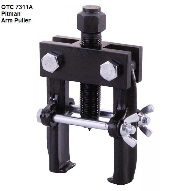

PostPosted: Thu Jul 10, 2014 7:54 am    Post subject: Reply with quote
RG and SG I did all that with all the tools and it never popped. I used penetrating oil, heat, a small hammer and a BFH. After the OG installation 46 years ago and some rust, it finally came loose with the rental tool a fraction of a millimeter at a time. I used a breaker bar with a 2 ft cheater and turned the nut 5* at a time and whacked it with the BFH in between turns. I could see a clean spot slowly appearing on the splines, but it still took brute force and BFW's to loosen it. I applied the force and let it sit overnight in hopes that it would pop, but it took three days to get it off. Without the rental tool, a cheater bar and a BFH it would still be on there.

I've always used one of these from the 1970's. Sounds like a gunshot when it comes loose sometimes but never an issue. Leave the nut on but way loose.
Tom Powell
Joined: December 01, 2005
Posts: 4855
Location: Kaneohe
Tom Powell is offline
PostPosted: Thu Jul 10, 2014 12:55 pm    Post subject: Reply with quote
That was the first tool I used, but the hooks kept slipping up, the arms spread and the hooks let go. The rental tool I used has bolts to keep the arms from spreading and the hooks stay in place.
