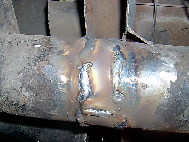

This one shows the crack in the tube, upon closer inspection it went from 2:00 to 10:00 on the tube, not good!

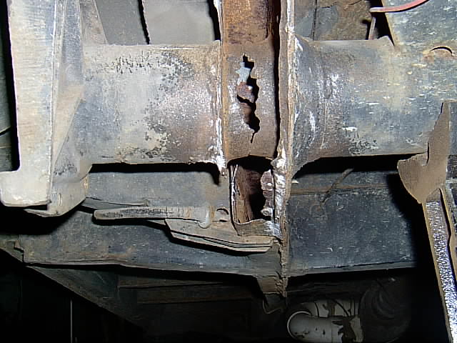

It didn't look that bad from the outside, really, but after being full of dirt, salt and moisture for many years the demons were busy in the dark recesses.
Sorry for the crappy pic but you can make out the crack running up to the top of the tube here:
Keep grinding and cutting, sooner or later you'll hit solid metal and have enough room to work.....here's the rest of the frame coming off the tube, notice the double layers:

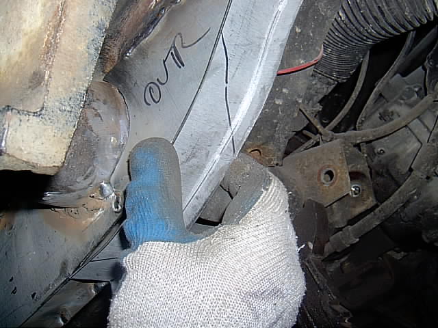

Luckily I had another frame to make templates off, damn that 12 gauge is a bitch to cut. Start by patching the tube and then fitting the frame in sections:
More frame, piece by piece:
Add the reinforcing flange (no razzing on the welds until you've welded satin coat on your back under a bus with an aggravating evil welder Twisted Evil )
Voila! just like brand old! (well better than a big crack and likely to outlast the rest of the truck) Wink
