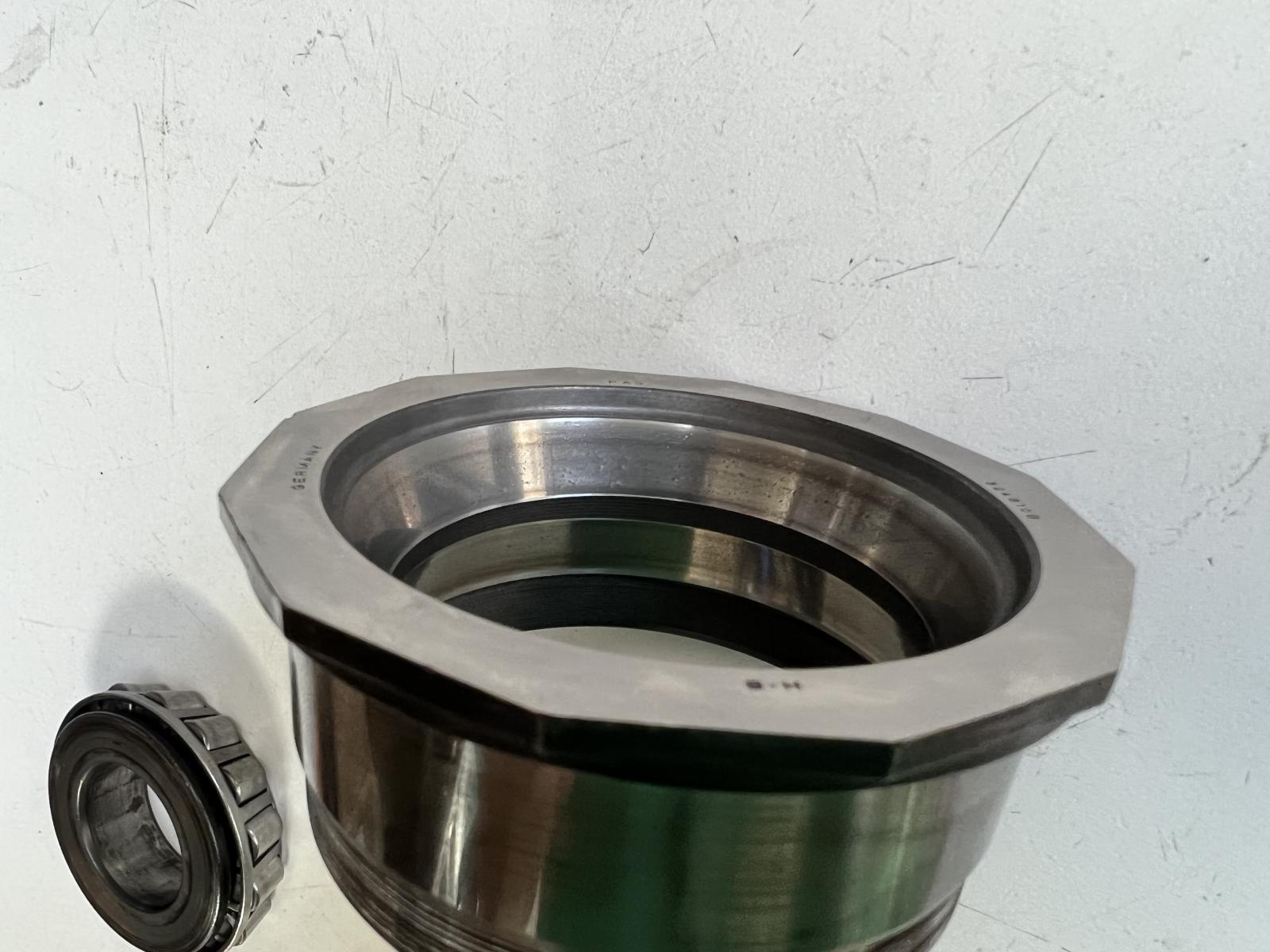

Digging thru used pinion bearings this SKF is a peach.
Unfortunately the nut threads got wasted. Evil or Very Mad
These other two aren’t great but should work.
Scott says that little bits of shit smashed onto the race by the rollers doesn’t mean a bearing is bad.
It’s only when the hardening is going away and the race pits that they’re junk for sure.
Since the slightly better one was OG to this case i decided to run it.

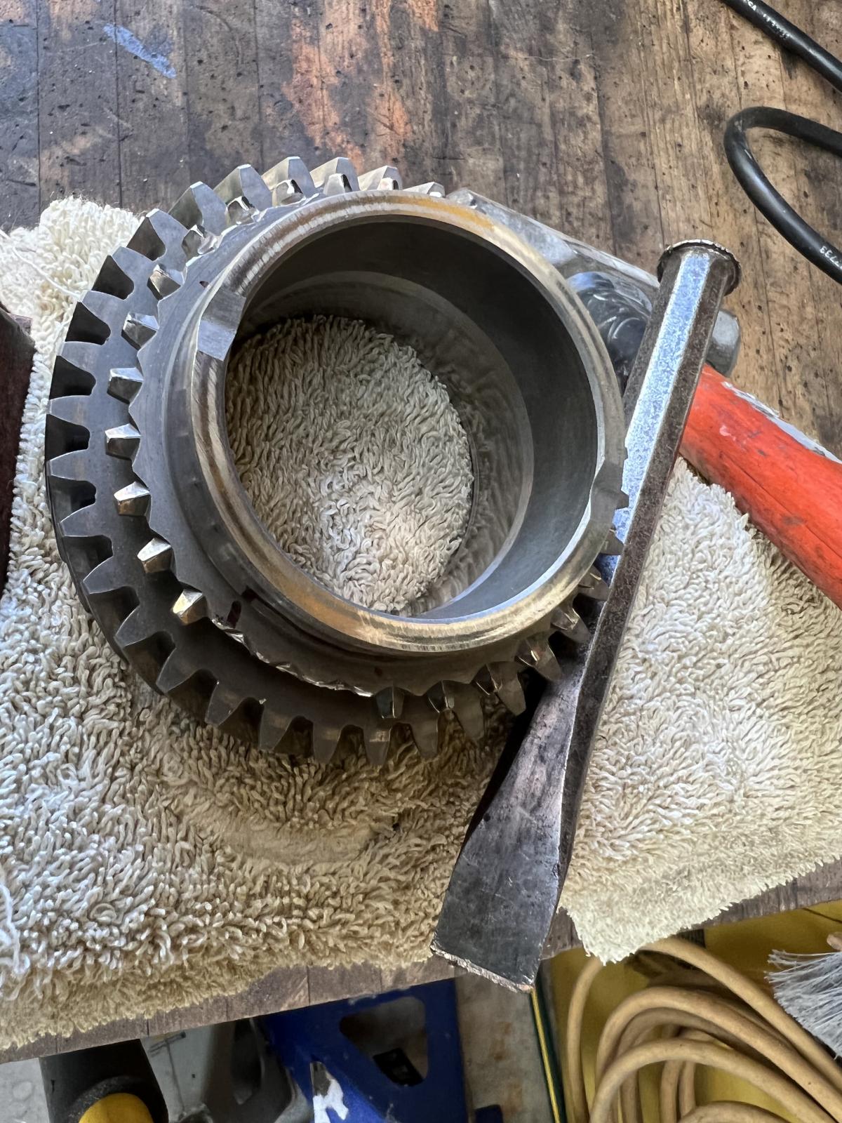

2.06 2nds i have quite a few of,
But still none good enough to keep their teeth.
Trying to knock teeth off like Scott I’m just not enough of a gnarly badass.
Had to give them a head start with a cutoff wheel.
Even with the help they still shot like bullets and gave a flash of light.
Check out how the towel gets smashed.

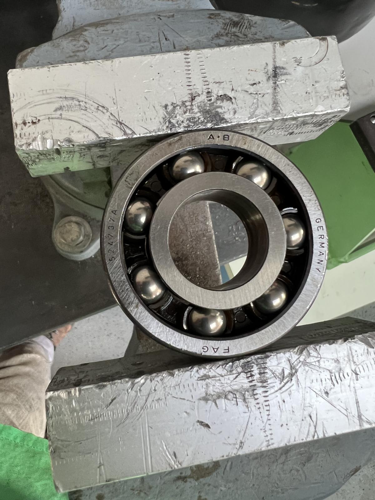

Dug around until i found my best mainshaft bearing.
Did the trick Scott showed me smashing them in a vise to tell how smooth they really are..

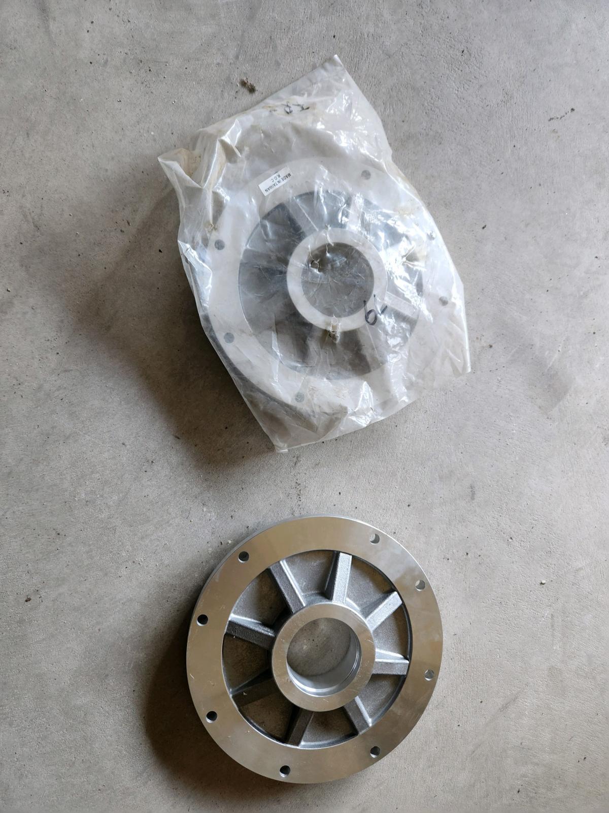

Also since it’s all from different boxes I’m tempted to find a better side cover.
A dual-ring would be sweet but i got none.
There’s a used billet one in the classifieds for 50 bucks that looks cool.
So there it sits.
Could just throw it together with all the used stuff i got here,
But it seems kind of a waste..
I know we need an early 2-bolt nosecone.
Anyone have one to donate?
