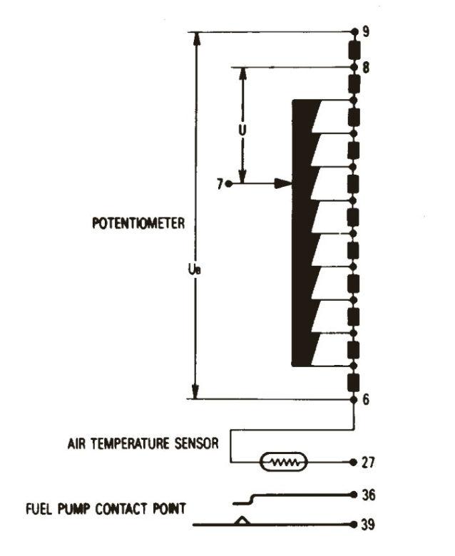

Getting back to this years later....from looking at the previously posted picture...the TS-1 in a type 2 (or even late type 4-412 car)...is wired straight into the variable resistance carbon wiper strip....unless I am looking at this wrong?
If so...its just variable ballast.....which tells me that yes...you could use a manual variable adjustment potentiometer or a handful of resistors. Ray

[...]the TS-1 in a type 2 (or even late type 4-412 car)...is wired straight into the variable resistance carbon wiper strip....unless I am looking at this wrong?
It is wired into terminal #6 of the variable resistance carbon wiper strip but bearing in mind that that terminal is ground too:
As such, I don't think the TS1 affects the output voltage of the wiper. The TS1 might be read by its own separate sensor input on the ECU side.

Yes....it will affect it. Carbon is inductive. If anything with resistance touches the carbon....is connected to....no matter which pole....it affects its response.
I have spent the last year workong on carbon inductive sensors for an automotive safety sensor company......and learned quite a bit. How it affects it and how much? Remains to be seen.....but if its connnected....its connected....and affects it. Ray

The TSI sensor is connected to the common #6 terminal at the plug on the AFM, the #6 terminal is common to the throttle switch as well if I am not mistaken. The wires for the TI sensor don't lay on the resistance strip but run off to the side a bit IIRC. At 5 volts operating voltage for the TSI sensor and a hot resistance of 500 ohms you get an amperage of 0.05 amp which should be steady so there should be nil induction from the TSI sensor. The amp flow through the rheostat shouldn't have very sharp pulses which would lead to much inductive current flow in any other component either, VW certainly didn't bother to use coax to contain it if it is there. Note that Digifant Vanagon AFM did have problems with current fluctuations from the rheostat which became known as Vanagon Syndrome. Additionally in at least some AFMs the two wires for the TSI are twisted together would have the effect of nullifying any inductive currents the wiring for the TSI receives from the rheostat.
In summary any inductive connection between the rheostat and the TSI sensor would have to be extremely minor.

That is at least what I measured to be the ground for the AFM (0V), here too: https://www.thesamba.com/vw/forum/viewtopic.php?t=690922. In any case, it's easy to double-check with a multimeter.
As per the comments on the carbon track being inductive, all resistors have parasitic inductance to some degree.
Since we don't know the circuit that senses the input, we can only guess. This is not an AC or high frequency circuit, so my own guess is that the inductance of the carbon track (or the TS1) is negligible here.

Just a note on any potential oscillation in the signal from the rheostat in the AFM. I independently came up with the idea of adding a 22uf capacitor between the rheostat signal lead and ground nearly thirty years ago to control Vanagon syndrome. Not only did it take care of the Vanagon syndrome, but it smoothed out the idle, so I did the mod on any other Digifant Vanagon I picked up even if it wasn't experiencing Vanagon syndrome. I also did the mod on the Digijet Vanagon I acquired as well, there too it smoothed out the idle.
I am not presently running a bus with L-jet, but if I did I would certainly try adding the 22uf capacitor to its AFM as well. Note to anyone who might try this, the sizing of the capacitor was determined by increasing the capacitors size until it caused a lag in the response of the AFM and then going back a step in size, this gave the 22uf size for the capacitor. If you try a 22uf capacitor in an L-jet system and it causes a lag, then go to a smaller capacitor. For people that have to get their rigs passed emissions adding the capacitor might well improve the emissions both at idle and across the board, YMMV.

Still attempting to troubleshoot the circuit for the TS1. With the main wiring harness attached to the AFM (7-pin since we have a TS1 sensor), removing the harness from the ECU and testing for resistance on pin #27 to see what action we have taking place for this sensor.
Results are? Absolutely nothing.No resistance at the AFM connection nor pin #27 at the ECU end. Tested two different AFM units.
Issues being experienced? The bus from a cold start ONLY is taking 5/6 cranks and starts before the bus will hold an idle. With no resistance within the Pin #27 circuit, there isn’t anything going to nor from the TS1 sensor to the ECU.
This would lead one to believe that there is an issue within the wiring harness from the AFM to the ECU, though every other circuit reads resistance within spec.
Just to verify, you mean no resistance like in zero ohms, or no resistance as the gauge is showing infinite resistance?
