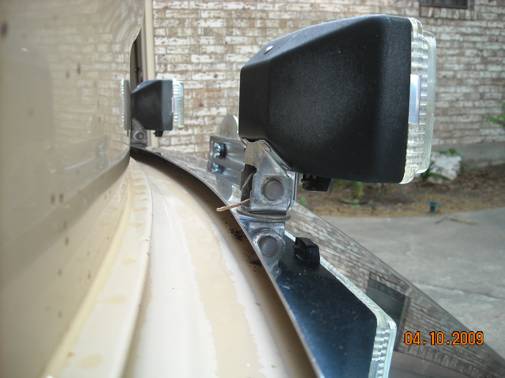

My '79 only has fog/driving lights on the front. This is the only photo I have handy, but if you'll tell me what you want to see I can take some close-ups this weekend. I'm not sure if they're factory original but they do say "Bosch Germany" on them and they appear to have been on my bus a looong time.

As requested, here are the close-ups. They're mounted to holes drilled in the bumper. The toggle switch is mounted to the right of the stock headlight switch. They're also wired to a relay so they only come on when the low beams are on. They go off when I hit the high beams.

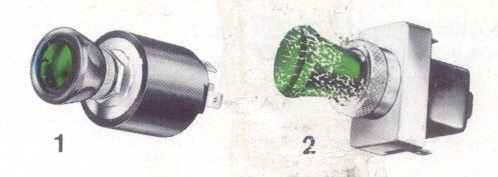

I have seen a pic of the original euro fog light switch. It has a round body behind the dash panel. 4 switch positions:
1 - off
2 - front fog light on
3 - rear fog light on
4 - Both F & R fogs on
If only I could find the pic...

"Here are some fog-light switches, with integral green-lensed warning light, featured in my 1976 vintage, Hella safety-accessories catalogue.
Item No. 1 (Hella part No. 6RE 001 596-001) which features the 1968~79 VW Type 2, switch-knob pattern (i.e. dimpled, truncated cone), is a three-pole switch, with the following functions:
Position 0: All lamps switched off
Position 1: Rear fog-lamps switched on
Position 2: Front fog-lamp switched on
Position 3: Front & rear fog-lamp switched on
Item No. 2 (Hella part No. 6ED 001 566-001), is a general purpose, single-pole switch, with the following functions:
Position 0: Lamps switched off
Position 1: Lamps switched on"
credit to NA Skeet
I prefer the #1 which allows for the separate use of a rear fog to increase visibility to the car behind you in foggy situations
