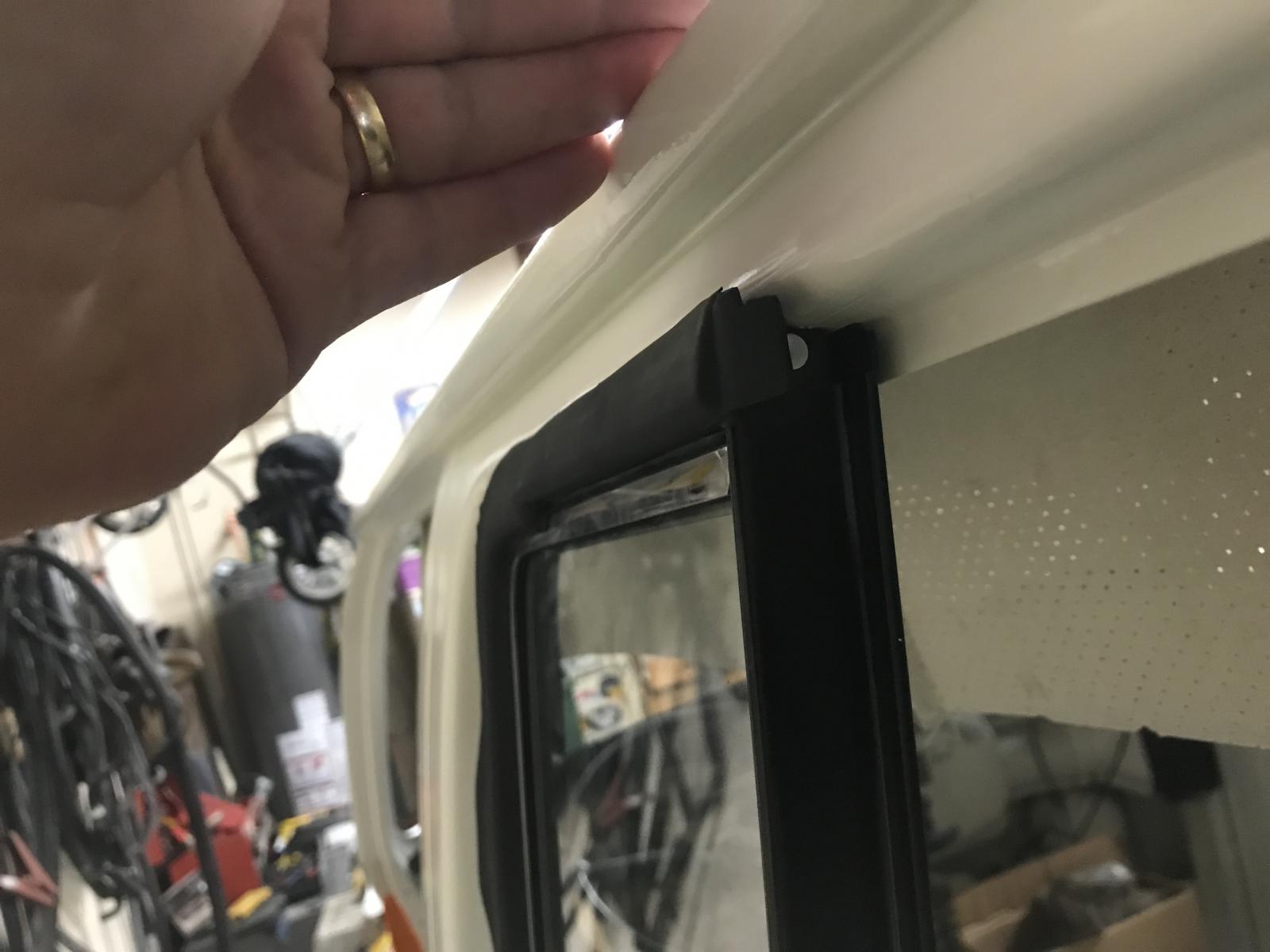

So it seems that the whole frame is pushed in from the outside and the lip of the seal is pulled into place from the inside. I have done that many times on other cars.
However, the pic below with the hand lifting the lip of the seal..... none of my window frames have notches for access to the screw. What is up with that?
They all have notches on the top of the frame tho.

Have the window openings been repaired for rust?, there's usually a notch top and bottom. But now that you bring it up I seem to recall not being able to get at that screw even on virgin buses, luckily it's not hard to pop the window out if it ever needs adjustment.

found the video below. Took a snip at about 1:13. This is a 74 and he has no pinch bolt head access either. seems the btm notch should be a couple inches right of the white bar.

Just put the vent and large window in my `70 slider and indeed NO cut out access at bottom to adjust the vent wing tension. I pondered cutting or drilling a hole but my door is freshly painted and I decided against it for now. I adjusted the screw to good tension and installed it.
Checked my 71 parts bus and no access in that either.
Glad to hear I am not the only one with this odd issue.
