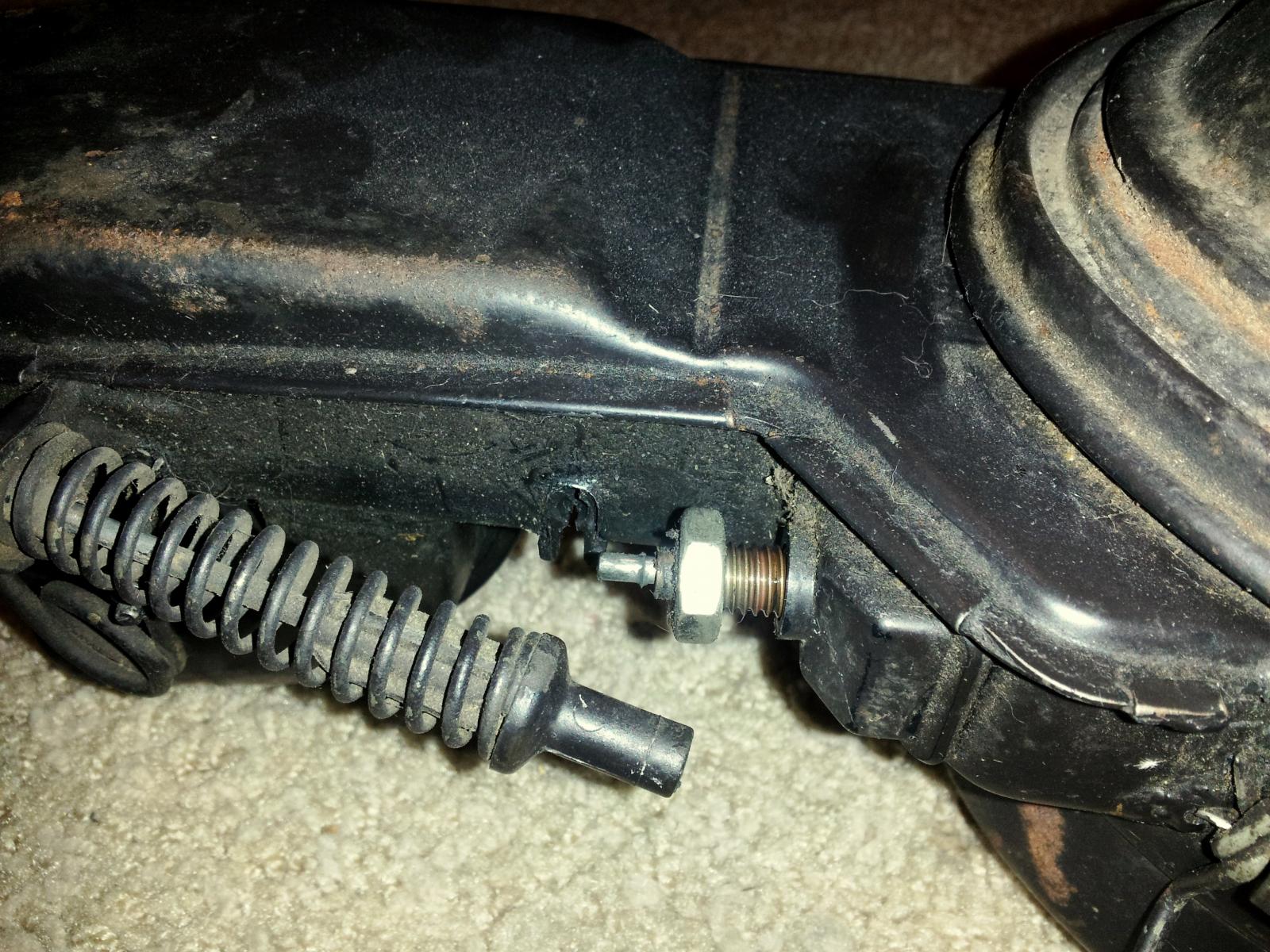

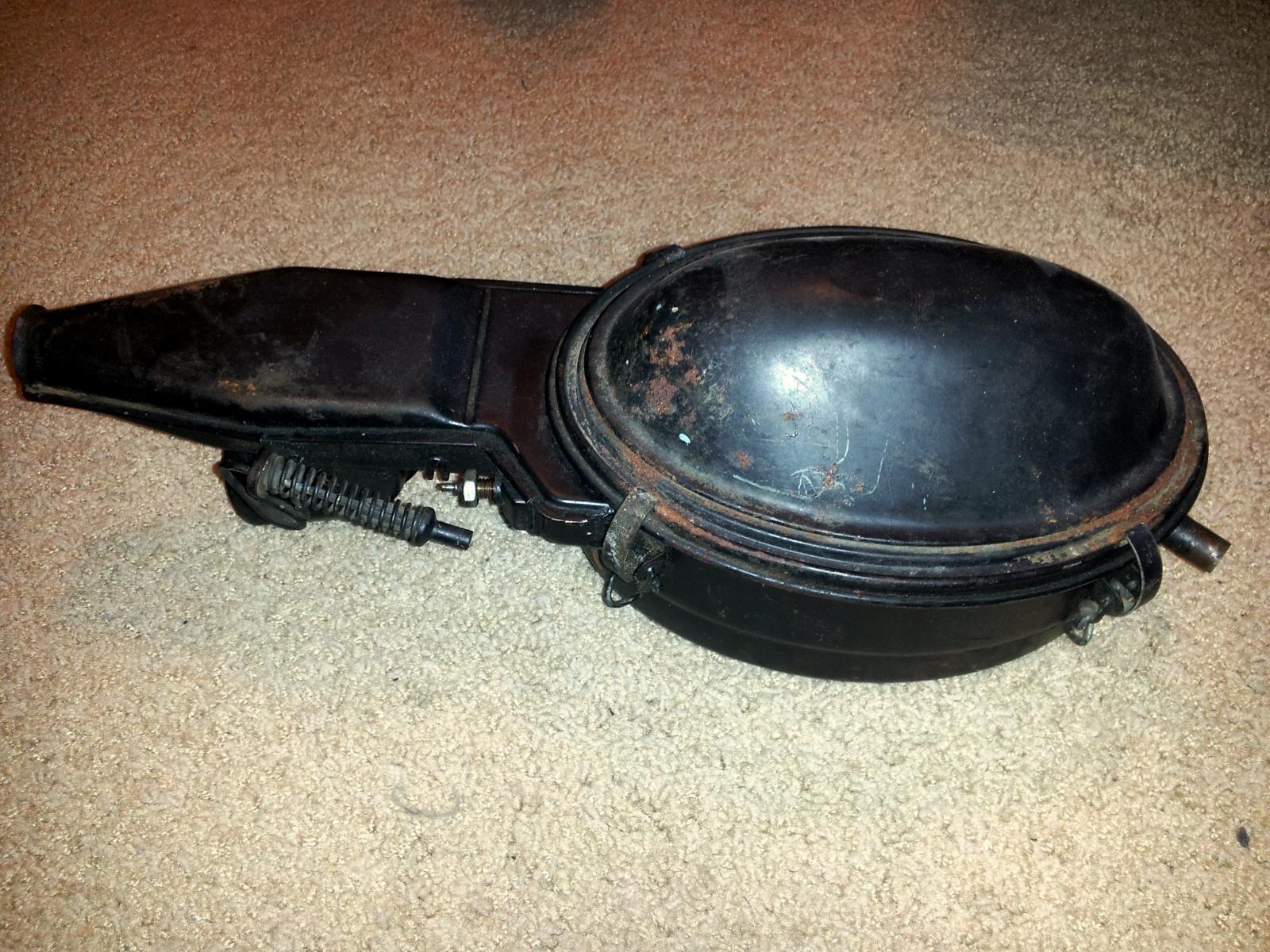

Well I'll be damned--
several months back I was looking for the original oil bath air cleaner for my 69- and I bought a 71 cleaner locally without realizing it was the wrong one.
I just looked and sure enough it still has the wax thermostat installed!
What are the odds of that
Surprised

Haha...The odds of it WORKING is what you're up against. Bend the spring back and seat that black plastic piece onto the end of the stat. Stuff a hair dryer in the bottom snout and in about a minute you should see the rod start to expand out. If it does you're in business, no Bowden tube and linkage hunting! Just stat hunting! haha. You can screw the stat in and out and lock it in place with that nut you see in your picture. There's no clear instructions I've found anywhere that show how to adjust it, I just played around with mine using a flashlight down the snout to make sure the flap closed fully with hot air running through. There are a couple of threads here discussing the adjustment if one wants to search for them, but nothing official.

PostPosted: Fri Jan 10, 2014 5:28 pm    Post subject: Reply with quote
You were correct sir- my thermostat is a no go! Smile
