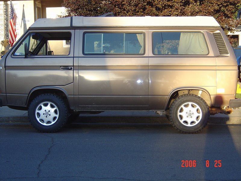

I picked up these wheels yesterday from the local Pick Your Part (50% off day...thanks for the info Lanval) for $90. I yanked them off of a Mercedes 450 SEL. The wheel is a 15"x7" ET 25 (or ET 23 I forgot to right it down...too excited to mount them). They mounted up with the stock lugs and bolts. The rear nuts mounted with 6 1/2 to 7 turns on the thread and the front bolts with 2 1/2 to 3 turns on the threads (I know this is not enough, I just wanted to see what they looked like mounted!!!) They seem to clear the control arms and sit a little further out than the stock 14'ers. I've picked through the 11 page ULTIMATE WHEEL POST but still have a few questions...
(1.) Is the taper on the mercedes wheel the same as the vanagon nuts? Is 6 1/2 turns on the threads enough?
(2.) Because of the ET being 25 will I have a positive scrub radius? Should I worry? Can I do anything to change the offset?
(3.) The original lug nuts off the mercedes had a two step lug because the hole in the wheel is so deep. Can I just use normal lug bolts and stick the socket deeper in the wheel?
(4.) Are there any other concerns with this wheel?
(5) I don't really like the polished look...too much bling bling for me...I remember reading a post a while back about painting your rims. James (Dogpilot) and some others had some good tips on painting wheels but I can't find that post when using the search. Any suggestions on removing the polish and painting these wheels? I'm thinking Black or a Gunmetal grey.
Any and all suggestions are very much appreciated!...And now some pictures!

Nice score on the wheels! They sure look better than the stockers.
I could be wrong but I think those wheels have a tapered seat (like the Vanagon alloy wheels) instead of a ball seat like the Vanagon steel wheels. If in fact they are tapered, I think Van-Cafe sells a set of lug nuts and bolts for something like $40. I think 6.5 turns is fine. If you are using the ball seat lug nuts and the wheels are tapered, you may find that you will get an extra .5-1.0 turn out of it with the proper nut installed.
Yes, you will have some pos. scrub radius. Should you worry about it and can you do anything about it? Not really and no. The main result of added scrub radius is that it will be harder to steer. If you an live with that, your fine. Tire wear will increase ever so slightly but not enough to worry about or even notice really.
Yep!
Other than the not-quite-perfect offset, which you can't really do anything about anyway, no!
Are they polished or chrome? If they are polished, sand them down with 400 grit sandpaper and wash them with a an aluminum prep solution which can be purchased ant any autobody supply store. A quick shot of primer and paint and your good to go. If the are chrome, It will be harder to get paint to stick to it. A light sandblasting followed by shot of zinc chromate primer will be about the best you can do for adhesion.

All OEM Mercedes-Benz wheels use a ball seat. All MB OE Benz wheels will hava a Mercedes logo of some sort and a part number on the back some where. Most part numbers will start with an A followed by ten digit number. Some accessory wheels might have a B followed by an eight digit number. AMG wheels may have either or evan a H WA and a ten digit number.
Vanagon alloys use a taper or cone seat, Vanagon steels use a ball seat.
Aftermarket Benz style wheels may have either a ball or taper seat.
Use the CORRECT style bolts to match your wheels or they will come off or as dumb as it may sound, get so tight you will break them when you try to remove them later.
The older style Benz wheel bolts had a long shoulder that were prone to breaking and corroding and have been replaced by bolts with shorter shoulders.
Also make sure the bolts thread into the hub at least as far as they are wide. Same for the nuts on the back. Make sure the studs are long enough for the nut to thread on completely without bottoming out.
It is a good ides to keep a set of VW bolts and nuts in your Vanagon that fit the spare you are carrying. Nothing sucks worse that getting a flat and not being able to put your spare on because the bolts that hold on your fancy wheels that are too long!!

I put the same style Mercedes wheels on my 84 Westy, same Assaun Braun color too. My wheels came from a 1995 C220, 15", ET of 37. I had a machine shop bore out the holes to 14 mm, and then ordered new wheel bolts from an import parts supplier. The front bolts are from a Mercedes S Class 140, part number 140 400 01 70. The rear wheel studs came from a Porsche 944, part number 901 331 671 01, which were too long, but better long than short, so I had the machine shop cut the length back to 60 mm. Wheels don't rub, and I put a meaty tire on Nankang (Big O) 215/75/15 LT, I love it. Good luck.
