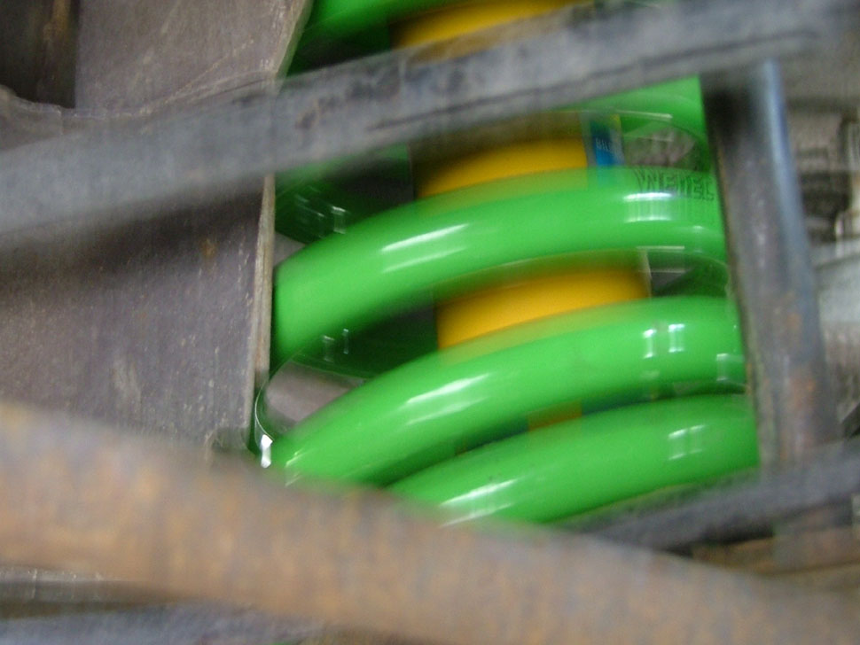

Weitec Sportfahrwerk springs
Measured from ground to underside of fender lip, full tank of petrol.
Front passenger side 26.125"
Front drivers side 25.5"
Rear passenger side 27.25"
Rear drivers side 26.625"
Measured from center of wheel to underside of fender lip, full tank of petrol, as suggested by PDXWesty (I was wiggling, had to take leak, so these aren't 'puurfect').
Front passenger side 14"
Front drivers side 13.5"
Rear passenger side 15"
Rear drivers side 14.325"
So, I've still got an "issue" with regards to ride height. Most notably the drivers front side is lower than the passenger side front by .0.625"??? The Westy lean is still haunting me, Grrrr. With this my SA front mud flap sometimes touches down on rallye style bumps Smile. Not really sure how to proceed on this. I guess I'll get it aligned, and then try equaling the ride height the best I can with spacers, and then get a re-alignment.
Install notes
To install the Weitec springs you will need to remove your front shocks and unbolt the top a-arm ball joint with the two allen bolts. I purchased the Weitec springs from Van-cafe. It was suggested that you don't need to shorten the bump stops but the H&R springs are also a 45mm drop and you NEED to shorten the bump stops with these, so I'm not so sure what's up with this. I went ahead and cut my bumps stops down by 2 rings. Basically, you cut off the dust cover and 2 rings, leaving one ring and the top rubber bump stop. It all went back together very well.
Boing, boing, boing - Weitec Sportfahrwerk spring num-num
There is a good write up on the springs here >> http://www.brick-yard.co.uk/VehicleSpecific/T3/info/mods/lowering/lowering.htm
I used a spring compressor on all four springs, just made it much more comfortable for me doing the job solo in my garage. I also removed the rear tires to help. The springs were so much more accessible with the tires off. I started at 8:30am and finished up at 2:30. Wasn't a real big pain-in-the-arse, but required motivation to finish.
Driving notes
I've had Bilstein HD shocks installed for the last 6k miles with stock alloys and Conti Vanco 185/70-14s. The Bilstein HDs alone was a huge improvement. Then I upgraded to the Porsche alloys and really nice Nokian WR Finnish made tires. This made for a more comfortable ride, but with loads of suspension travel. Side note: IMO, the D load range on the Conti's was just too severe and you felt it in the charssis and your arssy Smile, even at lowered tire psi.
With the Weitec's, Bilstein HDs and the 17' 98XL load range Nokian WR tires the ride is much more controlled now. The front of the Westfalia is a lot lower and you immediately notice this when opening the door. Mucho easier to get in and out of. Typical Vanagon nose dive and bounce under braking is drastically reduced. When you get on the binders, the front springs are already somewhat compressed from being lowered and this adds to the better stopping feel because the suspension doesn't have to compress and then brake. Bumps and pavement transitions need to be handled with this in mind. You will feel larger bumps and transitions because it is lower, but it still drives very smoothly over all bumps. Very nice. Another plus is taking off from a stop, when you let off the brakes the front doesn't skyrocket up either. Handling around corners is actually fun now rather than nail biting*. Driving with a head wind prior to lowering used to make me nuts. All kinds of wind would go UNDER the Westfalia and create all kinds of disturbances - upsetting and buffeting you around. Now, with the front raked down you can actually drive in a head or side wind without the buffeting feel as before and as a plus you can see more out the rear view mirror!
Set up as a sport suspension with proper tuned sport shocks, the overall handling is now far better suited for emergency braking, steering and driving around corners because of tighter spring rates and lower center of gravity. It just feels safer to drive.
*Note: I removed my Gary Lee basket roof rack to service my Westfalia in my garage and this might have something to do with the "nail biting" feel and lean while turning in corners. I'll re-install the roof rack and post notes afterwards.

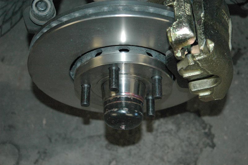

2. Just today, I started with my Van-Cafe big brake kit swap. Ran into a little snag with the H&R adaptors not fitting over the hubs Confused ooOOoo krickey! And double ooOOoo krickey, my stock 14" wheels w/Conti Vancos won't fit over the big brake kit!! stuck on the lift fursur.
(on the good side, the new Van-Cafe big brake kit is a lot bigger and looks to be a nice upgrade).
INSTALL NOTE
The supplied hubs (which I think are SA ones) have a taper to them and start at around 60.1mm then get larger towards the center where the rotor sits flush against. Stock front brakes, the hub is 60.1mm all the way to the center. Sooooo, the H&R front adaptors need to be shipped out to our machine shop to get opened up to fit.
See photos.
You can see the taper here with the Van-Cafe hub.
The new Van-Cafe big brake kit hub with rotor and H&R 25mm adaptor for Porsche wheels only goes this far on. Needs machining open.
Impressive big-brake kit! Looks like da kine, now all I need is to get the H&R adaptors and my Porsche wheels back on. Stay tuned for more!

I just received the H&R front 25mm adaptors back from machining open to fit the SA tapered hubs. Fit perfect. There is a load of clearance between the rim, the big brake kit and upper a-arm and suspension components.
Pads still need bedding in but feel really good. I just had time to bleed the front calipers and will get after the rears this week. Good pedal pressure and stops with authority and confidence.
Stock brakes, H&R 25mm adaptors before shot.
Mmmm SA big brakes and Porsche rim num-num
No clearance issues
