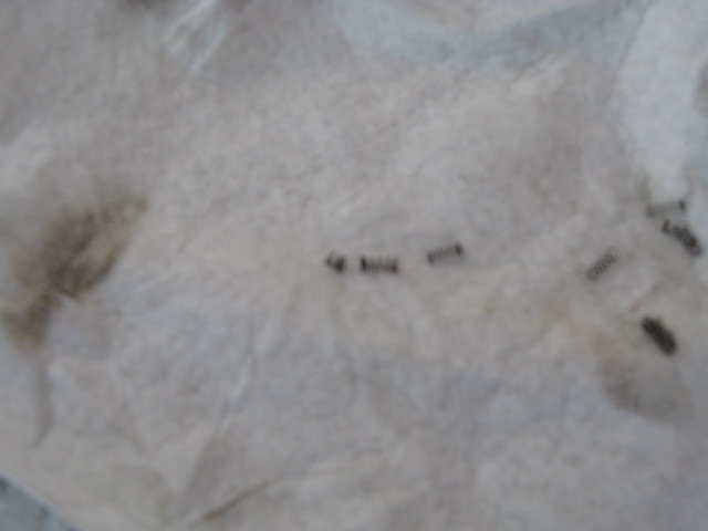

This is ironic. I was coming on here to report about my power locks. Here are some pics.
https://www.thesamba.com/vw/gallery/pix/791982.jpg
https://www.thesamba.com/vw/gallery/pix/791981.jpg
https://www.thesamba.com/vw/gallery/pix/791983.jpg
https://www.thesamba.com/vw/gallery/pix/791980.jpg
These pics are of the little springs for a set of contacts that slide up and down. I disassembled my actuators(very simple to do). They were corroded but no broken contacts. But the springs were broke. I bench tested the motors and they checked good. Cleaned up the actuator and went to the hardware store and found replacement springs. I was surprised they had the exact same size. The lady even gave them to me. So those little springs just saved me a lot of $$$$$ not having to buy new actuators. So I reassembled the actuators and bench tested. I reinstalled them into my van and the tested the drivers door first and nothing. Crying or Very sad Tested the passenger door and both the drivers and passenger door would lock and unlock with no problem. Checked voltage and 12v present at the red wire on the passenger side and no 12v on the driver. So I dropped the fuse box and checked wiring at the drivers side. Sure enough the red wire was broken inside the boot. So tommorrow I have to run a new wire. I will report when I get them all working. What I have to say to the OP is dig into and start investigating. It is pretty simple and it is also kind of fun trying to figure it out. I wouldn't blow any money on new actuators if you like tinkering just tear them apart and clean them up. There isn't much to them. Good luck.
