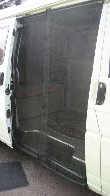

Screen door picked up from Amazon for $11 modified a bit,works great. Rolled up for storage
[img]
It's attached at the top by velco tabs at the backside of the awning.

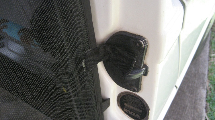

I had to modify to fix around the door hinge,cut and sewed/glued with strapping and velco to keep closed.
[img]

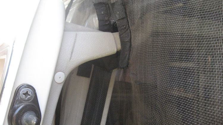

I sewed on some extra tabs w/velco to keep a tight fit. They use a magnet to keep the 2 flaps closed,easy in an out.
[/img]

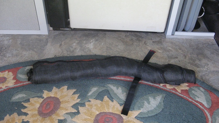

Had to shorten the screen,it's made to fit a regular door. I also got rid of the sand weight at the bottom and used old bicycle tire intertube filled with sand to keep it from flapping around here in windy Hawaii,works great BTW.
[img]
When not need rolled up and stowed on top of awning,just roll down when needed,can even close/lock door while off hiking.
[/img]

So I had some time to finish up the screen. Here is the final result. I’m very pleased. Total cost in the end was about 25 bucks and 2 hours of my time.
Pluses:
- you don’t need to drill into your Westy and deal with broken snaps
- Velcro peals off clean. replacement Velcro is cheap and easy
- Cheap, Cheap, Cheap easy to do Smile
- quiet entry at night (no zipper)
- hands free operation. nice for egress with hands full
- always stays shut. bonus for kids going in and out forgetting to zip up
- rolls up nice and small ( fold at the panel joint then roll)
- super light weight
- Takes about a minute to install, and 30 seconds to remove carefully.
Minus:
- Not a professional look, but it doesn’t look bad overall. If your not looking closely at the edges its a quite clean overall look.
- Can't close the door with it installed.... On the Vanagon its all gotta come down. ( takes about 30 seconds to remove)
Here is how I worked around the door hinge. A little finesse with scissors and the sail tape... To square off the edges clean, I cut the strips of sail tape to length and put a little slit in the ends ( directly on the center fold line) then folded the tape over the screen mesh onto itself.. Overlap the tape in the corners this way… The tape sticks to itself through the screen mesh. Its very strong adhesive on the tape, no glue required here… The little flap is also just sail tape folded on itself.
The Velcro attachment points are crucial to a good seal. Especially the front bottom point. Notice it’s almost inside the Van. Otherwise a small gap will exist for bugs to get in. The door seal actually acts as a great contact point for the screen making a bug tight seal. Yes my next project is to clean up the rust on the bottom door guide Embarassed
Nice big strip of Velcro at the center. And a big strip above the door hinge to hold the loose flap of screen. I used all the screens factory female attachment points.
