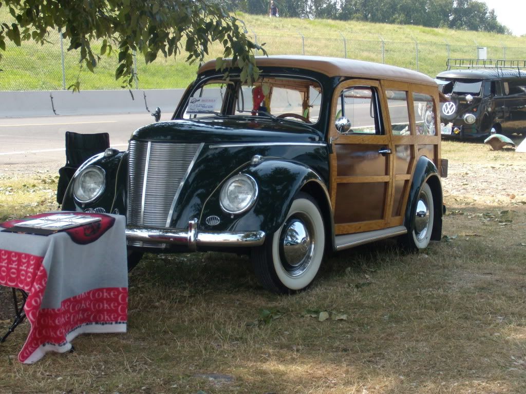

Some guy around here in the Portland/Vancouver area built his own on a bug. I saw it last week at the informal Portland Transmission show (AKA Portland Tranny---this thread getting really weird with Trannys and woodies!)
I think it's this one (this pic from a few years ago at the Bug In at PIR):
You might be able to get a hold of the owner if you contact Portland Transmissions, they had a log of all the cars there with names associated with the car...you might be able to contact the guy and maybe he has some plans or something.
Good luck.

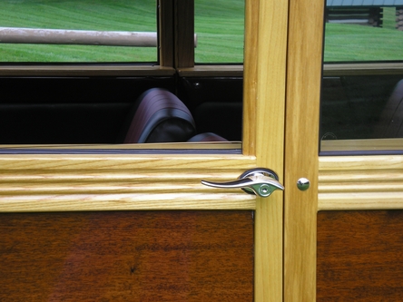

OK - a little background on woodies. There is no right or wrong as far as the wood goes. Real woodies had been made by a large number of firms either for a "factory" produced car or a custom car. The framing is USUALLY light, with dark panels, but they have been made with dark framing with light panels, done all light and all dark.
As far as wood for the framing, ash seems to be the most common. Real nice to work with and amazingly flexible. Maple and oak are also fairly common framing materials, but both have their drawbacks - I wouldnt use either. Mahogany is the most common wood used for the panels, but I have seen birch and maple. Here's the issue though - usually done with plywood panels and you will have 1/8 to 1/4" of thinckness to deal with.
3M Di-Noc is what was used on newer cars (50's on up) with wood, fiberglass or plastic framing. See this http://www.vinylgraphics.net/products/216-Wood-Grain-Vinyl/
If I was going to do panels like the kit mentioned, I would make my framing from ash - doesnt have to be real thick - 1/2" would be plenty. Stain it the color of choice if desired and use marine varnish. Put down the D-Noc and attach the frame. You have a couple ways to shape the frame to the car. Cut it to fit, steam bend it or just bend it when installing. If bending it when installing, you would need strong attachement, like carriage bolts. Would be a bitch attaching the lower front quarter, but the rest would be pretty easy. If the frame is steam bent or cut to fit, you could just glue it on.
Sorry for the book, but I have been down this road....

No problem, any advice or suggestions are greatly appreciated. I have no intention off forking out the $1500 quoted and are just toying with the idea so any input is helpful. I had already looked at the 3M vinyl though I haven't found anywhere in the UK that sells it on the internet.
Not being a master wood worker or carpenter, the method of bending the right shape framing members to fit the shape of the body panel sounds the easiest. What size fixing would you suggest and how would you make them discreet or would you simply plug the hole with a piece of wooden dowl?
andk5591
Joined: August 29, 2005
Posts: 16820
Location: State College, PA
andk5591 is offline
PostPosted: Fri May 18, 2012 11:51 am    Post subject: Reply with quote
Theres a couple aproaches to attaching. You can try to hide the fasteners or embelish them. I used 5/16 stainless steel carriage bolts that I polished on a lath. However on my doors, most of my fastening was done using sheet metal or wood screws from inside the door. BUT to keep the look consistent, I just cut the heads off of some of my polished bolts and glued them to the wood.
This is a "real" fastener on my B pillar
and you could carry the look over to the dash - I used 1/4" (I think) bolts for this.
