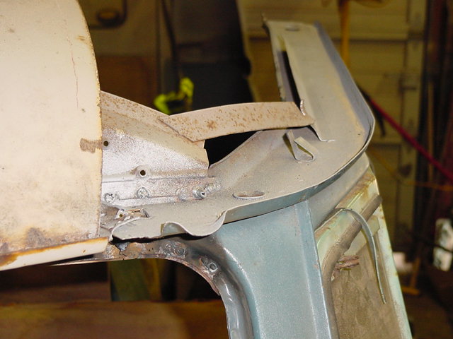

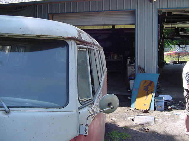

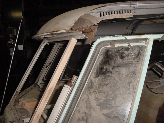

Body over the driver door was so bad that rain had no problem leaking in. Top of the "A" pillar was bent (see vertical rust line where bent) and top of the pillar bulged upward pushing open the seam between the pillar top and the underside of the over hang. DPO tried to silicon the gap closed.
So off to Eastern Washington for a donor roof from a 1965 kombi.
Fitted good used door to better check door opening fit. Turned out the belt line just behind the door was bent in about 2"! Door would barely latch on the first notch of the striker plate.
Removed the side windows.

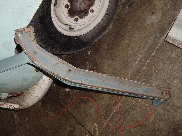

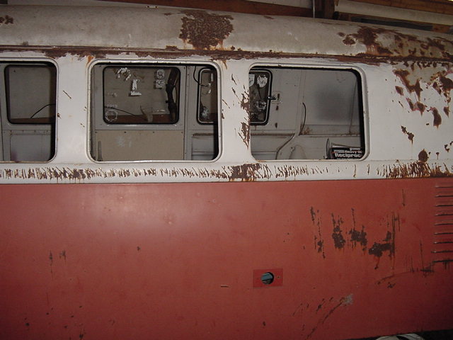

You can really see how much the belt line and rain gutter was pushed in.

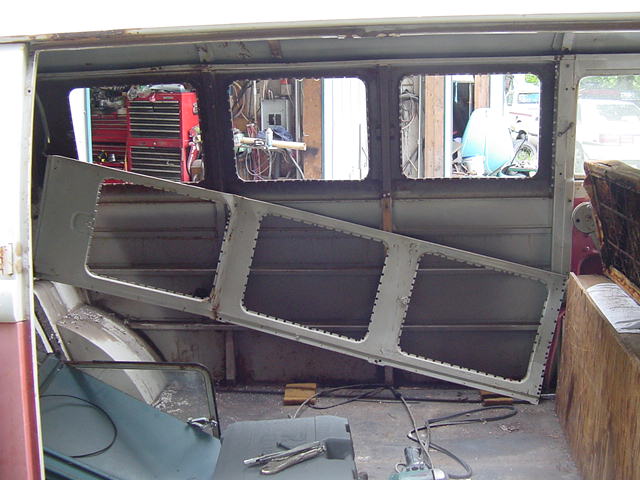

Took out the inner panel that was bent up from being pushed inward against the cabinets.

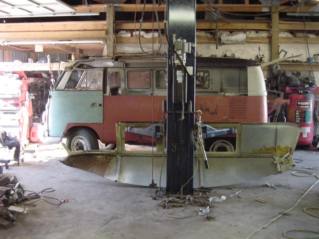

Then cut off the roof and cut down the donor section to be worked in.
Removed upper rear corner off the donor roof, and convert to the earlier small hatch rear.

This had a Westie roof rack when it was rolled over on its side, and still shows some gutter damage from where it sat.
Unfortunately the donor roof had had a leak in the LF of the roof so the roof top had rust and the body frame over and down around the driver door was rusted out. This did not show up till the donor roof was cut down to size.

You can see the rust in the LF donor section in the image in last post with the side bus shot with roof cut off.

Interesting joint from the door frame section with overlap from the panel behind the door. This was leaded over at the factory.
Fitted the top door frame to the new roof section. Have been applying phosphoric acid to the rusty part of the roof section for two days till it all drys out in the cool weather we are having. Then wire wheel off the coating and down to the newly exposed rust layer, and repeat with the acid and wire wheeling steps till the rust is completely gone.
Meanwhile cut out the upper left corner of the windshield frame.

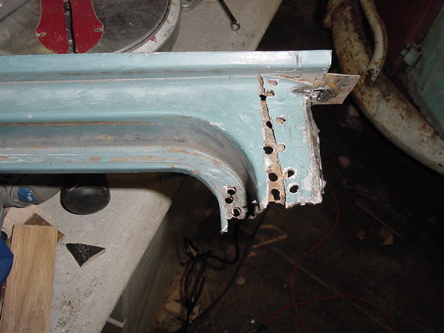

Was able to drill out the spot welds in the panel the sun visor screws to and the lap joint the over hang has on the left side. The wood piece is keeping the top window opening from sagging down.
This before image shows the bent damage in this are pretty well.
Here is the "B" pillar stripped down at the top, ready for the donor over the driver door body section.

With the roof cut open, the cupped sheet metal form of the roof is not self supporting causing the weight of the remains of the roof to push the rear hatch outward on the left rear side. Compensated this with a ratchet tie down strap run from the driver outside seat belt mount and out the left side of the rear hatch. With a couple of 4x4s used to anchor the tie down against the rear of the hatch and hatch opening.

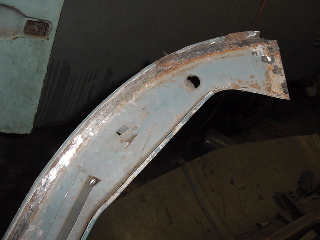

Unlike the "B" pillar, there is three layers of sheet metal in the "A" pillars up around the windshields.
What is the third layer? I can only see two. I don't see tar anywhere in the previous shop pictures.
