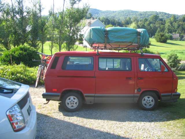

Not a good shot of the rack, but it hauls a bunch !!
Yakamia towers & cross bars, w/a Bekowa 1/2 rack bolted to the cross bars. The Bekowa was bolted to a ladys Chevy van, I asked her to contact me when she was going to sell the van, a year later & $ 50 I had a sweet ( legless) Bekowa.
