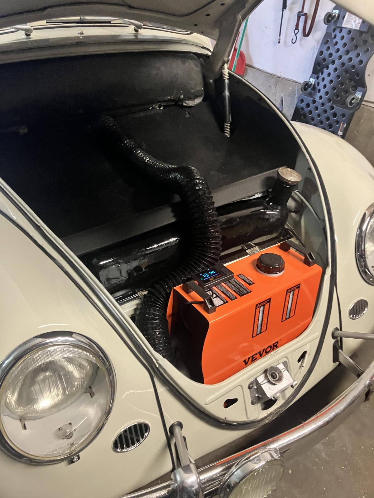

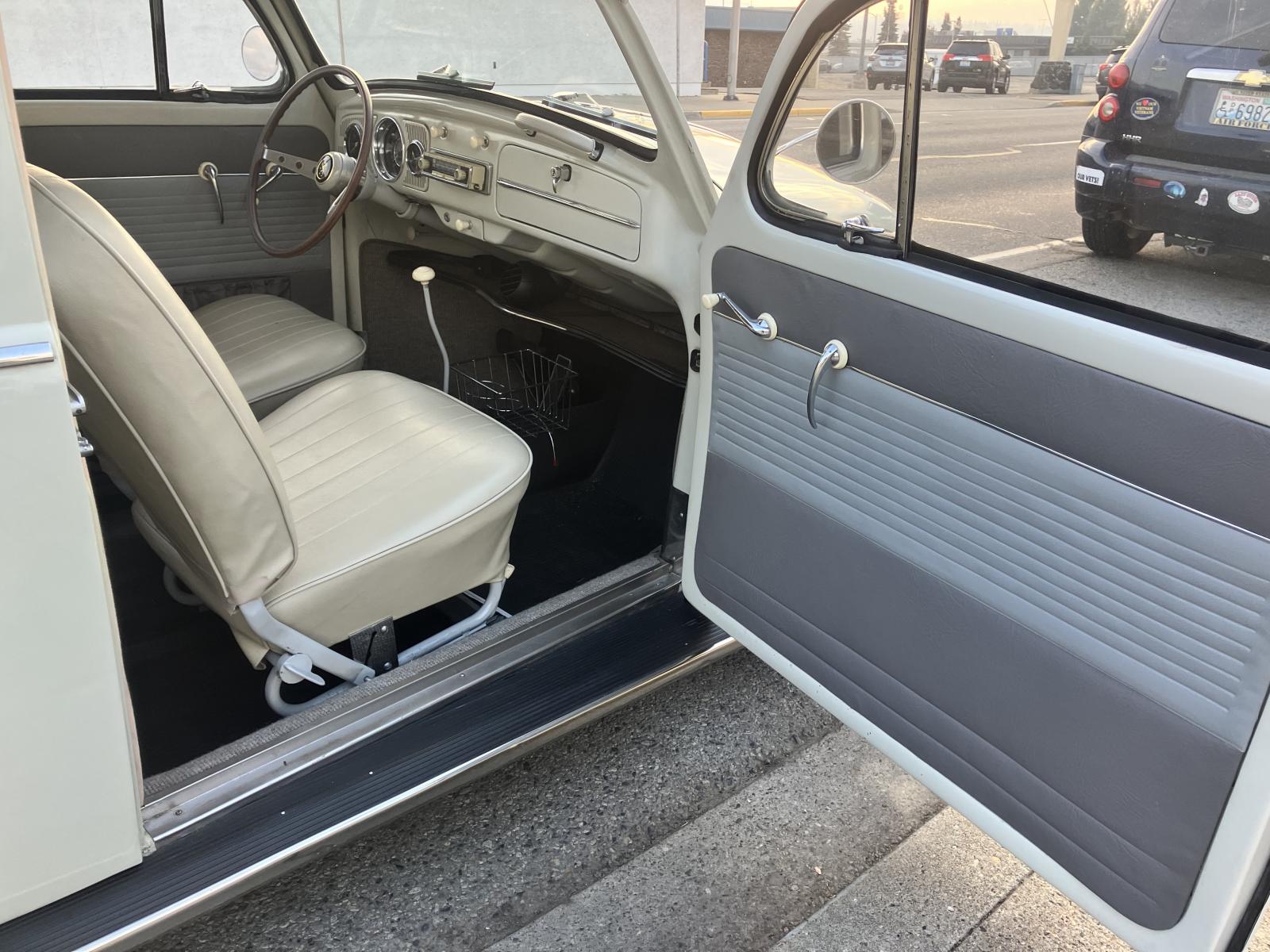

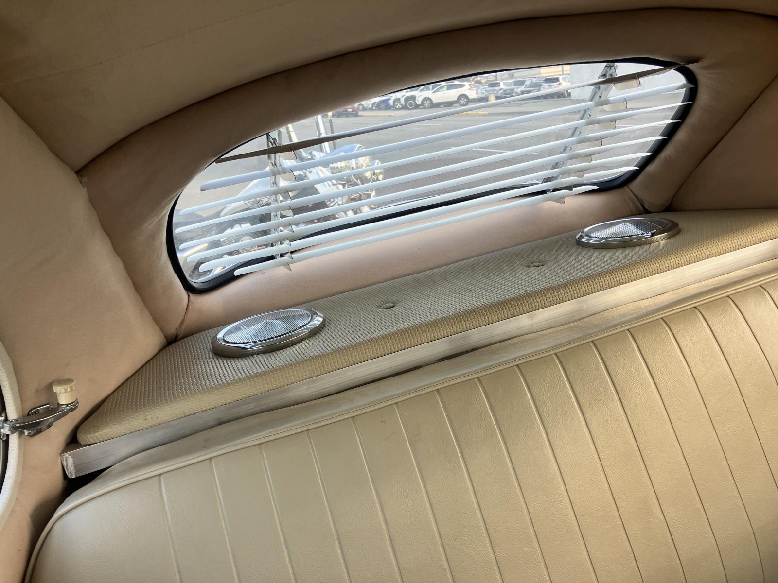

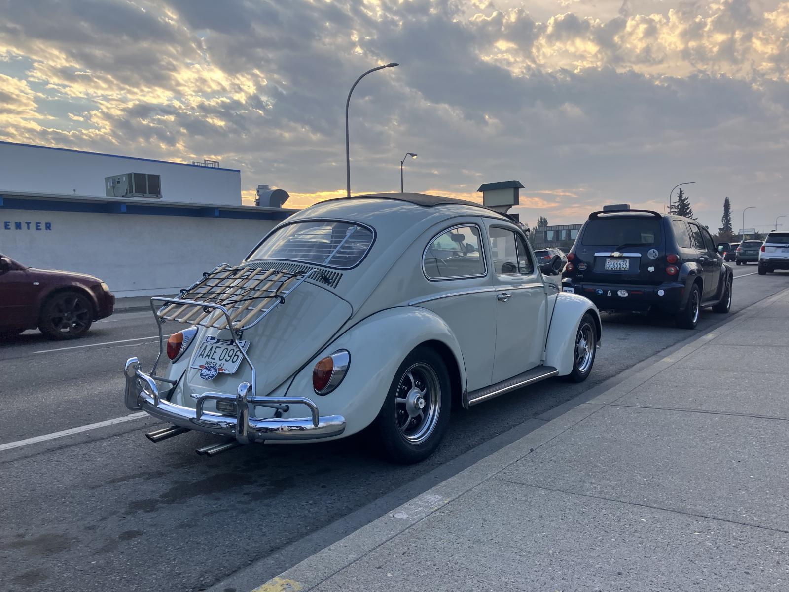

Haven't updated this in a while...but been working away as much as I can.
Won't bore you with a narrative of every hassle..but it's getting there.
Short story:
First car I've ever done myself from the ground up..I mean, sort of. I sort of did a 60' 356 25 years ago when I was a kid. Now that I think about it, that counts I guess.
But on this thing I had to cut most of the bottom 4" off to replace.
YOu get the idea of how I want to finish it I guess. I have a few cool accessories- Pull out Blaupunkt, Motest triple gauge, Kamei parcel tray, HULs recliner for driver seat, Tilt-a seat of passenger. Oddball but proper 60's steering wheel....old empi chrome tail lights housings, LED replacements everywhere I could manage
Engine is a 'whatever' I scrounged 1680cc w/ big valve heads, Andrig fan.
I'm not trying to fool anyone, I did some fairly dodgy repairs on this thing, it was a bit worse than I hoped and I'm not great with body work, but I did manage to keep the filler to a bare minimum.
I painted it out in the backyard..though it's not bad.I did start to get in a bit of a rush though and should have took a break during primer and sanded and re-primed once or twice for best results.
I didn't, and..I suppose it shows in a few spots. I think it is fine overall though- most of the parts on this car are what I could scrounge and salvage, and they're refinsihed with paint I can get at the store easily- for future touch ups.

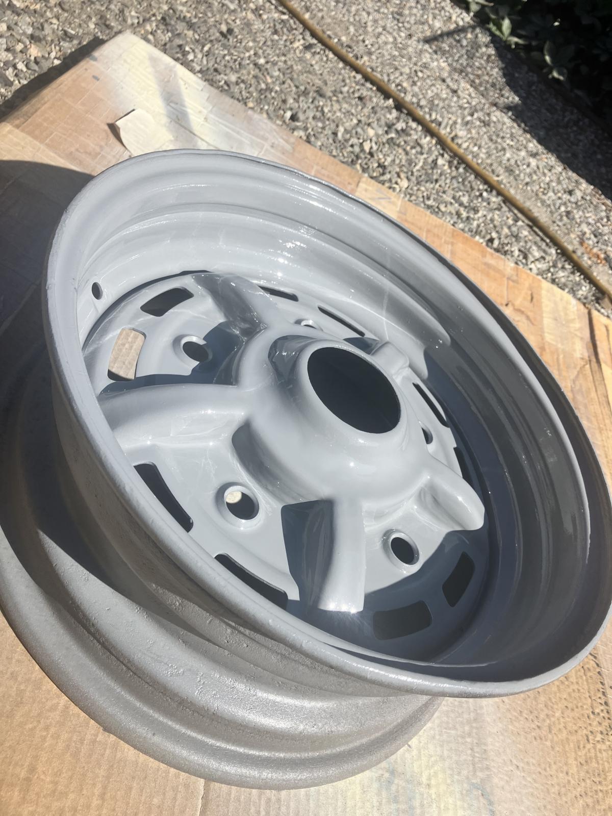

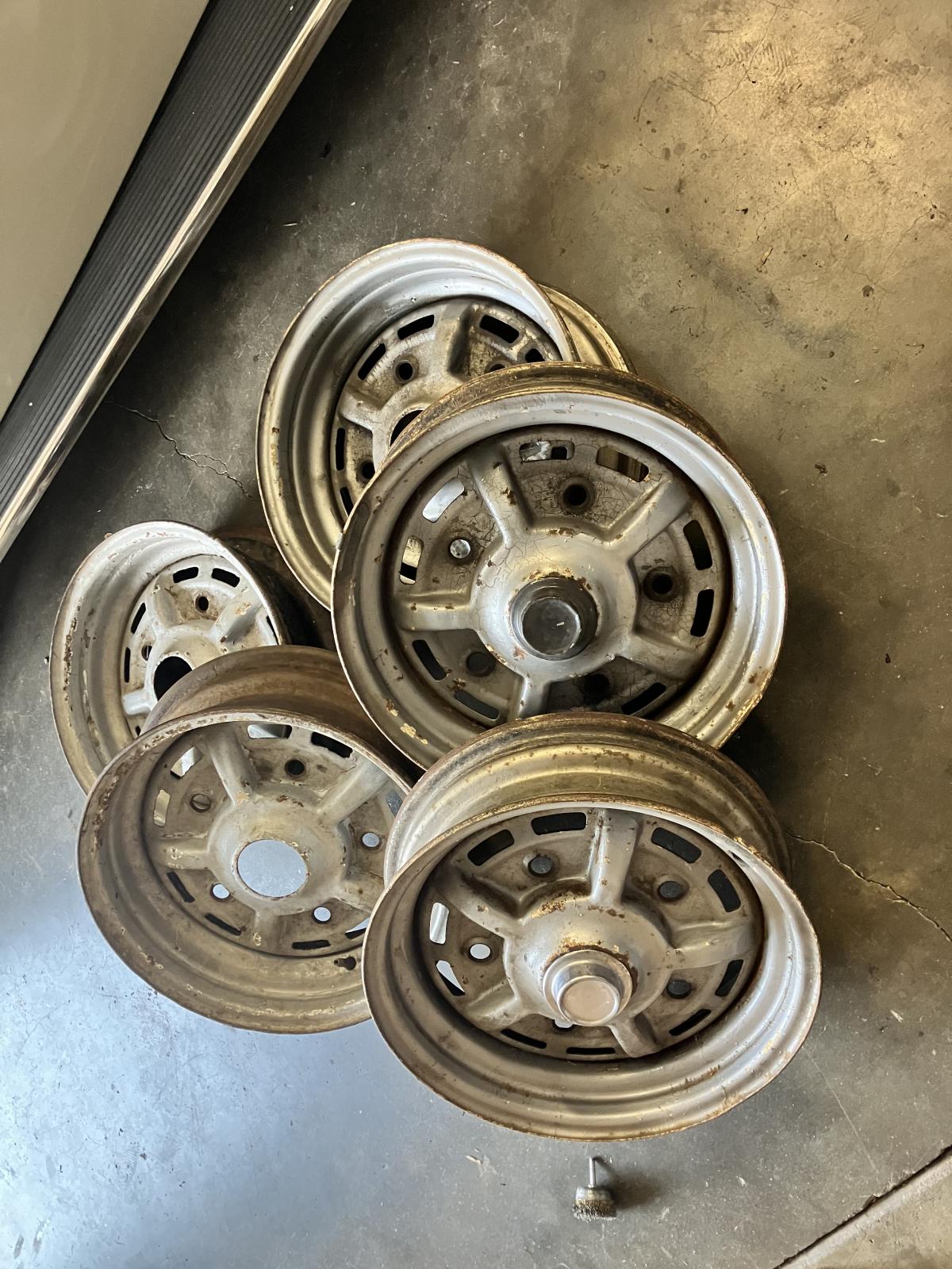

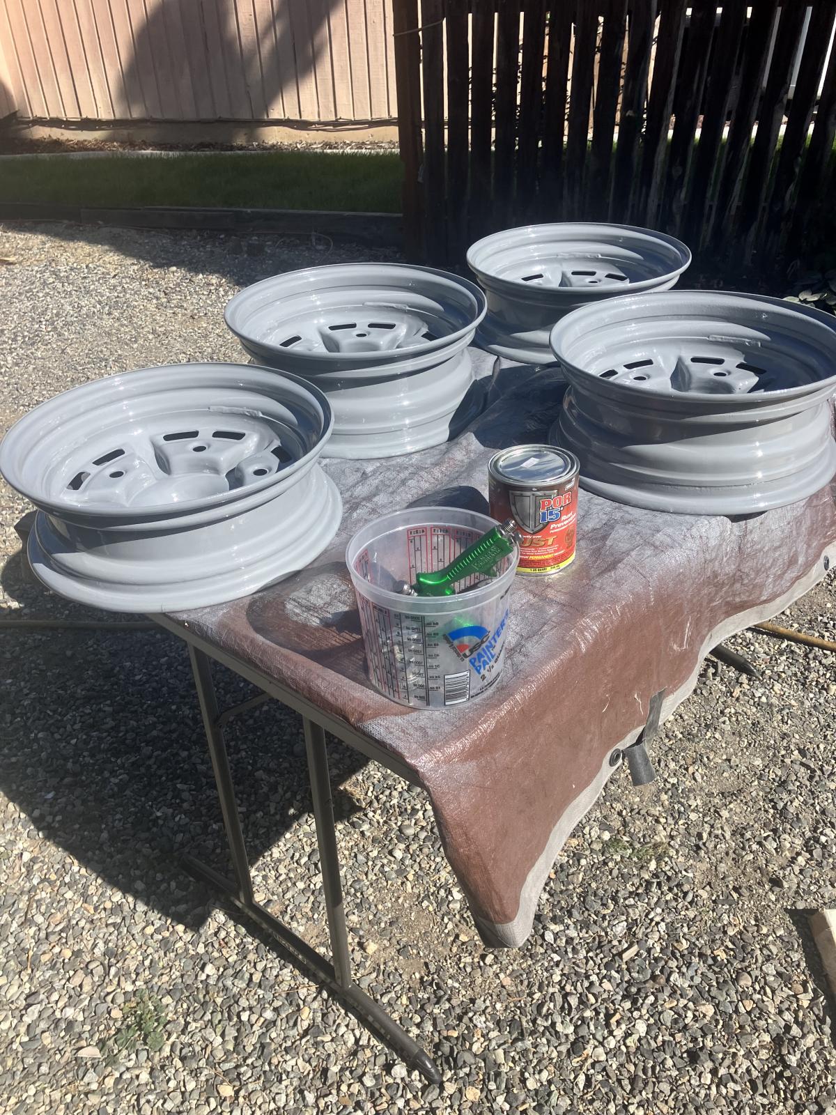

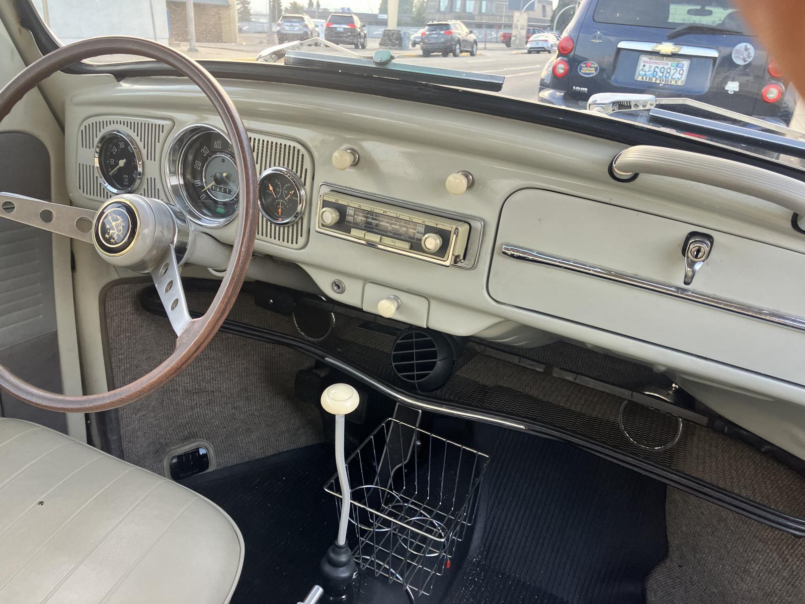

LIttle more progress yesterday...
HULs !
Cool steering wheel...I wonder if its off a boat or something
tilt-a -seat

I do have the original door panels- they're red/ grey of course. But they're fairly hammered. The way I scrounged for deals I was able to put together a whole TMI interior kit for around $800, and it all matches pretty well.
I planned to salvaging the door panels, but couldn't pass up $200 for brand new TMI panels.

More updates on the quest for a daily driver... it's getting there.
Took a great trip over to the Vintage Meet this last summer to break it all in, and it did great. I have had some trouble with the engine, but no surprise as it was just the best I could do scrounging for useful stuff - for instance: I got a pair of 40x35.5 heads off the classifieds here, brand new, but zero markings. And I found out WHY the manufaturer didn't want to know they made them.
*During torquing the heads I had one or two lower / outer nuts that felt like they were coming out of the case. You know that feeling when the torque goes soft? It wasn't the studs, the actual had casting was cracking @ 22lbs. WTF.
Anyway, some horrific hacking and some JB weld and it is still running.
Front trans mount failed completely in less than 400 miles.
Pressure plate also gave me some hassle.
What other stuff:
Original 3 in 1 Motometer gauge: 100% functional now.
Blaupunkt Mainz : also, 100% functional, with bluetooth.
I made myself a 'vintage speed' muffler.
Added some extra trinkets for that bling.
Imported a set of wheels... because HABITS! For my snow tires!?
Well...for whatever.
And the heating system, it should be able to handle ANY winter I need to drive this in. $99 Vevor heater, fits perfect. Required 1" hole for the exhaust, and the bit 3" for the vent. I plan on revisiting the interior vent setup. THat's just what I got done last night.
Anyway, lots of other stuff done and it runs amazing at the moment.
keep driving.
