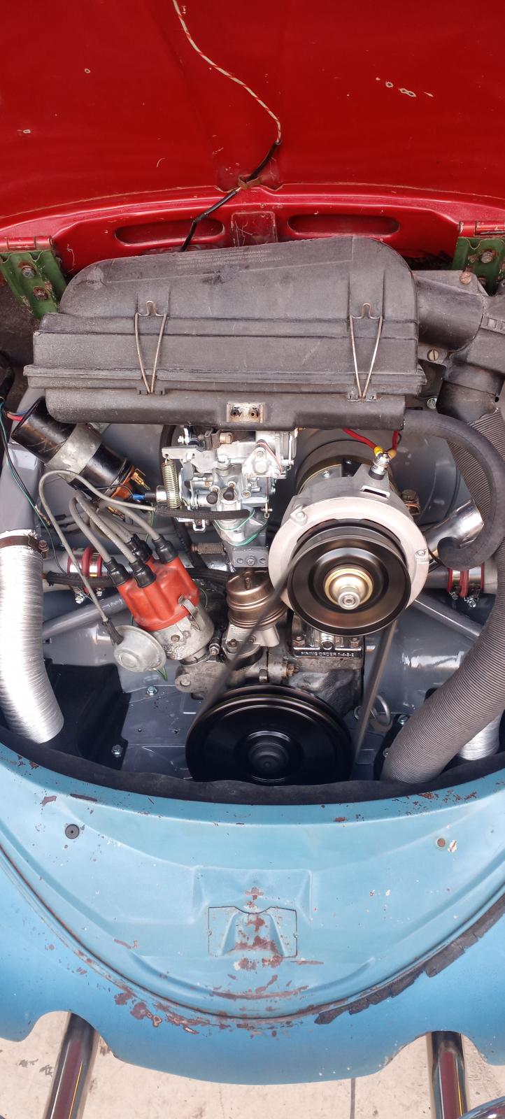

I happen to like this exhaust system, manifold heat is good, it has a pleasant exhaust note thru my TDE tailpipes. I cut the intake manifold heat pipes, drilled the carbon out with a long 3/8 drill bit and re-welded them back on.works great. Fits great, tips exit correctly

PostPosted: Sun Sep 15, 2024 1:25 pm    Post subject: Re: CSP stainless steel stock style muffler pics and impression Reply with quote
You have the vacuum advance hose hooked up at the wrong location on the carb. It should be on the left side, forward of the spring.
early
Joined: January 19, 2012
Posts: 255
Location: Glen Carbon, IL
early is offline
PostPosted: Sun Sep 15, 2024 2:05 pm    Post subject: Re: CSP stainless steel stock style muffler pics and impression Reply with quote
Yup, it's a brosol/solex H30/31 carb. These carbs do not have the
Proper vacuum signal at the normal side position.
The rear vacuum position has nearly the right amount of vacuum.
It's been covered here on the samba.
Edit. I plan to try a 1500 style distributor which requires less vacuum
Which this carb supplies, but this project is on the back burner for now
As I finish tuning the bus engine.
Good eye but it's not a 34pict3.
Cheers and thanks
