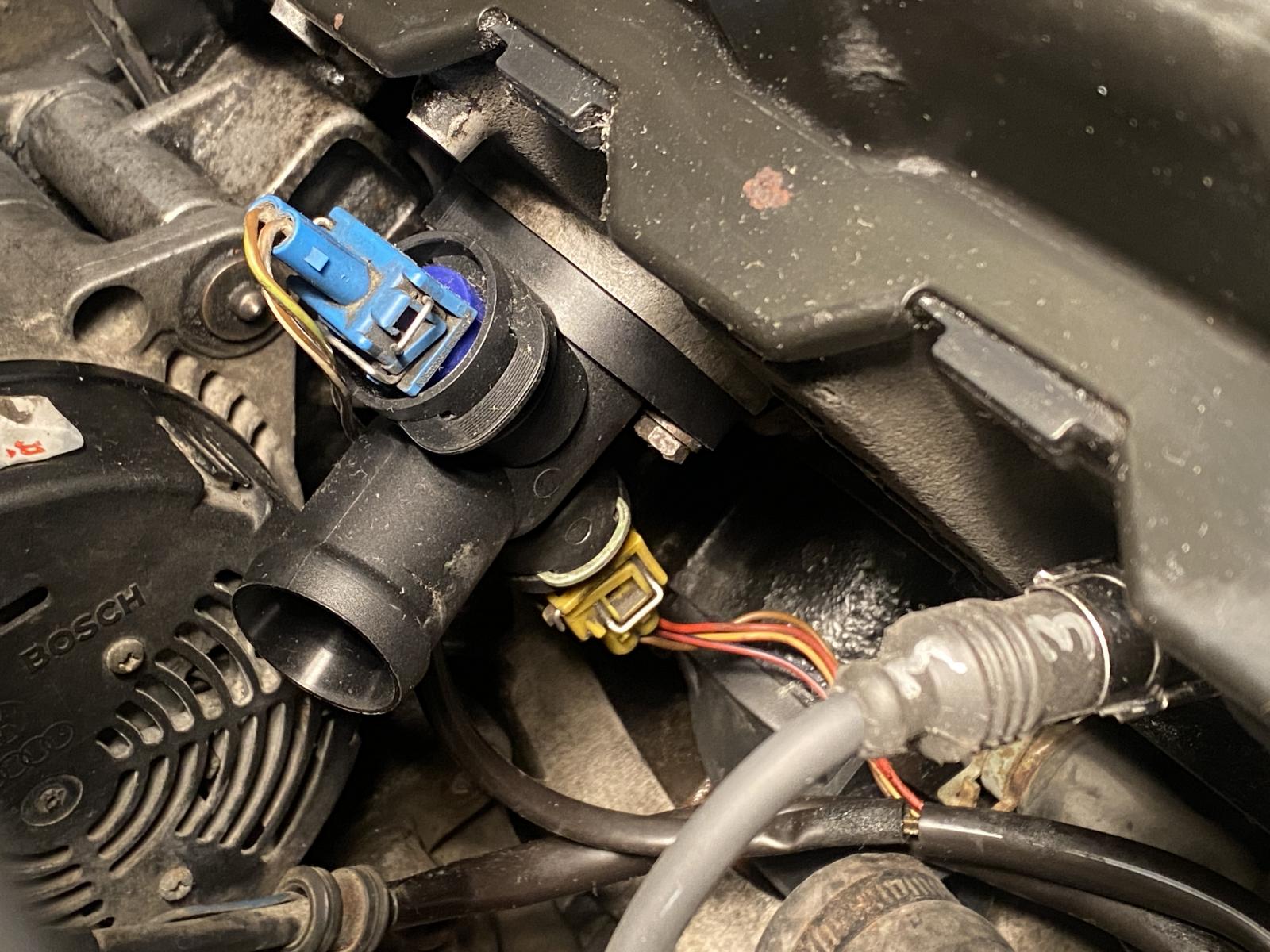

Line up the coolant sensor flange between cylinders #4 & 5 and finger start the fasteners with several rotations. These are tightened-up with a 10mm socket which can be done from the topside of the engine compartment. Mate the T-connector into the two hoses then insert the right side hose into the coolant sensor flange. Sometime in the past all of these connections had been replaced with hose clamps so these were tightened down with a screwdriver. Insert all of the sensor connectors back into their respective housings and give them a quick tug to ensure they are seated. Connect the main hose from the thermostat housing and tighten accordingly. Attach the two hoses into the coolant reservoir orb then secure it into position.

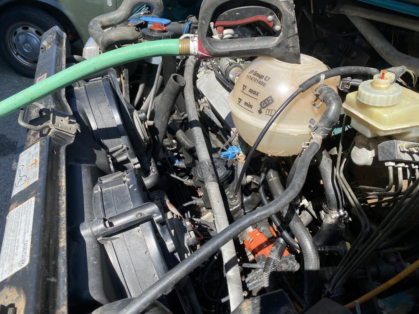

With wanting to flush out all of the old coolant, 6 gallons of distilled water are on hand to help facilitate this. The plan is to run distilled water through the system, flush this out and repeat. On the 3rd time, put G11 aka blue coolant into the system as it should be pretty cleaned out by that point. Pour in almost a gallon of distilled water and look under the engine for drops or drips. Immediately see a drip happening about every second emerging from the T-connector. At first it looks like it is leaking from the sensor itself. This was the sensor which a previous owner had gooped-on a large layer of sealant around. Changing my viewing point, see the stream emanating from the hose on the right side. Crank down on the hose clamp and this stems the leakage. Everything else seems dry and tight so resume pouring in the distilled water through the orb. After ingesting about a gallon and a half of water, it mostly fills the reservoir. Recheck the ignition wires once more, get inside and the engine almost immediately starts at the turn of the key. With the water pump now spinning, the water level in the orb starts to drop. After 2 or so minutes shut things down and look under the engine as it remains leak free. Top it off with more water and notice what is in the coolant reservoir has already started to turn a light shade of pink. Restart the engine and keep it running to see what happens as it warms up and reaches operating temperature.
The engine continues to run for about 15 minutes as the temp needle eventually reaches pretty high on the dial face. The cooling fans finally rumble to life, this is one of the systems I want to definitely make sure is operating properly. The coolant in the reservoir is now quite rust colored and no longer clear. Not a positive sign. During this test, the coolant light came flashing on, several time the engine is turned off and restarted to see if the light re-activates. When the temp gauge is in middle area finally the blinking subsides. Looking at the color of the liquid in the orb, I speculate if using just distilled water and as the rust particulates are mixed in, does that impact the sensor readings? Let the engine cool down for about an hour then run it for 30-40 seconds to attempt to get any substantial gunk back into suspension before draining out the once distilled water. It is pretty nasty looking liquid and notice the the solid residue left behind at the bottom of the reservoir orb. It is getting obvious it the engine will need more than just another flush. Close the system back up and refill it with more distilled water. Run the engine for 10-11 minutes and this is a repeat of the last run with the clear water turning rust-colored. This time I set up a time-lapse to capture the transition. which happens pretty quickly. Drain the system out and call it a day and to figure the next plan of attack.

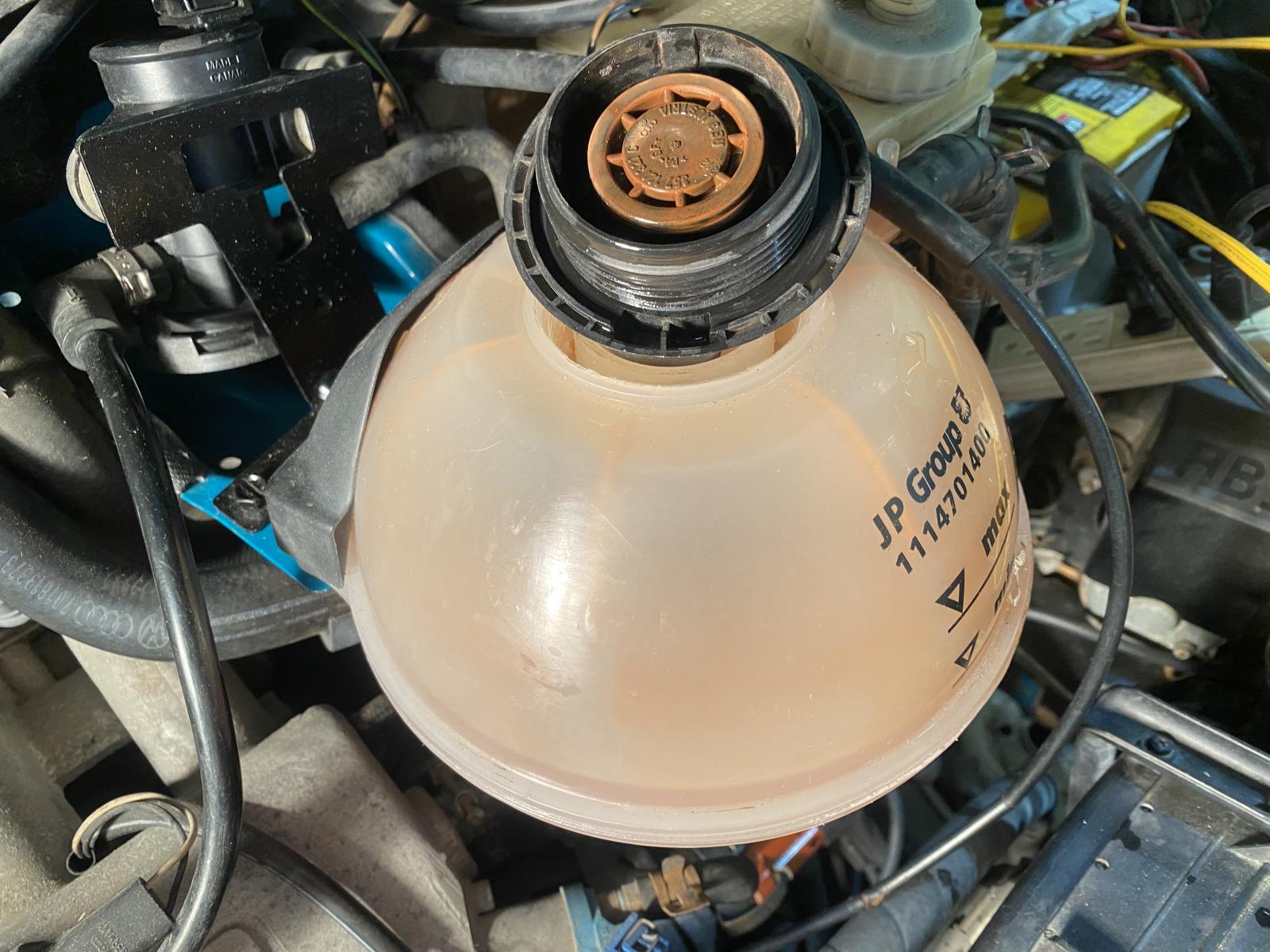

Time Lapse of the Coolant Reservoir Orb

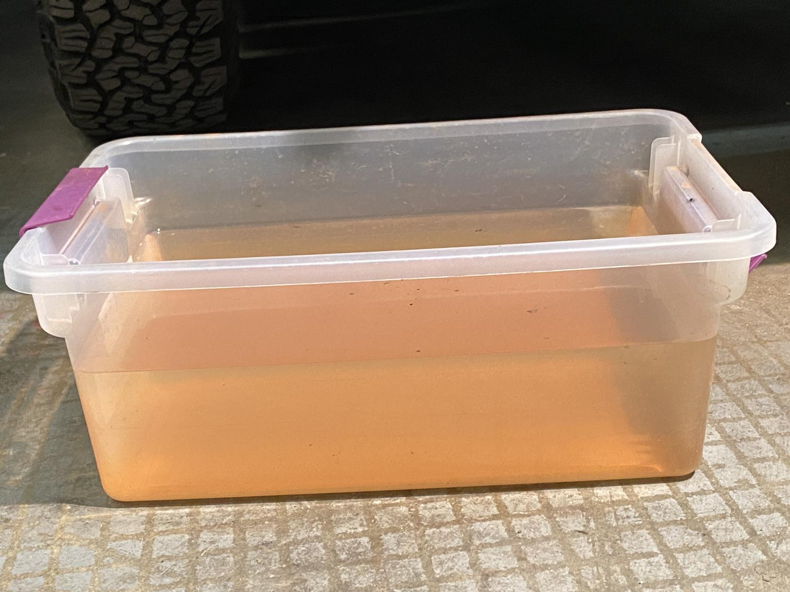

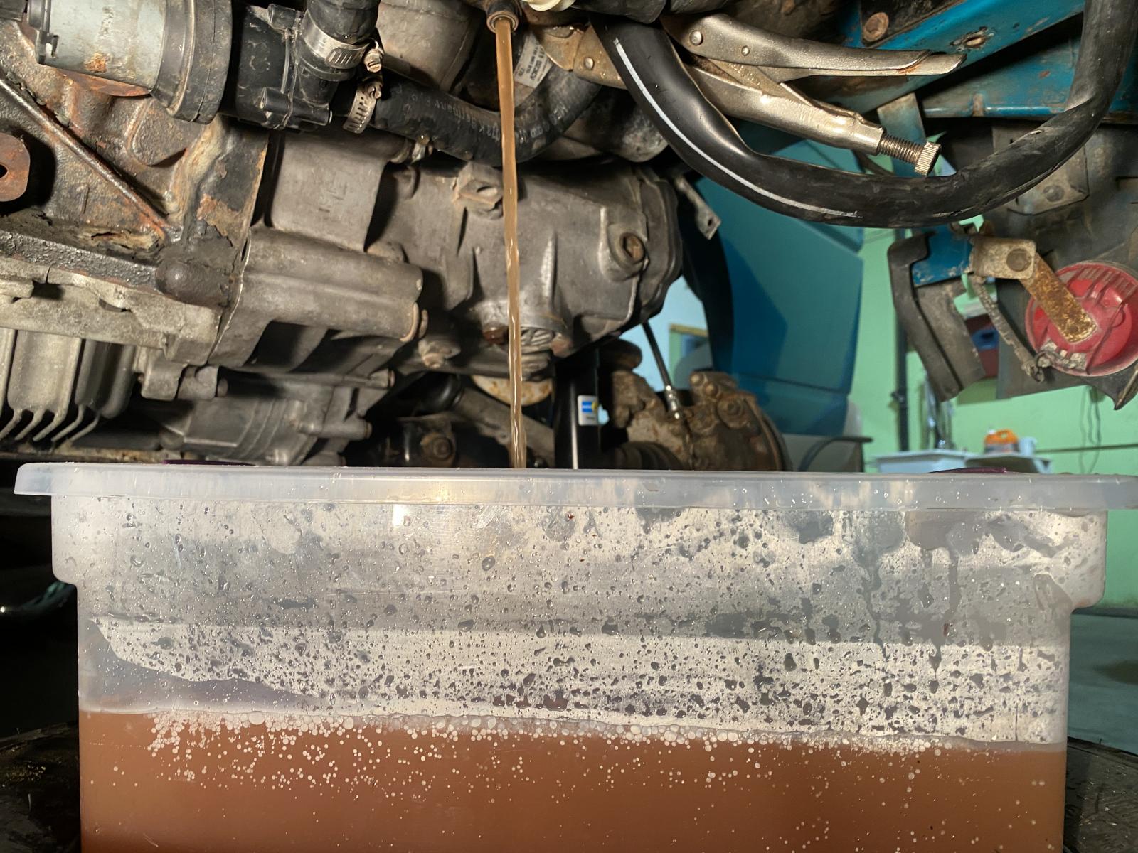

After going through 7-8 gallons of distilled water and still encountering significant signs of rust, decided to take a bit of different approach. Did not drain out water of the last flush so I could reposition the van. Since the Weekender has been up on jack stands since October, now it is time to get it back on its wheels. The tires are mounted on and soon it is back standing on the concrete. Start the engine and head out to the daylight. With the van outside, I can now flush the system out multiple times using a hose. Drain the fluid in the cooling system into a catch basin which again emerges rust-colored.
In order to try and rinse out the block, the thermostat housing is removed. Already a rusty silt lies along the bottom of the internal passage, pretty much assume this will be found in all throughout the hoses and the engine block. Undo the hose to the upper coolant sensor flange. Find a length of radiator hose from one of my older Volvos which plugs snuggly onto the flange. Using this hose, water can be shot into the top of the block and escape through the thermostat opening. This will certainly not remove all of the built up deposits inside the engine, it should get a significant amount up and out. After a couple rounds of rinsing water through the flange piece and the reservoir, button everything back together.
Flush out the cooling system with distilled water twice, first filling then running the engine for a couple minutes with the heater controls on. Draining the second flush into a catch basin, the fluid comes out a lighter orange color rather than the deeper red of the first series of attempts. I now feel comfortable adding coolant into the system. A gallon of straight G11 (blue) is poured into the reservoir and need to open a second bottle to top it off. Run the engine for several minutes to circulate the coolant and top it off with the G11 coolant and the last of the distilled water.
After letting the engine get up to operating temperature, take the Weekender up and down the street several times to really mix up and hopefully fully burp the cooling system. Bring the van back into the garage space and let it sit. Check things two days later and the coolant level is almost at the max line of the reservoir. There are no drips or leaks under the van and the fluid from the final flush in the catch basin has a fine sediment along the bottom of the container. he fluid in the reservoir retains a deep blue color and it does not seemed to be tinged with any sort of red/rust hue, a positive sign. The one issue still occurring is the flashing coolant warning light. though it only happens when the engine cooling system is cold. When the needle finally hits around mid-range on the face, the blinking warning light will remain off after restarting. While an improvement, its also a still a bit of mystery of what the issue is.

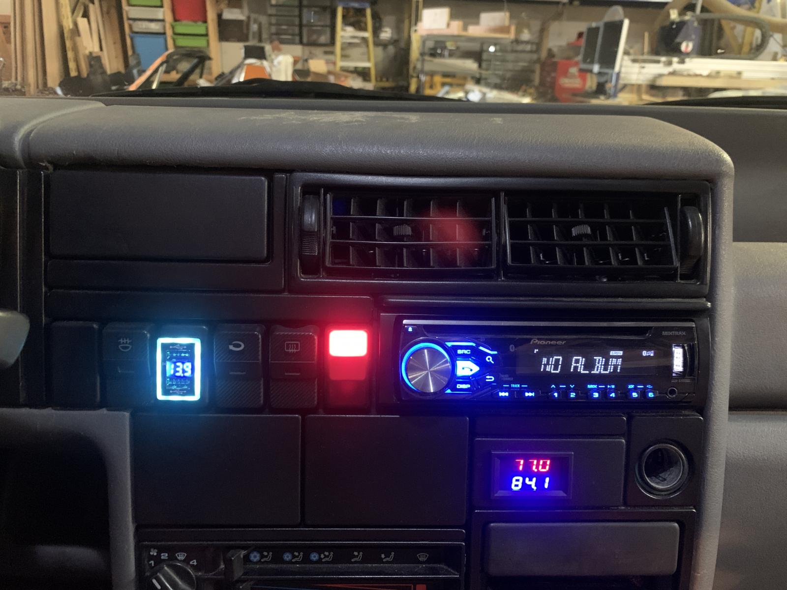

Panel Lighting
During the post-purchase assessment noticed an absence of illumination in the controls for the “secondary heat exchanger” in the center dash. Having light bulbs being non-op wasn’t a huge surprise in a 30 year old vehicle, though a working light in the climate control panel was not something I was expecting. While taking out the instrument cluster to replace out the voltage stabilizer in late January, decide to tackle the illumination for the secondary heat exchanger panel at the same time. This panel is easy to remove from the dashboard, it fully releases after undoing two electrical connectors. The back cover is detached, revealing a single burnt out T5 bulb in a holder. The bulb fits over a plastic octopus looking chamber on the main panel to help distribute the light. Swap in a LED bulb, snap the backing plate in place the plug in the connectors. This control panel is now properly and brightly lit. Figure I should be proactive in replacing out the light for the main climate controls. While the bulb in this particular panel is not made to be serviceable, it can be removed with not much work. This panel gets a replaceable LED light fixture as well, the details of which are here in a separate thread/posting. (https://www.thesamba.com/vw/forum/viewtopic.php?p=10014506#10014506)

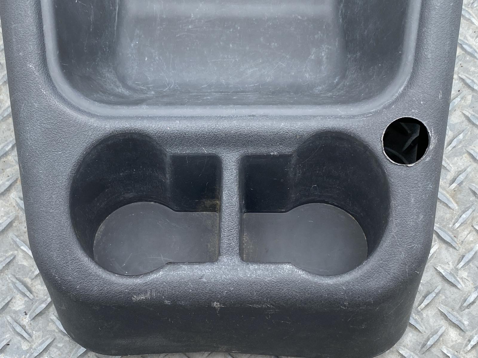

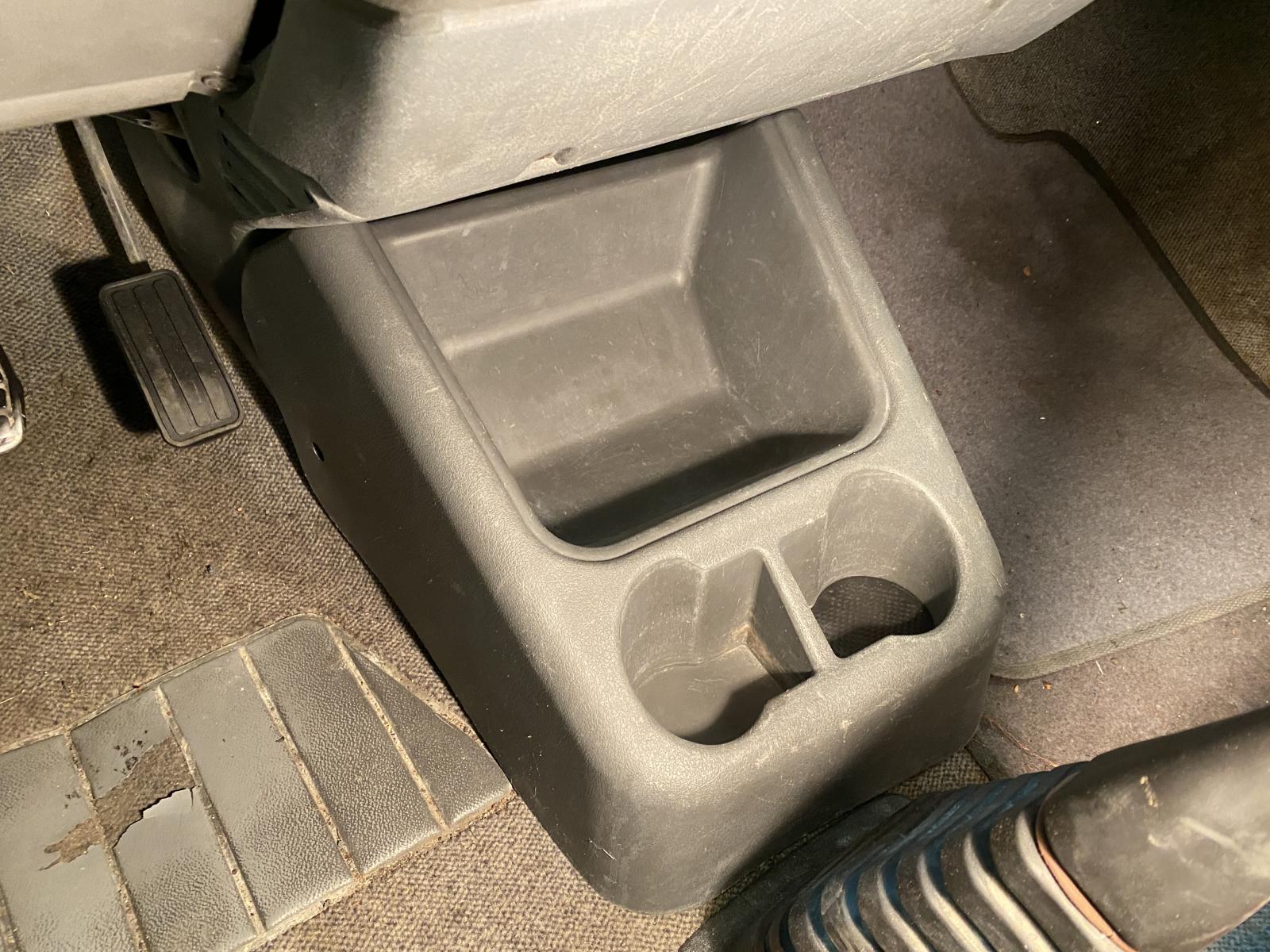

Center Cupholders

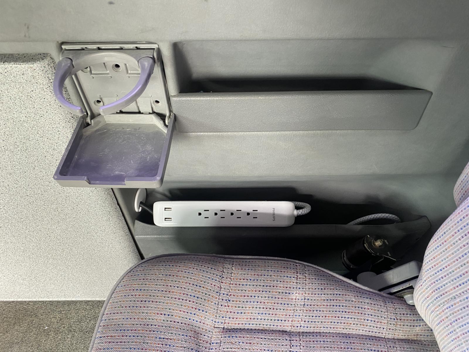

The 1997 and newer vans feature a floor-level storage compartment and cupholder in front of of the shifter. This is something I noticed while going through a Eurovan at the junkyard two-some years ago. Looking at the set up of the VR6-powered vans, the air vent ducting below the dash does not seem any different than the five cylinder vans. Removing this piece out of the well picked-over interior, I am curious to see if it is a simple add-on/retrofit into the older vans. The charge for this part is less than $10 out the door so it is an inexpensive experiment. Adding this storage piece will not block any air flow as the lower center air vents angle from sides of the plastic housing towards the feet of the driver and front passenger. The contour of this part fits into the existing design of the floor vent and has been in my 1995 EVC ever since. After finding another one when searching for the AC relay in mid-April (previous post) the Weekender sports one now as well. I’m sure the VR6 owners have a similar experience, the reach to the cupholder and storage compartment is somewhat of a stretch, even for me with a fairly long reach. That said, it is certainly convenient and a worthwhile addition to the cabin.

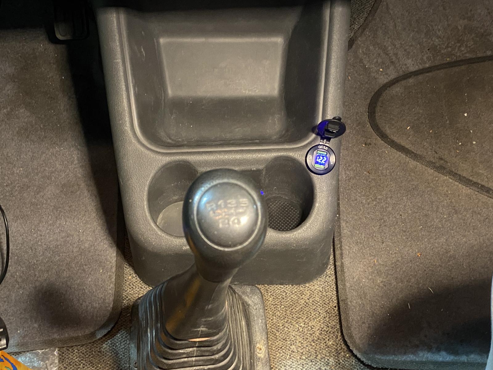

After retrofitting a USB power point next to the center rocker switches, I have been considering where to install another one. Could mirror the first one by mounting another port into a plastic blanks next to the first one. Not a fan of having chords draping in/around the shifter so want to see if there is another logical spot before having to do that. After retrofitting the storage bin scavenged from the 1999 Eurovan in the boneyard, begin to calculate if it could host a charging station. Taking it back out, inspect the console and the proverbial light bulb sputters on for a solution.
It looks like one of the round USB power ports meant for replacing out a cigarette lighter should be able to fit between the cupholder and the main recessed storage area. (Ordered these several months ago so they were on hand: https://www.amazon.com/gp/product/B08PCMJRR2 ) A 29mm hole is needed for the body of the charger to pass through. Grab a 27mm socket as an initial check if an opening can be made without impairing the cupholder or storage area. With a sharpie, outline the target opening (28mm) with the assistance of a plastic stencil template and find the center point. Drill a small pilot hole through the topside. Use this to guide a 1 1/8” (28.5mm) spade bit from the bottom side to create the proper sized opening. The USB charger slides in and is secured into place with the threaded lock ring. Need to loosen it a bit to get the gasket/protective cover to line up correctly then tighten it back up. Route the positive wire to the ignition/key activated connector providing power to the stereo and existing dash USB power port. Run the negative lead to the ground ring to the left steering column. At some point will need a USB-C port in this van somewhere and this position would be an easy place to fit one in when that time arrives.

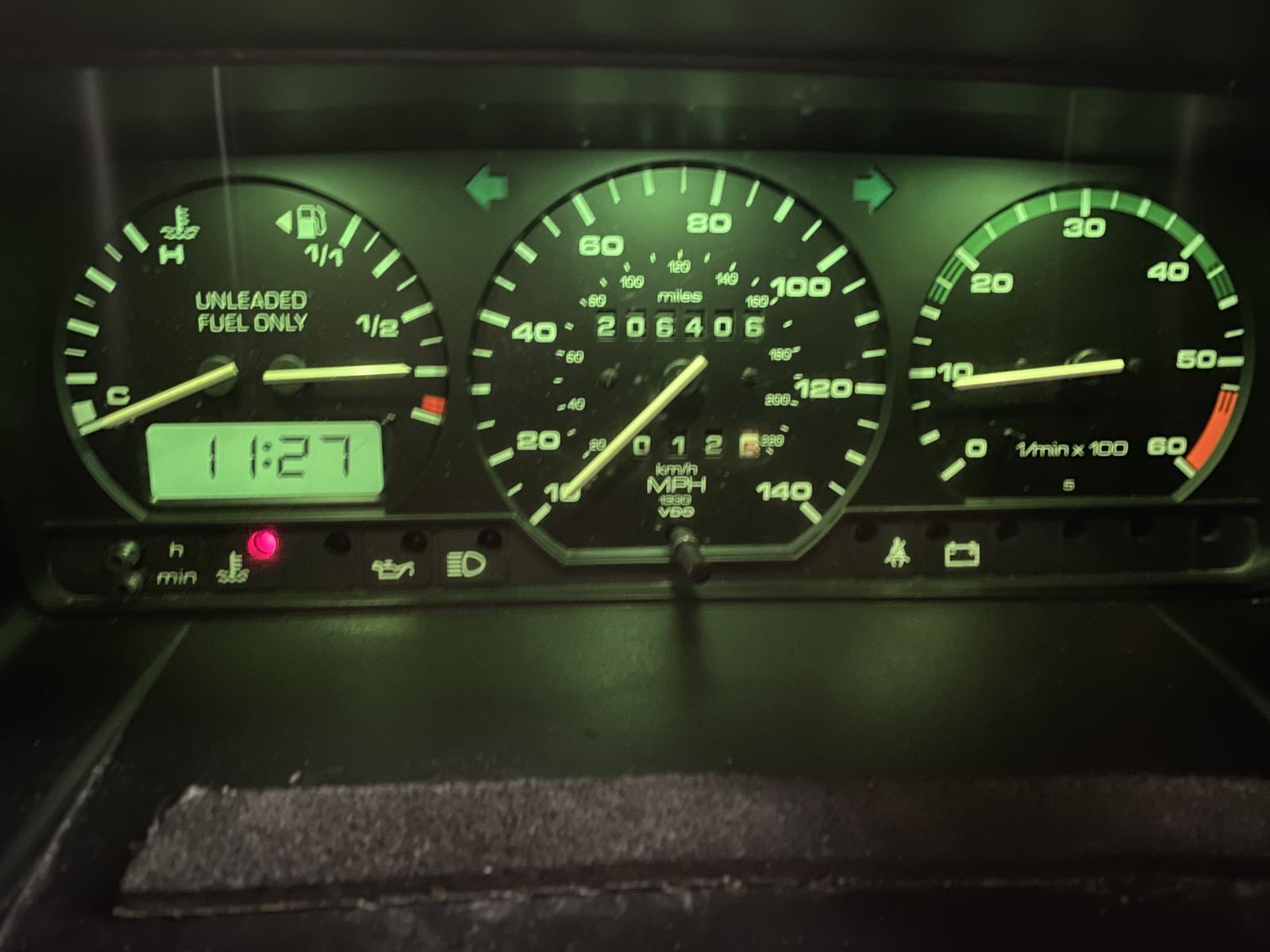

After seeing the blinking red coolant warning light during the test drive, go back to the coolant reservoir and once again pull the connector to the level sensor. Install a jumper wire, fire up the engine and the red light activates again after about 20 seconds. In addition to the jumper I have taken out the instrument cluster to resolder the voltage stabilizer joints, replaced the voltage stabilizer, as well as replaced the coolant temperature sensor. Right now I am pretty much stumped on what else I need to be checking so any suggestions would be very welcome.

Hey @Saturn thanks for your posts here. Appreciating and learning from them! The center console modification you made for the USB power looks great! How bright is the voltage display when driving at night? Those adapters don't have an option to dim or shut-off the display without losing power to the USB ports, right?
Saturn
Joined: April 06, 2019
Posts: 265
Location: San Francisco
Saturn is offline
PostPosted: Wed Jul 05, 2023 11:23 pm    Post subject: USB Charger in the Weekender Reply with quote
Thank you for the feedback. Good to know the work I am documenting is of value to the Eurovan forum.
In regards to the powerport, I have yet to experience driving the Weekender at night with the new USB port installed. Usually these chargers are about the same brightness as the display from a DIN-sized aftermarket stereo. Most of my cars have some sort of retrofitted USB charger set up in them so it could be the case I am filtering them out after seeing them for so long. That is why I tend to stick with blue lights/lighting on these power ports. Newer USB chargers do have on/off buttons incorporated in them now, though that is a main switch and not just the lightening of the unit. (https://www.amazon.com/s?k=USB+charger+3.0+dual+socket) If the light is too distracting then apply some tape and block it out with a marker or sharpie. Personally, I don't mind the light generated and think there is reason to have it as it makes it easier to find/use when it is dark. Kind of like the built-in illumination in the door window switches.

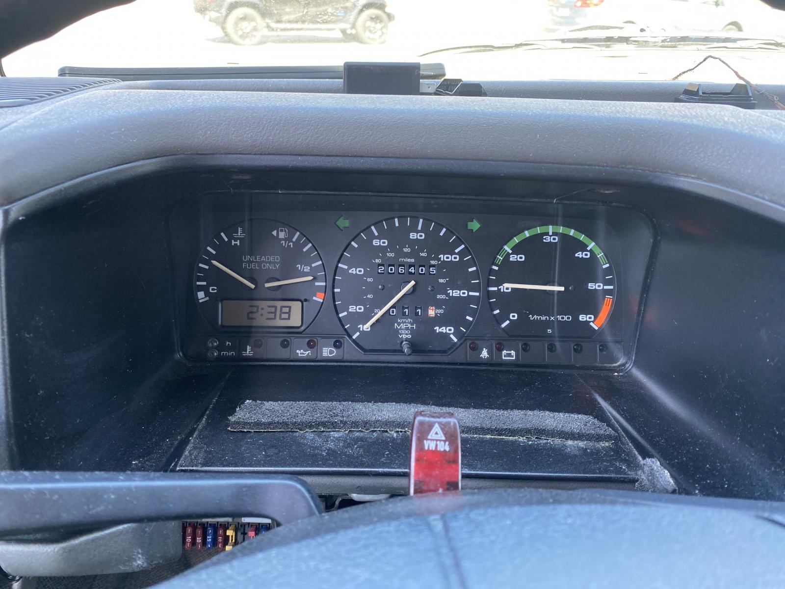

The one dash display which trips me up is a red overdrive light on the dash of my 1967 Volvo. I will catch it out of my peripheral vision and will sometimes momentarily set off the oil warning light alarm in my brain. should change it to a blue or green light to help reduce that distraction. Also in darker conditions, the LED flights get blown out by camera phones so they tend to look a lot more intense then they normally appear to the naked eye.

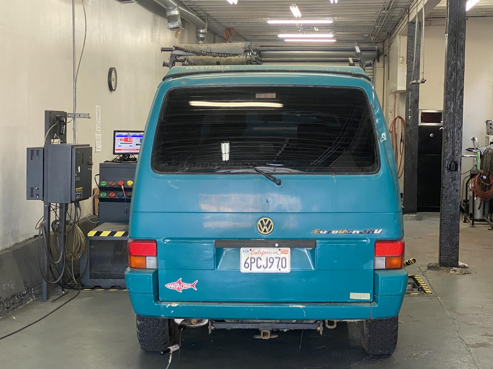

Tuesday afternoon finally get the Weekender out on a drive in order to get it properly warmed up. Proceed to my usual smog test station and the result is the van fails its smog test. In the Bay Area, vehicles must pass a 15mph and 25mph dyno test used simulate actual driving conditions. The van does just fine on the 15mph parameters but ends up failing at the 25mph level. The max of the HC (Hydrocarbons) allowed is 51ppm with the van registering at 81ppm. CO (carbon monoxide) has a max of .73% and the test detects 2.26%, way off the scale. NOx output is way within limits 747ppm max/41ppm measured. Elevated HC & CO usually means incomplete or unburned fuel, so most likely running rich.
When talking to the tech after the test, they indicated a bit of trouble occurring with the Weekender. After situating it on the dyno, the tech needs to put the vehicle in gear and rolling to get to the speed of 15mph. On the first try, the Weekender ends up stalling out trying to get into second gear which I see happen while out in front of the shop. During the 25mph test, I hear the engine straining trying to keep up in 3rd gear and the tech goes back to second gear to run the test. They relate the van seems to be down a bit on power and recommend that I look at the MAF, plugs and/or wires as a starting point. The ignition wires, spark plugs, distributor cap, rotor, are all new, the only part I left alone is the ignition coil.
Beginning to research on what to start looking at so the test can be run in 3rd gear. Want to figure out If this relates to an issue with the ignition/spark, fuel delivery, vacuum leak or something like a blockage in the catalytic converter. When driving the van around the past few weeks, I have not sensed any sort of misfire or the engine being down on power. That said, when I first picked up the Weekender last September, there was an initial feeling it was not running optimally. Because of the original shifting issue, the entire seven mile trip was done all in 3rd gear so that might have made things seem not at 100%. Another aspect to note during the pretest drive and going into the smog shop, the coolant temp gauge was sitting at the 3/4 mark. If the engine was running too hot, then the NOx measurements would be elevated as well.

Since the dyno test mimics road conditions, I focus on if there is anything else which could be done to make the Weekender operate more efficiently. Remembering the difficulties the tech had getting the van up to correct speed during the first test, started to consider rolling resistance. This van has pretty beefy tires on it and realized I have never checked the tire pressure. All four corners measure at 32-35 PSI which is on the low side. They should be at 50 PSI according to the sidewall print and are inflated accordingly. At this point I am ready to retest the Weekender to see if any of these changes make an impact. Get the engine/exhaust fully warmed up and head to the smog shop. In examining the results from both tests, the HC and CO drop dramatically though at the same time NOx shoots way up to almost the maximum allowable. This may mean a new catalytic converter will be needed in the next few years. At the end of the day not sure if it is one or a combination of the fixes which allow the van to pass the test.
Another data point on an ongoing issue. On the way to the test station the temp gauge is reading pretty high and the coolant warning light continues to blink away. At a stoplight several blocks from the destination restart the van and the warning light stays dormant. Still trying to figure out what is going on with this light and how to make it operate in a more consistent manner.

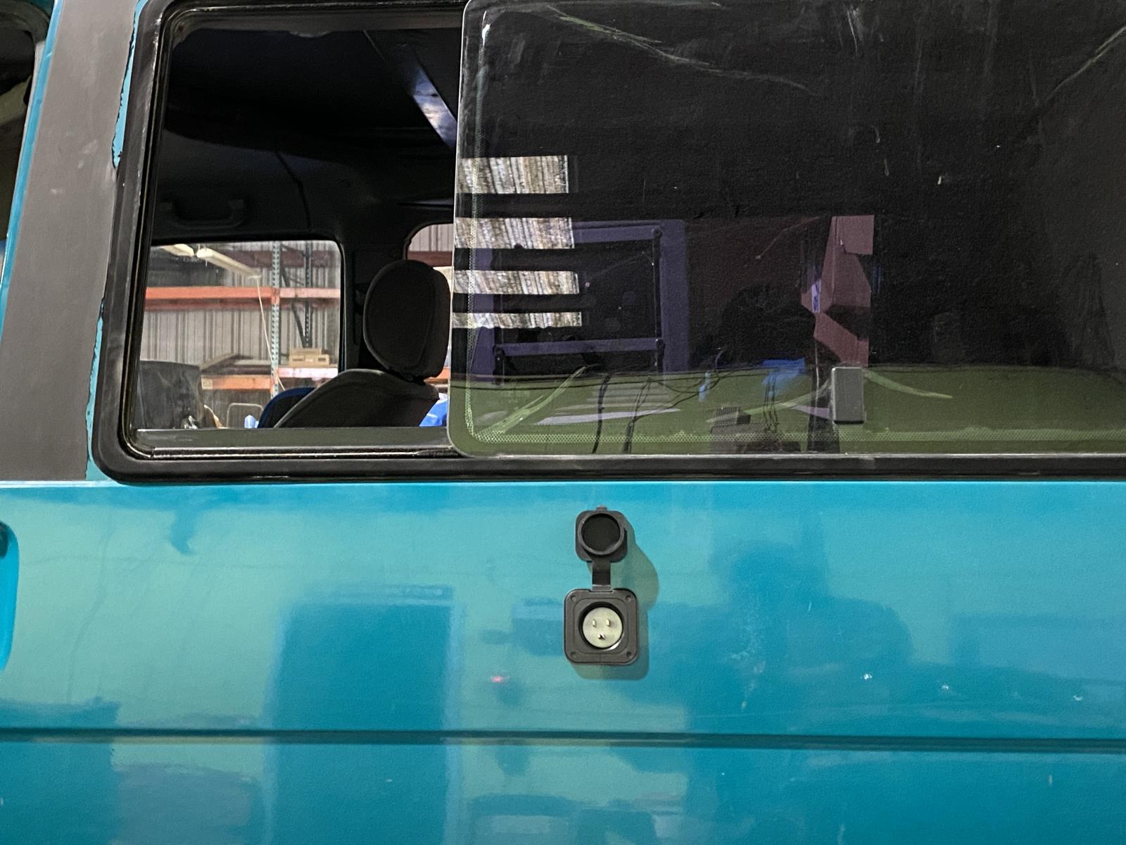

Shore Power
In January, dbeeby posted a well documented procedure on adding shore power into their 2003 Weekender. https://www.thesamba.com/vw/forum/viewtopic.php?t=776533 Bookmarked this how-to guide, and decide to perform a similar install. Instead of a dual plug port, I opt for a singe port as I plan to integrate it into a power strip in one of the storage pockets next to the jump seat. Follow their instructions except for routing the plug through the cup holder. Instead, cut a 1 1/2” hole into the panel wall above the storage pocket to run the power plug through and retain the cupholder for the jump seat. Find an appropriate sized plastic cap on Amazon to cover this hole for a more tidy and finished look.
After installing this into place and putting everything back together close the slide window and see something which will need to be addressed. Sliding the window close, it drags some residual dirt/playa dust which exits out of the drain openings in the channel. Couldn’t ask for a better visual cue on the drainage route as one of those happens to be situated right above the shore power port. My plan is to initially close that channel drain with butyl so water does not leak directly onto the port/opening. If planning this approach to adding shore power, keep this placement in mind. Having this shore power availability is really valuable when working with the wet-vac inside the cabin.

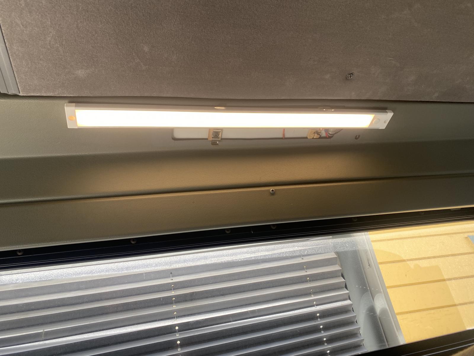

The one other update in the EVC is a swap out of the LED lighting over the pullout bed area. This had been upgraded with dual warm-white LED fixtures, in my opinion provided too much light as they were not dimmable. Additionally, these units have a pretty thin clear cover which I believe to too fragile for a camping rig. Initiate a search for a suitable replacement and end up finding a 20’ long fixture which is dimmable as well as sporting a red/night vision mode. (https://www.amazon.com/dp/B0B62S5ZY3/) Installed one of these in place of the dual fixtures and pretty happy with it. A second one could be installed in the space as well if needed. The EVC is now ready for them to take it on the adventure up north. Four days and 500 miles later it returns back without an incident and ready for the trip down to Laguna Seca.
