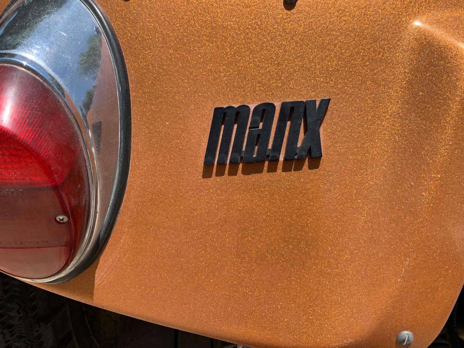

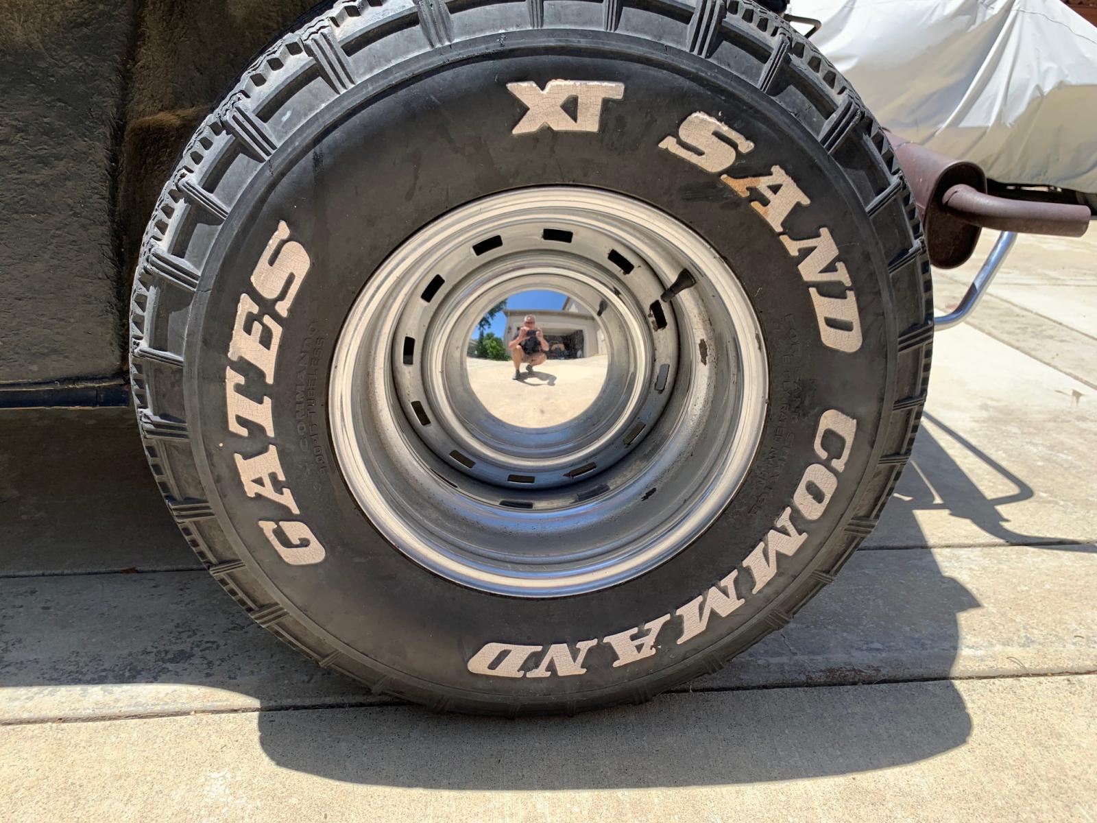

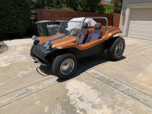

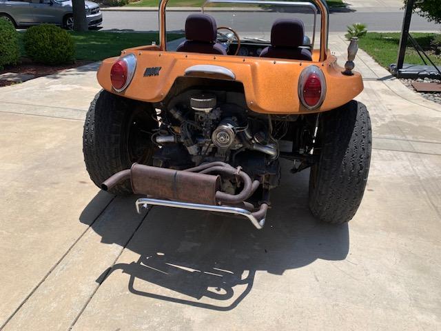

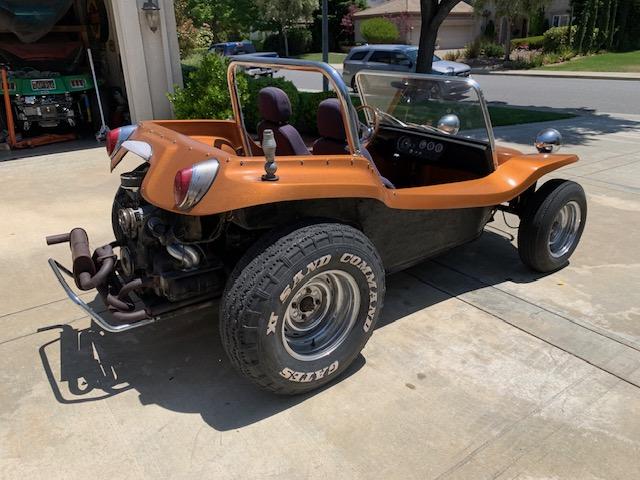

I found this beautiful Manx two weeks ago and got to see it for the first time this morning. It was about 600 miles away from me but my buddy Chris Hersh volunteered his time to go pick it up and bring it to me. So this morning at 1:30 he showed up and we unloaded it.
It looks like a good early 70's type build. The Commando XT70's and Grantmaster Super 120 tires go all the way back to the mid 60's so who knows how old the tires are. One of the tires must have a flat spot or a bulge because it was a bumpy ride. It has a bit of a crash in the hood that they tried to cover up with flat paint but overall this Manx is in great shape.
Immediate plans are to replace the tires, go through the brakes and tune it up. It's a bit rough at idle and the front brakes pull to the right. Future plans will include fixing the hood (see you soon Miguel), replacing the seats with something a little more 1970, and replacing the cracked windshield. I'd also like to find the same wheels but maybe a different offset to pull them in under the fenders a bit more.

Sweet period correct Manx! I love it, clean and uncluttered!
I wish I was close enough to buy those seats, they look very comfortable for long distance drives! Good luck with the tune up and let us know how it turns out. I see several things you might want to change to make it run better but try the tune up first.

I'm all ears for things to change to make it run better. Will start with getting an intake that has the heat risers. Need to change the plugs and get a blue Bosch coil. I usually get rid of the points too and install a Pertronix but haven't even looked to see if they have those. Probably will go to an alternator too to get rid of the external regulator.
Here's some shots of the engine.

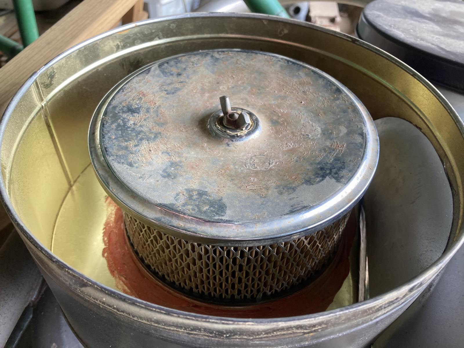

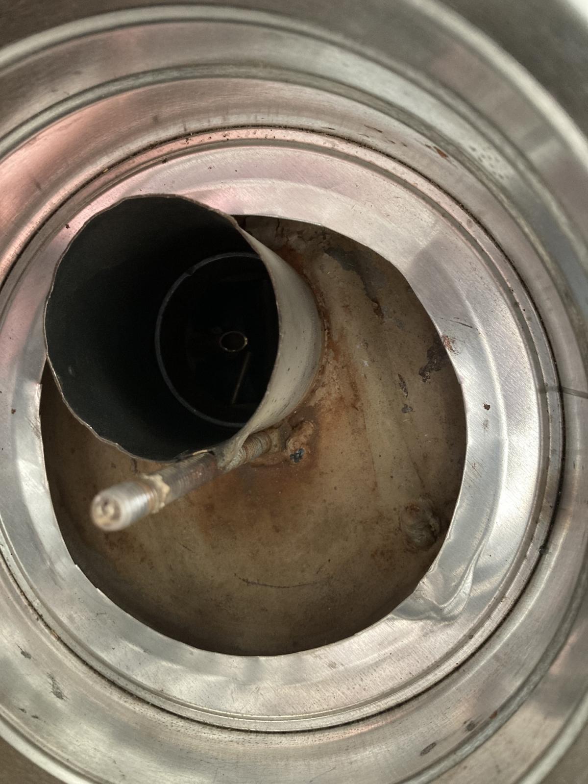

Sounds like good ideas thanks for pointing them out. The only one I'm not clear on is the fuel stand off tube. Do you have a picture of one? Assume that with such a short air cleaner it may not be there.

Ok, you will have to overlook my redneck air cleaner warm air intake system using a coffee can and a cookie tin. The base for all that was cut off a stock VW oil bath air cleaner so the actual fuel stand off tube is the stock one. It measures 2.5" on the inside down to the carb or 3" total on the outside including the 1/2" that slips over the carb and the clamp goes around.
This is what the bottom looks like.
Two shots from the top.
And with the air cleaner on, not that it matters...
I hope that helps.
If you look inside a stock oil bath air filter from a Bug you will see the inside tube goes from the carb to top of the filter. The filter mesh is updraft, then down from right under the top to the carb. That tube length above the carb is needed. I dont fully understand why, but it has to do with the pulsing airflow. Since a Berry Mini-T has no space above the fan shroud I went with a stock Bus/Ghia 40 horse air cleaner pipe for the effect. With a Manx I suspect you have room for a stock filter or short extension pipe between the carb and an aftermarket air filter.

EVfun wrote:
Thanks for the explanation. Now I get it. I may have a stock air cleaner housing somewhere around here. With the current filter there is 3.5" of clearance above it.

dlyle wrote:
EVfun wrote:
I would suggest not using a 1200cc air filter (36 or 40 horsepower filter) on a later engine. Some have reported that they run rich at the top end, suggesting excess airflow restriction.
You can cut off the snorkel(s) off a stock oil bath air filter to remove the hot air intake for a buggy, not suggested if you plan to run it year-round. Some of the more knowledgeable people in the performance forum here have input on doing that correctly to improve airflow. It was over there I learned about the Bus intake elbow option when lacking room.
