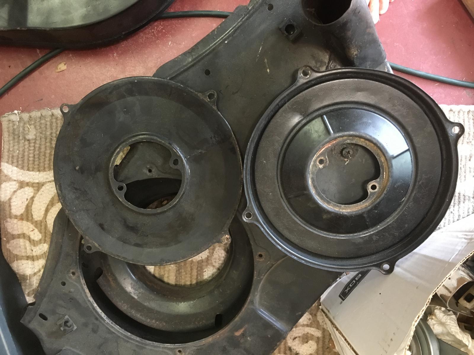

You'll also need the correct backing plate for a 6V generator. It's the single piece shown here on the right (12V generators use a 2-piece backing plate).

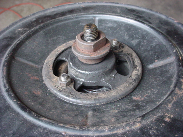

You'll also need the 6V version of this clamping ring (shown here being held in place by the two hex nuts)
And as already mentioned, you'll also need a 6V generator stand.
