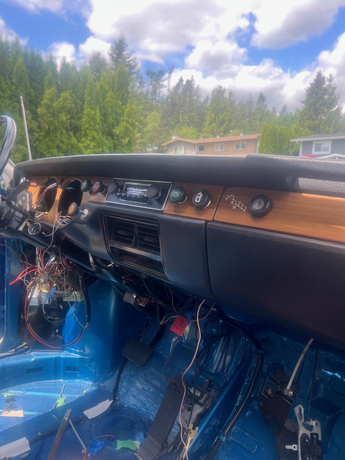

PostPosted: Thu May 25, 2023 7:33 pm    Post subject: Re: Walt's 1973 412 Barn Find Reply with quote
Walter, I am so jealous of that new sparkling dashboard. I made do with my original with the small cracks but it looks good despite those. I may be able to find someone that can repair those cracks. There are miracle workers out there.
Let us know about that windshield when it arrives. I would like to have a spare someday.
Your hard work is paying off!
Bill

PostPosted: Sun May 28, 2023 7:49 pm    Post subject: Re: Walt's 1973 412 Barn Find Reply with quote
NurseryWalt wrote:
The ultimate prize, a pristine dashboard from Germany installed.
Hopefully my new windshield from the UK will arrive in June. It takes 10-12 weeks from Pilkington.
Walter
Is the orange knob for Fog lights?

PostPosted: Sun May 28, 2023 8:27 pm    Post subject: Re: Walt's 1973 412 Barn Find Reply with quote
Yes. Fog lights which I don’t have at the moment. But the knob looks really cool.

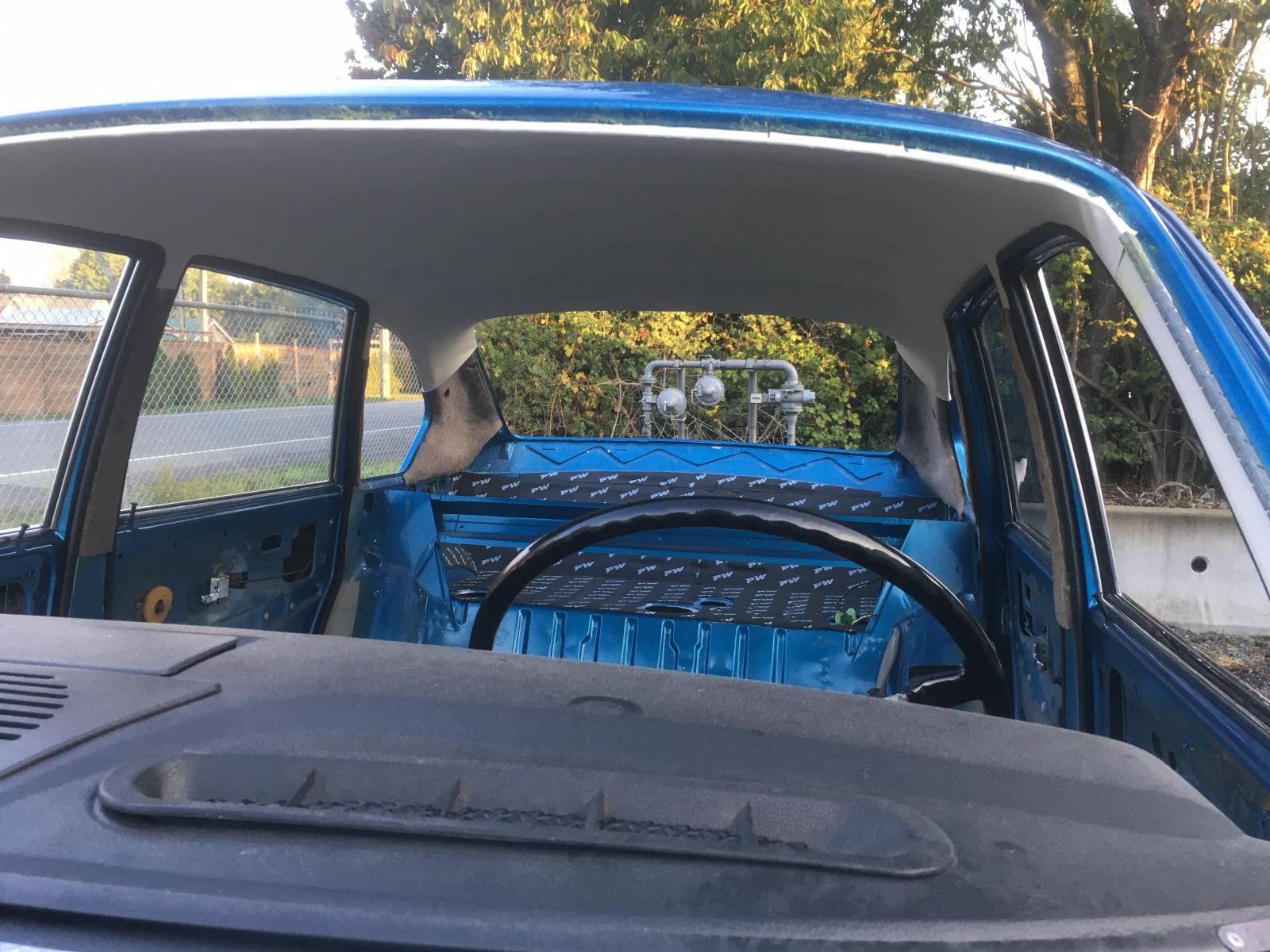

PostPosted: Wed Oct 18, 2023 8:58 am    Post subject: Re: Walt's 1973 412 Barn Find Reply with quote
The windshield(s) arrived yesterday from Pilkington, UK. The shipping is expensive so it only made sense to get 2 windshields right away. I ordered them in March and they arrived in October. So you have to be patient. Here is the crate they came in.
And how the inside looked like.
Headliner is in.
At the moment, the transmission and engine are being installed. Can't wait to hear the engine running.
Then back to the upholsterer to finish up the interior.
Eventually...it will get done.
Cheers, Walter

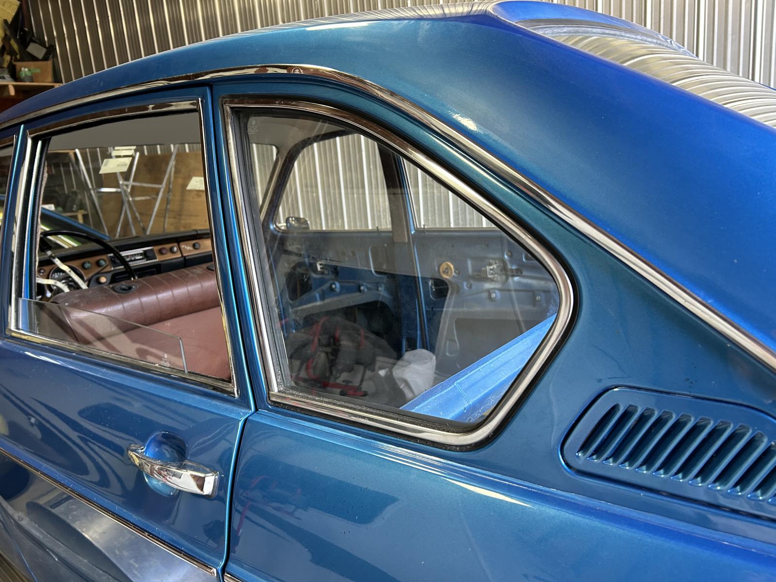

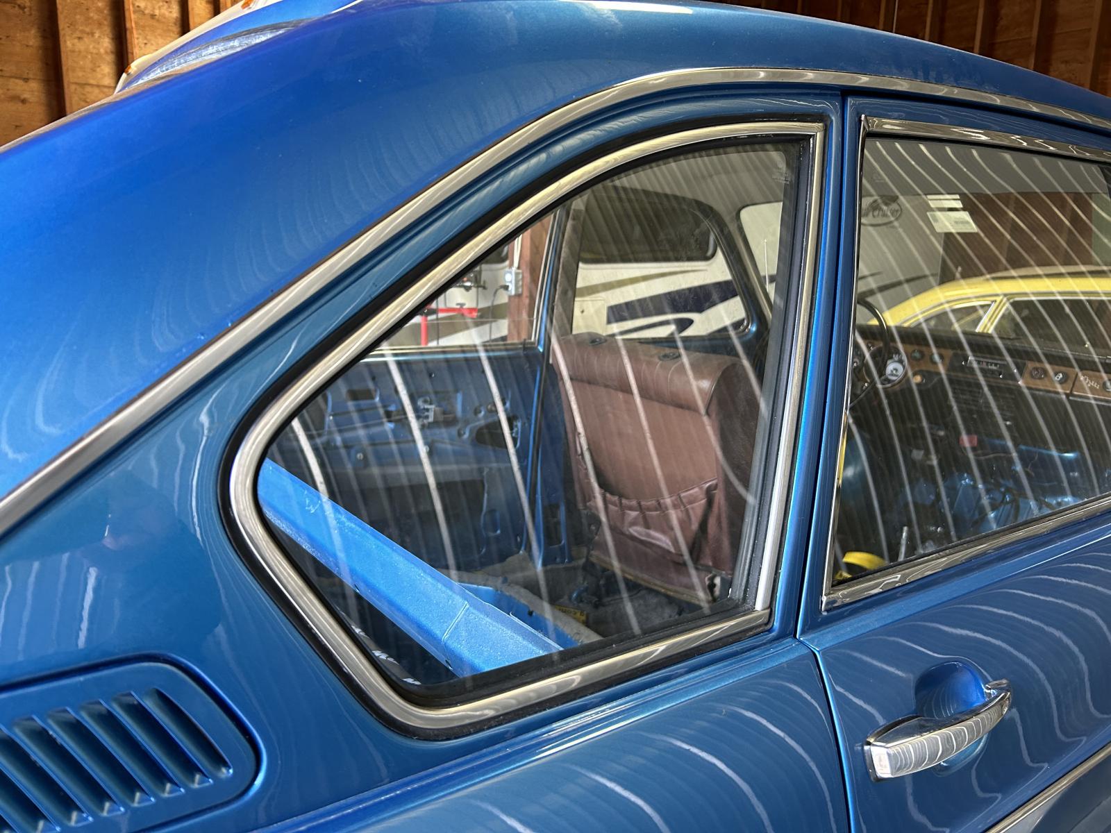

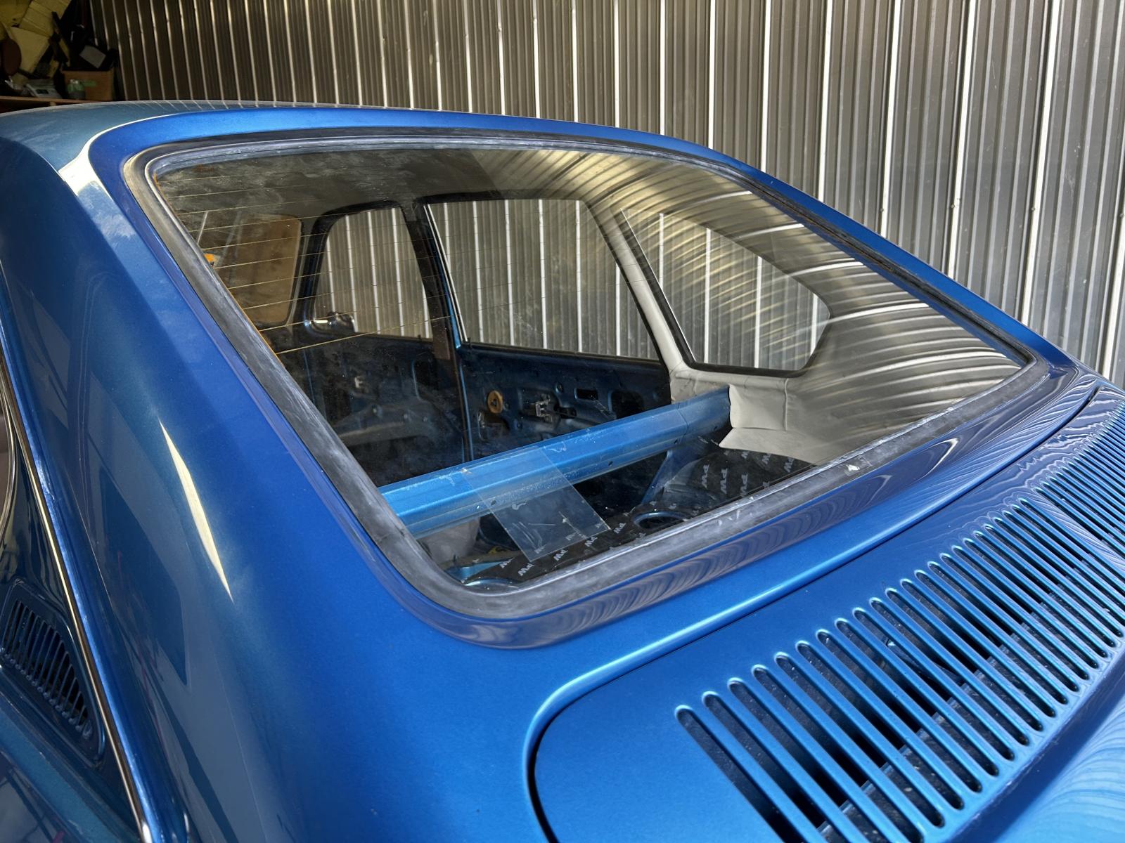

PostPosted: Sun Feb 18, 2024 8:52 am    Post subject: Re: Walt's 1973 412 Barn Find Reply with quote
After taking the winter off (so it seems), I'm back. The upholsterer finally got around to installing the front windshield and the rear windows. Now it will be heading to the mechanic to see if the engine will finally start. He claimed we needed a new fuel pump and an ECU. Let's keep our fingers crossed that this will do the trick. If so, then back to the upholsterer for all the rest. The brown seat in the pictures is only temporary...so don't panic! Cheers, Walter
Front windshield from Pilkington's; the chrome trim needs to be inserted yet:
Right rear window:
Rear window...hopefully the defroster works; also needs the chrome trim inserted:
Left rear window:
Sorry about the quality of the photos...should have taken them outside!

Very nice!
Do yourself a favor.....test the defroster BEFORE you install the glass. First just check the ohms between the two male terminals. If you do not read resistance it's got a break somewhere.
Also.....fuel pump I can see for sure if it's been sitting. If the pump does not run and voltage is there ....sure it needs a pump. Also if the pump runs and fail volume test, volune at pressure test or leak down test. You need a pump. Test the leakdown of the fu pressure regulator as well. If the pump is bad at this age the regulator suffers from the same issues.
You need to inquire as to HOW it was ascertained that an ECU is needed. That would be EXCEEDINGLY RARE. Just because it does not start does not indicate it needs an ECU.
If the ECU has been visibly submerged and is corroded....sure. Do not replace the ECU until all else has been set to spec. Throwing an ECU at a car where the ECU is not the real problem, may get it to start simply because the output specs from ECU to ECU are different enough to cause a change in fuel mixture.
Ray

PostPosted: Sun Feb 18, 2024 2:05 pm    Post subject: Re: Walt's 1973 412 Barn Find Reply with quote
We have missed you Walter.
Yep, totally agree with Ray on your Computer/ECU. It would be very rare for it to be bad unless it has been abused. There are alot of other components that are problematic, including the wiring harness for the injection. My original harness checked out ok after doing a bunch of resistance and continuity tests. I had to rebuild my MPS and also get new trigger points. I also had to rebuild my fuel pump. I wanted the stock pump so sent it to Mr. Adney for a going over. Works flawlessly! Oh, almost forgot… new fuel injectors also. It’s all in my 2 threads. It was a few months of persistent sweat to get this engine right!
Beautiful work on the windows and rubber! What front windshield rubber are you using? Do you know what type of trim is going to fit? Also same for the rear window. My rear glass defroster quit working years ago… it is the original. It did not matter to me so I repurposed aand modified the rear defroster circuit to light up my fog lamps. A perfect fit for the fog lamps because of the higher amp draw for the defrost window originally. Wish I had a nice dedicated fog light switch like yours. Oh well…

PostPosted: Mon Feb 19, 2024 1:28 pm    Post subject: Re: Walt's 1973 412 Barn Find Reply with quote
I'd say this is a noob question but since I don't own a Type 4, I don't even qualify for that name!
But unlike all other VW window trim, does the Type 4 trim go on after window installation, or does it have to be inserted into the rubber before the window goes in?

PostPosted: Mon Feb 19, 2024 3:48 pm    Post subject: Re: Walt's 1973 412 Barn Find Reply with quote
If you are talking about the original seals and trim that the car came with, the method is the same as the older air-cooled cars. Meaning with the rubber fitted on the glass first on a bench or table. Then the trim is inserted carefully into the rubber with the end clips. With everything together, the complete unit is then installed in the car.
Now, I have noticed that on Walter's 412, he is using a seal that has only one channel or groove. This is a later style seal that was common on Super Beetles. This trim has only one point of attachment unlike the earlier style trim that had two. It was a C channel style.

PostPosted: Tue Feb 20, 2024 6:16 am    Post subject: Re: Walt's 1973 412 Barn Find Reply with quote
So I did, 3 Years ago. It took nearly as long, but delivery directly to the distributor who did the implementation.
https://www.instagram.com/p/CLrCFOyF8OQ/?igshid=bl5k3k3uy6tg&img_index=1
I'm still glad, that I have changed it, much better sight in the nights.
And it is the laminated version, much safer in case of damage.
Best Regards from Germany, the origin country of Volkswagen.
