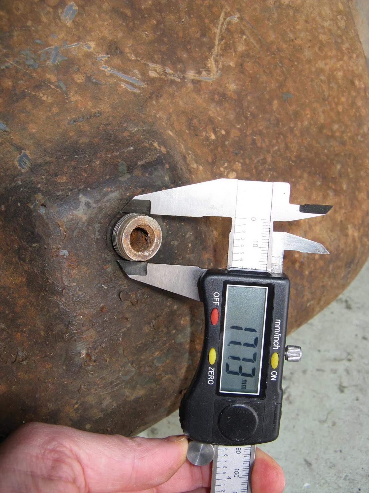

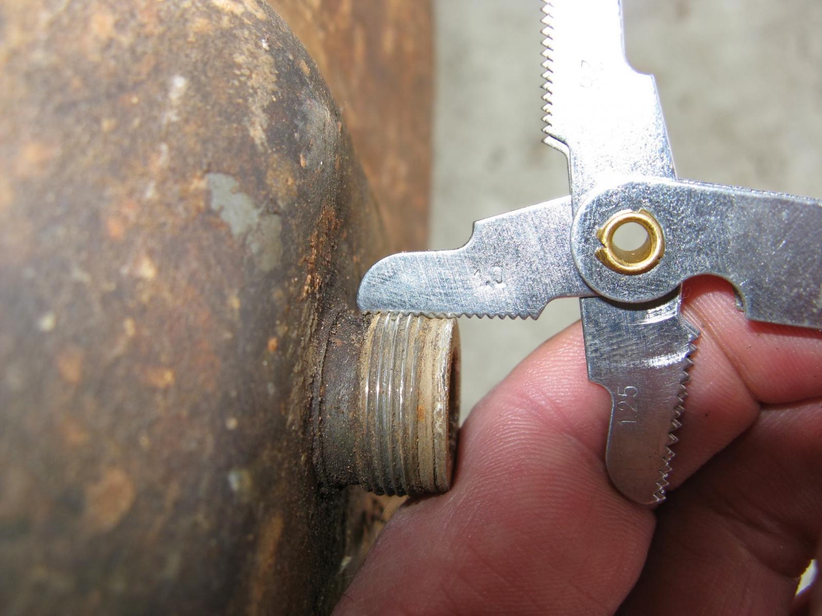

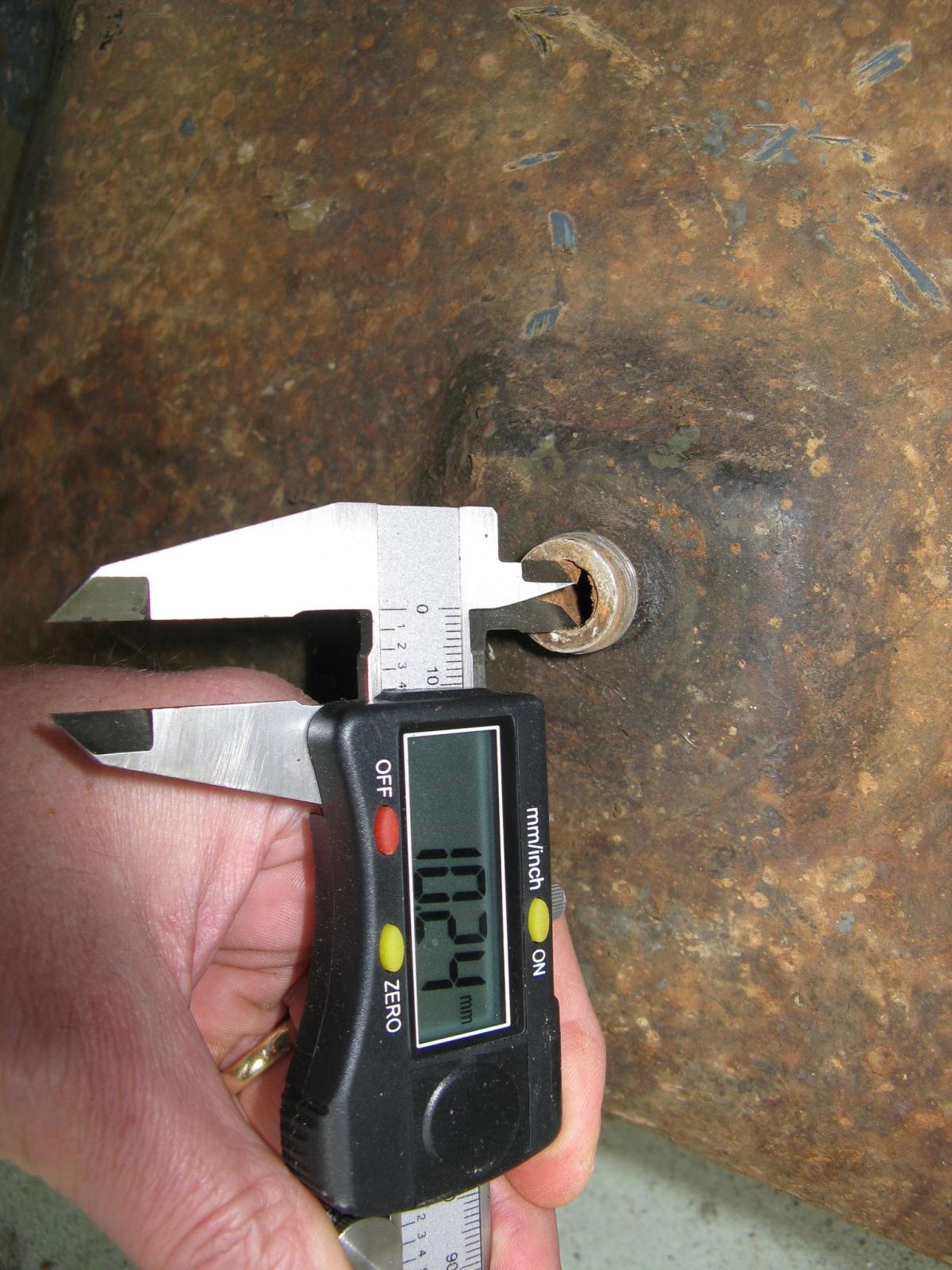

Do anyone know where to get an M18x1.0 die? I have looked, but not found anything.
redhot
Joined: February 05, 2005
Posts: 447
redhot is offline
PostPosted: Wed Dec 10, 2008 7:45 am    Post subject: Reply with quote
Can anyone confirm if it is normal right hand thread, or left hand?
Found some dies:
http://buy1.snapon.com/catalog/item.asp?P65=&t...ir=catalog
http://www.hermanscentral.com/product/qual-tech-18-x-1-metric-hex-die-carbon-steel-3847.cfm
redhot
Posts: 447
redhot is offline
PostPosted: Thu Dec 11, 2008 9:41 am    Post subject: Reply with quote
Just found this post:
http://www.thesamba.com/vw/forum/viewtopic.php?t=300050&highlight=m18
Where it claims to be a M18 x 1.5 thread. Here it is said to be M18 x 1.0
Do anyone know if the thread type changed over the years and when, and also is it left of right hand thread? I don`t have the tank here with me, so can`t check before I buy a tap.

Old post, but while I was measuring, I thought I would share:
Looking at an early 1955 tank, the threads on the tank are M18 x 1.0 pitch right hand.
The fuel tap that attaches to it has the same size and pitch but the threads on the tap are left hand.

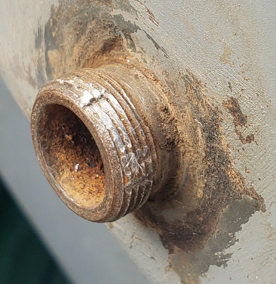

Quick question..I noticed this weekend that the fuel tap seemed to be slightly leaking so, I proceeded to remove the tank & tap (been in there since I purchased) and found the threads to be bunged up. Any thoughts on if these can be salvaged or am I up a creek and need to search for tank?
Thanks.

Hey Mud
Pretty sure you can clean those up.
If you don't have a metric thread file - well, go buy one - OR just use a small triangular file and judiciously go round and round with it and I bet you can clean those up to a point where they will hold fast.
Make sure to use new gaskets on top and bottom of the screen when you reassemble.

Riff Raff wrote:
Hey Mud
Thanks, I ordered up a Die and took my time to get the threads lined and looks like it worked out well. Threaded on the petcock and it's sitting over a container with gas to look for leaks. I did find a nice used tank that i picked up..just for the spare in case.
