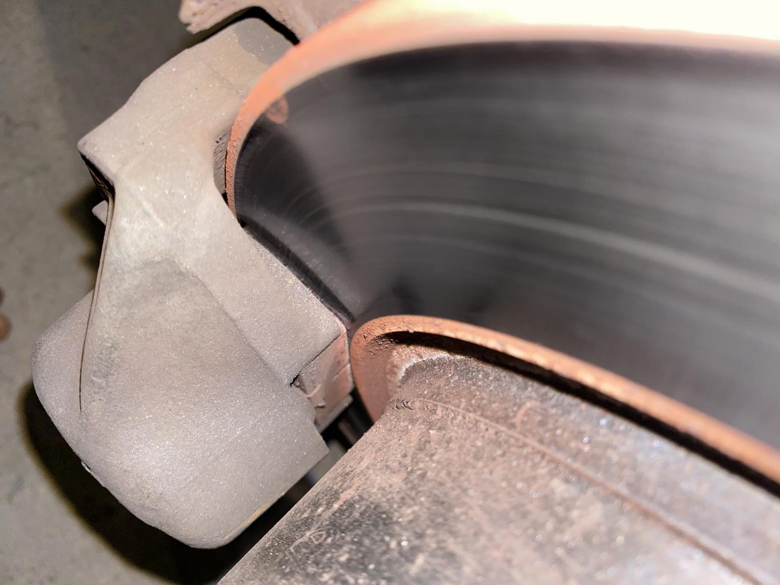

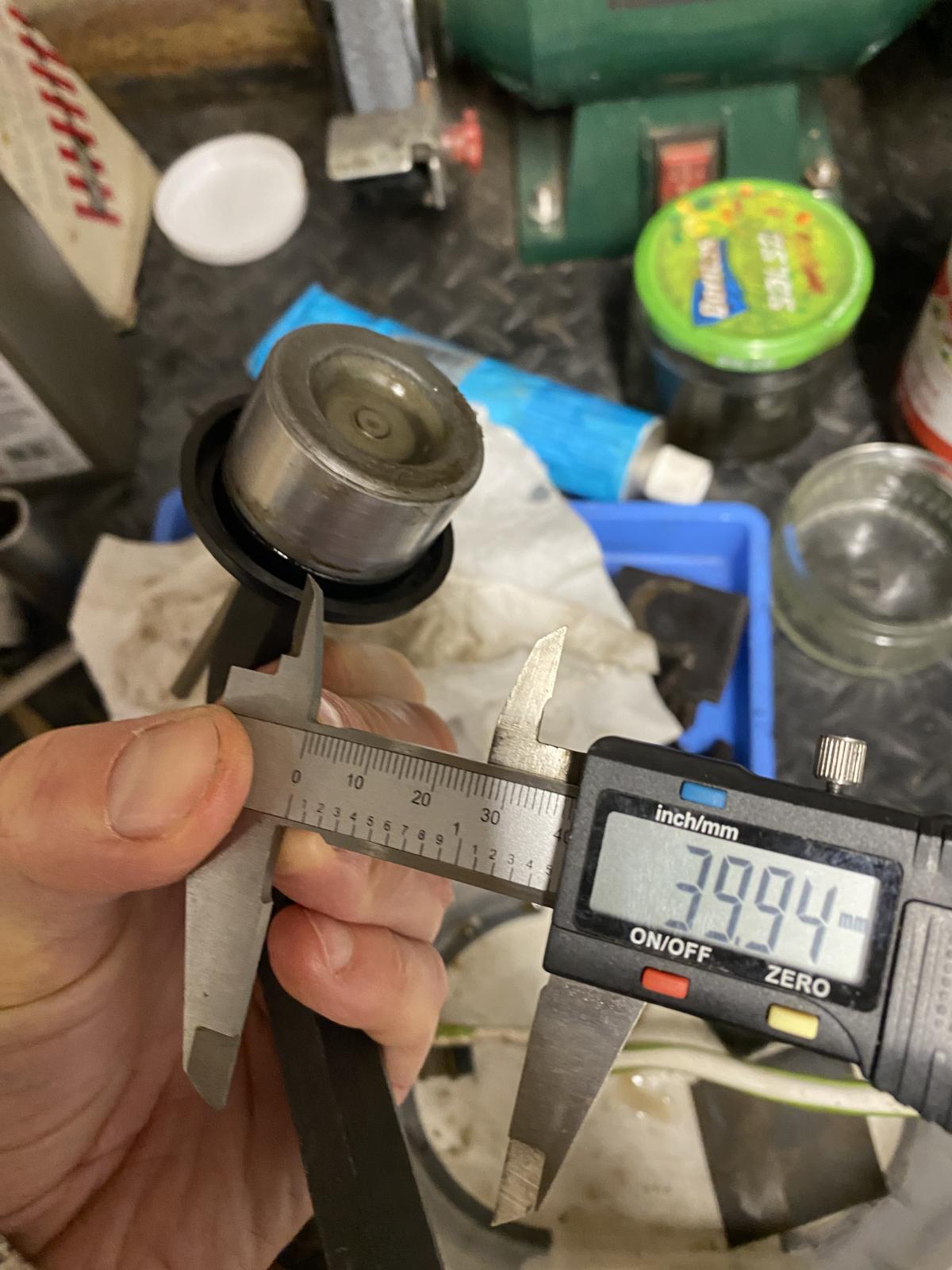

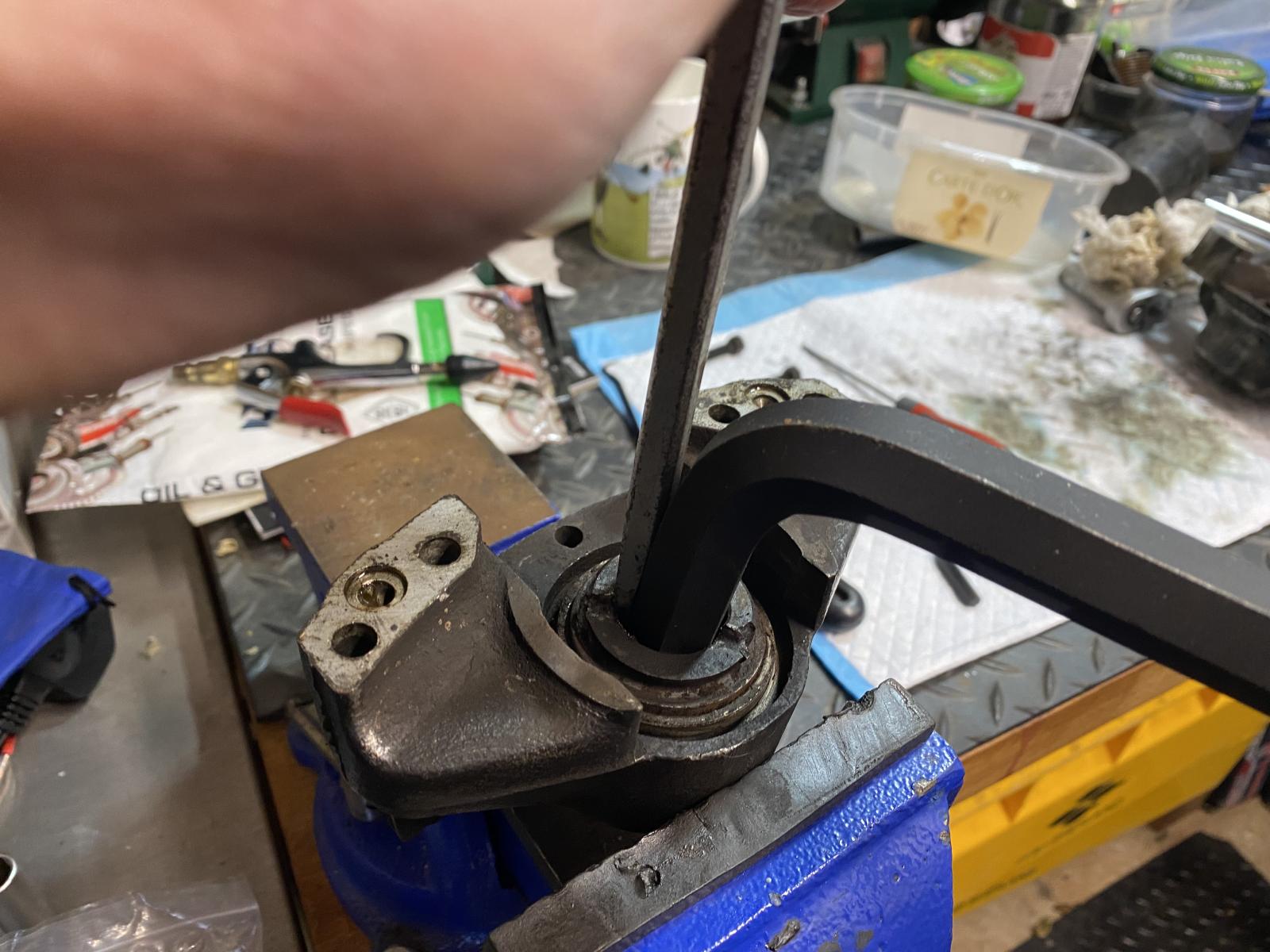

I have been working away on the brakes for the Ghia since the pistons stuck and were temporarily fixed in the summer. I have taken the calipers off and of course the dust boots were shot. I had ordered a rebuild kit several months ago but they had sent the wrong pistons (too large and no cut out for the shims)! They kindly sent replacements and I have rebuilt the calipers, but annoyingly the anti rotation shims don’t quite fit in the new pistons. I’m considering adapting them or leaving them off. Suggestions welcome!
My DIY tool for removing the pistons is a large hex key, jammed in with an aluminium handle-works perfectly!
While the calipers were off I took the chance to remove the discs and bearings and sent the splash guards for powder coating. They are in remarkably good condition and I doubt I would get an exact replacement, so it’s worthwhile.

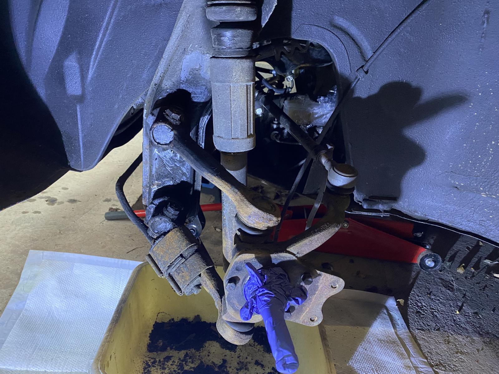

PostPosted: Thu Jan 25, 2024 1:59 pm    Post subject: Re: Late 1969 Ghia vert preservation/ restoration Reply with quote

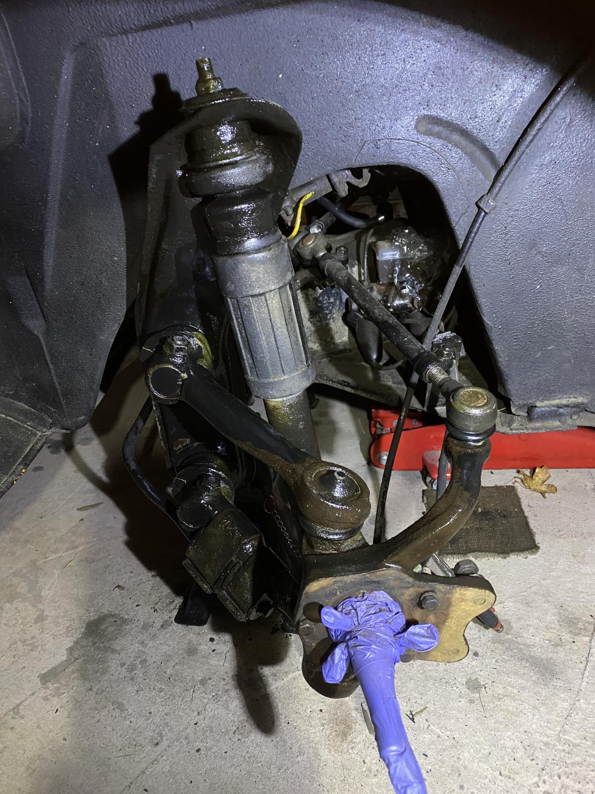

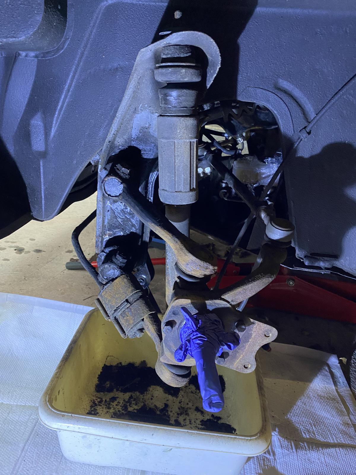

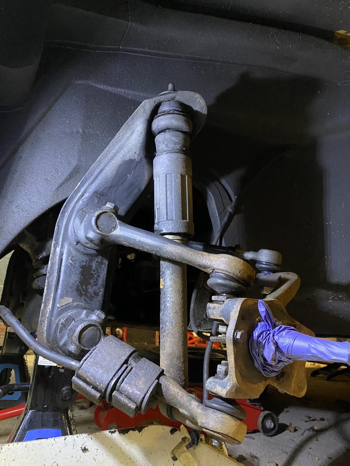

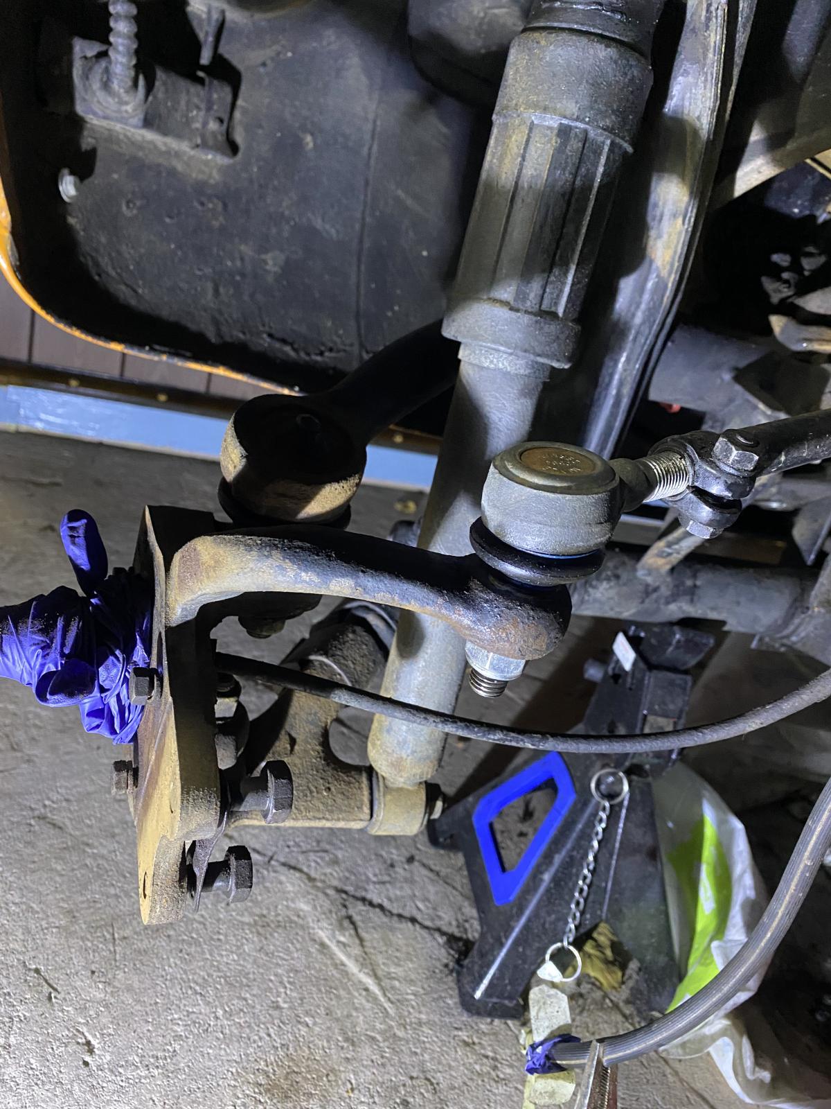

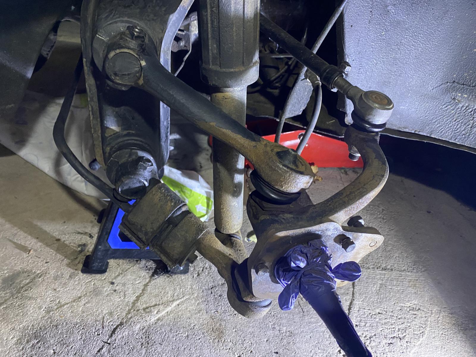

Having rebuilt the brake calipers now, I have been working away on the Ghia, an our or two at a time. My main aim is to clean and protect the wheel arches while I can get to them but I haven’t been very good at taking pictures as I go!
The suspension and steering components have been thoroughly cleaned with paraffin and alcohol, the surface rust will be wire brushed, and the rubber treated with glycerine. Then everything will get a coat of Lanoguard grease and/or protectant.
Some pics:

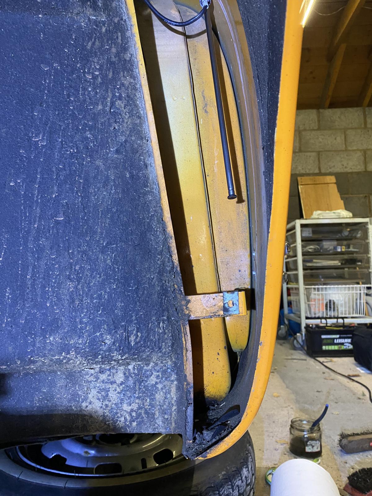

PostPosted: Thu Jan 25, 2024 2:01 pm    Post subject: Re: Late 1969 Ghia vert preservation/ restoration Reply with quote

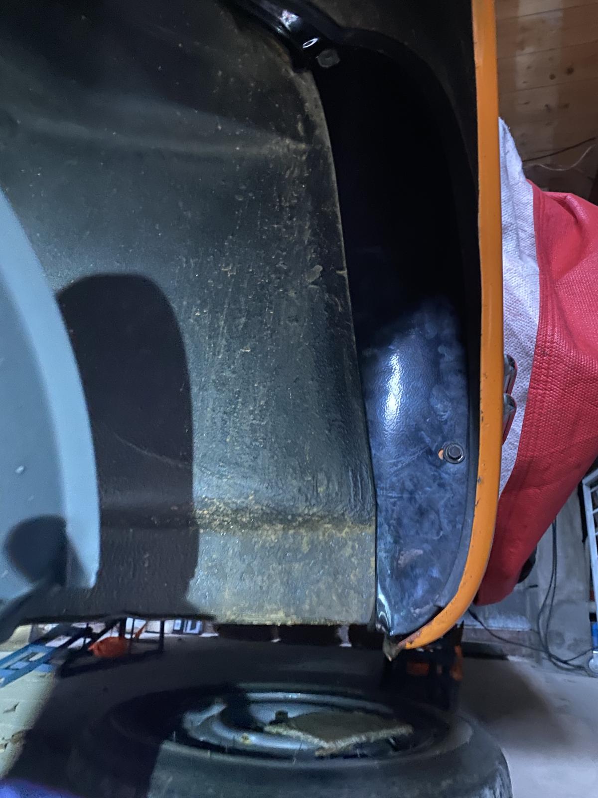

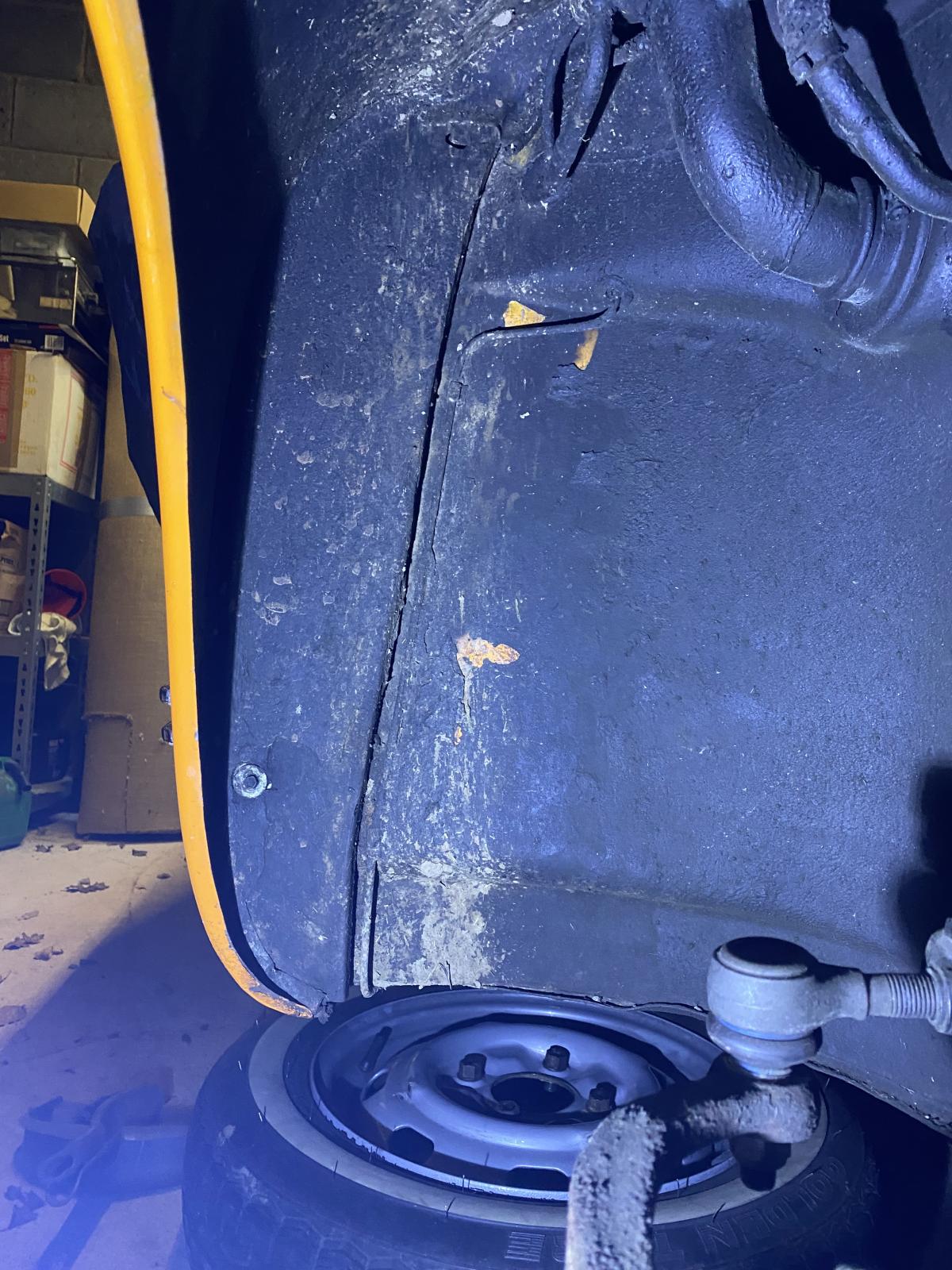

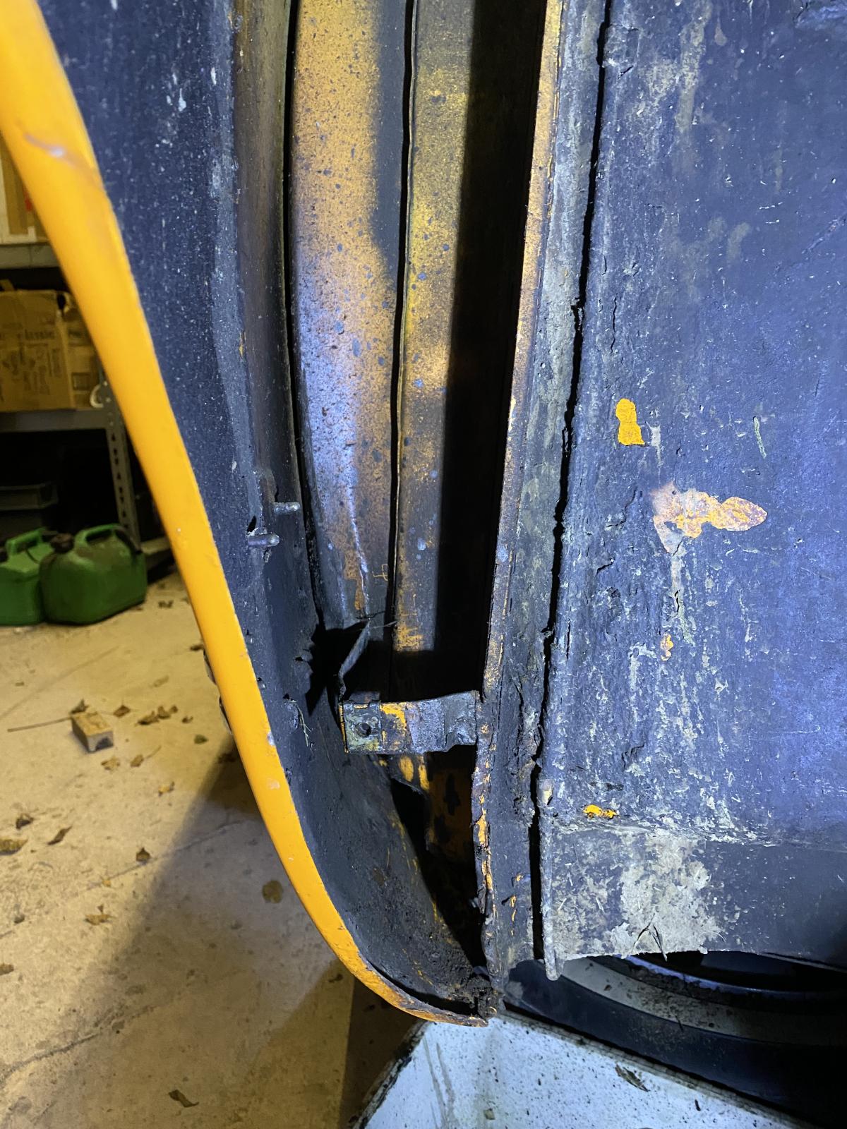

The actual wheel arches still have most of their underseal in place and don’t look too bad. I will top up the underseal where it has flaked off and possibly Lanoguard over the top.

PostPosted: Thu Jan 25, 2024 2:09 pm    Post subject: Re: Late 1969 Ghia vert preservation/ restoration Reply with quote

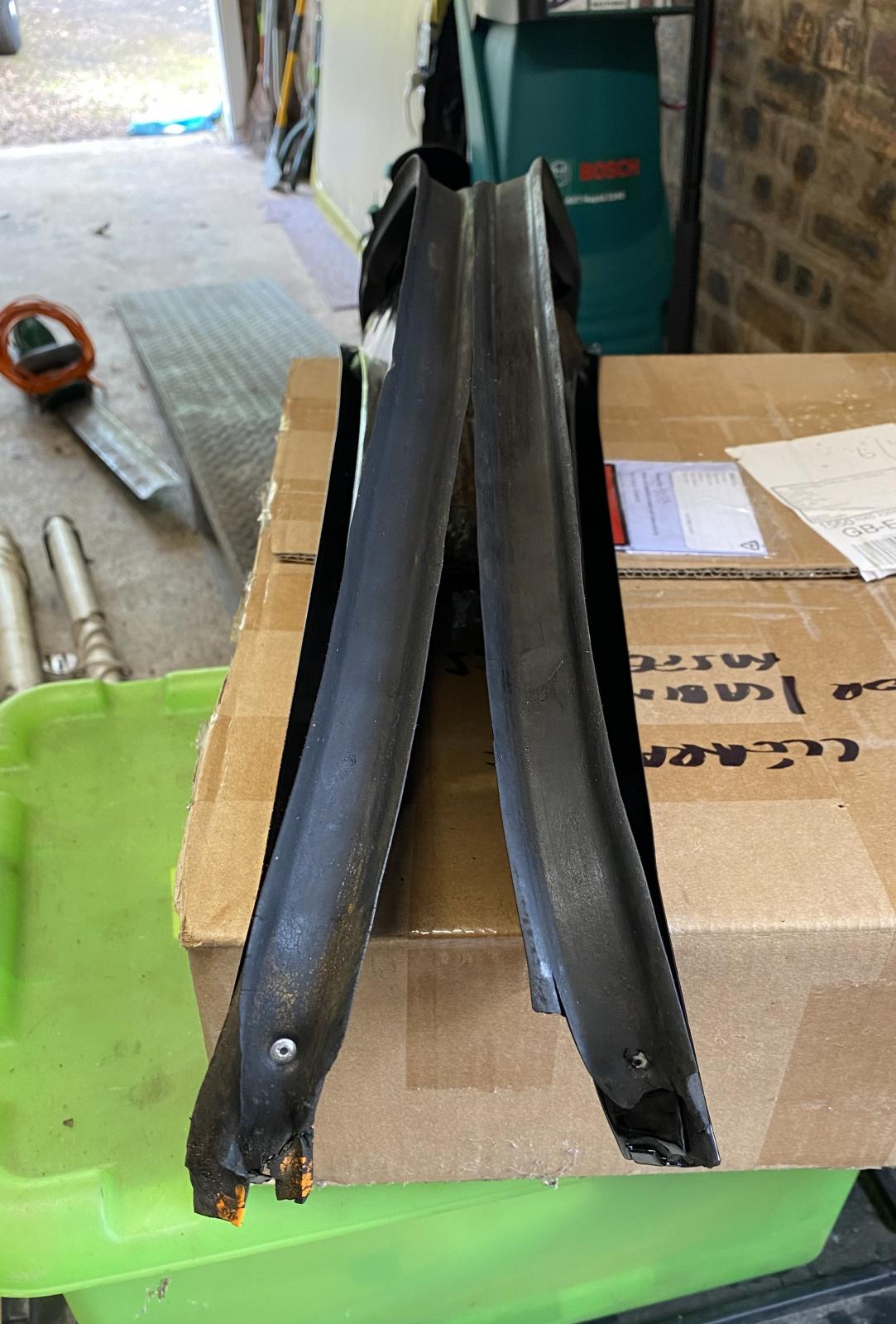

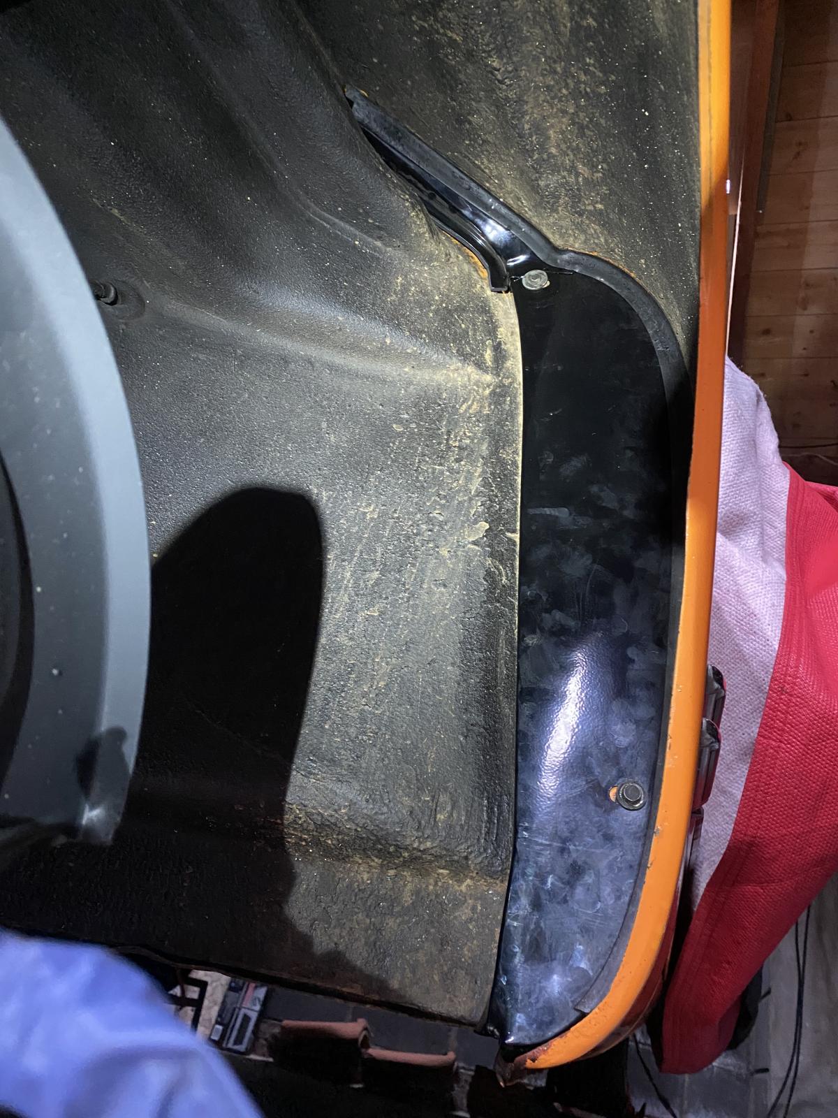

I was keen to inspect behind the splash panels, but I didn’t anticipate it being quite such a pain to get them off. Not helped by shearing on of the top bolts that you reach from the trunk but I have tapped a thread for a fresh bolt and the panels will go for powder coating, as they are solid but with a little surface rust. The rubber seals were intact but covered in underseal and grease, so I cleaned them up and have reconditioned them with glycerine and they look reusable. They are held on by three small nails, but I think I will rivet instead. The top ‘tongue’ section was sealed with an adhesive strip of thick foam which had totally degraded and I’m not sure what to fill the remaining gap with, possibly I’ll just go with ATV?
The area behind the splash panels just had a bit of surface rust and so I’ve sanded it back, treated the rust and painted on red oxide primer.

Wonderful documentation. Someday, I've got to put the splash guards on my 71 and your pictures will be very helpful. Amazing that the metal behind the splash guards has stayed so well preserved!.
Thanks Marc.
I am amazed by the condition of the splash guards, with just a bit of early rust down at the bottom ends, but I’ll be happy with them powder coated. I was keen to preserve and reuse the rubber seals if I can, they look a bit different from the replacement ones and I’m sure they had never been off! A real pain to clean off 90% of the underseal, but they are looking much better with the glycerine soaking in and that usually works very well to soften and recondition rubber seals.

I’m not about to dismantle the steering/suspension components at this stage, so I have wire brushed off the worst surface rust and then applied a lanolin based grease and liquid underseal to slow progression (and protect some of the bolts etc)

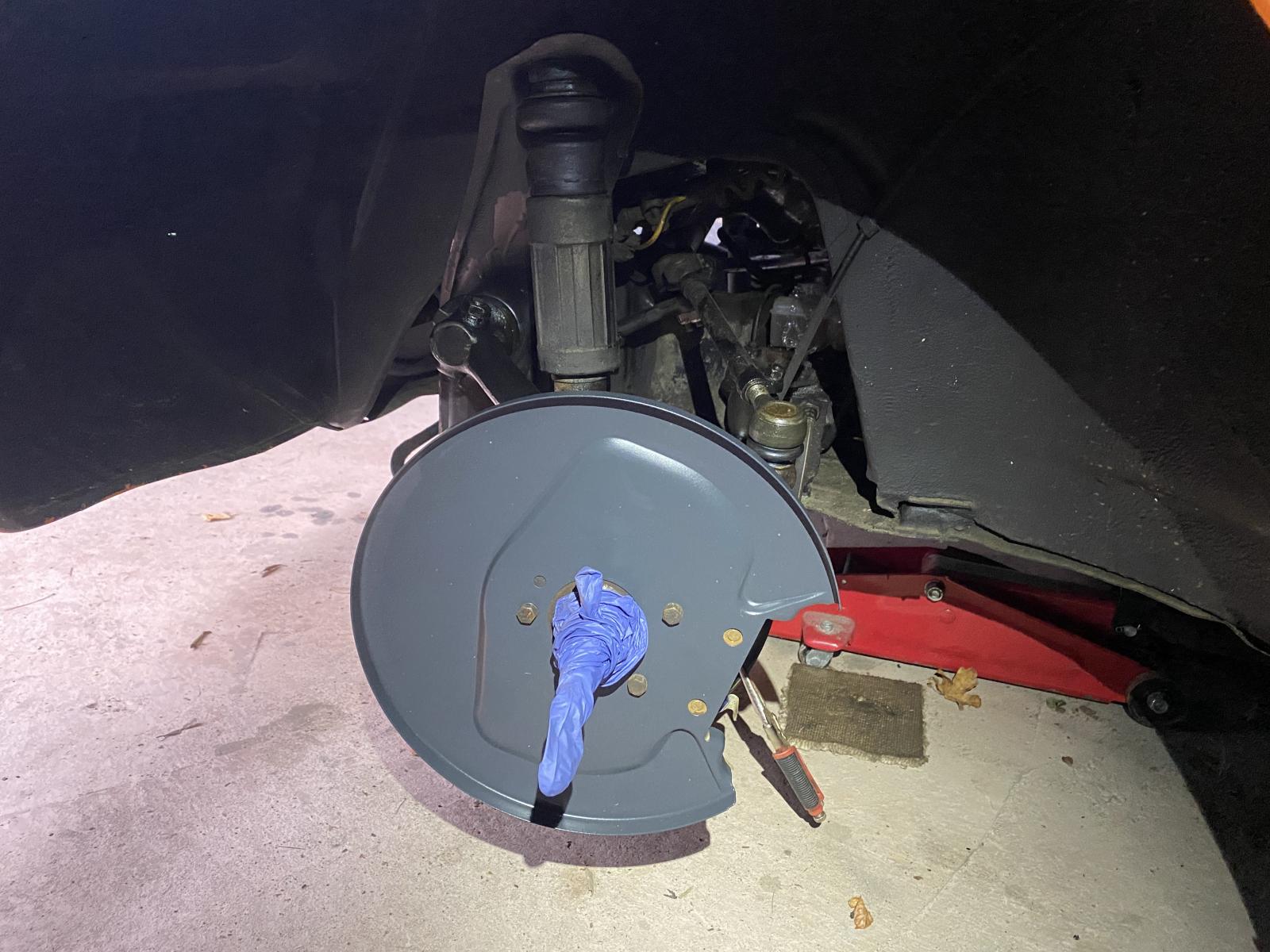

Rebuilding the front end continues. Slowly.
Powder coated disc splash guards ON.
Disc and bearings ON. I couldn’t find my dial indicator, so I adjusted by the ‘just able to wiggle the thrust washer under the bearing lock nut’ method!
Wheel arch splash guard ON
I am ready to connect up the brake calipers, but I am stymied by the old rubber hoses, which are at least 25yrs old, stuck fast to the hard brake line. I have left them with some penetrant for a couple of days while I find the right spanners to be able to squeeze them together to release the connectors.

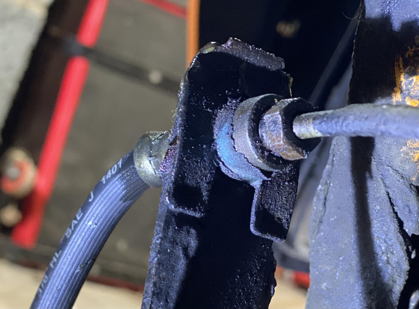

PostPosted: Mon May 27, 2024 12:32 pm    Post subject: Re: Late 1969 Ghia vert preservation/ restoration Reply with quote

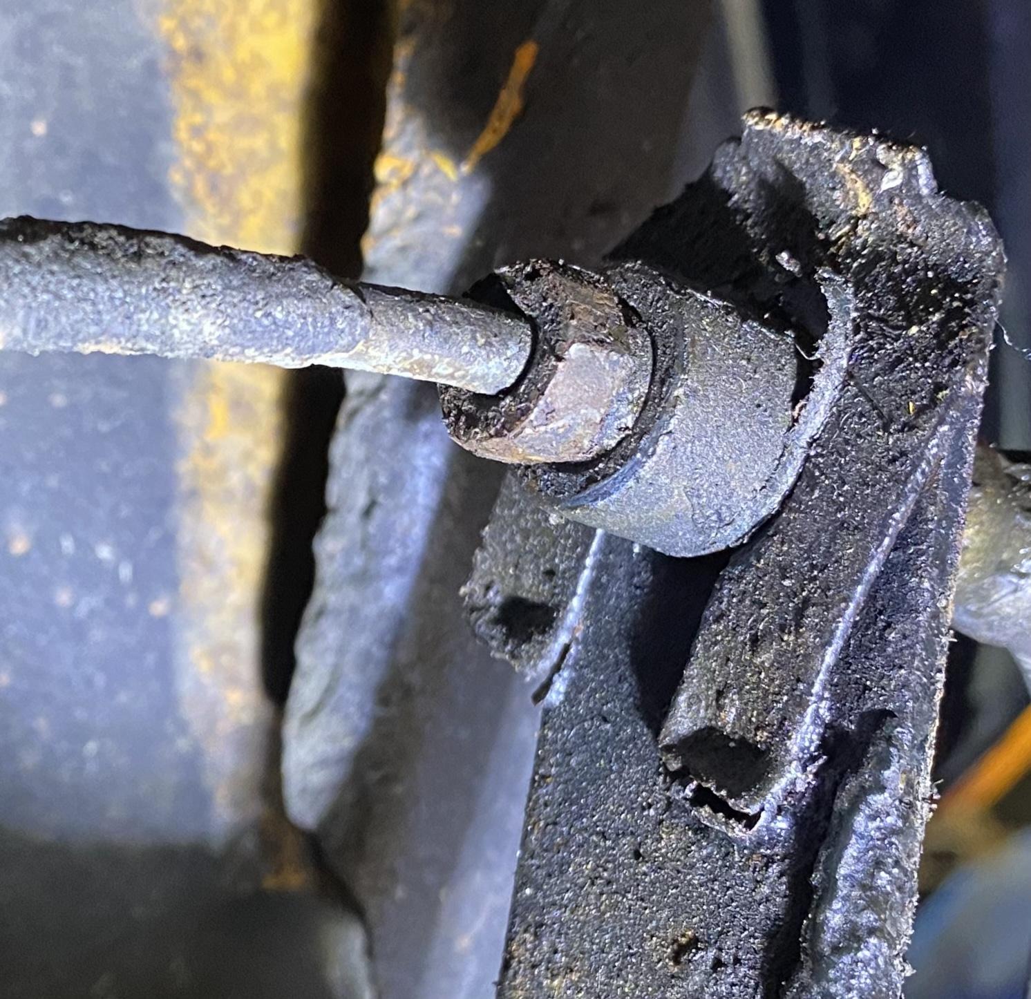

I am driving myself slightly demented with brakes on the Ghia.
After a caliper/piston failure last year I have rebuilt the calipers and am in the process of replacing the flex hoses all round, some of which date from 1984!
My problem is that the union between the flexible and hard lines at the front is stuck solid. Even my flare nut spanner is rounding off the nut. Even when I removed the hard line at the master cylinder and took it out of the car I couldn’t get it loose! Fine, I thought, I’ll just replace the hard line as well and I have CuNi lines coming.
The rears though are similarly stuck and part of the problem is the hose inner end is attached to a 2/3 way brass block on a bracket which doesn’t allow you to exert full force. I eventually got one of the hoses off with the bracket only to realise that my spare rear hoses are female/female and I need M/F!
So. Question: I can order the three flexi hoses I need, but for about twice the price I can have Goodrich stainless/PFTE braided hoses with a lifetime guarantee…
I’m tempted to go for the braided but keen to hear any thoughts.
Pics of the brass block (and the general area for no good reason)!

PostPosted: Mon May 27, 2024 1:42 pm    Post subject: Re: Late 1969 Ghia vert preservation/ restoration Reply with quote
Oh the wo's of old car ownership. It sounds like a PO might have been a bit heavy handed tightning these up, because of the flares they don't need much to make them seal.
I have had a a bit of luck with home made penetrating fluid, 50% ATF and 50% acetone, it 'might' help.
I like the braided hoses, and have run them for 20 years and they never swell or go soft like rubber hoses. If available, I'd get the ones with the clear PVC cover so they don't scratch anything. the brake feel is noticably better than stock hoses.
at the back when undoing the lines, I have been able to get a pair of vice grips on the brass block to take some of the stress of the little bolt the goes through it
mcdonaldneal
Joined: June 13, 2013
Posts: 2733
Location: Gullane, Scotland
mcdonaldneal is offline
PostPosted: Mon May 27, 2024 1:50 pm    Post subject: Re: Late 1969 Ghia vert preservation/ restoration Reply with quote
Thanks for that Ian. I had thought the same about a pair of vice grips. It’s a pretty tight space but I have a couple of different options. I’ll have a go tomorrow.
