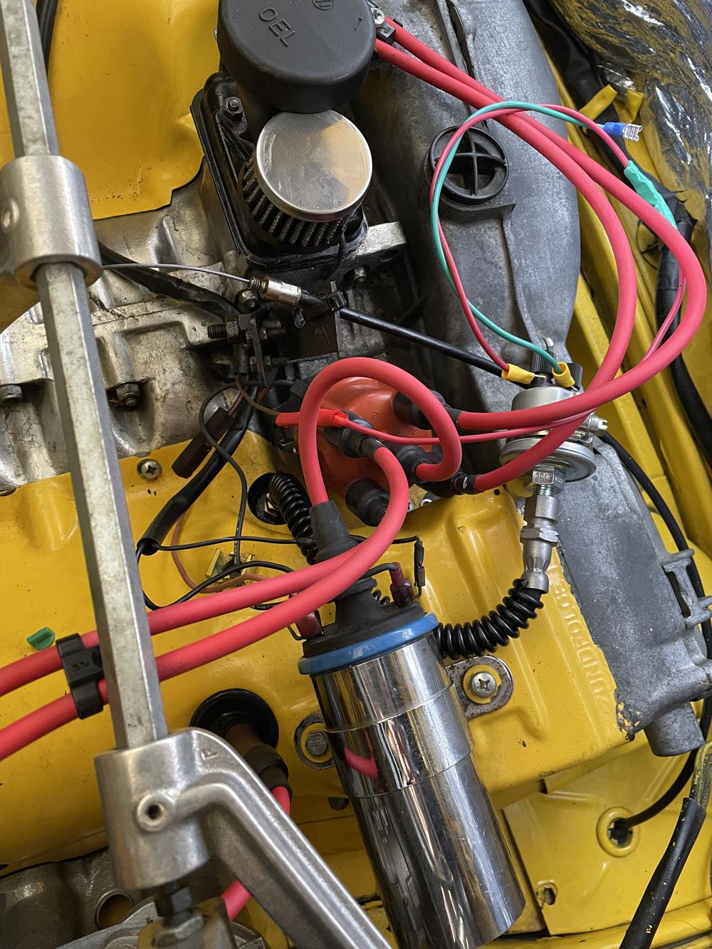

PostPosted: Fri Apr 12, 2024 2:28 pm    Post subject: Re: Wiring up an oil pressure gauge added to a 914 center console Reply with quote
Well, this post isn't strictly about wiring-up the two-pole engine oil sender... Rather it's more about installing that sender, given the challenge of adding a two-pole (one to oil pressure idiot light, the other to an oil pressure gauge) sender to the engine, given that damnably small access hole where the idiot light sender normally screws in (using a 24mm deep socket to remove it).
See the attached three images that show AUTO ATLANTA's nifty oil pressure sender extension hose assembly. These are available from several other sources, of course, but interestingly their use also involves some challenges of their own, since that damnable pressure sender hole is so small (and submerged inside the outer sheathing).
Actually, you'll need to have a cut-away 14mm deep-socket, first of all, in order to install the correct brass adapter required in the sender hole after you've remove the OEM idiot light sender. But then you'll need two of those SAME brass adapters (stacked on top of each other) in order to get the extension hose collar above the sheathing (otherwise it's tough to be able to get a suitable wrench on it for tightening purposes). Then, if you're not careful, it's all too easy to accidentally drop an adapter down onto the engine itself (requiring fishing it out with a long-nose forceps or hemostat). [If you smoke 'funny stuff', no problem finding a hemostat...er...'roach clip.' Laughing
Assuming you aren't tres clumsy (like me...I was born with 5 thumbs), that's most of the 'tough' work required. The next step is to determine how long you need to cut some wire lengths to attach to the two sender poles (the 'WK' terminal goes to the idiot light, the 'G' means 'Gauge, NOT 'GND'). After this, the new two-pole sender needs to be grounded to the engine casing (which I was able to do easily enough...see attached images).
Since there's already an idiot light wire going directly to that warning light on your instrument panel, the only thing left to do is run a separate wire from the 2nd sender pole ('G') to your oil pressure gauge, up in the cockpit. [Every time I am forced to go into my car's center tunnel, I usually make sure I've installed a couple of extra spare wires in there, running from the engine bay to the instrument panel outlet., so as to save a lot of needless extra work.]
Make sure you use the appropriate copper washers (as and where appropriate) on the adapters and DO NOT over-torque them. Since the adapters use tapered threads, over-torquing can really screw things up.
Grounding the sender body to the engine casing IS necessary and use of as extension tube assembly like mine (AUTO ATLANTA) enables the new two-pole sender to be installed anywhere with reach of the attached hose.
