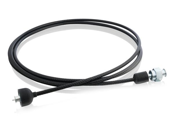

Hi Ray. I seem to recall that one of the Pelican Parts reviewers of the GEMO 914 Speedometer Cable (91464111101) cable said:
Customer Reviews
Here's what our customers have to say about this part:
(2)
Michel Scrobonia July 16th, 2020
Attachment to transaxle:
I had already spent an hour pulling the old cable and installing the new one. I followed instructions to tie front of new one to end of old one and pull thru chassis. it does not work that easy. First their are clips holding down the existing cable, so you need to remove anything covering the center console. Second, the threaded connector on the end of the old cable has to be removed to fit through the hole in chassis. To do this I hacksawed the connector down the side and sprung it open with large screwdriver until it could fit over cable. I was done except for screwing on the new connector to the transaxle. It did not fit. The threads did not match. I ended up sliding that connector out if the way and tie wrap it. Then I took the original I hacksawed off and fit it over the new cable and with very large pliers, I squeezed it close to its original shape. I was now able to screw the cable to the transaxle. I safety wired it to the transaxle to ensure it did not back off. I wrote a letter to Pelican afterwards, but received no explanation for the connector not fitting.
(1)
Brian Butler June 19th, 2020
Incorrectly manufactured
Angle drive end had a left hand thread fitting on it. Customer support has toyed with me for 9 days on getting the item returned. Sent requested pictures, and all I'm told is it is the correct part number. They also want me to pay for shipping to return the faulty cable...
Auto Atlanta sells the GEMO cable without any alerts, so the reviewers may be incorrect. It's unclear to me.

PostPosted: Sat Apr 06, 2024 10:13 am    Post subject: Re: 914 speedometer cable replacement? PORSCHE OEM or other? Reply with quote
and the boot is on backwards! It was supposed to cover the entry to the firewall NOT the connection to the angle drive. Currently gemo is not avaialble, and the other german one has no boot at all! The factory ones we have are MUCH too expensive. The german ones are however inexpensive at about 38 dollars as of 4/6/2024

and the boot is on backwards! It was supposed to cover the entry to the firewall NOT the connection to the angle drive. Currently, Gemo is not available, and the other German one has no boot at all! The factory ones we have are MUCH too expensive. The German ones are however inexpensive at about 38 dollars as of 4/6/2024
Thanks for that information, George! I may just order the German one and 'have-at.'

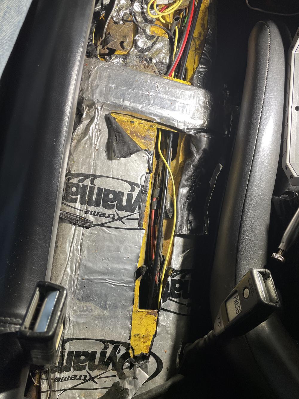

Hi gang. OK, got two of the 'German' speedo cables and a GEMO unit The connection on the GEMO (which appears to identify my existing cable as also a GEMO) is too #$#^&^%@! large to fit easily through the central (ventral) tunnel, so I used one of the 'German' cables, securing the 'head-to-end' connection (with wire and duct tape) as suggested before attempting to remove the old cable (thus pulling the new one through the tunnel). Surprise-surprise! It doesn't want to go through; I can only assume that, because I loosened all the wire clips holding wire bundles in place before starting all this kerfuffle, it is lodged on some obstruction in that %$#*&!@ narrow tunnel channel!
"Go ahead and do it...it should be simple!" they said. "Should pull through and problem solved," they said. "Should be relatively easy," they said!" NOT!
So there I am. Cable connection somehow wedged against something I can't see in the after section of the ventral channel near the firewall and not budging, with no idea what to do next (except pull the speedo cable out from the front again...and return to square one!). Grrr, grrr!
Any suggestions from anyone? I seem to be dead in the water at this point.
Given that that ventral tunnel is already so crowded with wire bundles, etc., I've half a mind to simply run the speedo cable under the carpets to the rear of the car. I readily admit that that's an extremely half-arsed and amateurish way of solving this problem, but it certainly would be a LOT less fraught with challenges that trying to squeeze that bulky connection (between the cables) through the tunnel's constricted confines pose! Anyone ever admitted to solving this problem that way?
I also have no buddies to work on this with me...strictly a solo affair...so the 'under the carpet' solution seems at least doable.
PS: Below are several shots of the verdammte scheiss ventral tunnel and one of the GEMO speedo cable ends (which, when joined, comprised a BEEEEG obstruction to have to fit through that verdammte tunnel!)

PROGRESS UPDATE: OK, just checked my email trash (all 250 of the entries probably from as many commercial companies), set my teeth and began tackling this speedometer cable problem again today. After checking the access as much as my rapidly fading LED shop-light would allow, it became painfully apparent that whomever had put the previous speedo cable in had surfaced it so that it was sandwiched between two metal fuel lines (how they ever got it in THAT position I'll never know).
It was at this point pretty obvious that this was the...as the Germans put it...Schwerpunkt ('focal point' or, in my case, "hard place"). No way I could further maneuver the speedo cable past that 'Y' juncture some idiot had cleverly wedged the speedo cable between. What to do?
Finally, I decided to get out my cable cutter and sacrificed the cable by cutting off its proximal connector, so that I could attach a heavy gauge wire to it and pull it out the rear of the ventral tunnel.
With that done, I now have that heavy gauge wire inside the tunnel, within the channel through the ventral channel. The next part of this odious problem involved connecting the proximal end of the cable (the Speedo end) to the proximal end of the heavy gauge wire and (hopefully, fingers crossed) pull the new Speedo cable through the ventral access tunnel into the cockpit.
I can truthfully say that I have earned my ventral tunnel complexities [i]chops
and as a result hate that aspect of the 914 unlike anything else in recent memory! We'll see how it turns out, but to echo another plaintive seeker after advice herein, "I have an amazing talent at making simple things difficult." Pray [/i]

Happy to say the cable replacement has been completed, but it was a Battle Royale from start to finish!
Here's the gen. I discovered that the previous owner, who installed a push-button starter switch on the central console, ran a heavy-duty pair of wires from the starter to that switch through the @^%$&*^! ventral tunnel intended for used by the speedometer cable! As such, the tunnel is not big enough to accept the replacement cable's proximal (Speedometer-end) connector if it has to share that tunnel with two 10/12 Ga wires!
No amount of pushing, pulling, and squeezing would coax that new cable through to the ventral tunnel near the shifter, unless...the circular threaded screw fitting that secures it to the speedometer is cut off! GAAK!
I vaguely recall some other forum member citing the same exact problem and resolving it the same way (by cutting that screw-threaded collar off).
And yes, the cable goes where it's supposed to rather easily (as so many have remarked) if you aren't sharing the speedo tunnel with other wires!
So, now I have to figure out how to securely attach the speedo-end to the appropriate speedo-fitting on its rear and once again, I am open to any suggestions (whether from the peanut gallery or members of our panel of 914 experts!). See the attached photo that shows the threaded collar that broke into 4 pieces when I tried to saw it off!
As always in problems like this one, "two-steps forward and one back" seems to always be the rule! But a word to the wise 914 shade-tree mechanics out there: DO NOT crowd the speedometer tunnel with other wires, etc., etc., if you want to pass the cable 'easily' through that narrow passageway...
