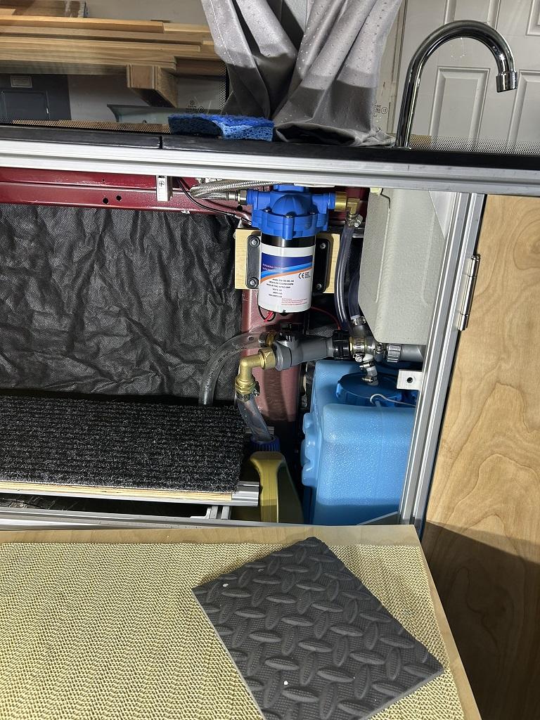

It's time for a plumbing upgrade. I stumbled across an overstock multi-diaphram pump which I decided to pick up at 1/3 the normal cost. I know the GPM and PSI rating on this pump is overkill for my situation, but I like how these kind of pumps have smoother water flow and are noticeably quieter. I did this upgrade on our teardrop and it was without a doubt worth it so I knew we would get the same improvements. My previous pump was a cheapy that I double wrapped in insulation and hung from rubber supports all in an effort to quiet it down. It was still amazingly loud. So, glad to have it replaced. If/when the time comes I can easily add an outside water hook up. And now I can empty my 7 gallons in just minutes.
Perhaps even more important is that I upgraded the piping and did a few other additions like adding a bulkhead fitting to my water tank to prevent water from sloshing out. All in all the entire system is more water tight.
Something I guess I knew but never dealt with before is access to various systems. The 8020 with removable panels made this work very easy. I've been contemplating adding some kind of side access in this same area. In the picture you can see the carpet covered shelf which I usually access from above via a hatch. Not sure what I will do yet but pulling the panel back out and modifying it should be pretty easy.

PostPosted: Sun Feb 18, 2024 8:04 pm    Post subject: Re: Evolution of my Eurovan Weekender Reply with quote
All buttoned up. I always look forward to this time of year, particularly living in the PNW when it can get a bit dark and rainy, for the release of my favorite beverage. In fact, my samba username is based on drinking a few of these and not sasquatch.

Tell us about this pump. I hate the noise of my Shurflo pump, and am looking for a quieter option at (almost) any cost.

I've been on the fence about this. I think because I always see them explained as a shower. I'm pretty sure I would never use this to take a shower unless it's about 100 degrees out. But your comment made me think some more and I definitely could see the advantage to having a fresh water sprayer. Maybe for a shower, but also just hosing things off, even rinsing dishes. Let us know if you install something in your conversion.
Well, a noisy or quiet pump like this is a relative term. I don't want to mislead anyone you can definitely hear this pump running. But, without doubt there are advantages to this design style beyond GPM and PSI.
I'm not familiar with the pump that comes in the EVC. Here is a generic no-name brand on amazon for about $20. This is the style I started with since I had it leftover from when I pulled it from the teardrop. This is the style that feels like every time I open the faucet the entire campground can hear (even when I'm dispersed camping)
Because I used to own a sailboat I was familiar with this option, which I used to replace my teardrop pump. It's kind of spendy but works very well.
https://a.co/d/5L276aV
So, when I saw a knock off brand for a little more that $20 I decided to go for it. The multiple diaphragms pulse less which makes the flow smoother and the operation of the pump smoother. That ultimately leads to a quieter pump relative to the cheaper option, but not a silent pump. I think the pump I got is 3 diaphragms and this shurflo looks like 4. Also, keep in mind these are larger and heavier so you want to make sure you have the space. And also notice the fittings. You can get a barb screw on adapter if needed, otherwise they are 1/2 inch straight threads.

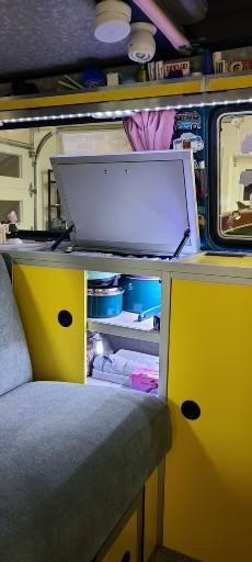

I enjoyed your write-up - Nice job on the 8020 build! I, too, went down the Ourkaravan rabbit hole a couple of years ago Smile We built our 8020 cabinets with sliding doors, a couple of top openings, and pull out shelves.
We continue to tweak our setup as well, although the tweaks are becoming more minor.

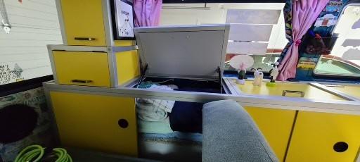

Picture from another view shows how we did go back in time to the older layout with the sink behind the passenger seat. We do not camp - we travel - and found that we never swiveled the front seats, so placing the sink behind the passenger seat has worked well for us. We used Ourkaravan's setup with the 5 gallon fresh water and 5 gallon grey water tanks, and the Shurflo pump.

I've seen VeeDubn's van and it is indeed a well thought out interior design. I'm also in Olympia. I'm using some 80/20 as well as Winnebago aluminum shelving to design our interior. The rear seat is the most vexing for me, as I want it to be comfortable and not interfere with other cabinet openings as much as possible. Tall order

Here's another one of those small but useful changes that I didn't know I needed until I lived in the van for a bit. During non-camping times having top access to storage on the sides worked just fine. However, when we are loaded up for camping we have bags that fit perfectly right on top of the access hatch. I even added special straps that hold the bags in place, right on top of the hatch.
So, another access was needed. Thanks to VeeDubn for pointing me in the right direction. I took the solid panels on the sides and with an addition from 8020, I turned them into sliding doors. Now I have storage access from above via the hatch or via sliding doors. I did the same update on the other side as well. Making changes never ends...
I particularly like I can easily reach my plumbing should a problem ever happen while on the road.
