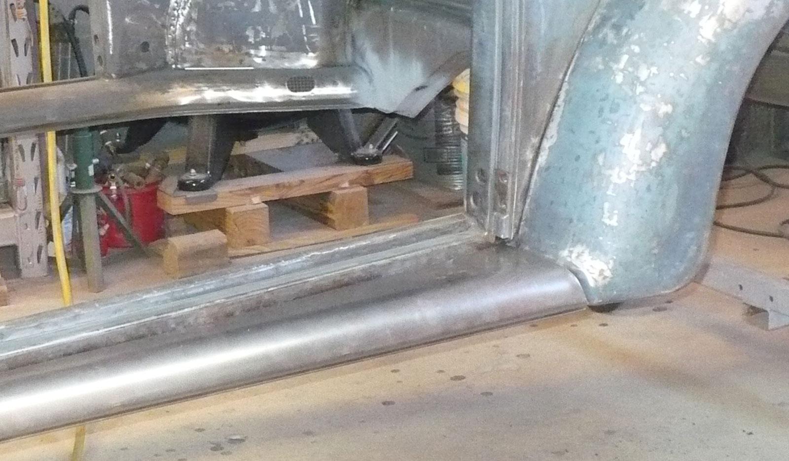

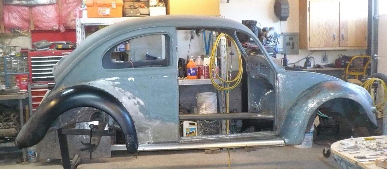

I got a set of correct running boards from Restoration Parts....Thanks Mika! These running boards are beautiful. I couldn't resist and had to bolt one up...that lead to quick bolt up of the front fender...
and then the rear... I had to draw the line at hanging the door. I'm looking at this and thinking "I could drive around in that..."
Plugging away at the tedious stuff...cleaning and prepping everything below the fender lines in hopes of getting everything below sealed up during the warmer weather.
I got one of those sandblaser things that work with a pressure washer and tried it out last fall before things froze up. Seems like it could do all the blasting that I need to get to where I want to be and without the dust. Its just about warm enough to break it out and see what I can do.
Going around and around the car panel by panel prepping, cleaning, finding things that still need attention. Still addressing rust in the wheel arches. This spot failed the sharpened punch test.
I'm wanting to mitigate all the rust that I can and then seal it all up and maybe get this body mated back to the pan before deep fall...

PostPosted: Fri May 31, 2024 7:09 pm    Post subject: Re: The 'Ol 55 Reply with quote
I would have to have bolted the running board up too Jim.
Looking so good, finish line in sight.
Keep it up.
Mark.

PostPosted: Fri May 31, 2024 9:29 pm    Post subject: Re: The 'Ol 55 Reply with quote
The addition of the running board makes it a Bug! Looking really good!
Jimbo
