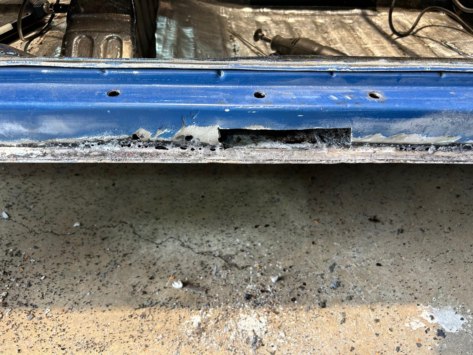

Welp. While I had the seats out to replace the upholstery on them, I was going to clean up the passenger side floor pan and put down the second roll of quickroof I'd bought. While I was in there, I thought I'd take out the headliner because I wanted to replace it. Of course, I didn't realize until after removing the headliner that you have to remove the windows to put the new one in. So I removed all the fixed glass, only to find some rust under the rear quarter windows. So I figured I'd have to do rust repair on those, at which point I'd have to paint those areas, and being as I want to paint the whole car anyway at some point, I figured now was a good time. So fast forward a week or so, I've completely stripped the car (except for powertrain, gas tank, and electrical harness). While removing the heater hoses coming up into the front quarters, I discovered some very nasty rusty bits on the driver heater channel. I soon started poking around with a pointy object, and, long story short, driver heater channel and both A-pillar bottoms need to be replaced. So this year's VW budget just increased by about 400%. I've ordered the Dansk heater channels and Autocraft A-pillars from CIP1, and the "deluxe" floor pans from JBugs.
I'm doing both heater channels, because while the driver's NEEDS to be replaced, the passenger side isn't exactly a spring chicken, and is also rusted through in a few small locations.
I'm determined to do all of this with the body on, powertrain in. While I have a lift, the chassis should offer some support to keep the body in shape while I cut out the heater channels, though I'll be welding in a few stiffeners in the door frames to keep everything nice and rigid.
Job #1 is removing as much of the existing undercoating as I can, in order to access the spot welds along the heater channels in the front wheel wells. Somebody really slathered that stuff on. I'll then sandblast the areas to remove relevant paint, drill spot welds, so on and so forth.

PostPosted: Thu Jun 05, 2025 8:41 pm    Post subject: Re: 1977 Fuel Injected Standard Project Page Reply with quote
Oh shit!, project creep at it's worst! Surprised
Rip the bandaid off now and you won't have anything to worry about again.
