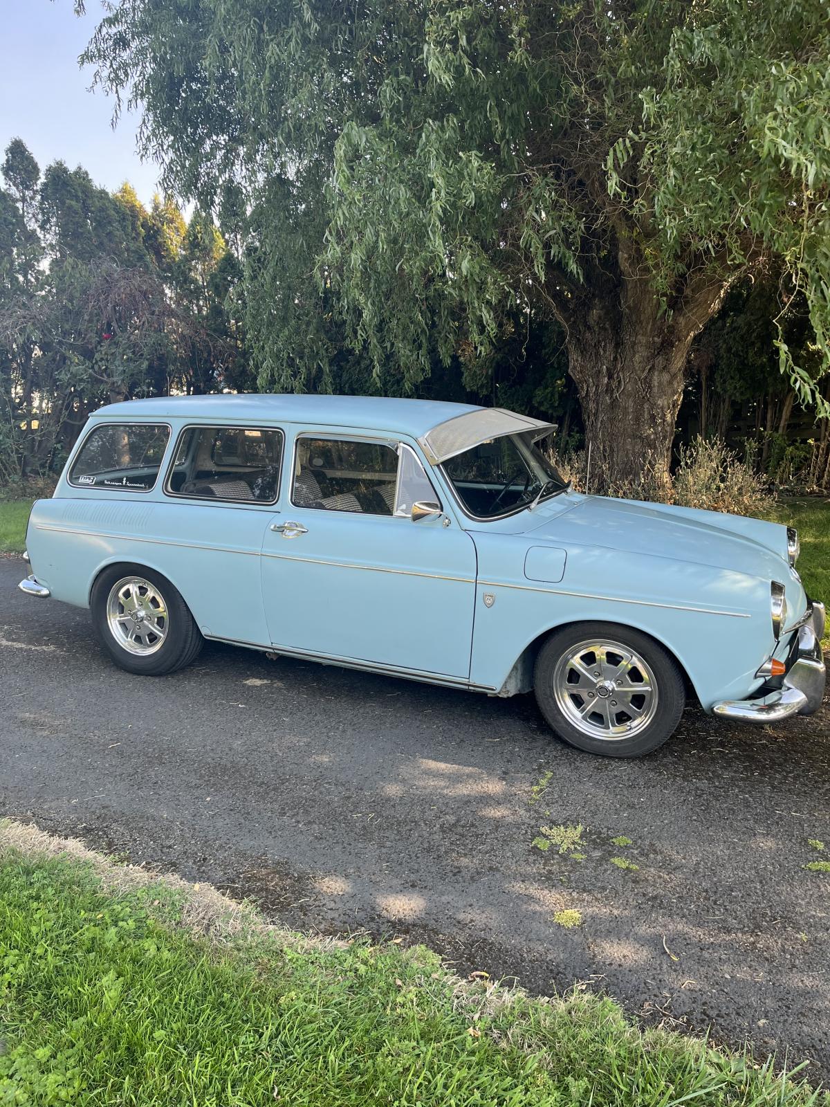

I have 185x60 & 205x70 on 5.5"x15" 730P www.Mobelwagen.com wheels.
69 FI/AT square Daily Driver
