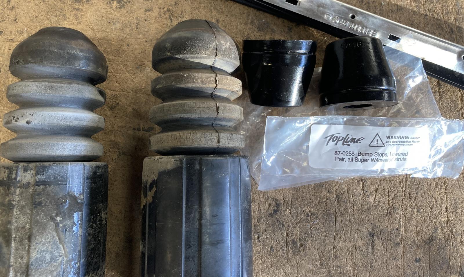

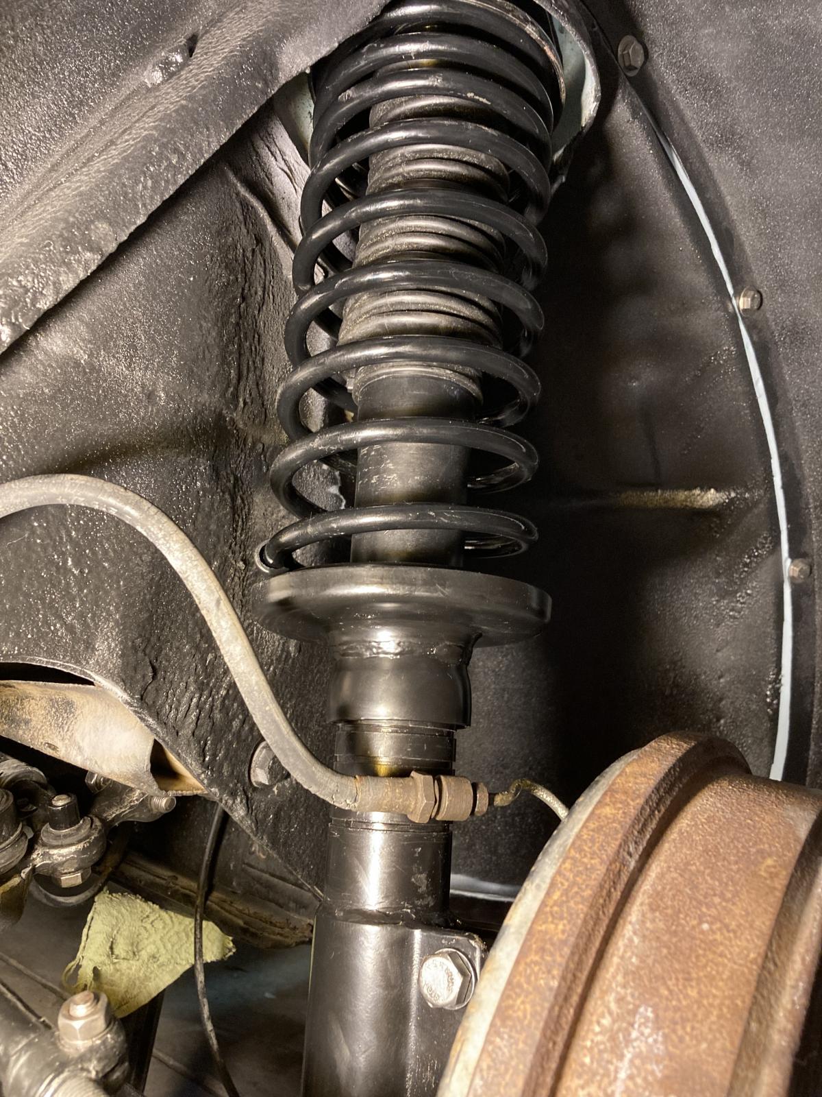

Empi Adjustable Lowering Strut housing -> bump stop and bellow?
Finally getting to the point of reassembling/installing the Empi lowered struts, using stock spring, on a 74 Super.
The Jbugs video (props to Sam/team for quality help!) references not using the OEM bump stop and strut protecting bellow/cover.
Has anyone found an acceptable aftermarket solution?
Doesn't make sense to not have either installed.

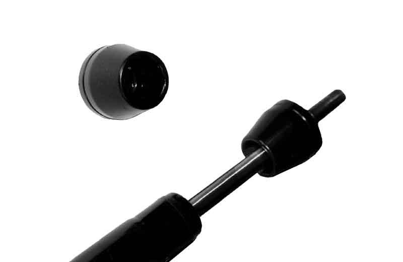

TopLine offers Bump Stops for all Lowered Super Beetle, pair. Black Urethane. Use on any lowing strut…….#87-0258.
That is half the solution but feel that maybe there is a bellow/boot combo that is also available? Like...

I just installed those bump stops from Topline in my '73 Super. Jon told me to use a pair for each strut but that cause the front to ride too high and bounce. I went back and left it at one per strut, much better.

TWO on one side? Seems strange, especially since they don't look like they would sit nicely/mesh together (vs using 1/2 spacers that Top Line sells)
I noticed you still have that strut cover installed. Does that cover attach to those new Top Line bump stops? Does it interfere with anything?

Here's his email reply to me when I asked:
Fat ends against each other.
J
> On Apr 12, 2023, at 6:34 AM, myeamail.com <[email protected]> wrote:
> Jon - are these installed with the fat ends up against each other? Or with both cones pointing up?
I kept the cover on top of the new rubber stop. It doesn't cause any interference that I could detect and the ride is fine. The cut original style these replaced lasted for about 27-28k miles. Time will tell how long these last!

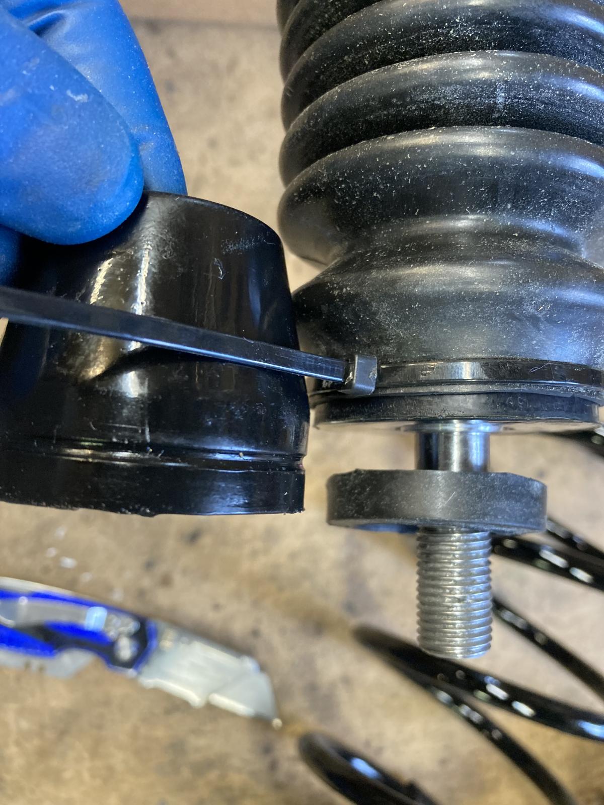

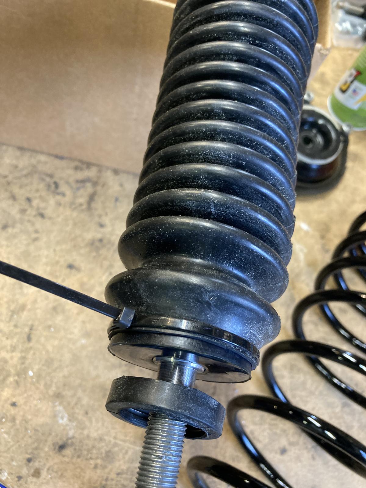

Photo updates with Top Line bump stops, shock/strut covers, and shock isolators (cheap on Amazon).
Side by side of the shorter bump stop. Very good quality (as usual with Top Line)

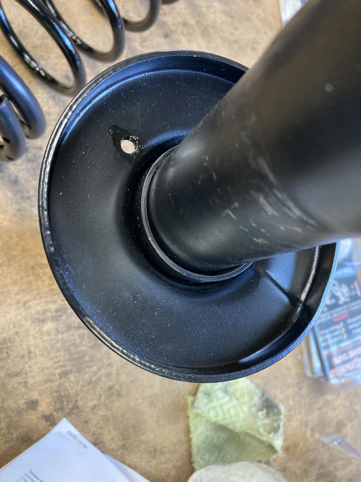

Instead of purchasing those expensive strut isolaotors that fit in the bottom of the strut holder (VWC-113-411-211-PR) I just bought those basic/standard isolators on Amazon. Cheap and seem to work good. The fit in the bottom mount plate just fine. Also those are the original springs....they were prepped and sprayed with Rustoleum Caliper paint..lots of research indicated this paint could work on springs...I guess we will see!)
Drilled one small drain hole in the base mount so water can drain.
Decent quality boots/covers purchased on ebay. (Aftermarket Black Shock Absorber Boot Cover 2 Pack JSP Brand Replaces ROU-87159) Not sure how they will perform but I feel they will protect the strut shaft and the final product looks more finished.
Had to trim the top of the boot and zip tie the cover on. Only driving around will confirm if this approach works but it seems like a good fit.
Also..those 2 bolts that hold the strut to the spindle...29 ft lbs (approximate 39 NM) I swear I was going to strip them or break something...it took forever to get to that torque.

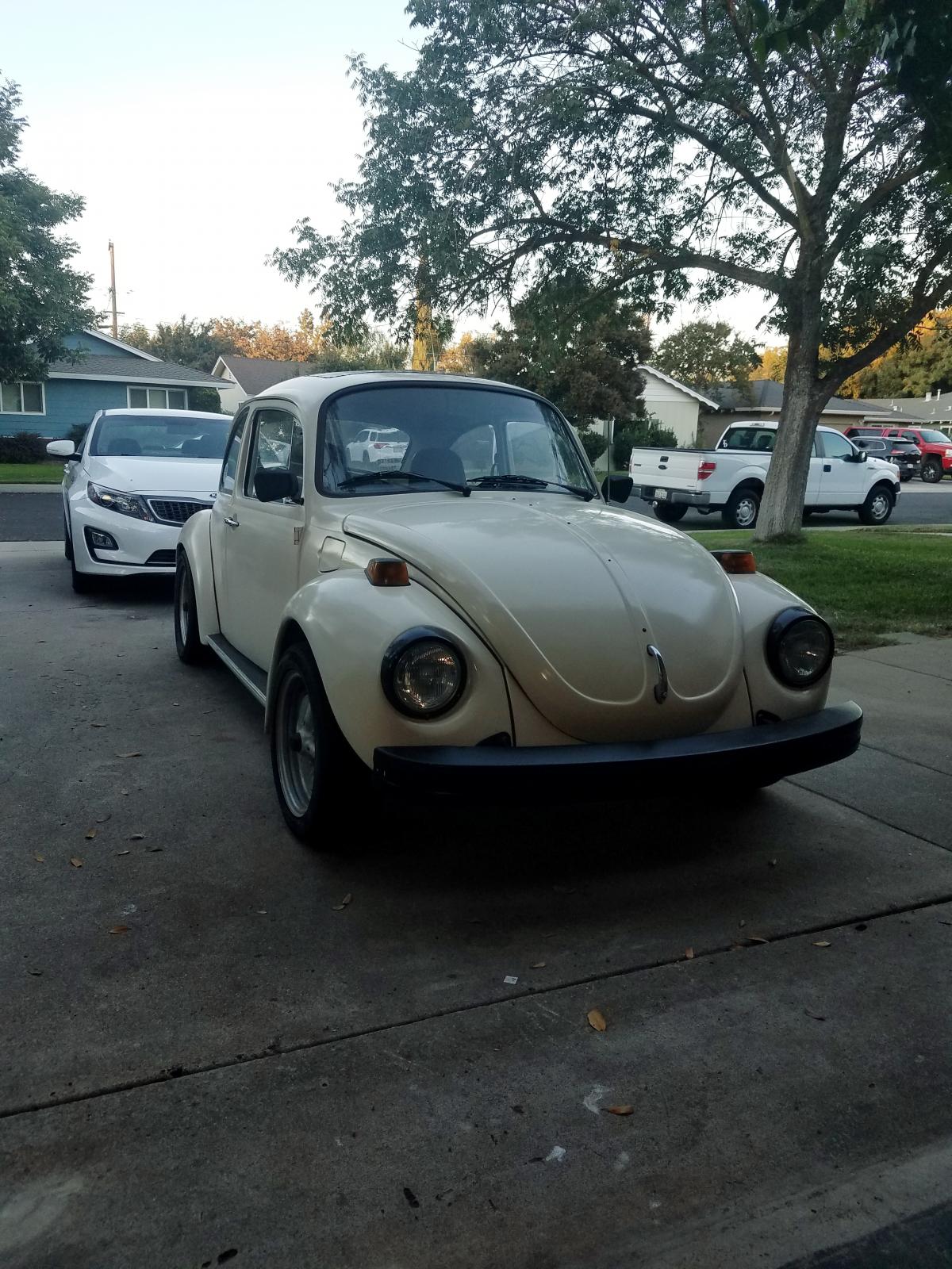

Lowering my '74 Super Bug...
Before and After
1974 Super Beetle
