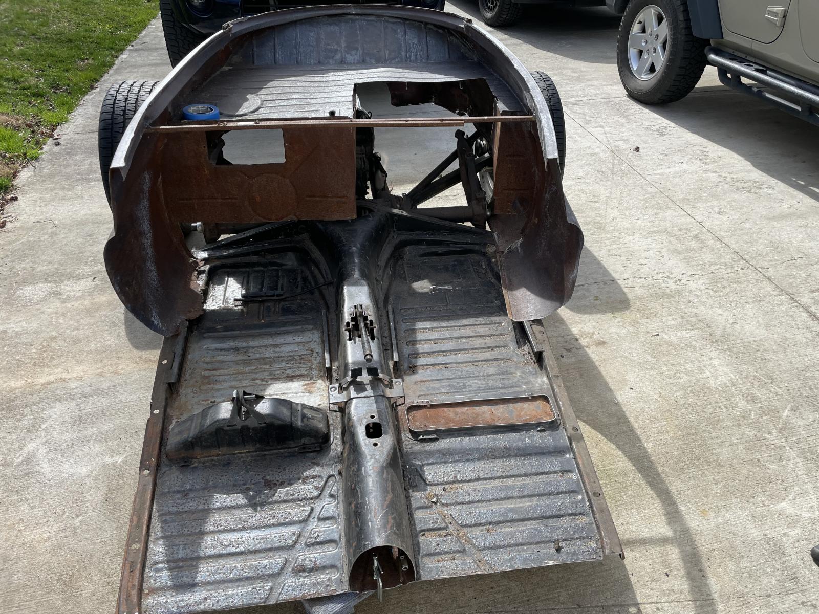

External Handbrake would be fun... Did more work to see how I will fit in the car. Bought a Wilwood reverse swing pedal assembly for the clutch and brake with some compact cylinders - seems good to fit the cylinders rearward away from the suspension and the gauge cluster will mount right above them.
Cut a notch out of the body at the package tray and the removed most of the old seat mount on the floorpan so I could sit in the space and see how it feels.
The site lines are good with at seat back angle leaned back to 55 deg from horizontal and the top of my head is about 1" above the top of the windsheild which should be fine). But, it is not a very comfortable seating position...
Could use more legroom. 3 more inches would be ideal. Right now, the seat bottom is as far back as possible at the rear of the floorpan. I could cut the rear of the floorpan out and gain a few inches by moving the seat bottom back to the axle tube. That will be a bit of work. The easier thing would be to lengthen the wheelbase. Here is the side view at the 84.5" wheelbase that I prefer the look of.
And here is +2" - 86.5" wheelbase.
And here is +3" - 87.5" wheelbase.
Will contemplate the wheelbase while I work on other things. Will either stick with the short wheelbase or go with the +2" wheelbase and tweak the rear floorpan as necessary...

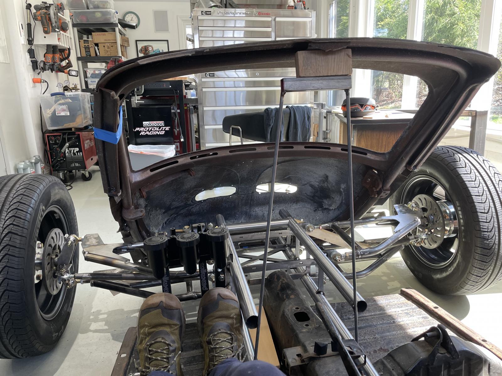

PostPosted: Sun May 12, 2024 5:15 pm    Post subject: Re: Isetta EV Hot Rod Build Reply with quote
Here is a pic of the seat mock up. It is leaned back to keep my head height low and shifted back as far as possible for the most (but not enough) legroom - you can see how the seat back is notched to clear the back edge of the floor pan.

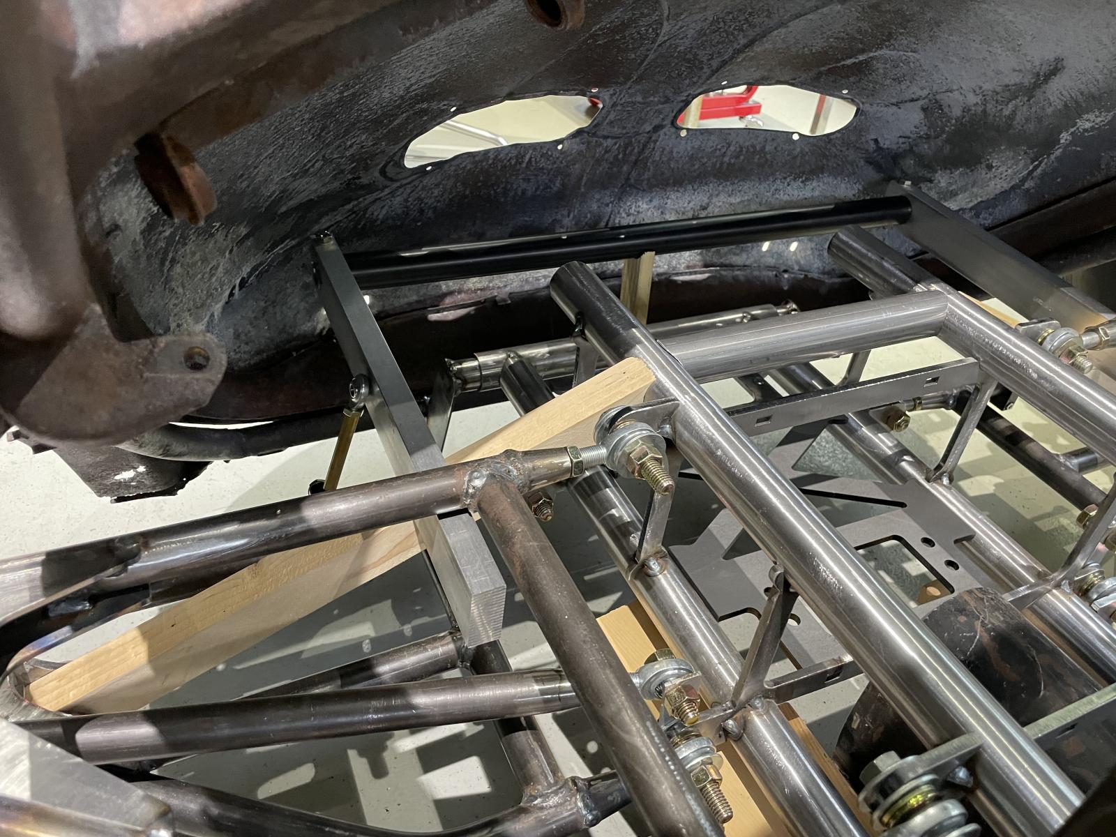

After looking at things for a while, it dawned on me that the best solution is to move the upper a-arm mounting points forward. I can gain up to 5" that way so I can move the seat forward a few inches and gain a few inches of legroom. I also looked at different front anti roll bar designs and sizes and calculated the wheel rates for each option. The best option came from a circle track company called Hyper Racing. Went with a 26" long splined bar which is short enough to fit forward into the curved part of the front door. I want the links to mount to the lower a-arms at 28" (or more) apart to get a better motion ratio, so I bought some blank arms with just the splined hole, so I can bend them and cut them down to the right length and drill holes for the links. Hyper Racking were very helpful in helping me select the right torsion bar, I went with Schroeder .825" hollow bar with 7/8" splines which should be plenty stiff. Here are a few pics of where the bar will be located and how it fits inside the door...
I bought the parts to further modify the upper a-arms and will start on that soon. You can see from this pic from above how I can move one or both of the upper a-arm mounts forward, just have to keep clear of where the coil over will be mounted down to the lower control arm (they will mount be further outboard and be angled up quite a bit compared to the wood blocks holding the suspension at ride height.

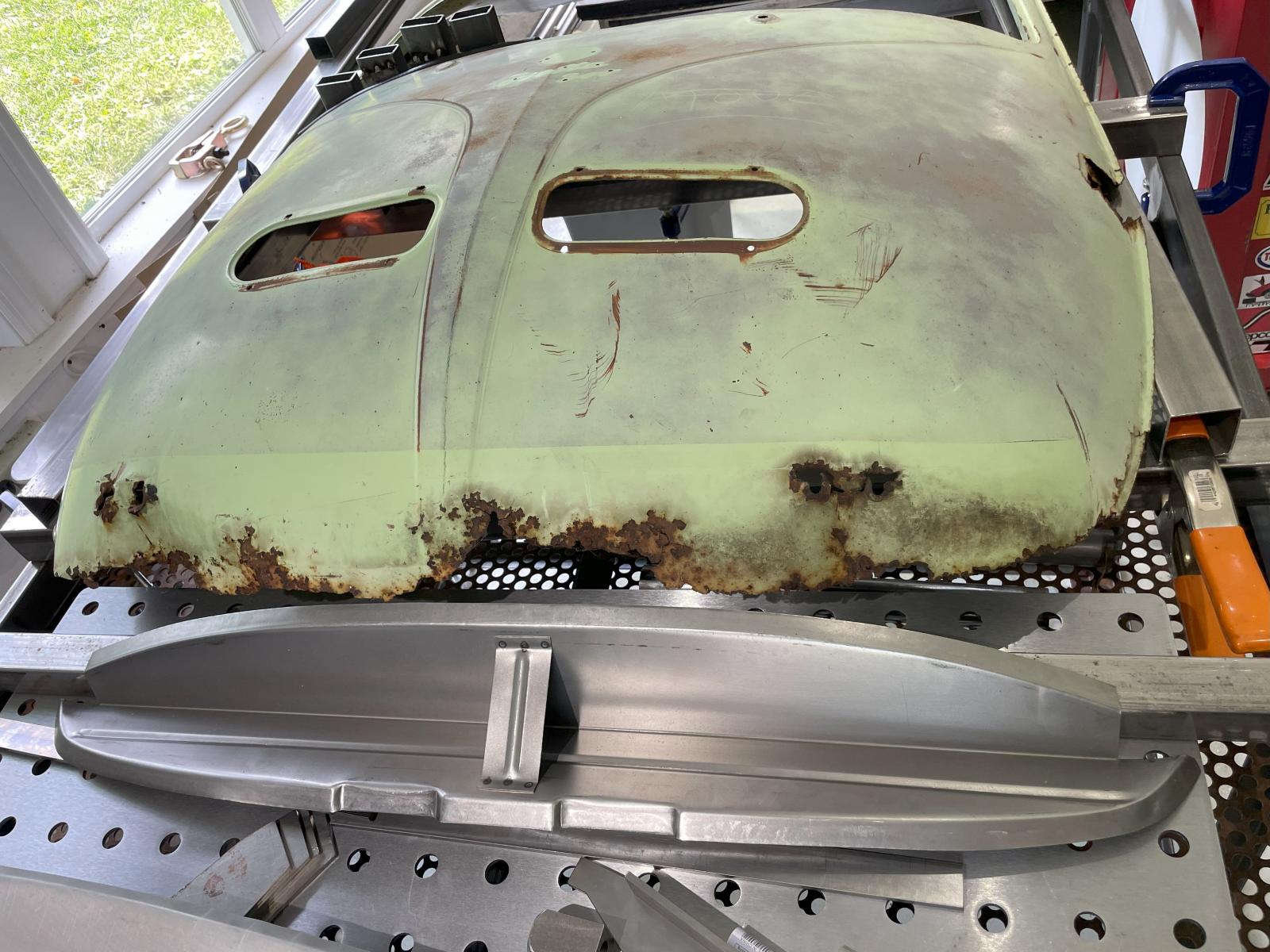

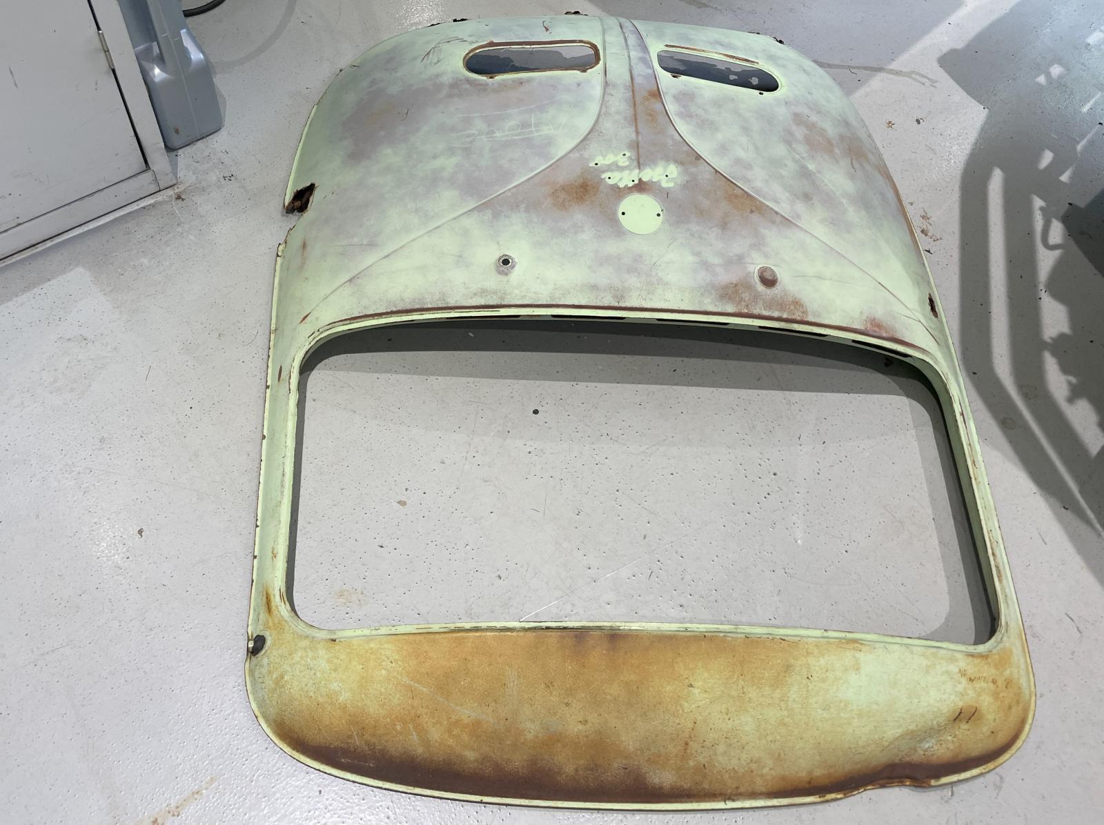

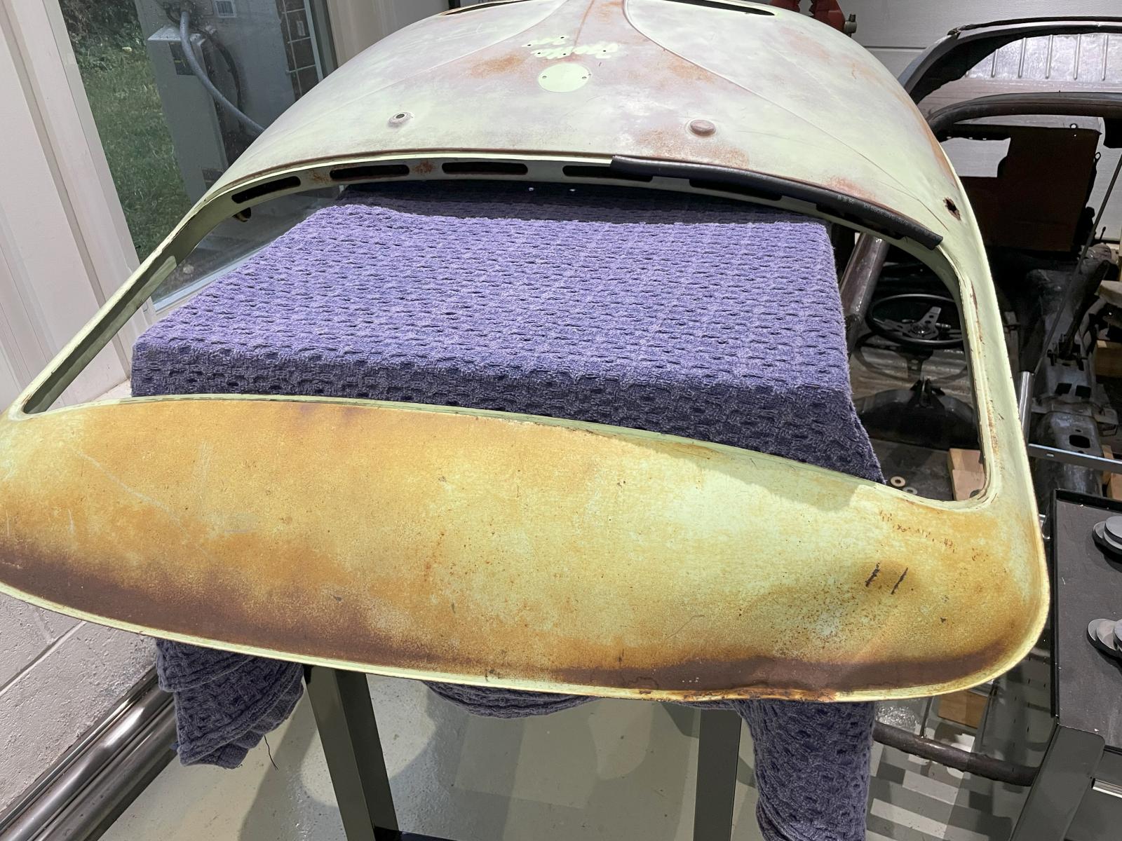

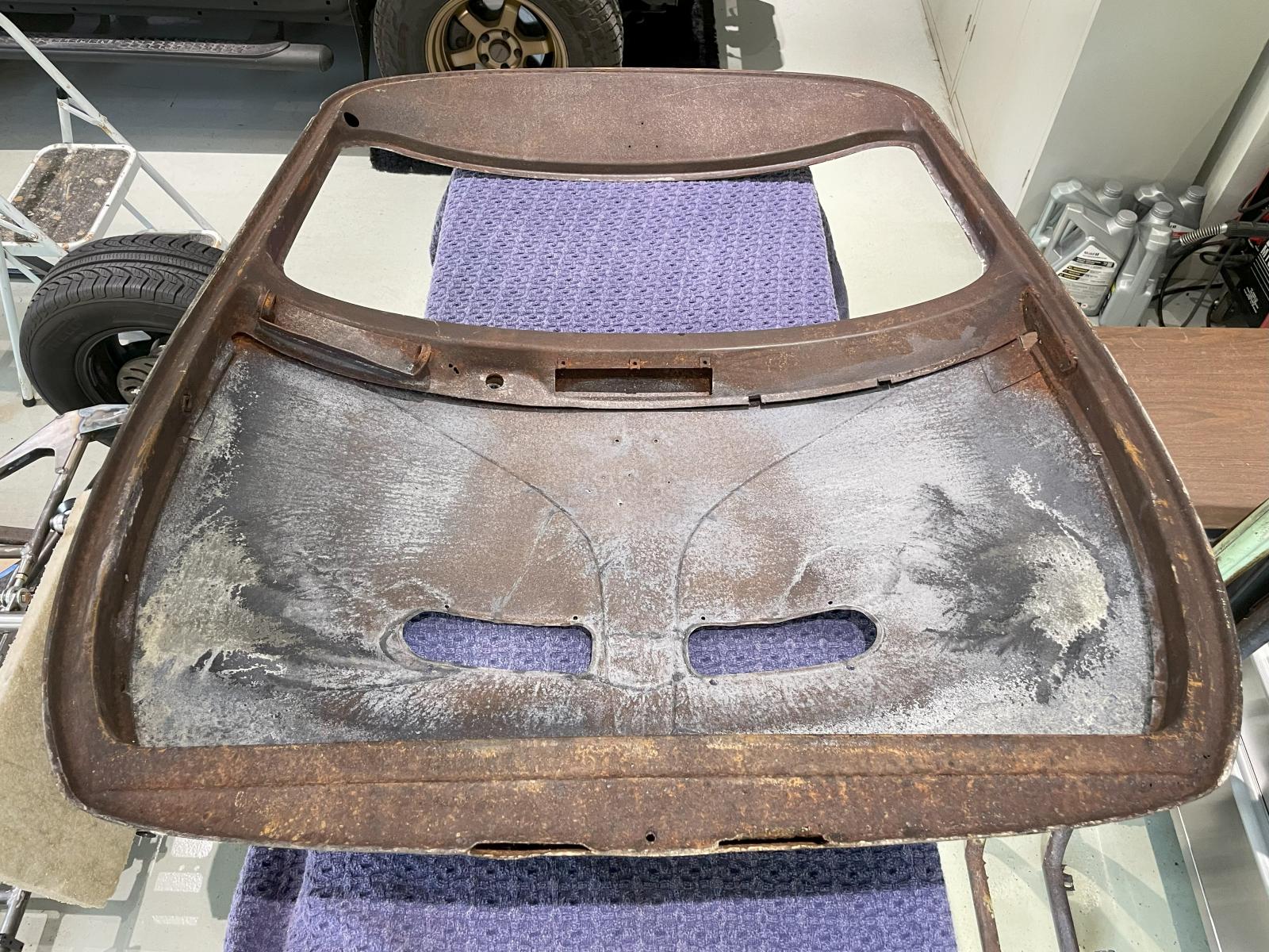

I started to work on the front door. I actually have two doors, so the first order of business is to decide which door to use. The green one or the rusty one. The green door is in rough shape. A tree fell on it which dented the top and ripped the lower hinge completely out of the door. And the bottom is rusted out - and the lower inner structure is completely gone...
The rust colored door is perfect structurally, but is a bit warped and dented across the lower third of the outer sheet metal.
I decided to try to fix the green door for no other reason than I like the patina and am going to try to keep the the car with as much of the original color as possible. I even have the original badges for the door, so it is going to look cool...

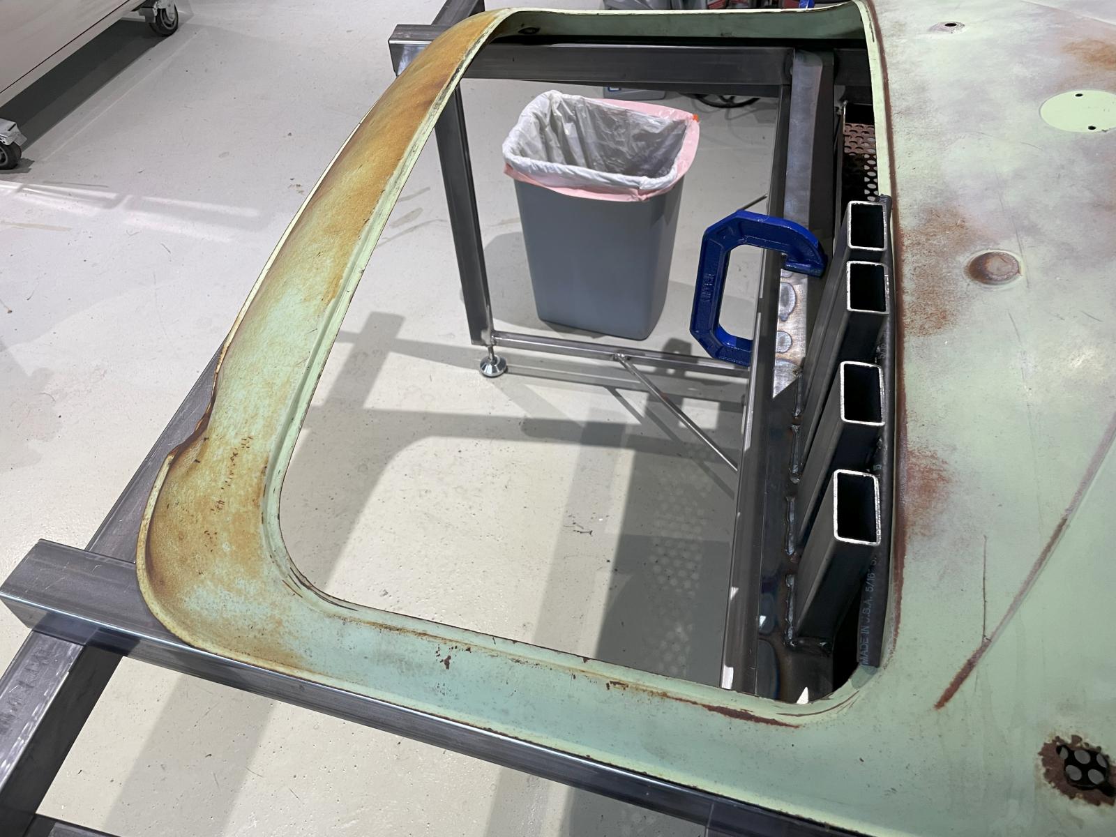

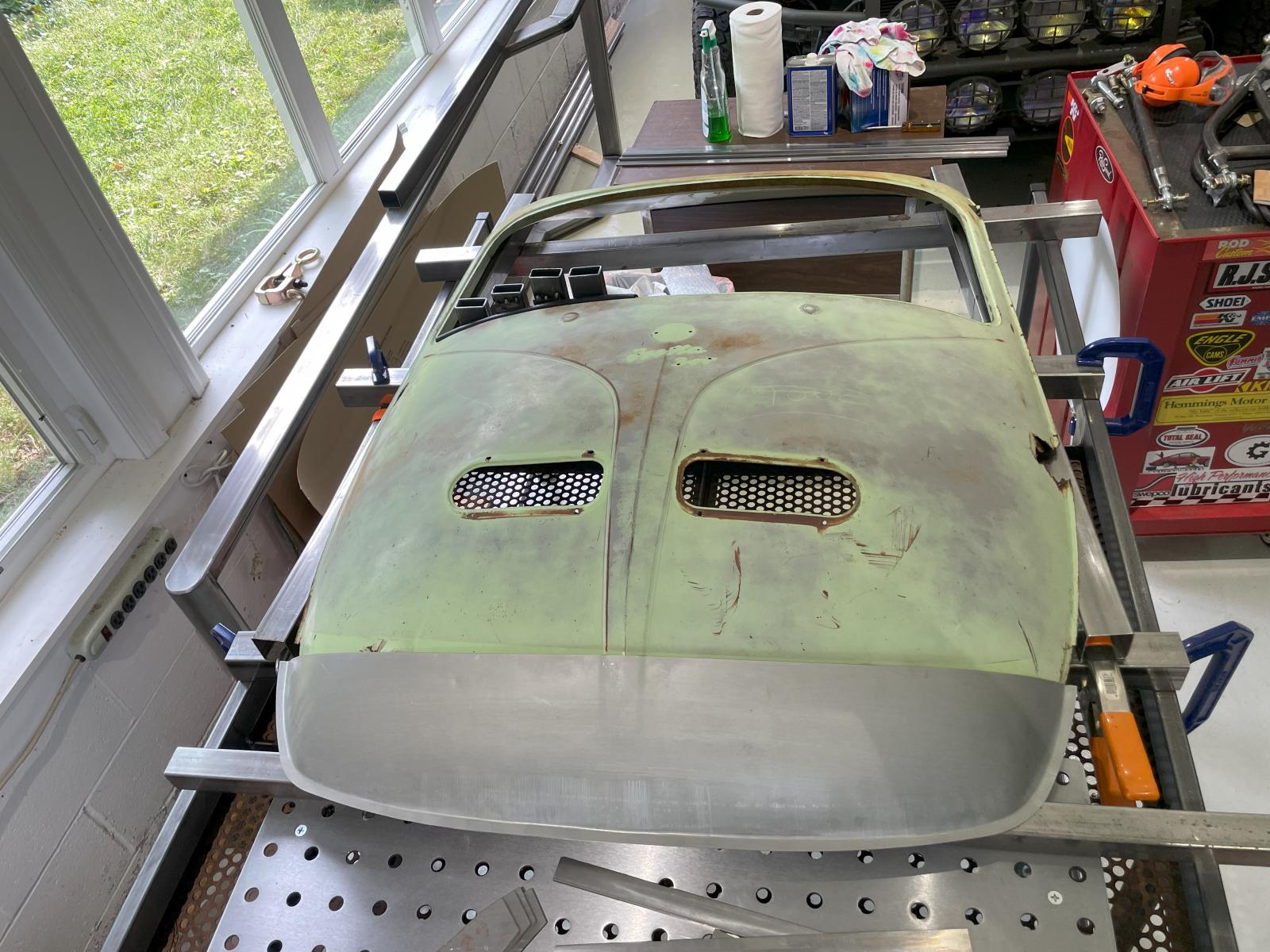

First thing I did was to build a frame so I can pull and pry out the dent in the top of the door - the frame will push against the lower part of the window opening when I pry up on the dent.

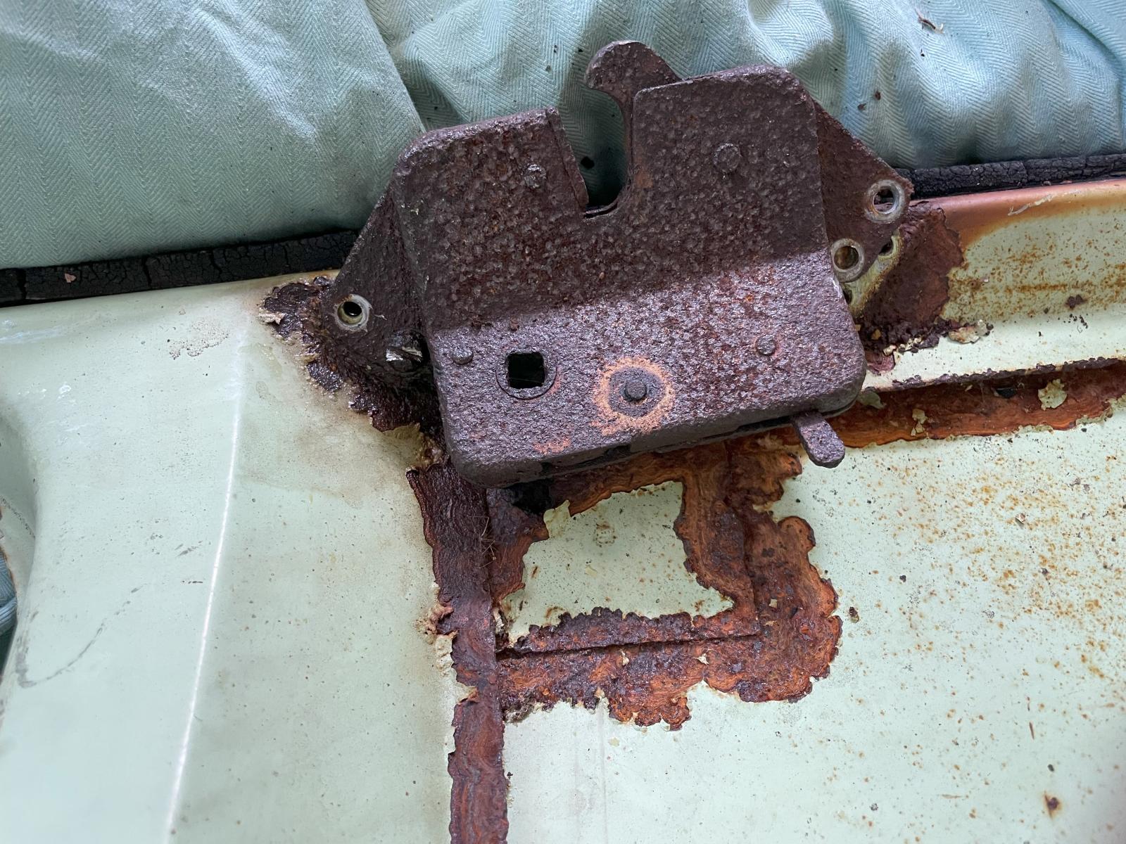

My mechanic told me about using an induction heater to remove rusted bolts. I bought a cheap one from amazon and it did an great job loosening things. It took some heat, PB Blaster and time, but I was able to remove the 4 screws holding the frozen shut door latch.
I found a cool company in Germany https://www.oldtimerteile.net/ that had both new and used parts for the door including the latch and handles and inner and outer patch panels for the lower door. They even shipped a used windshield to me.
So, lots of work to do to get the door fixed up and mounted. The plan is to have it hinge open, so I will have to rebuild the lower hinge area. I am going to have to use the rusty door frame because the green door frame is really bent up.

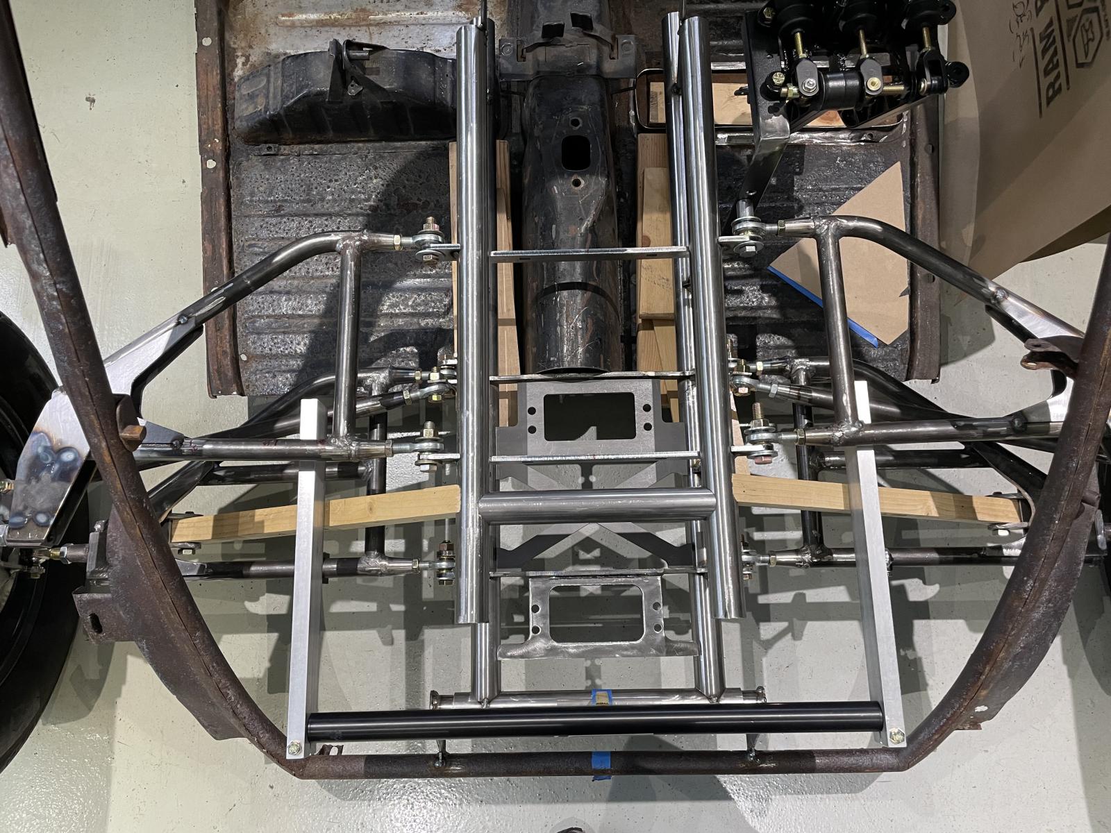

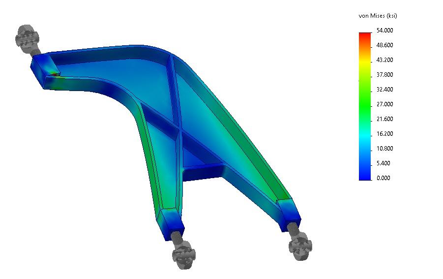

The new upper a-arms are getting made from boxed steel plate instead of the 1" DOM tubing in the original arms. I also narrowed up the inner mounting points - they are 7.5" apart instead of the original 10" spread. In combination with relocating the upper pivot points on the subframe, it will give me around 4" more length for my legs and feet. Here is what the arms will look like.
Because the arms curve around the door frame and the inner points are more narrow, there will be a lot more stress on the arms. I had my friend who helped with the CAD design run finite element stress analysis too. We did the loading cases for cornering, braking and hitting a curb. That helped to refine the design and come up with the materials. We are using .135" thick cold rolled steel for the top and bottom plates and 3/16" cold rolled steel bar for the sides and the inner X bracing. They will be plenty strong and they are going to weigh around 12 lbs each.

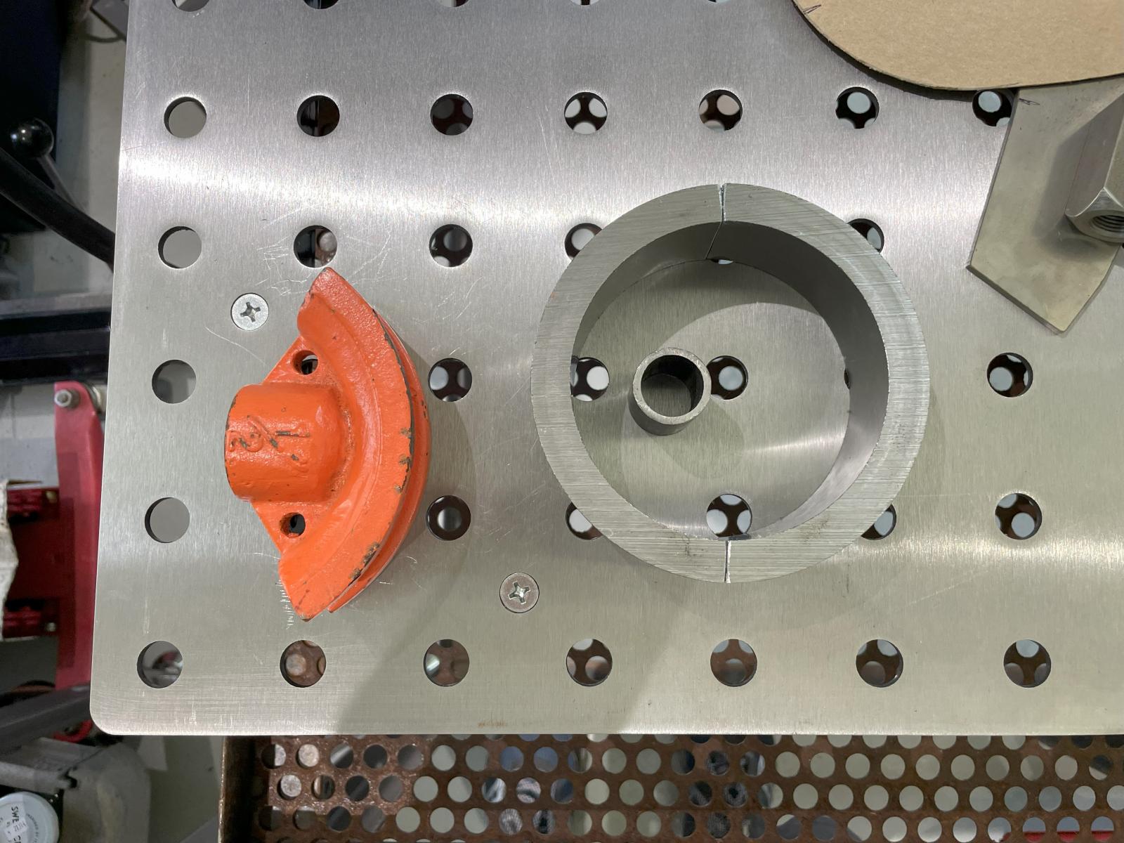

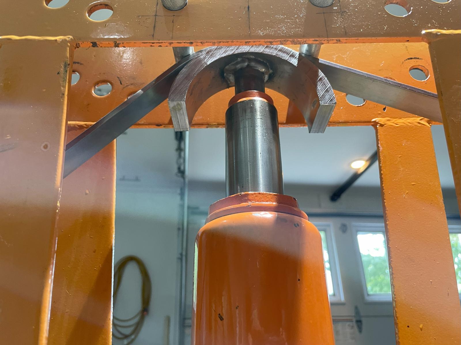

I have to bend curves into the 3/16" bar to match the curves in the top and bottom plates. That material is not easy to bend by hand - at least not consistently. Luckily, I have an old harbor freight tubing bender that could be modified to help. I had to drill some new holes to put the pins closer together.
Then made a new die out of some 5" OD round tubing.
It worked really well...
Going to weld them up soon - just getting set up with a new welder. I will also have to rebuild the subframe with new plates to relocate the upper a-arm mounts. In retrospect, this is a ton of extra work to gain the 4" of legroom. But, I am doing this because I enjoy building stuff and it was cool figuring all of this out...

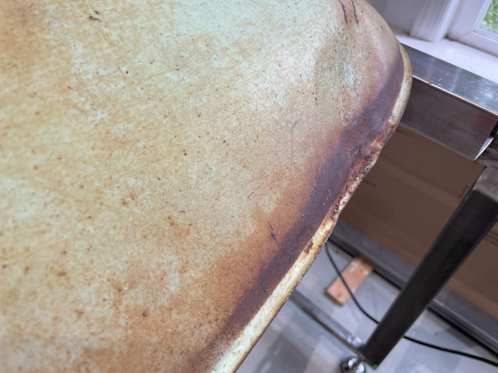

I also used the frame that I built in the last post to hold the door's window frame to pry the seam at the top of the door back into shape.
I bought the smallest auto body pull clamp that I could find on Amazon and pried through the eye hook against a block of wood. The heat gun helped to soften the metal and the seam moved pretty easily...
A local paintless repair guy is going to try to push the rest of the dent up so I can keep the patina on most of the door and only repaint the lower parts where I have to weld in new metal.
