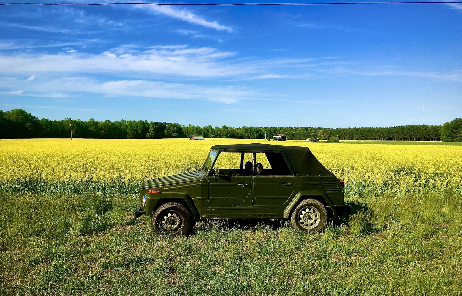

PostPosted: Thu Jun 27, 2024 5:52 pm    Post subject: Re: Easy lift for 1974 Thing? Reply with quote
Well, for low effort here's about how much you can get from air shocks on completely stock suspension. Counter intuitively it rides softer when lifted.
Monroe MA803 rear, Monroe MA810 front, 205/75-15 tires.
Before:
After:

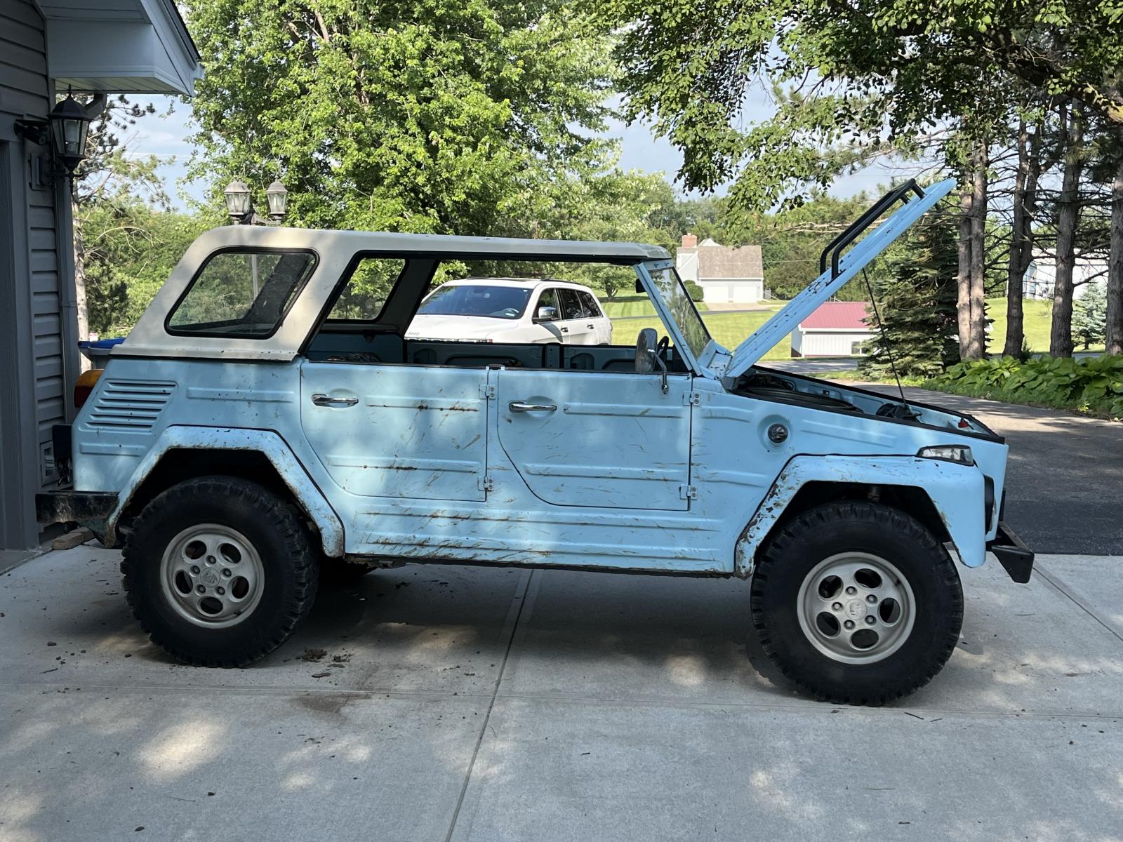

PostPosted: Mon Jul 01, 2024 2:22 pm    Post subject: Re: Easy lift for 1974 Thing? Reply with quote
Like this?

PostPosted: Thu Oct 10, 2024 9:13 am    Post subject: Re: Easy lift for 1974 Thing? Reply with quote
Heiferman wrote:
joosty_chin wrote:
Like this?
What did you use to achieve your lift?
I built a baja prerunner Beetle years ago and used notched torsion arms and bus CVs in the back.
Up front I used an adjustable beam AND raised spindles. I regretted the raised spindles. They were poorly made but this was in 1987. Maybe they are better now.
An old buddy saw that prerunner in the background of a FBM ad for another Bug last year. I can't believe it is still around.
Stock raised spindles for the front. 3x3 trailing arms and AtomWorks static spring plate adjusters for the rear.
