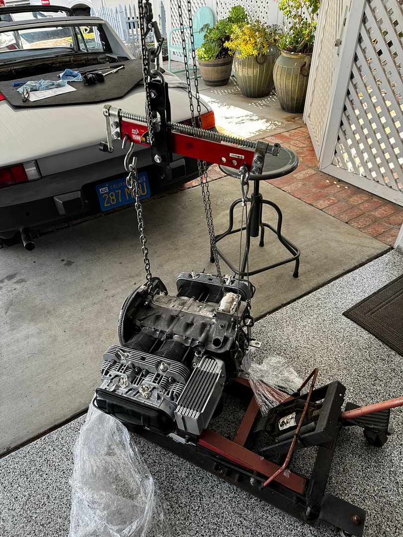

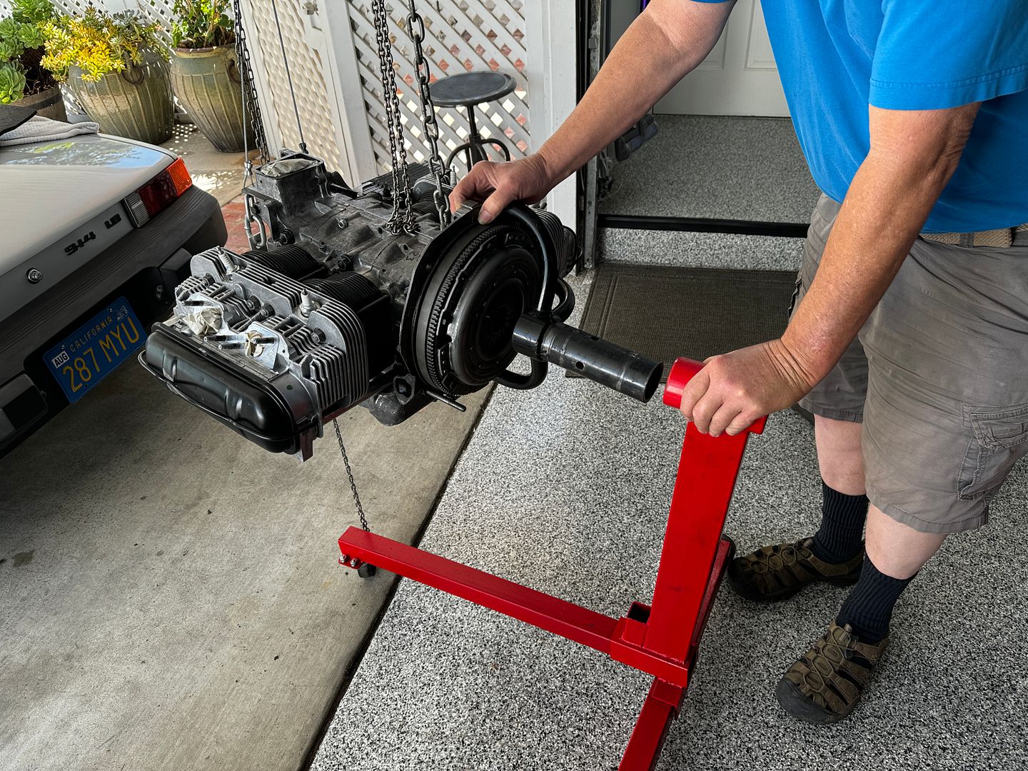

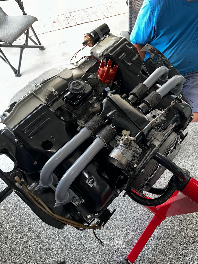

I purchased the 'Vevor' engine stand from Amazon. I got the 1300 lbs version, not because of its carrying capacity, but rather because this one specifically has the 'U-shaped' footprint, which allows me to put something directly underneath to catch oil/dirt etc.
This stand, however, doesn't fit well onto the VW engine as is. So I 3D printed some spacer tabs that fit perfectly onto the case, and over the protruding lip as well. (I printed these with basic PLA, but with 100% infill). (Yes, I can already feel many people on this forum's eyes rolling, but seriously under compression these parts are more than strong enough).
The next problem was that the holes in the black arms are much bigger than M10 bolts, so I 3D printed some sleeves to fill this space. (also in basic PLA with 100% infill).
The final piece was that with the original hole locations, the mounting arms were spread too far out, so I drilled a second set of holes more 'inward' on the mounting arms.
I purchased two M10x120mm bolts for the two upper holes, and use the existing M10 studs for the two lower holes, and mounted the engine. Everything is very sturdy.
Here are the pics...

How are you gonna split the case with all 4 bolts being used?

Yep, that is the shortcoming of my setup. Fortunately, I don't intending to split the case at the moment (I am just addressing the exterior of the engine), however, I will keep my eyes open for the proper T4 engine cradle in the future...

Take two of the bolts off and split the case. It's not like it's too heavy with the case and internals in it. If it is, then I guess I've been lucky.

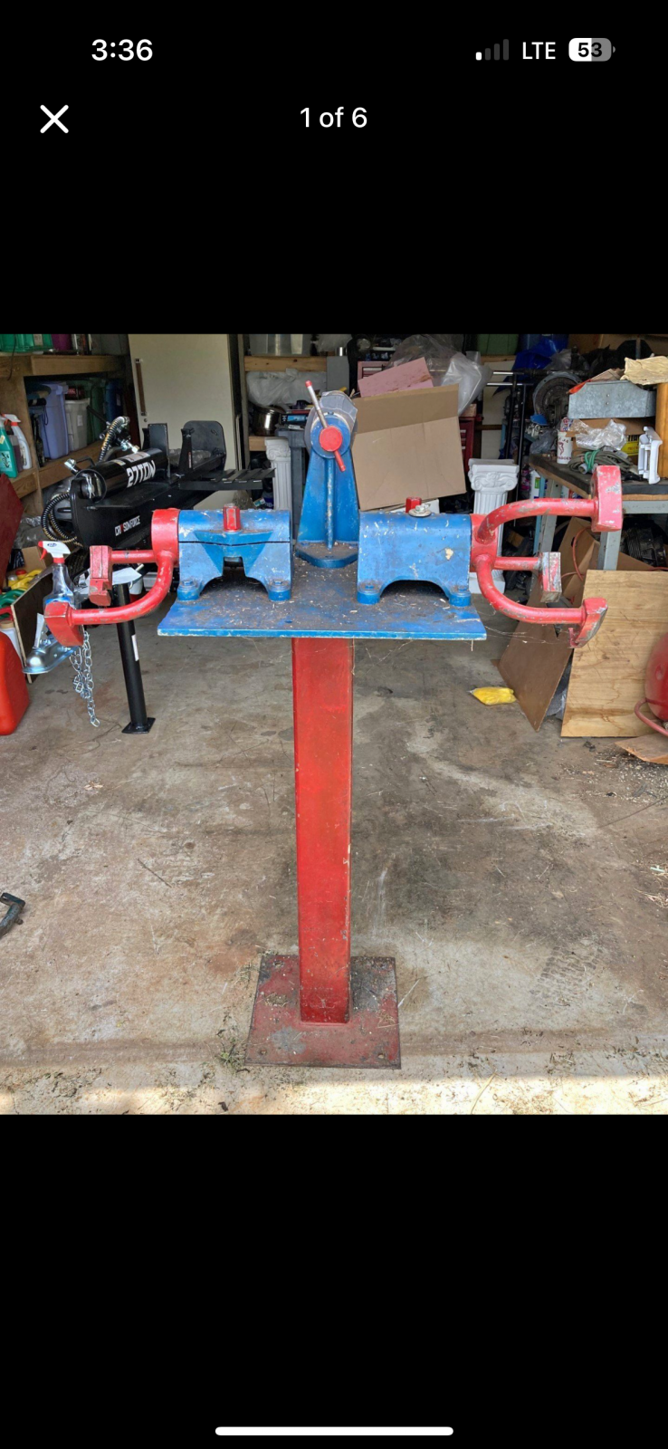

This is my old floor mount dealership stand. This is the best picture I can find of it. I've had it since 1990. if you can find something like this go for it. But look for just the head and yoke and you can mount it to whatever your fabrication skills allow. Avoid the cheaper small tube "bench top" style that still seem to be around. those just offer disappointment. You want something stout you can roll around at the very least.

Most all VW engine adapters just use two bolts to attach the engine to the adapter, built heavy enough a two arm stand is going to be just as good as a 4 armed stand. A three armed stand might give the best strength to weight ratio though..

With such little material, on the yoke, it can break the ears off the case.
