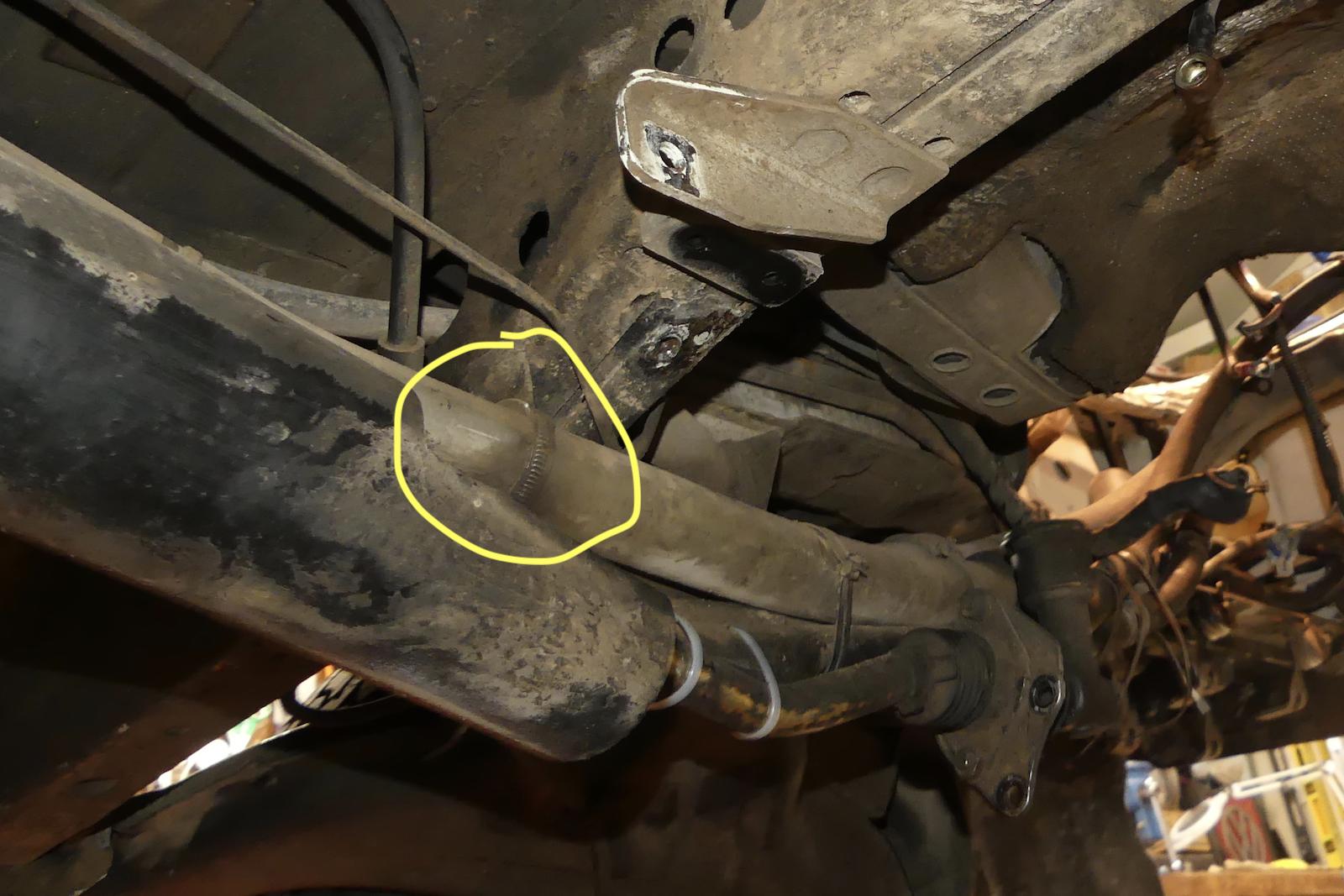

These are the best pics I have of the two clamps that hold the main coolant pipes to the body:
Up front it's a stiff wire that hooks into holes in the structure.
And in back it's a screw band clamp around a cradle type mount on the frame.
My new pipes are aluminum so I painted them and used a rubber sleeve to protect, but here's another view of the rear clamp.
P.S. I would get rid of those cheap worm clamps and replace with stock constant pressure spring clamps for your hose/pipe connections.

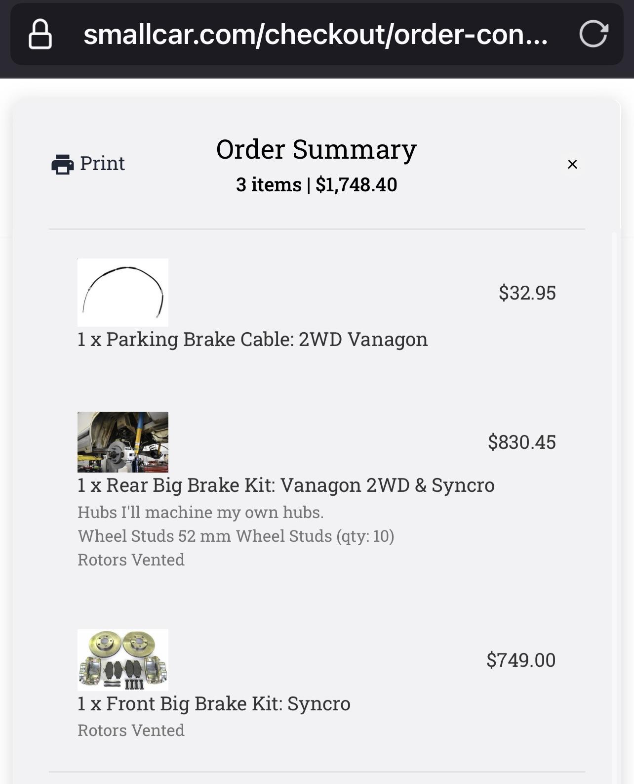

Ordered the front big brake kit and rear disc conversion from small car performance today.
I didn’t get the Wilwood kit as much as I wanted to, it would’ve been about double the cost which I’d rather buy the engine mount kit and an engine swap and get that going even tho wildwood’s would feel quite nice I’m sure. Found a set of Mercedes CLK wheels I’m hoping to pick up this week as these brakes require 16’s. Also found a 1.8t so I’m hopefully making that trip to pick that up soon.

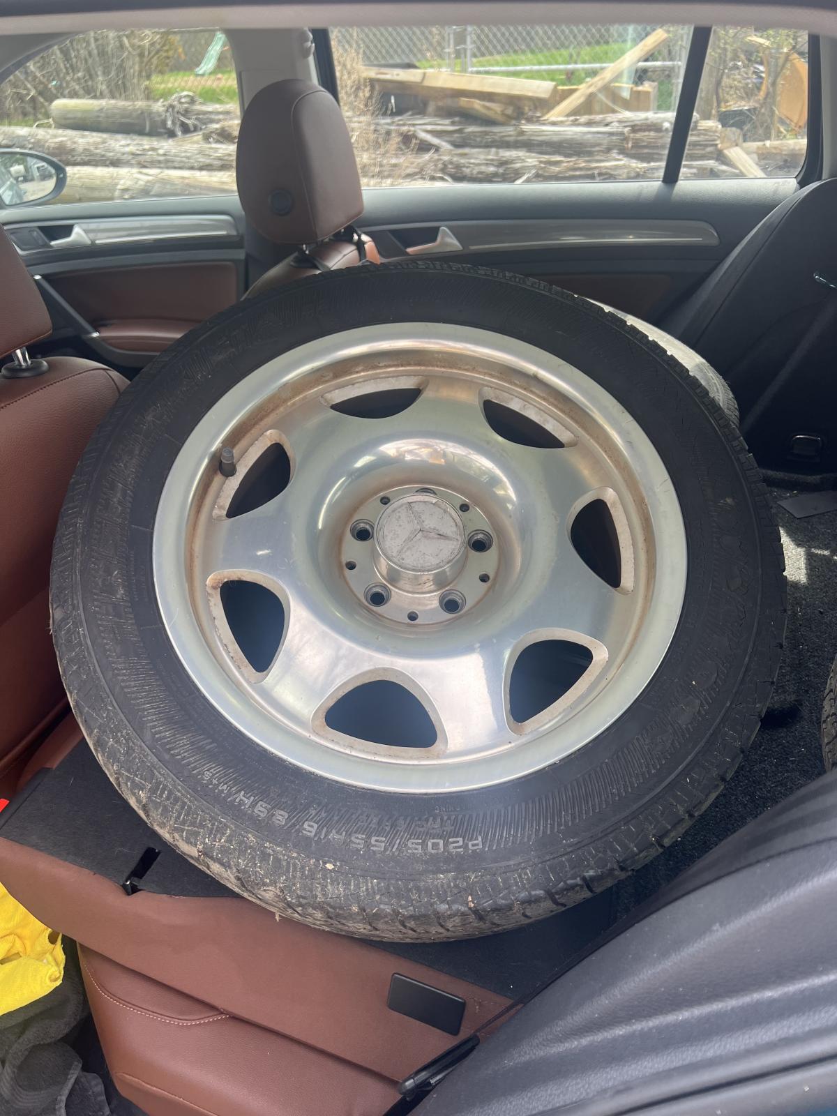

Drove up to Massachusetts and grabbed this set of 4 Mercedes wheels, ordered a 5th off eBay when I got home. Ordered center caps and lug nuts from t3. Gonna have them powder coated bronze and then throw some 215/65/16 fallen wild peaks on them.

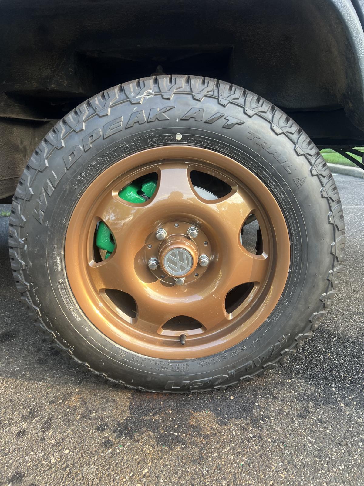

Picked up and installed the wheels after work. I like them, I think they’ll look even better after I have the van painted green. The ride was much smoother and quieter too.
Now that I finally have the 16’s on I can do the front big brake kit and that will much improve the braking/drivability of the van. Rear disc conversion after that and then I’ll do all the suspension work. Found my springs were a lot rustier than I thought so I’m going to just order a new set to be safe to install with the new bilstein b6 suspension.

Those wheels look fantastic! Cool
And I've got the same tires and have been very happy with them.

That wheel color and wheels look awesome!

Thanks! I’m really happy with how they turned out, I haven’t driven on them much but the quick ride I took they were super quiet and smooth, van felt different in a good way!

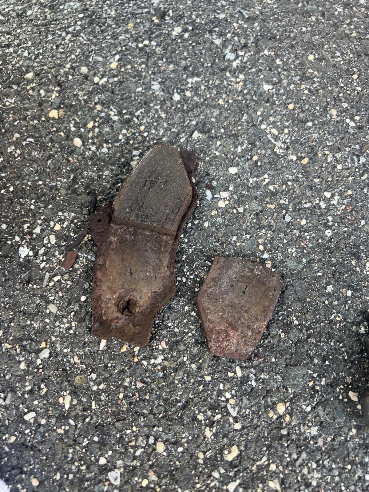

Finally had a day off where the weather cooperated. Pulled front brakes off to inspect, passenger side was metal on metal which I suspected from
The grinding that started just after buying the van. And the drivers side the pads just crumbled. I think this van was sitting a bit longer than I was told, which is whatever at this point just gotta roll with the rust, I mean punches. After pulling it apart I saw my disc shields crumbled so I ordered 2 new ones from small car performance. I also have 2 front axles on the way so I’ll sway those out too since I’m here. So this has become a full overhaul quickly. I have the burley control arms, new upper and lower ball joints, and new bearings. Trying to bang all this out at once so I don’t have to deal with it again for a little while at least.

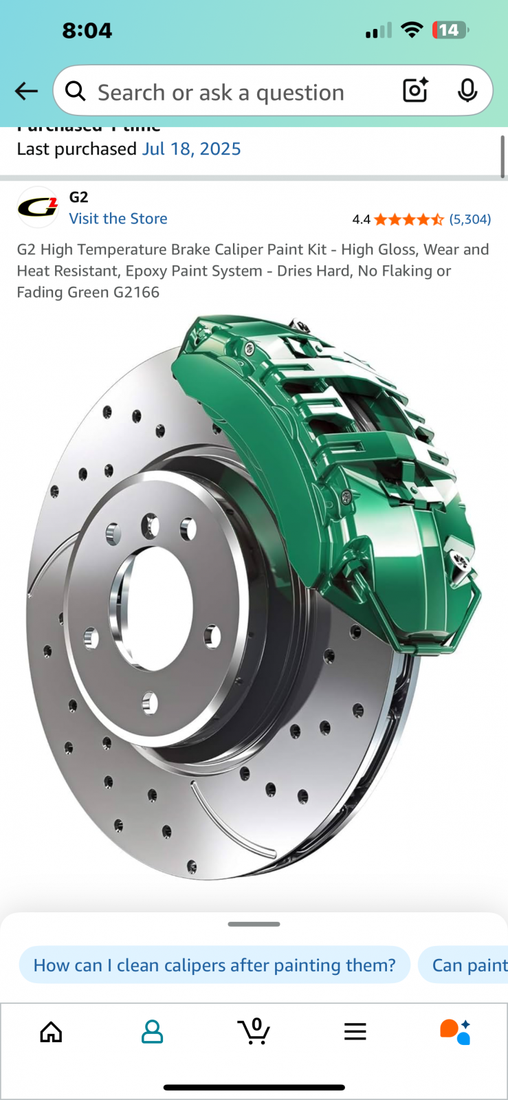

Well before I install the new big brake kit from small car I wanted to paint the calipers so they don’t rust within a week. Found this nice dark green paint kit on Amazon and gave it a shot. Needless to say the colors not even close but at least the calipers won’t be rusty.
