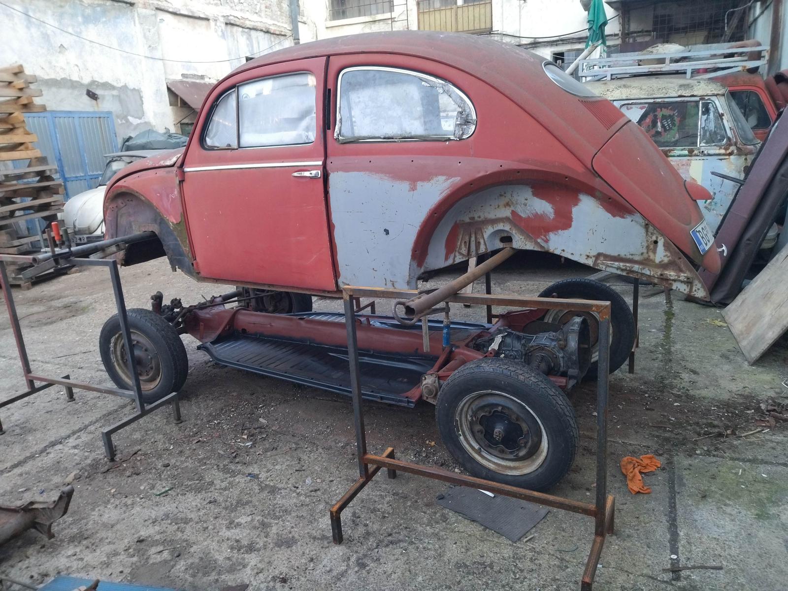

Well this is my 53 oval. I drove it , went to shows and gatherings collected small bits and parts as it was all with wrong parts, enjoying in it. I knew that when i start to correct and fix all bad welding and rotten parts joy is over for about one or more years. Also i never wanted new and shiny oval, but will see at the end what will come out.
This are some pictures of it when i drove on a daily basis.

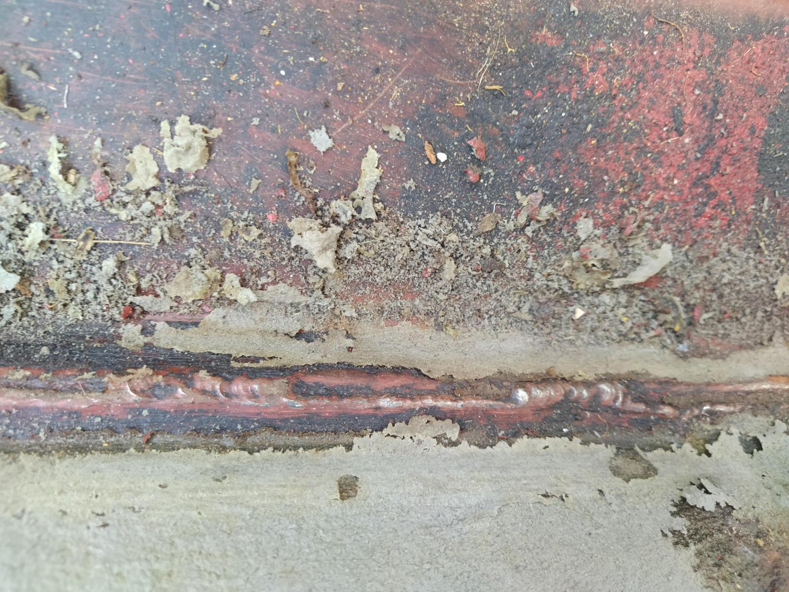

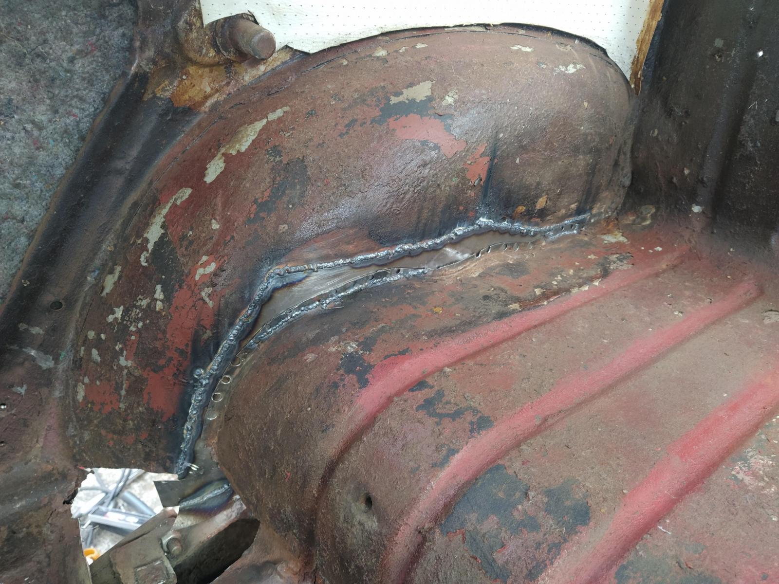

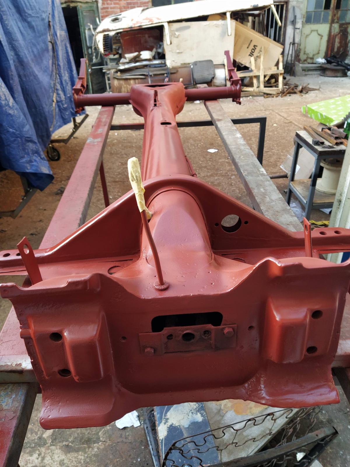

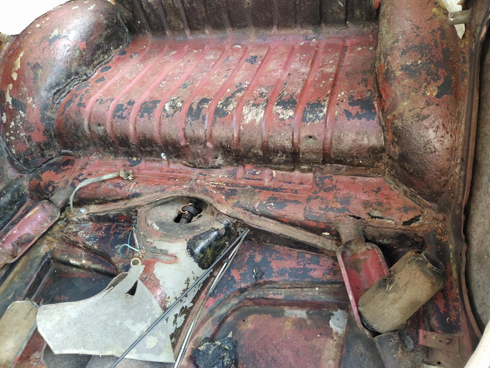

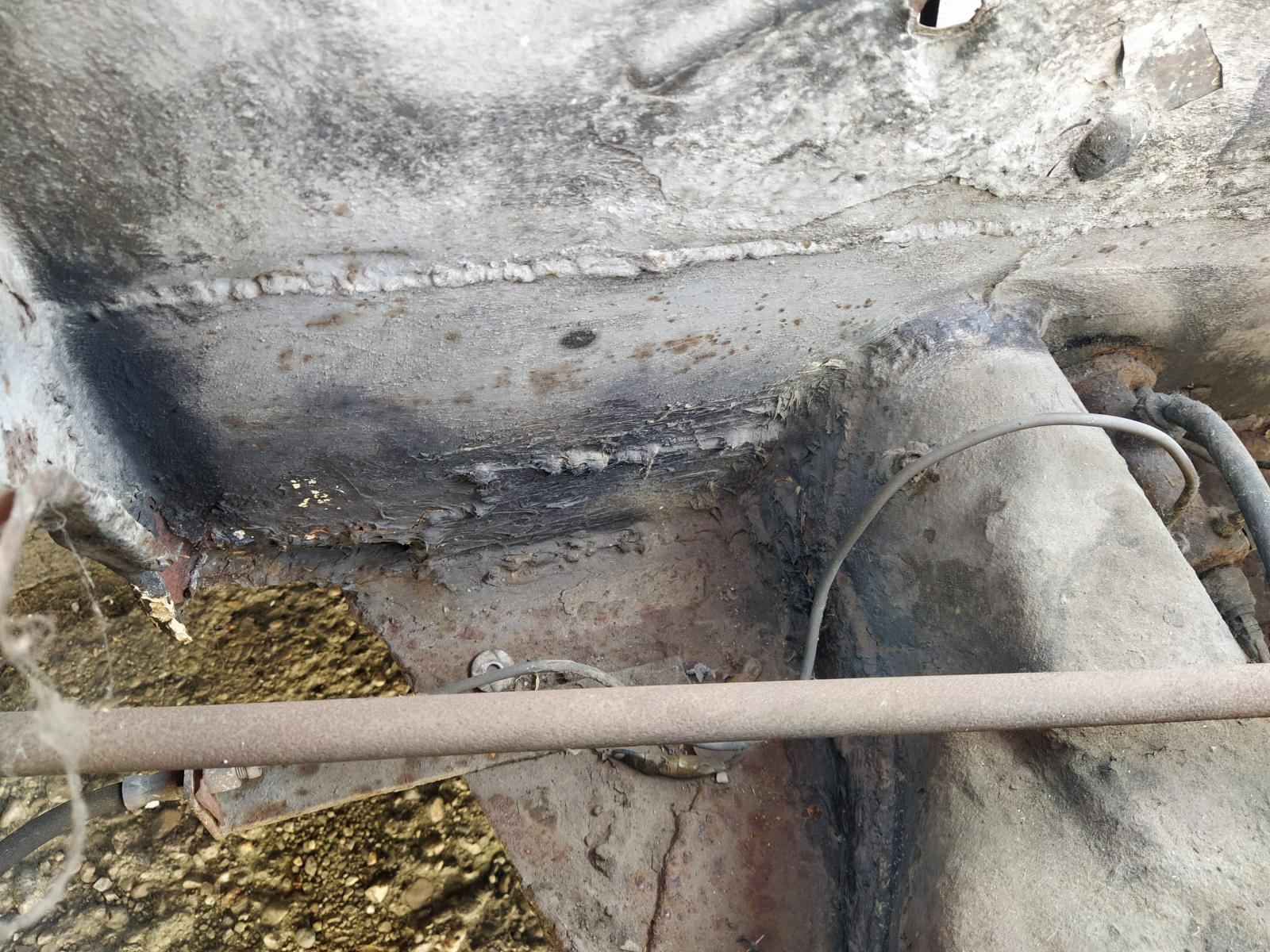

Bad things are that body is welded to the chassis with no bolts at all Rolling Eyes and front frame is all rotted and badly fixed. ( some of bad fixes are my work done by laying under it and welding Laughing ), so i had to trace and acquire new correct year chassis. So I did.
Pictures of welded frame
and floor ( by the way floor has been made from 2mm sheet metal previously )

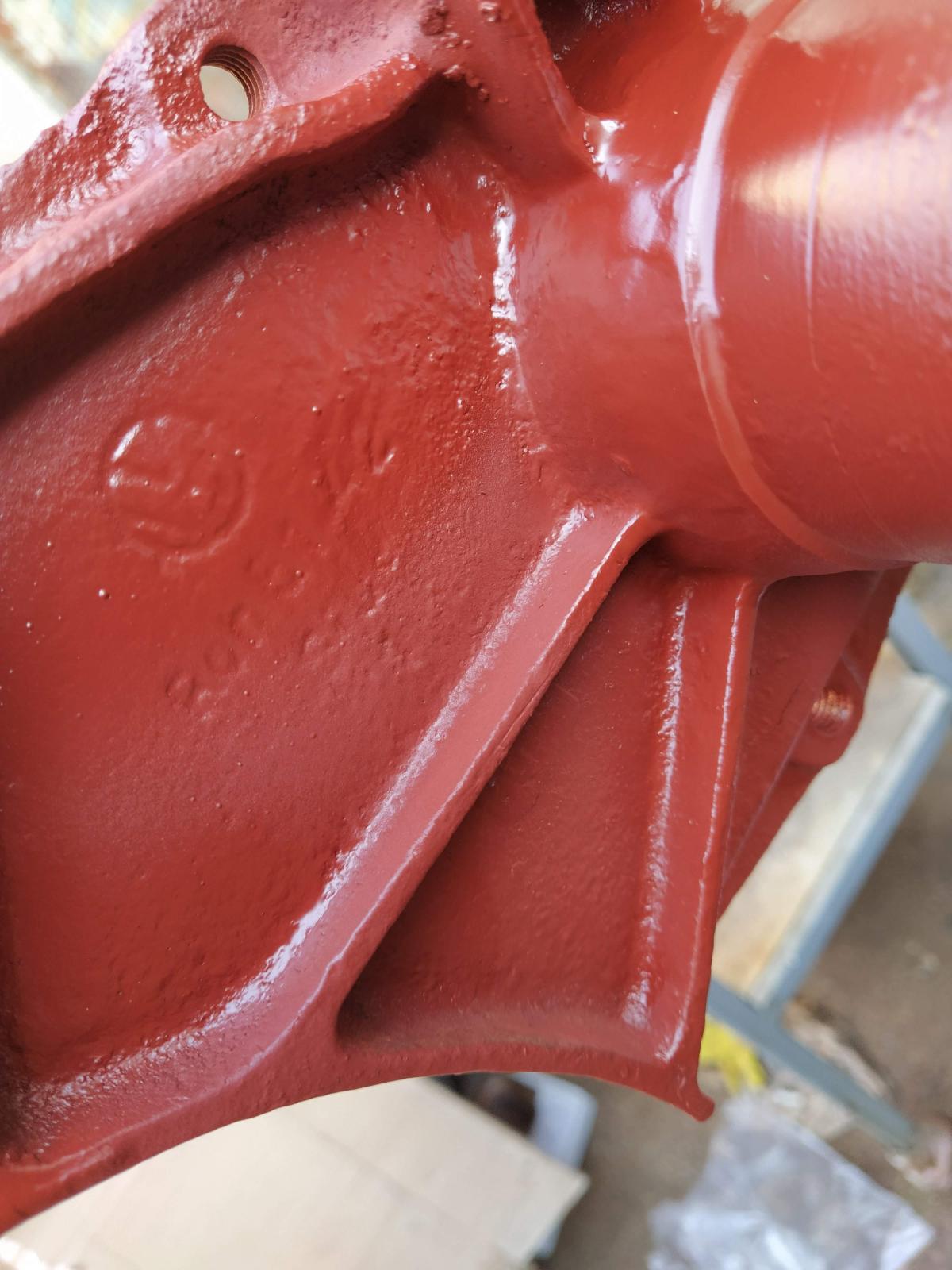

And new and already striped chassis
Then epoxy primer

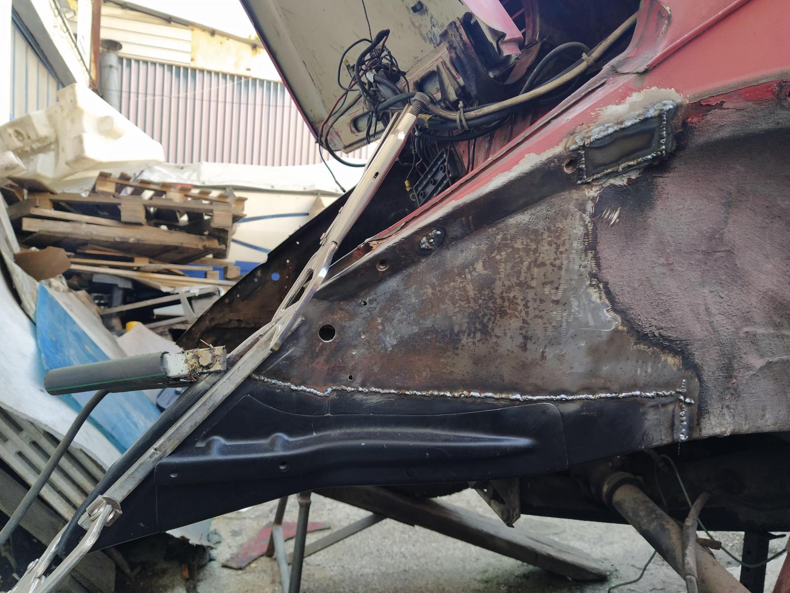

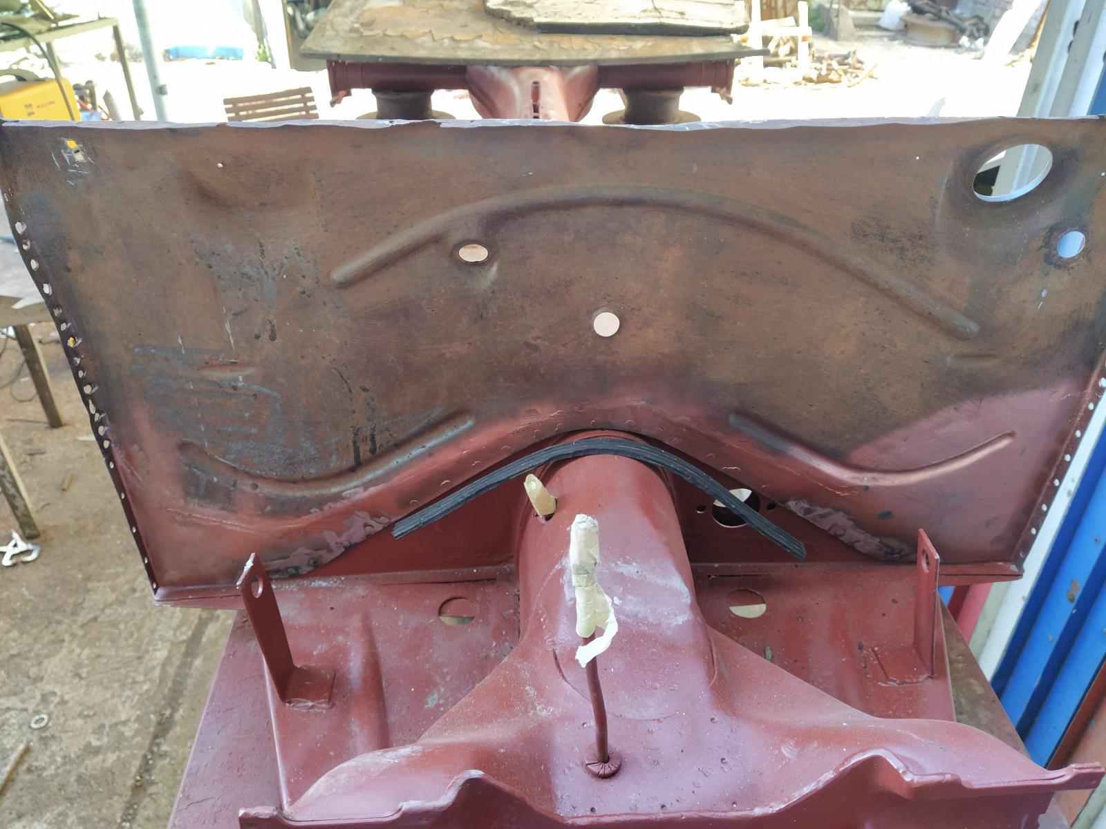

First I started with front firewall as obviously mine will be cut of so I found not so good another one
And gave him a little love
First I thought ,well it will be easy done but now i know what I knew before, this is a beginning of a long road, but not without fun Cool

I will be, hopefully soon, dabbing up those same lower corners at the bulkhead wall. What did you use to make the recessed segment? Any tips?
Keep at it! Looks like a great project!

VW_Jimbo wrote:
Very cool!
I just hammer it using half oval pipe and another straight smaller diameter concrete armature but first if necessary i bend half pipe , or just hammer it Wink

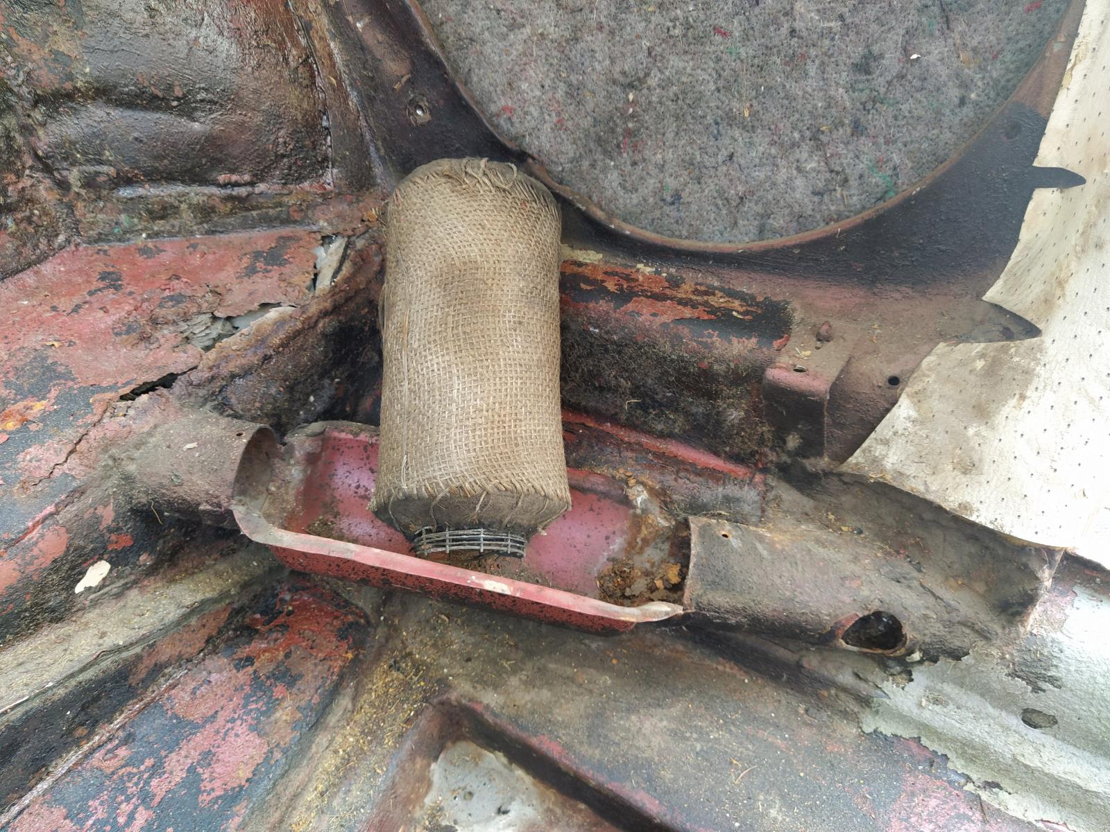

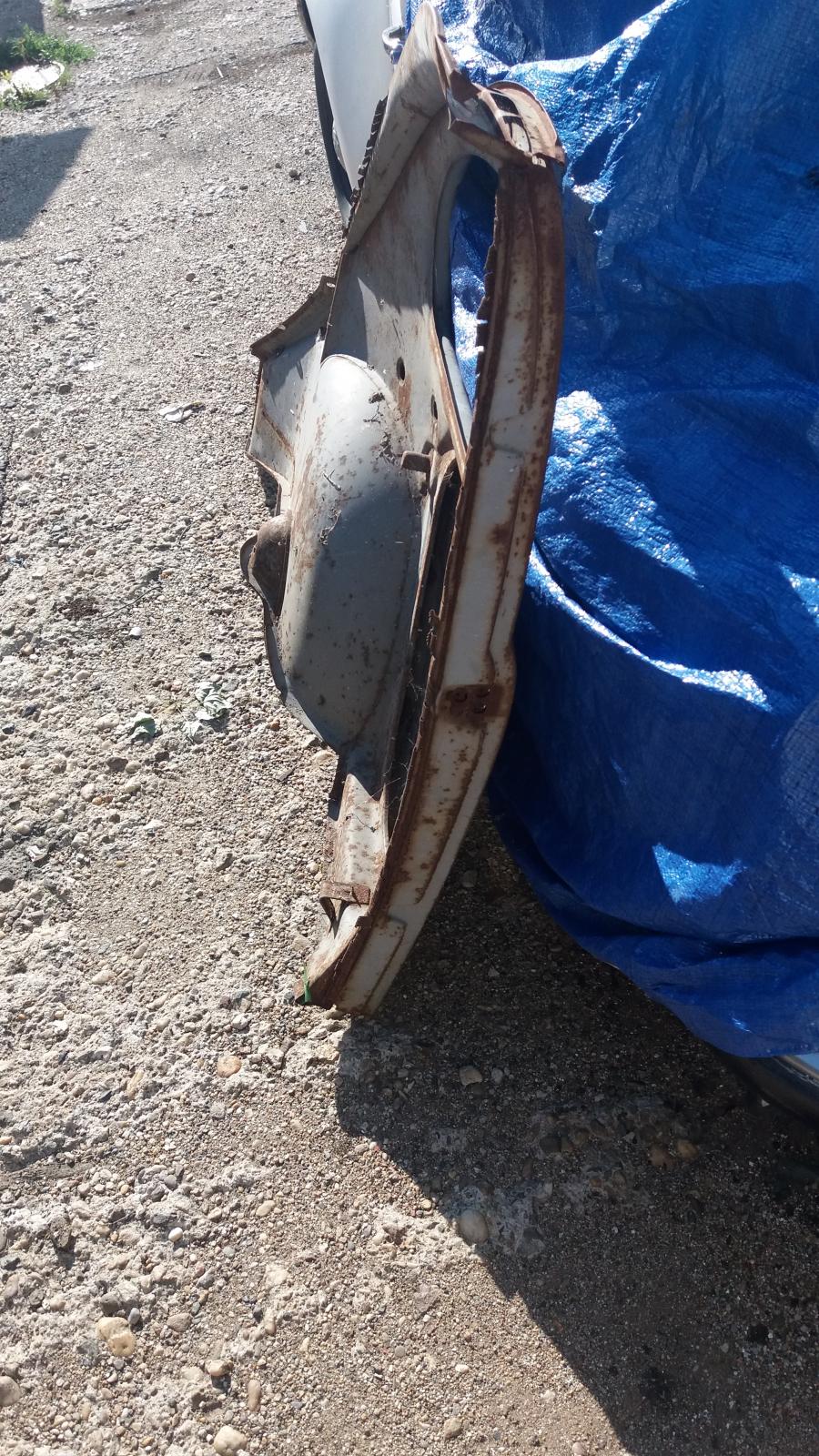

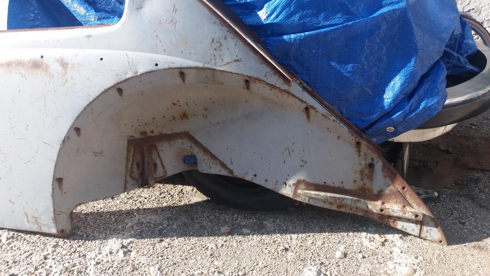

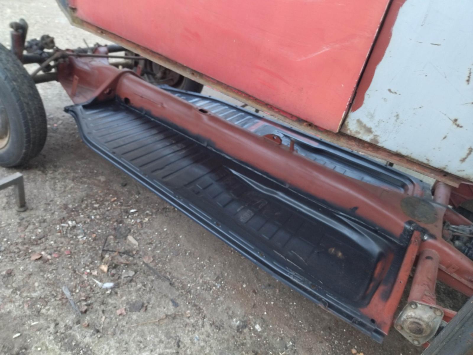

Ok. Next i started working from behind so I fixed engine bay right corner as I started from left passenger side. Someone had hard time installing bigger 1300 engine so he hacked corner of rear small firewall
Than started to work on rear apron and rear tails. couldnt find exact mach and right year bumper bracket so i use what i can find and another reason for using this tail section is because i have entire driver rear quater panel with same tail section
So vire holes are exact match to original so i used this holes to measure and cut new piece
inside is not too bad but it will need a lot of work.

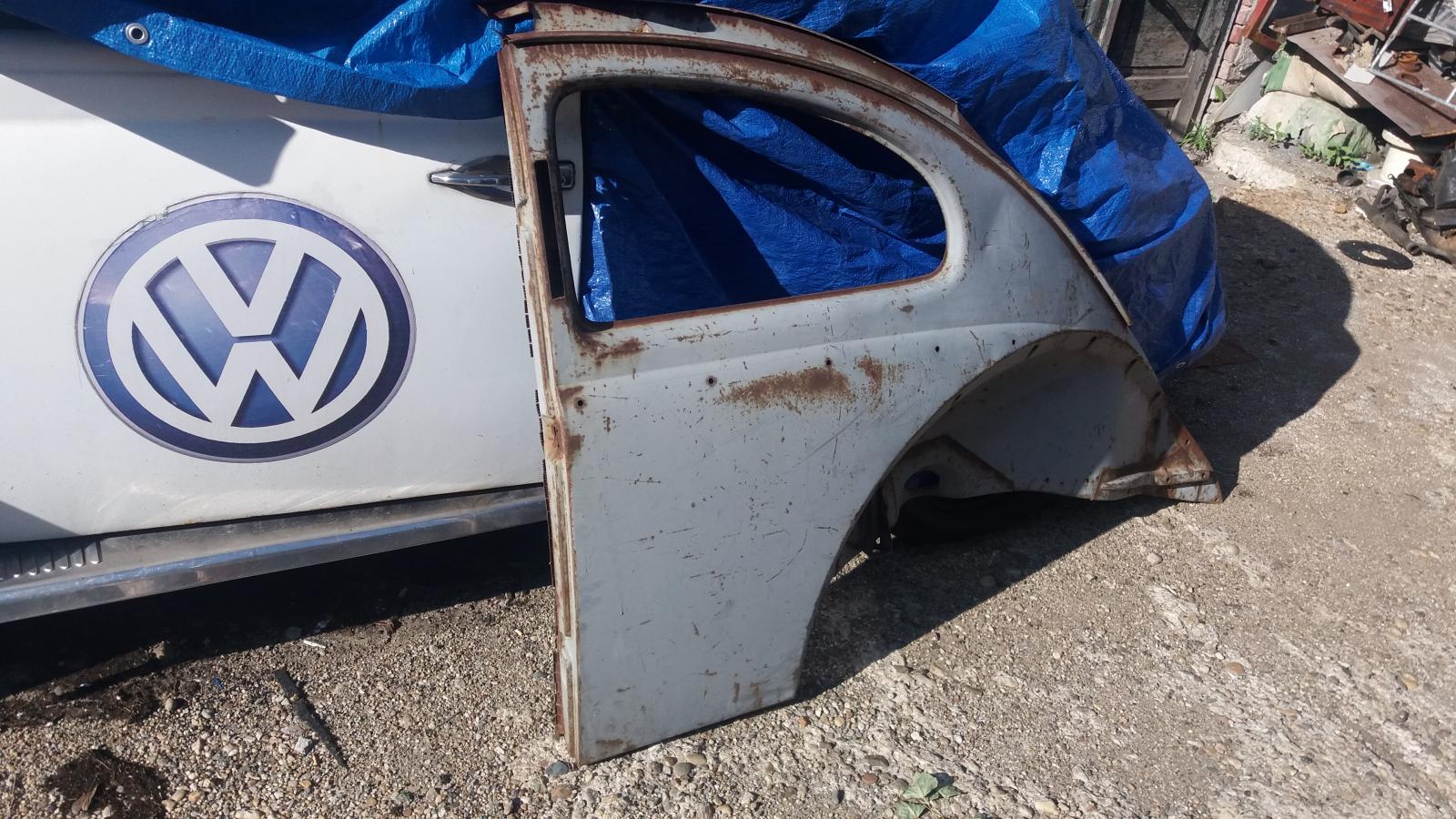

This is rear driver side quarter panel which i maybe install if original is too bad. Shame I dont have pass side as well Wink

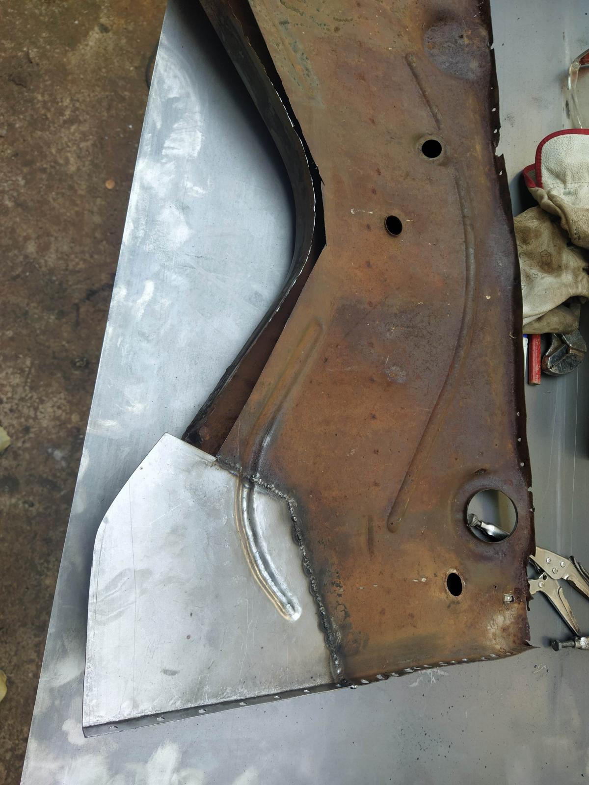

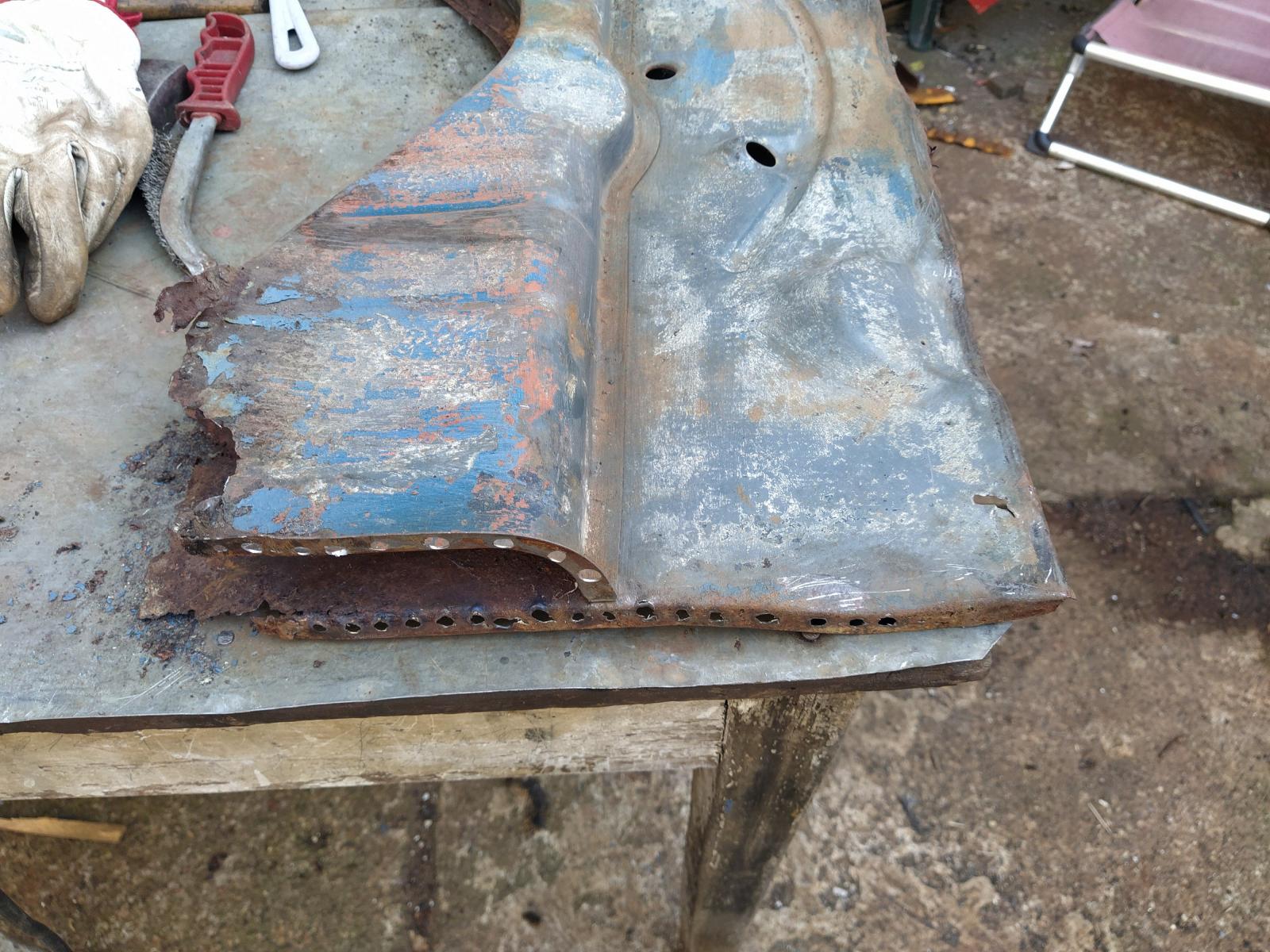

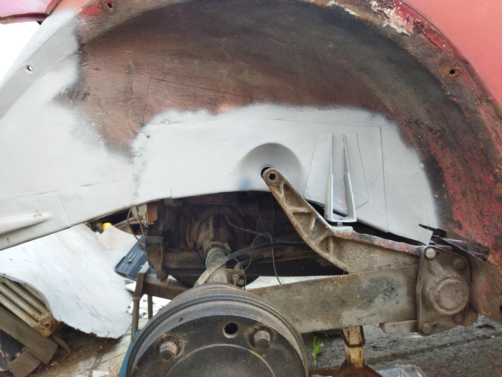

As I move along I had to consider either to buy new entire section behind rear wheel or to try to reconstruct existing one. So first I will try later and then if I fail, I always can cut and weld a new.
first I transferred curve and dimensions to new sheet metal and then welded original center piece to it

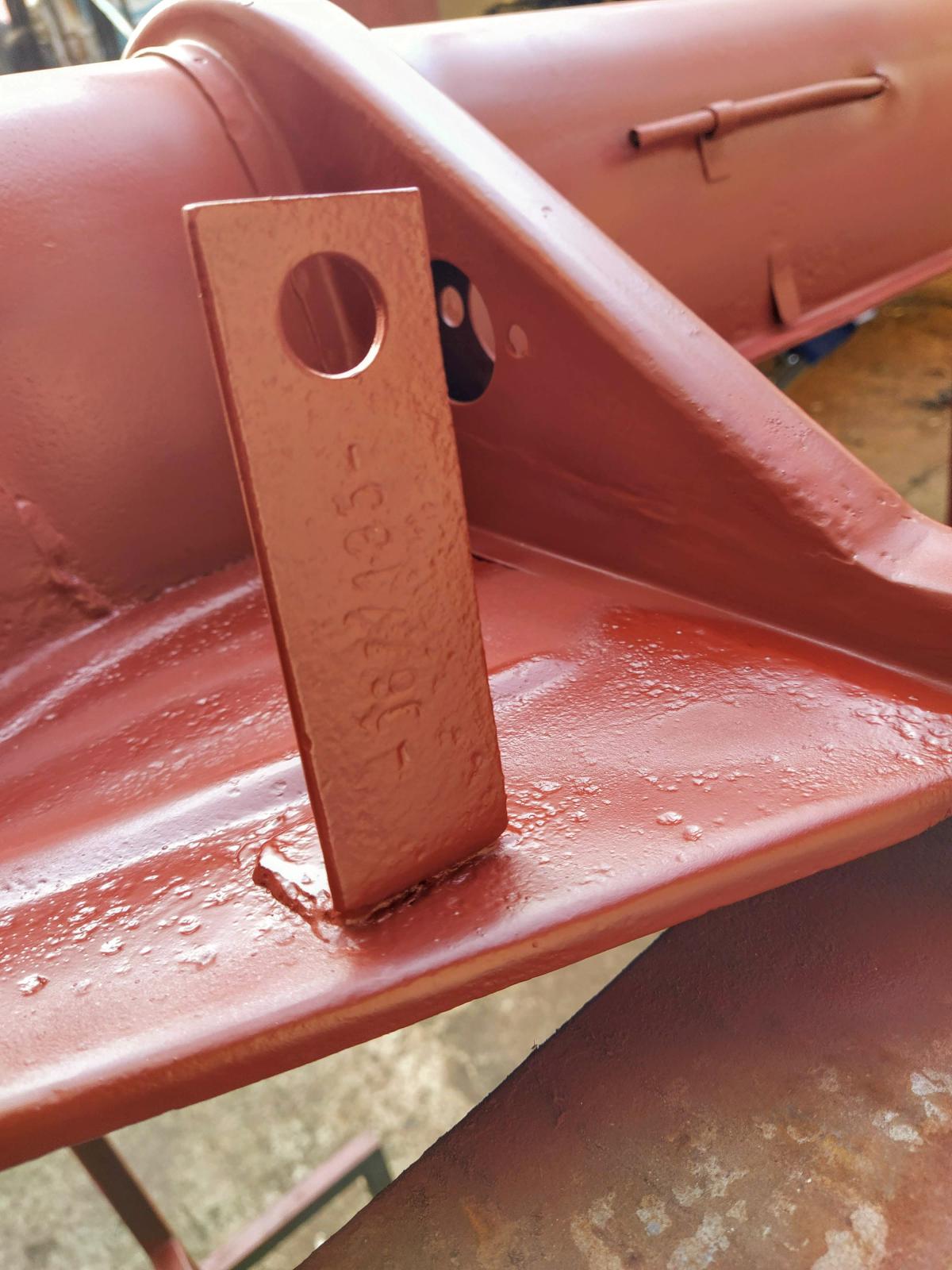

Then i copied bracket from already cut piece
than fixed truck area lip that welds to inner wing
Then assembled all together to make sure it sits well and marked metal where to cut
then installed inner sheet metal
Than straightener part welded trough holes aka " spotwelded"
And Voila... finished and satisfied . I let it sit a little higher 0,5 cm as I suspect to measurements .. easy fix.
