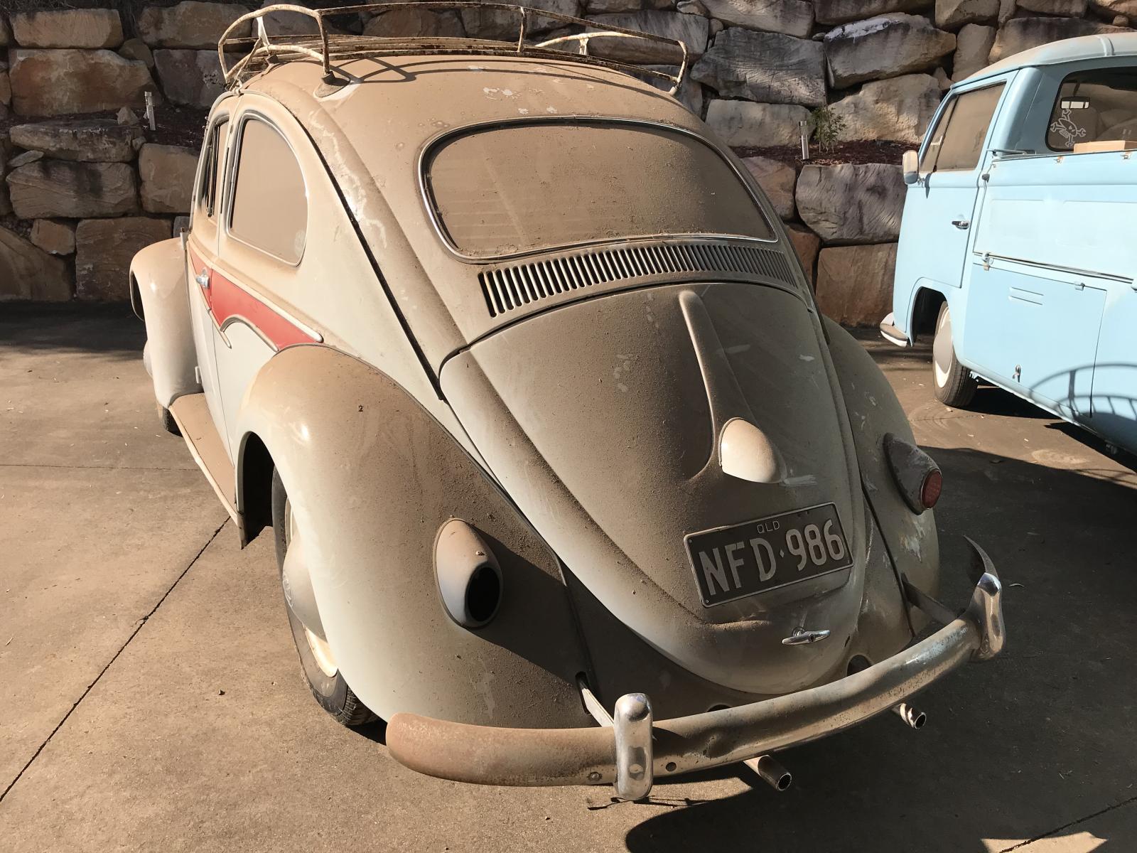

Found this pic from 2016 when we checked on saint christopher on our trip to go pick up my brother coral oval… this was the trip that sealed the deal for us to come collect her from her resting spot about 2 weeks later….
Anyway… pan complete
Rallied the boys together for a shed night to lift the body back on the pan and bolt it all down
